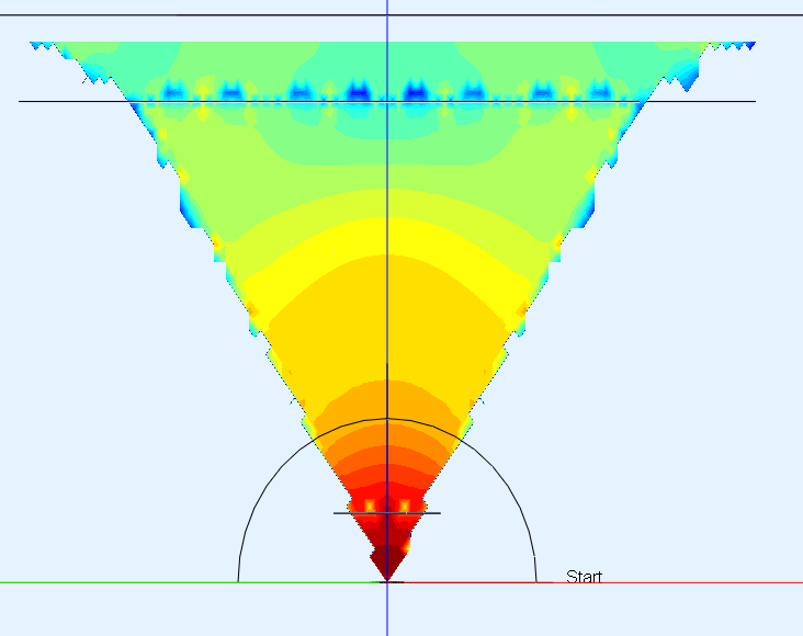

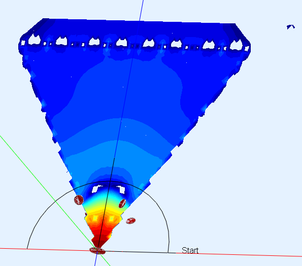

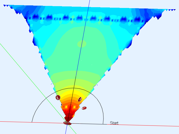

@nc535: I thought about what you said, and I think ABEC should show this clearly - if the mids are too far out, the sound won´t sum constructively as you mentioned.
So I rendered fields to check (mids only, fake phase plug in place)
1.1kHz
1.3kHz

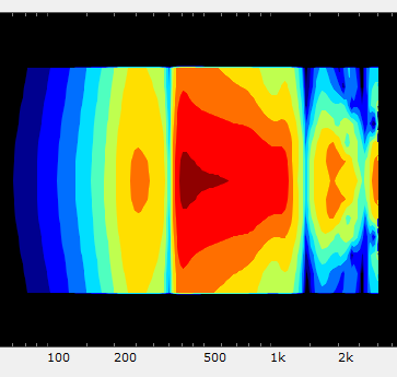

Directivity:
The two bright spots in the two first pictures near the mid entries are just artifacts from the transition between two subdomains. The same with the strip of blue spots at the top, where the flare angle changes.
It does seem like there is constructive summing at 1300Hz, with that midrange distance. (7.5cm at a 60x60 horn).
For fun, the 1450kHz field looks like this:
A strong cancellation due to the reflection of the horn throat and compression driver.

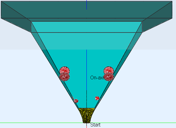

Thanks Kessito - quick question - how would you divide it? into horn segments perhaps? so that the parts close to the throat has higher resolution?
Yes, so à first part with the throat, a second part with the middle of the horn and a third part with the mouth.
If you send me your model I can show you how I would do it (just post the txt files here)

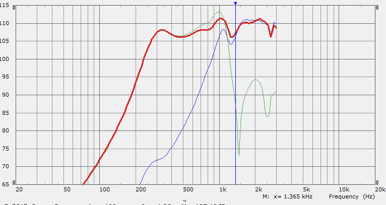

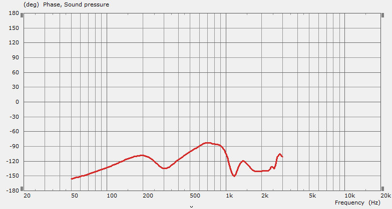

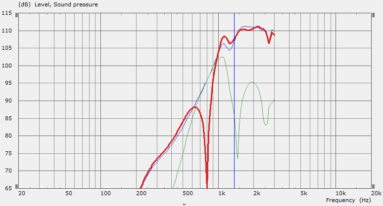

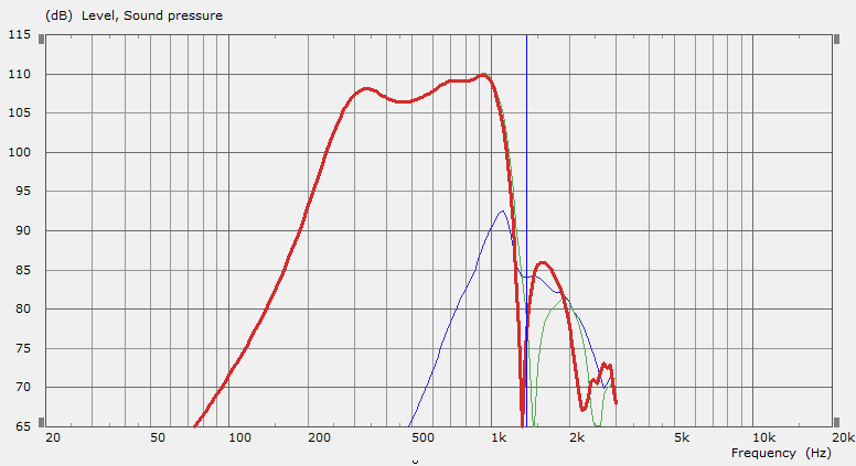

Ok, I did some changes that are encouraging:
1. Moved the mid entry points to 86mm, measured axially.
2. replaced the M10s with the 3F325s as recommended.
* 30ml as under the cone volume.
* An additional spacer of 73mm diameter and 1cm tall.
* Frustum entry 73mm -> 15mm over 16mm (just the thickness of the wood i´ll probably use, but can be anything since this is to be 3d printed).
* 0.1l as rear volume per mid. The driver itself takes up 0.125l.
Result, compression driver. The dip is shifted down to 780Hz, which means that the interference from the midrange entry holes is less of an issue.
Result midrange, with the Faital instead of the Visaton: Looks very nice!
But here´s the big surprise. The sum:
No crossovers involved here! Just the raw drivers simulated output.
Combined phase, after correcting for distance:

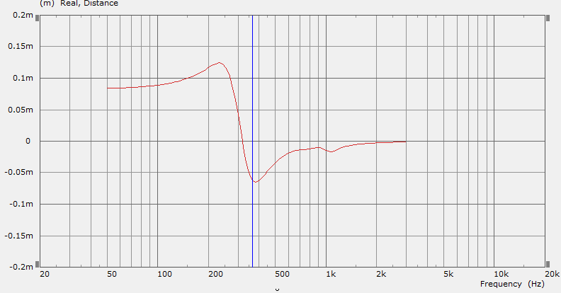

Here´s the mid excursion chart. Keep in mind that driving this sim is 2.83VRMS, and the charts always show peak values. I haven´t figured out how to make the charts show RMS values yet, but I suppose for excursion peak is a better thing to look at anyway?
The top peak at 230Hz is at 0.12mm, while the bottom "peak" at 370Hz shows 0.064mm. I´m not sure I have used ABEC correctly to get these values, as they seem really tiny. Perhaps Kessito has some tips for me? I will post the script in my next post.

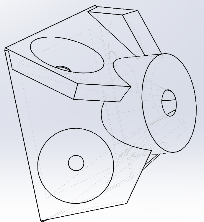

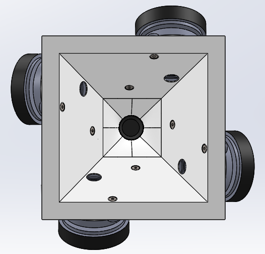

Kessito: Was this how you meant?
Yellow, aqua, teal represent individual subdomains.
The file is attached. I will attach all the files for this model a bit later, because I feel the need to clean them up - remove unnecessary comments, make them easier to read etc.
Nice work! I also like to use injection ports located about same place (89mm) and your cone displacements are correct. The horn loading is good so the driver diaphragm doesn't hardly move. When mine is running at 100dB I can touch the driver and barely feel it moving - about 40um for my 3FE22 in the tractrix horn (as main tweeter/mid driver).
Great work on new xo response.

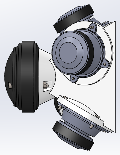

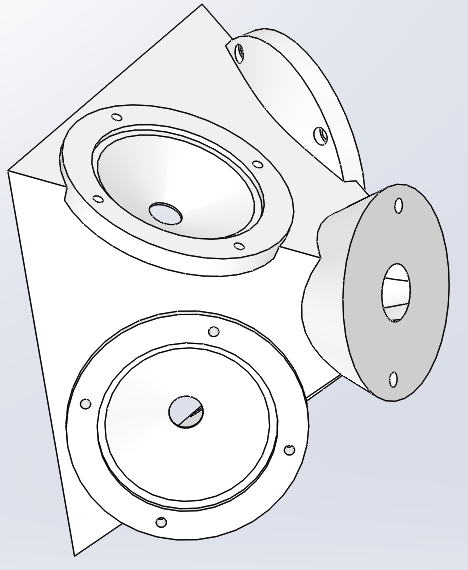

Ok, almost done.
As for the chart above with the summed response: The CD model used has this strange dip, around 1300hz. As I mentioned before, I´m not sure which one it actually is, but it is calibrated. So unless the acoustic properties of a DE250 are very different, it should be possible to use this design.
STL also included, if somebody wants to check it for printability.
I should probably make the space for the CD nuts tight enough so you don´t have to stick something in there to hold it still while tightening.
Now, if anybody could suggest a fool-proof method of fixing this to a wooden horn, I could add the necessary bits on the adapter.
Well it has a couple overhangs that won't print without support.
And it is too big for my buildplate.
But you could design it different to make it easier to print.
In what program did you design it in?
Can you attach the original file?
Meshmixer generated the following support to make this design printable.

It can be designed as five parts or more that bolts together.
Midrange holder can be a separate part making them modular.
That way trying phaseplugs and shapes of the fructum would be simpler.
Hornshape one part. Or more if the buildplate is to small.
Mounting plate for the compression driver one part.
Then that mounting plate can be build so that the surface that touch the compression driver is the surface that touching the buildplate.
That will give it a smooth flat surface.
