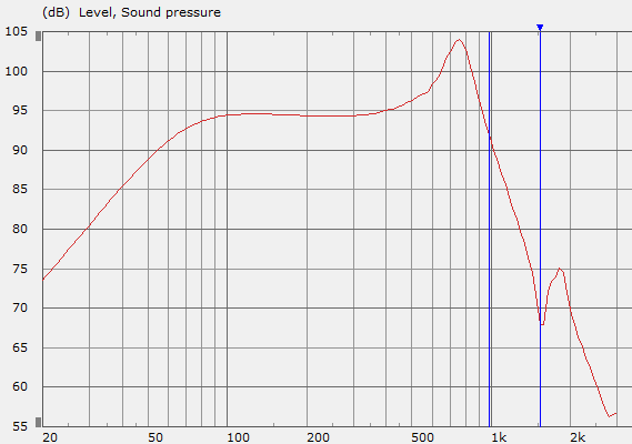

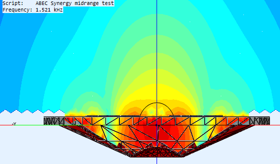

cookie and Jack, I've also done some testing a couple years ago with some 4" Celestion TF0410MR with offsetting the port vs centered. I came to the same conclusion I believe..........I'll see if I can find the data.
That ABEC sim is really cool! I need to learn how to run that..........
Cookie:
I did the same center vs offset hole experiment in the lab with a driver mounted over a hole through a large baffle board and got the very similar results. This led me to implement what I called a "top hat" phase plug (attached). The plug is hollowed out to duct the sound from the center hole over to the edge. The internal path length ends up being 3-4 cm long which probably means it needs to be simmed and optimized.
The phase plug improved the worst of it but I'm now trying some 6" drivers that I have on hand to see if the end result is better.

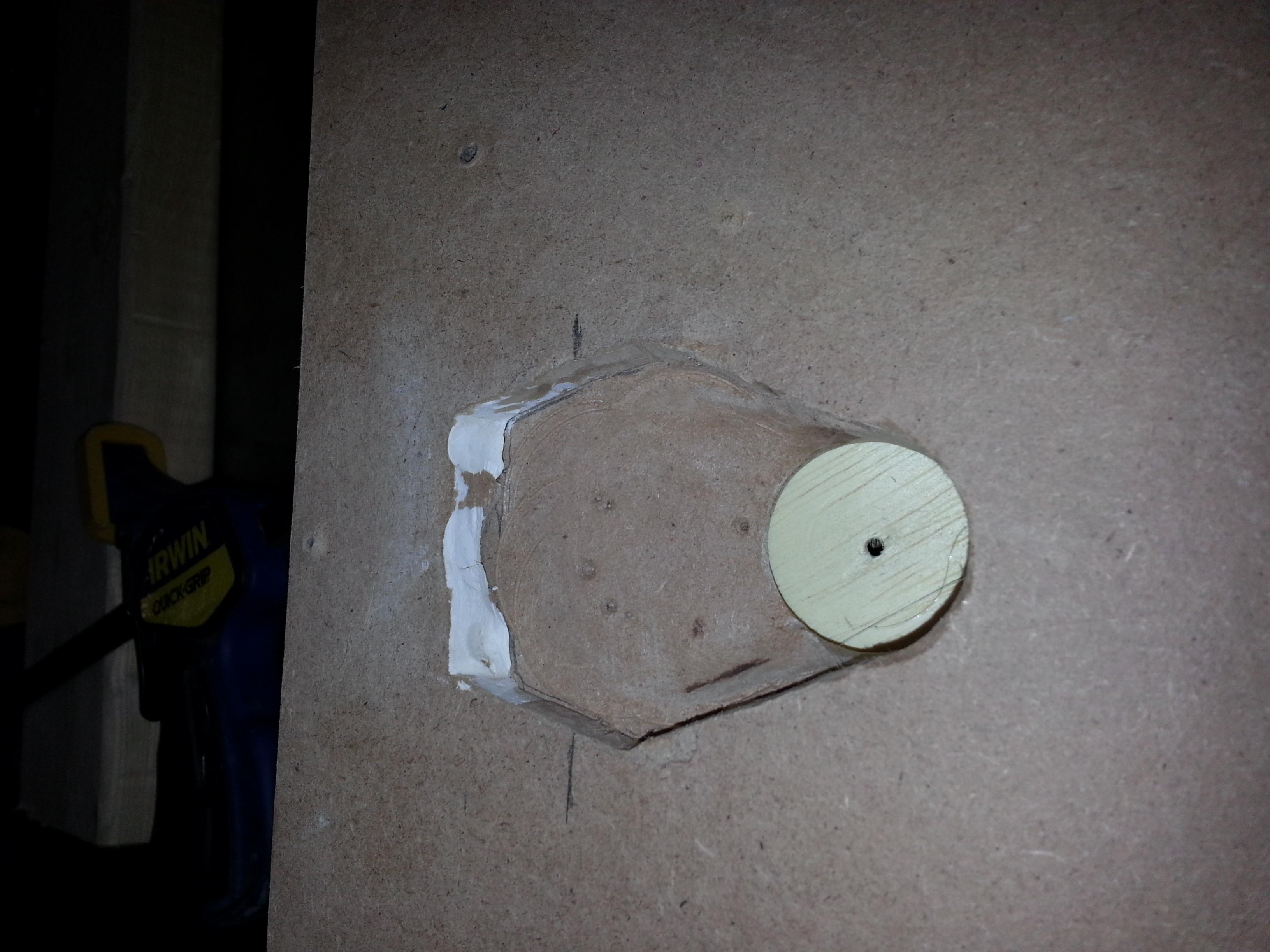

Neat stuff. Is that top hat a flat with a depression for the dust cap clearance or is it a ring? Can't tell from photo but assume it is the former. Is the central duct then angled to get the outflow located at an offset location?
top hat phase plug details
Its a depression to avoid hitting the dustcap at high SPL. I'll attach some better pictures.
I made a truncated cone by clamping a round piece of 1/2" MDF in the arbor of my table saw, using the saw as a lathe. I then drilled a 1 3/8" dia hole down through the center and mounted the 1/4" thick top hat 1/4" above it. I mounted the assembly on 1/2" spkr mtg plate which then mounts on the horn wall. The spkr mtg plate is cut away under the hole thru the phase plug and above the holes through the horn wall to form the duct. The plug itself is hollowed out above the cut away in the spk mtg plate. So the net of this excavation is a duct that is angled on top, following the cone profile and flat on the bottom. A dremel tool with a flapper sander was invaluable in doing this.
The first picture is a top view from closer up. The 2nd picture shows the view looking up through the cut away in the speaker mounting plate.
@ winslow: Thanks. Why do you think this is? Due to the resonance of the hole being at a higher frequency?
@nc535: good to hear you got the same results. I am wondering if a simple longer frustum would do the trick. the longer the frustum, the smaller the wavelength distances for the woofer. naturally, resonance will be an issue though. one thing i thought about was basically splitting the woofer into segments (say 4 slices of a pie) by an X-shape extending down into (but not touching obviously) the cone. that should help separate the waves from each section from eachother. I´m sure there are many ways of doing this, the goal must be to do it as simple and sturdy as possible, and keep it printable. 🙂

I tried to run the simulation with two 70mm holes offset by 60mm. So same offset distance as the single offset, and same total area.
Perhaps result is not too surprising: Somewhere between the two first trials.
@ nc535: Thanks! I will read through the thread and find it.
Good to know that two holes is better than one 🙂

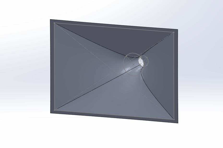

I one want to make the transition from round entry to square horn, Spaceclaim have a really nice feature called Blending.

If you are using Solidworks it is built in. Use the "Lofting" tool in sheet metal. Make a square profile and round profile separated by height. Choose Loft shape and it blends it based on how many "panels" or regions of a bend you want.

A loft in Solidworks does not require the sheetmetal feature.
The loft can be built from sketches positioned along the horn path each containing the cross section profile.
The loft can be built as a thin feature with a wall thickness suitable for the 3D printer
A nice feature is the tangency between the profiles.
This example is built from 3 profiles 2 round and one rectangular
The profile sketches could be any shape. Maybe in this example of a transition from round to rectangular the second profile should be elliptical? It should be possible to guide the loft so that the end shape is tangential to any timber horn extension used. Need to play with this a bit longer!
