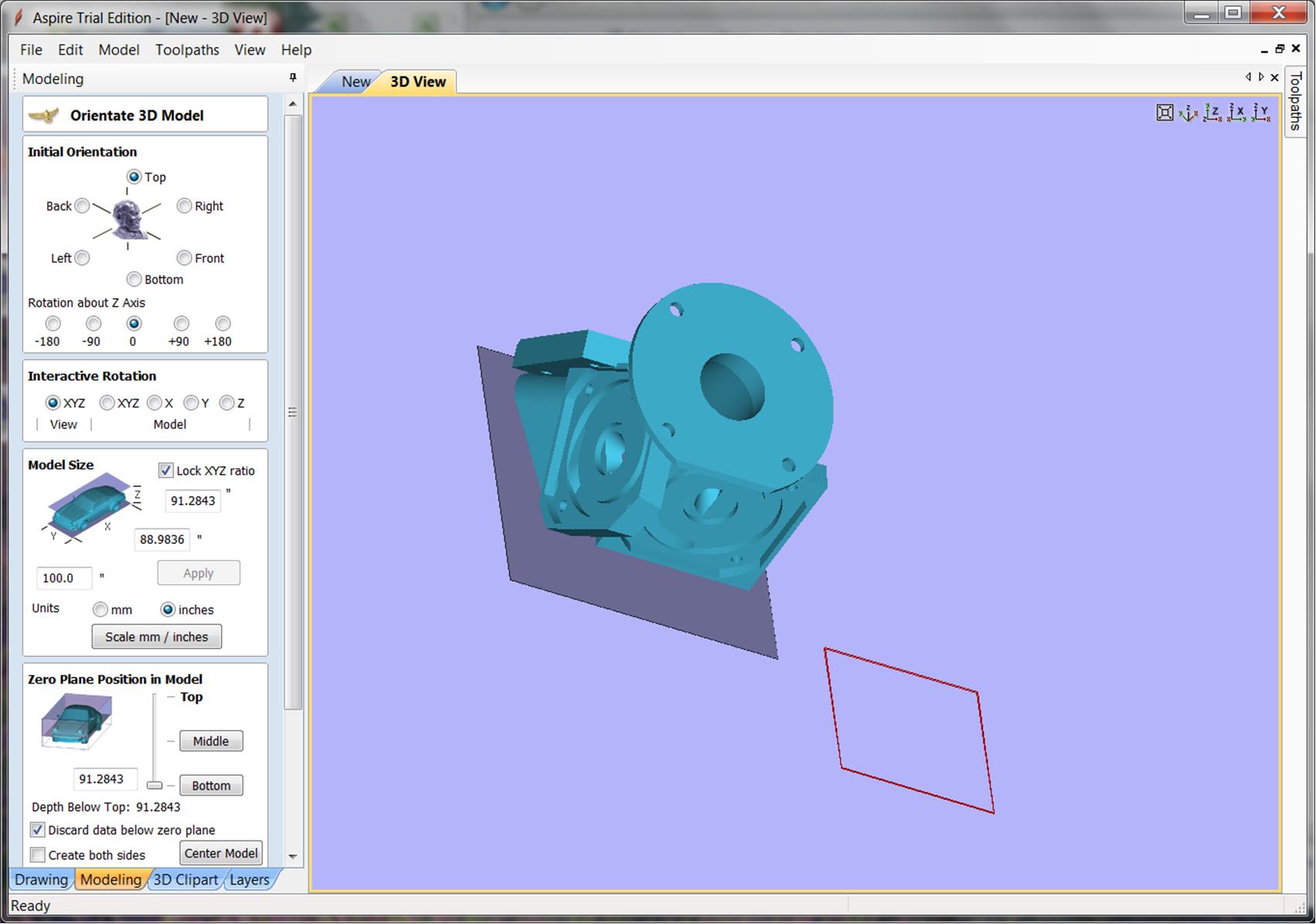

I was (ironically) able to open and view the file in Aspire Trial Edition, typically used for CNCing. It would be folly to try and CNC it but individual pieces certainly could be done that way. OTOH, a 3D printer is way cheaper and smaller than an CNC router.

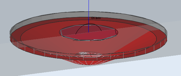

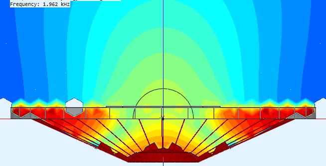

Two smaller ports per midrange is going to cause less problems with the compression driver than a single large port.
Offset port vs centered port - woofer example in ABEC
I got sidetracked from the midrange bit because I wanted to experiment with ABEC3 on the effect of having the output ports offset from the center of the driver. In the M10 example, I went to some trouble to keep the ports centered in a frustum to get minimal cancellation of sound waves. I don´t think Akabak simulates this, and I suspect it could lead to frustration when trying to get mids to "reach high" if one is not aware of the effect of the offset ports.
I did a very simple example, based on the 10CL51 driver from the Synergy Tripp thread. The reason I used that one was because somebody had posted a nice profile of the cone interior, so I could get a pretty accurate model in ABEC. Not 100%, but good enough.
So in the simple model, I have used the following Akabak-paramters, if somebody wants to validate:
Def_Driver "10CL51"
Re=5.2ohm Le=0.8mH
| Rg=0
fre=1kHz ExpoRe=0.8 ExpoLe=1.6
Mms=32.321g Cms=0.218e-3m/N Rms=3.206Ns/m Bl=12N/A
Bl=12N/A Mms=32.321g Cms=0.218e-3m/N Rms=3.206Ns/m
| fs=60Hz Qms=3.8 Qes=0.44
The script is BEM except for the rear of the cone, which goes into a LEM enclosure of 60L. Huge yes, but it was just what I put in to make the bottom end as smooth as possible. No vents of anything. Low frequency is not really the interest here, as it doesn´t matter for this purpose anyway. There simulation uses an infinite baffle, so no wrap-around etc (imagine the driver mounted on a huge wall - no floors, ceilings etc).

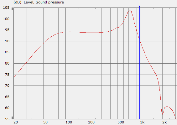

First, the response from 1m @ 2.83VRMS with a 100mm hole centered. 100mm is chosen randomly. Unfortunately, once you go "full BEM", I can´t find a way to measure flow velocity through a port.
(Perhaps xrk971 could help with the ideal port size for this woofer? I thought I had found it as 1.68 square inches in the Synergy Tripp thread - is that correct? Two exits per woofer? I don´t mind using that woofer as there is a proof of concept in the Synergy Tripp thread, but for the heck of it i´d also like to use mids - more learning (and frustration probably) for me, but that´s why we do this.. 🙂)
Anyhow, the sim is interesting - so first with a centered hole:
One can clearly see a a peak and a deep dip following, as can be expected, at around 2000hz.

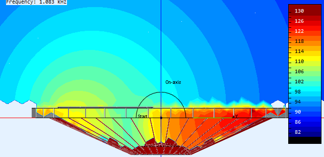

The found field at 2000Hz looks like this:
There is a neat cancellation of the soundwaves coming from the left and right, leaving us with (probably very simplified) with the sound from the middle of the cone.

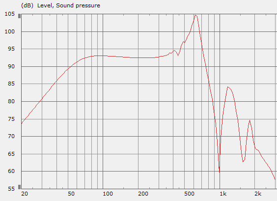

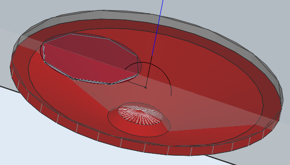

Moving on to the offset variant (60 mm offset)- no phase plug or anything here:
The peak appears a bit lower in frequency, sharper, and is followed by a strong peak/dip pattern, with the first dip at 1000hz instead of 2000hz. An octave!
Examining the sound field for the 1000hz dip, one can see how the sound waves from the right side arrives at the left side (where the port is) such that the two cancel out.
It seems to me like its worth striving for centered entry if one wants to extend high frequency response. Even better than the simple hole would probably be some kind of phase plug - depending on how high one wants to go in frequency. Cone breakup will be an issue, and is one of the reasons why I´d like to use mids rather than make a big deal with trying to extend the highs of the woofers.
With an octave difference in this example, it won´t be unreasonable to expect similar effects with the mids. Tuning the entry to get the desired extension is important.
Def_Driver "10CL51"
Re=5.2ohm Le=0.8mH
| Rg=0
I would like to run the example with parameters from the mids you guys have suggested.
