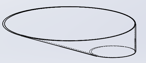

Knowing the cone geometry of the midrange driver would allow simming this assymetrical entry in ABEC in BEM, to see how the offset hole would change the frequency response.
Of course, phase plugs could be added here.

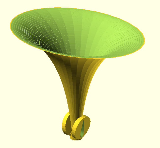

To illustrate some of my thoughts, here is what should be a tractrix expansion (expansion code borrowed from Lukas Süss aka mechadense via Thingiverse), elliptical horn with teardrop mid entry holes. 6.5" mid mounting plates. 1" CD with 2 bolt sized CD mounting plate.
The code originally was for a circular tractrix horn, I scaled to an ellipse by stretching subsequent layers farther and farther on one axis. I don't actually know whether this destroys the tractrixness of the expansion. I'm hoping it just creates a lower frequency curve, which is part of the point, so all should be well. Fair warning though 🙂.
