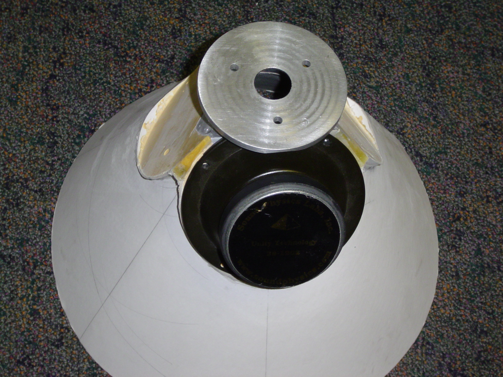

Hi mark100,
perhaps you could approach the problem form a different angle (pun intended). That is, with the per-determined 1/4 wavelength distance(s), select an angle of the horn/wave-guide that satisfies both requirements.
But, then one needs the loading curves for the different angles. I see if I can find my old Maple to install and revisit the problem.

Hi mark100,
Regarding the italicized portion of your quote, maybe my geometry is lacking, but it seems to me that since the distance is constant, the drivers must be at the same distance from the throat. What am I missing?
Or are you talking about the entry-to-entry distance between the different drivers? I attempted to solve it using a round horn, which allows for (relative, depending on the size of drivers) freedom regarding the number of drivers.

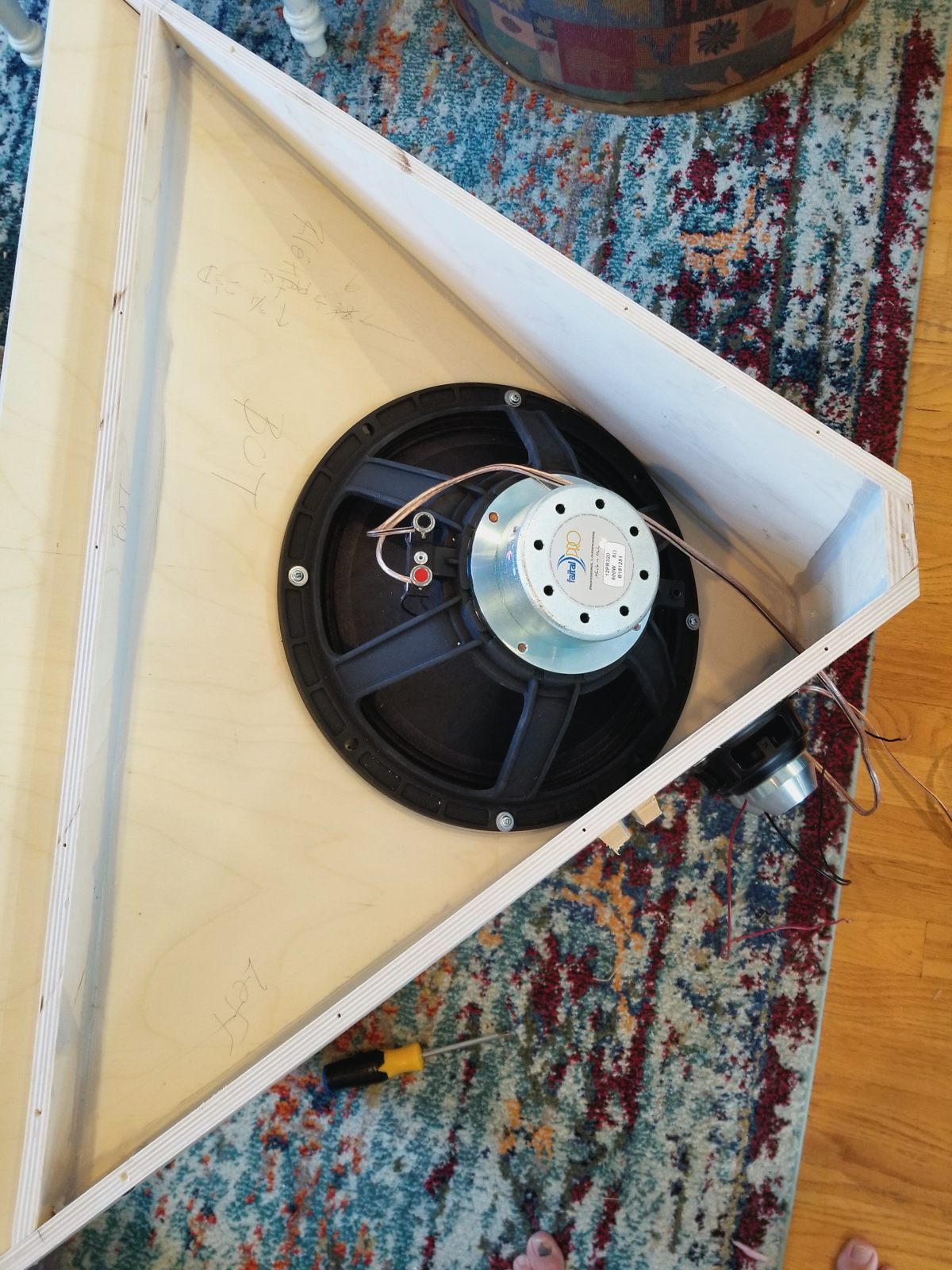

Hi M, sorry for a lack of clarity. What i meant was particular to my method of mounting the 12"s on the top and bottom, where it has to fit in between the side flares.
Like in this pict.
When i'm trying to keep its ports as close to the side walls as possible, a narrower horiz pattern pushes the cone and hence ports out further from the throat.
When I use a single round port centered in the horn, it obviously doesn't matter then.
I really need to figure out an easy way to make vertical polar measurements.
The single round port centered in the horn doesn't mess with horizontal polars any more than ports towards the corners as far as i can tell.
But i figure it has to hurt vertical more. Must test, and find out. If verticals don't die and go to the minors, to heck with woofer corner ports !
The big syns without a box are very awkward to rotate, to rest on a side for measuring verticals.
But their saving grace is weight. This 75x60, with a 33.5" x 26.5" primary mouth weighs just 62 lbs using the 8 lb B&C CD.
Still needs secondary flares, and boxing in the small mids. I'm estimating 70 lbs total.

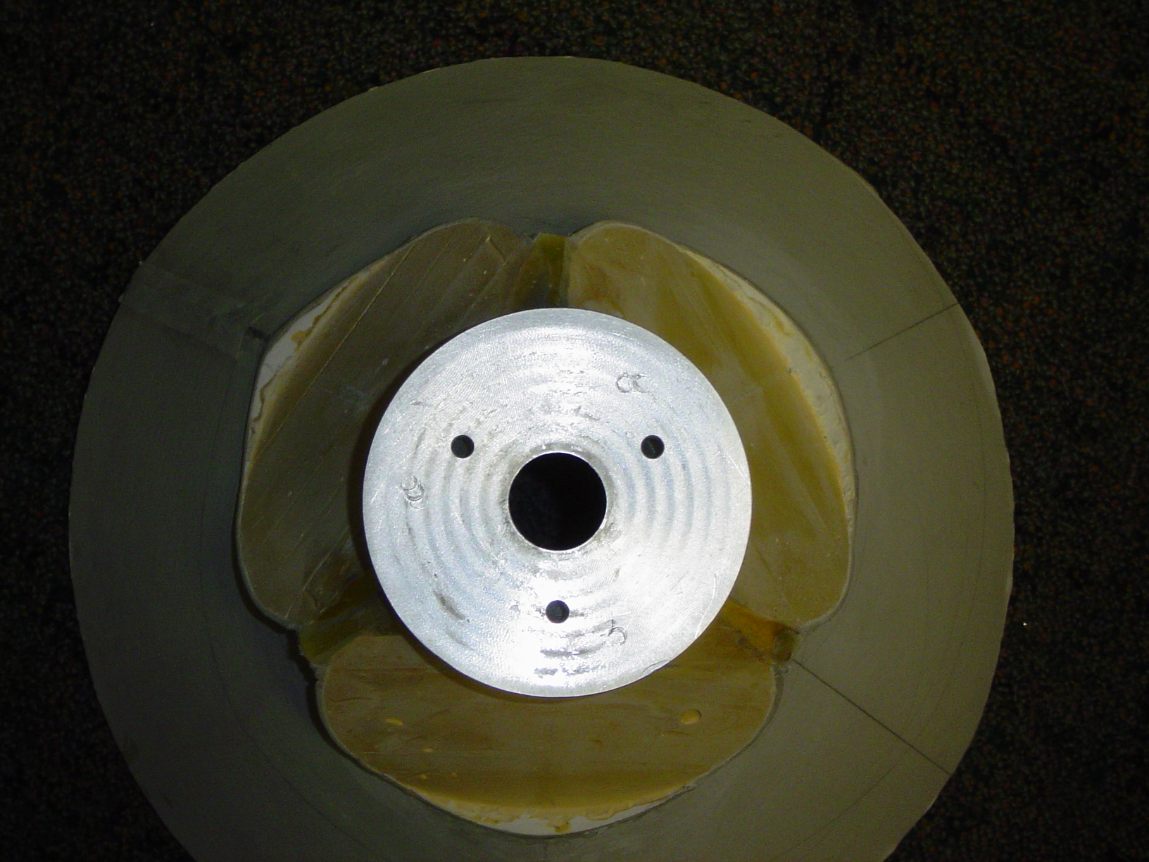

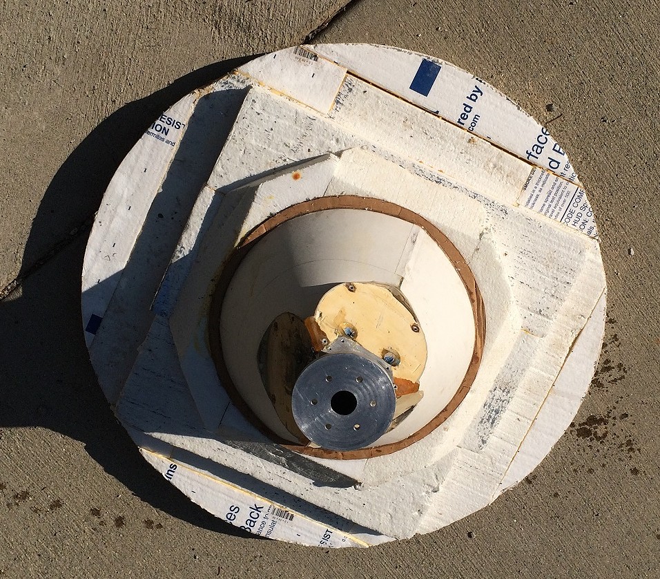

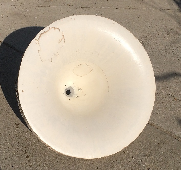

Hi mark100,
thank you for the explanation, it makes sense. The round horn does not have the same problem, but, of course, it has its own tradeoffs.
My project stalled several times for various reasons, but I have now finished the horn mouth, and I am waiting for a measurement microphone to arrive, as I had lost an access to a reference microphone I had used before.
Kindest regards,
M
P.S. It is little crude, but for evaluation purposes . . .
M
Kindest regards,
M

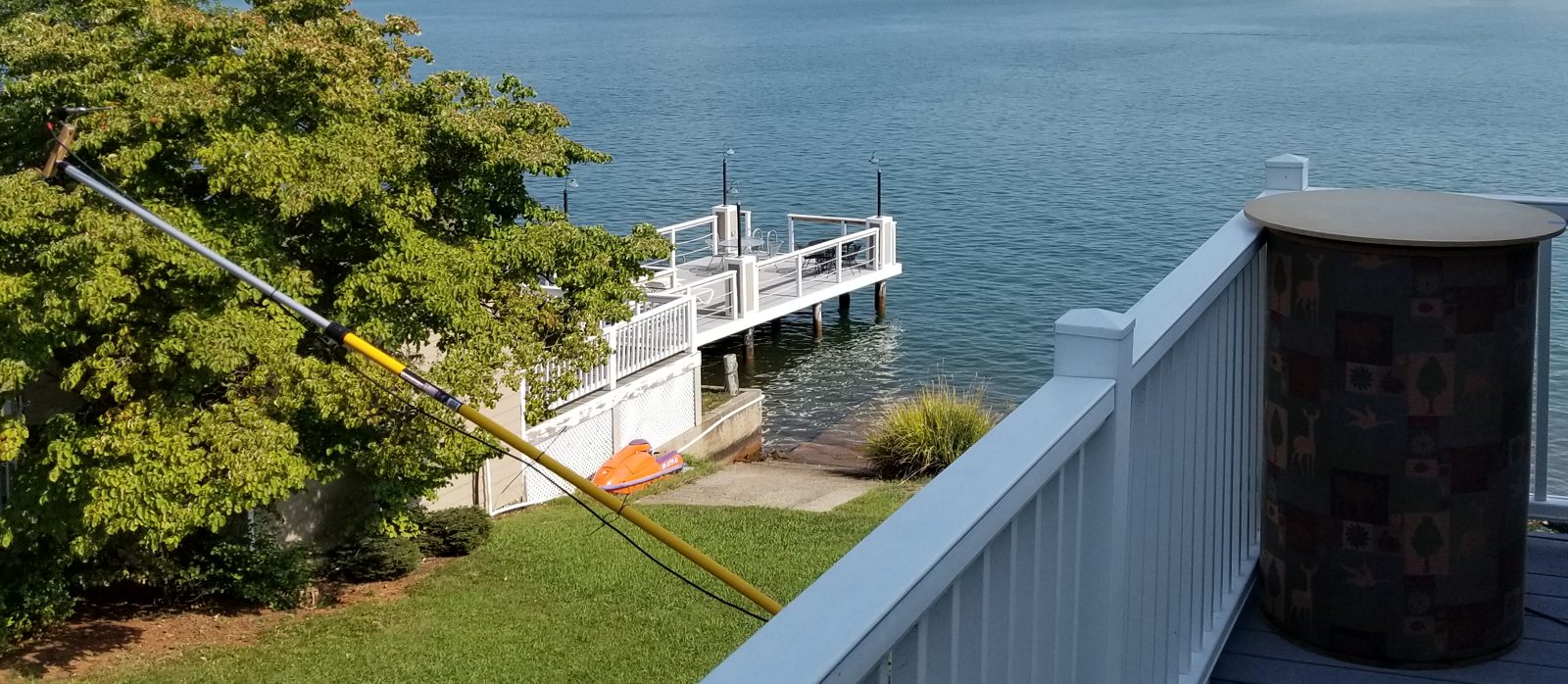

OK...progress report.
Been trying many things...
First step was to make a better outdoor measurement rig.
The rotating boom hung from off a deck overhang that i've been using for years, has always had high susceptibility to wind. And i've never been real happy about house/deck reflections still being picked up.
New location uses a fixed boom going off the side of the deck that reduces house reflections, and greatly reduced wind's effects.
You can make out the mic in top left corner.
I'm very lucky to live on a beautiful lake, but you would not believe the noise.
Sound really caries over water, and between boats, jet skis, waves on the rocks, lawn movers, leaf blowers, cicadas, well, ...SPL meter always reads 80+ dB noise.
Remarkably, time averaged measurements with Smaart using pink noise are barely effected. A few seconds and not very loud, and good data is captured.
I didn't fully appreciate how well time averaging worked with the old test rig.
Wind really messes up measurements with even the slightest mic movements. That was obvious, but i also thought all the lake noise was messing up the measurements too.
With the new, more stable mic rig, I can now see how little the noise messes up the measurements. (and it's easily identifiable as a lack of coherence)
I'm elaborating all this to provide encouragement to any contemplating out-door measurements in noisy environments. Time averaging pink works.
Averaging multiple sine sweeps works too, but it's probably hard to get away with many siren swoops just about anywhere. Pink is inoffensive.
If anybody knows a lower cost dual channel measurement program than Smaart, which can time average pink (or music, etc), please post it.
Anyway, back to syn 9 with adding small mids....
Attachment 979664
