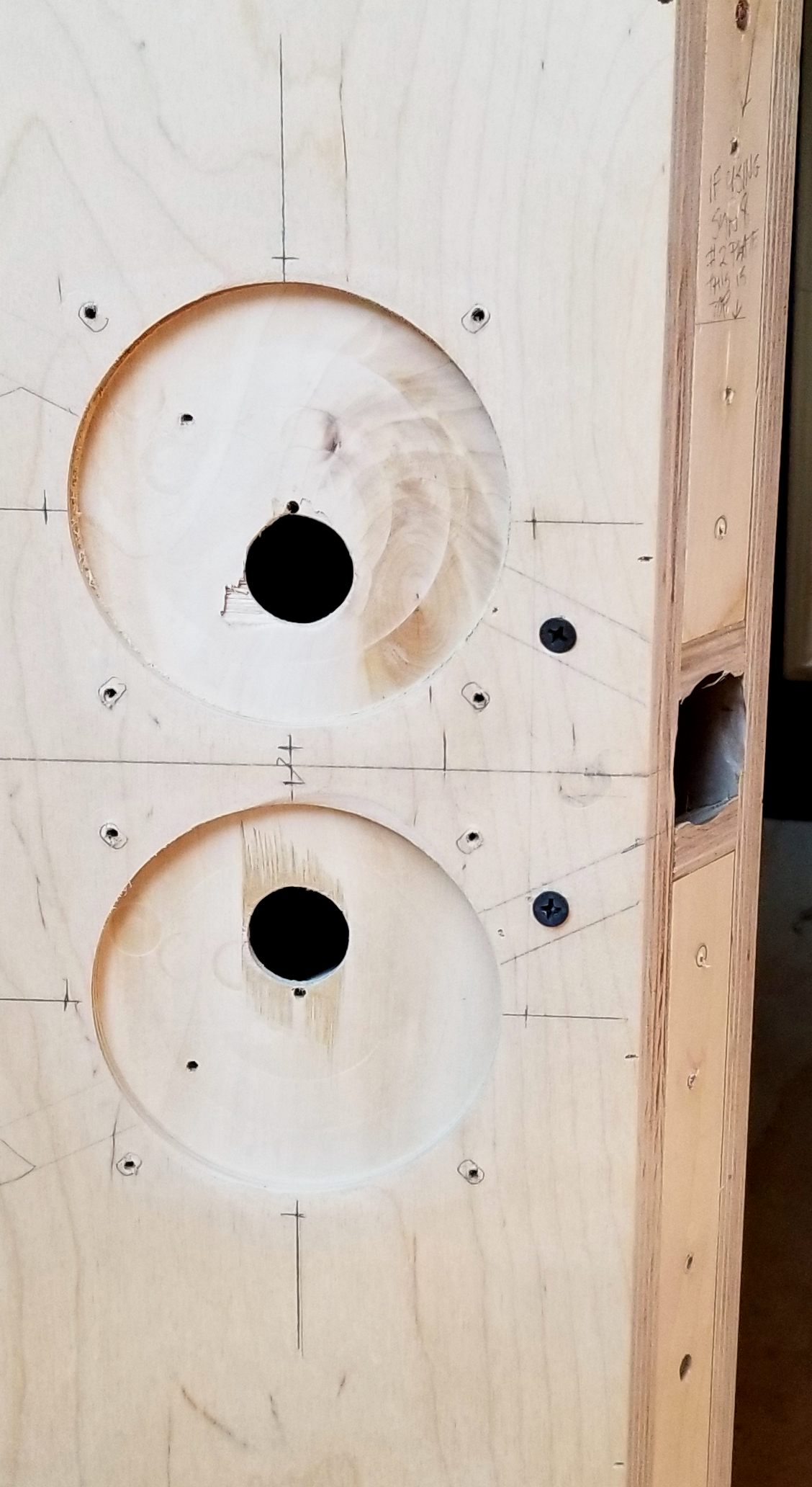

For the 4mdn34's, i recessed 3 7/8" diameter, 6mm deep.
Both to allow for excursion, and to reduce the thickness of the ports. (Horn is 12mm BB)
The ports are 15/16" diameter, with centers at 3 1/2" from throat.
They lie tangent to the horn's top and bottom flares as seen from front view posted earlier.
One quick indoor measurement showed no change to their response when enclosed.
Which surprised me, as I thought something would change....but no....
A similar surprise occurred testing different 12"s.....kappalite 3012LF, faital 12pr320, and rcf mb12n351.....I could not tell their response traces apart.
The horn seems to dominate things somehow....

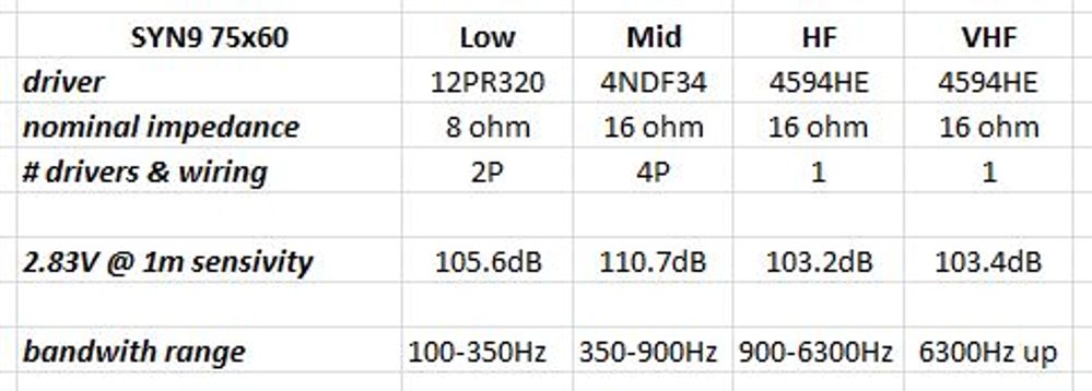

Yeah, the whole phase rotation / summation thingy can get confusing.
The good news imo, is once we start trying things out for ourselves and making measurements, it gets clearer quicker.
Single drivers in open air tend to have natural 2nd order roll-offs on both ends of their bandwidth. With these freq response roll-offs comes 2nd order phase rotation.
(Phase is relatively flat within the drivers in-band reponse where magnitude is relatively flat.)
The mids in a MEH have a steeper HF rolloff than 2nd order due to the acoustic lowpass formed by the reduced air volume between the cone and port.
I get about 30dB down, an octave away from the high corner at around 1kHz, with the 4ndf34's.
Which means a boat load of phase rotation above 1kHz...clearly unusable territory.
So it's important to crossover well below that high corner if trying to use low order IIR crossovers.....simply to have room to tie it to the CD in its flatter mag and phase region.
With steep linear phase xovers, the mids can be used all the way up to the high corner if desired.

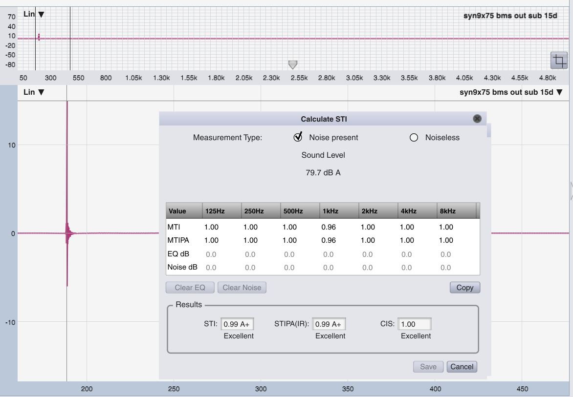

Tried some speech intelligibility measurements, STI and STIPA Speech transmission index - Wikipedia
Got all excited when i measured those great numbers at 3m, so i measured a commercial speaker i use for comparisons, a Meyer UPA-1p, and got the same great numbers.
The Upa's score did degrade faster than the syn9 as i cranked them up, but not enough to make me want to continue with this measurement avenue, for looking for why the syn9 has greater clarity.
Plus, the STI & STIPA measurements require sweeps that are at least 1.6 seconds long and echo slap from any even far off structures becomes unavoidable. And may turn into slaps from neighbors 😱

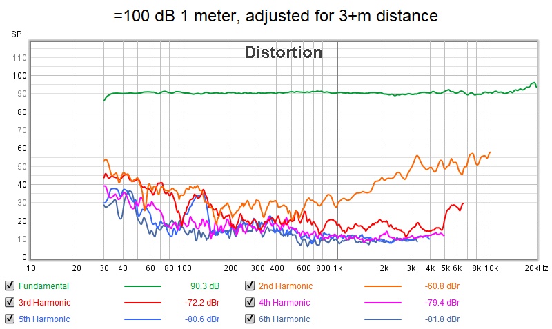

Anyway, here's a good ole THD measurement taken outdoors at a bit over 3m. SPL is correct, so figure the processed fundamental curve is 100dB @1m.
Seems clean for 100dB for sure, but really not that much cleaner than my other builds...so still don't have any solid clues about clarity gains (other than maybe some really good weed Lol 😀)

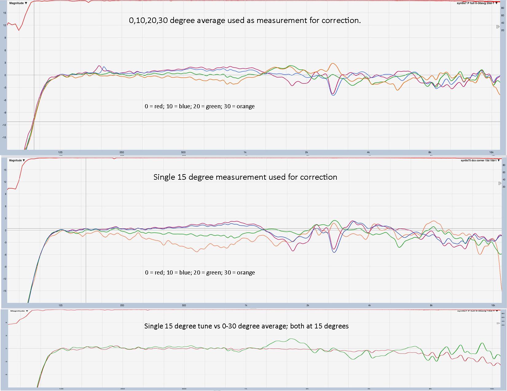

Hi Steffen,
Yeah, i've worked on the syn9.3 polars some, but not too much really as it doesn't make sense to put lots of fine tuning effort into polars until secondary flares are added.
Here's two sets made outdoors, one that used an average of measurements for each driver at 0-30 degree increment, as the refence measurements for drivers' individual corrections.
And the second set that used just a 15 deg off-axis measurement as reference for their corrections.
(Followed by comparison of the two tunings at just 15 deg.)
Don't know what was going on at about 3kHz...hadn't seen those oscillations on quickie indoor polars...blame gating haha....
It was pretty noisy outside ....but I don't think that's their cause ...

The STI/STIPA is a standard for speech intelligibility often required in public address systems that may be needed in emergencies. (see the wiki link gave earlier).
It uses modulated tone bursts, in an on & off type fashion, to provide a score.
Since the syn9.3 clarity improvement has been most noticeable with lead and backing vocals, i thought a measure of speech intelligibility might be worth a try.
Plus, the second aspect of improved clarity, is the quietness surrounding the music. It's funny, but v9.3 sounds both quieter with louder transients at the same time, and with an overall sense of making less average SPL.
I keep turning up the volume, and it stays great sounding (as in better and better)..without sounding loud.
But when i put the SPL meter on it, it's like wow this is really measuring louder than i would have expected.

That is a lot! Then I am wondering, what output are we talking in SPL/1W/1m for those four 4NDF34 16 ohm speakers in parallel? Do you have any estimate? Is it about as hysterically loud as the CD in its optimum passband?
Here you go...just measured sensitivity as i've been a little curious about the 4NDF34's myself.
I measure sensitivity with processing in place for the intended bandwidth.
Pink noise is used, and both SPL and driver voltage are time-average measured over the exact same time interval.
It's the most real world way to assess sensitivity i know of...but always looking for a better way if someone has one to offer.
Anyway, here's a chart using the bms CD, at 1m from horn mouth.
Note it's all at 2.83V,......no matter the nom impedances.
The 4NDF34's looked so dang high, i measured a single one on a small open baffle for a sanity check, and got 91.9dB, right in line with B&C's spec of 92dB.
4 of them should raise best case theory sensitivity by +12dB, to 104dB.
But in the 75x60 horn, it's measuring over 110 dB...so it looks like the horn is loading them for sure...using 'loading' in a true sense of the word Lol
