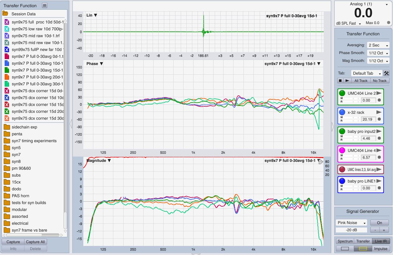

Here's the one outdoor tuning i've pulled off on the 4-way 75x60...(been too busy listening to measure much 😀)
The raw response of each driver section which was corrected, came from an average of 0,10,20, and 30 degrees horizontal.
No further fine tuning was done, and it still needs secondary flares to help improve polars. Not sure that will matter much though. (getting less convinced about the supremacy of CEA2034 simply from the profound change in adding the small mids). Oh, Traces only go to 30 degrees...more to be done as always, including verticals.

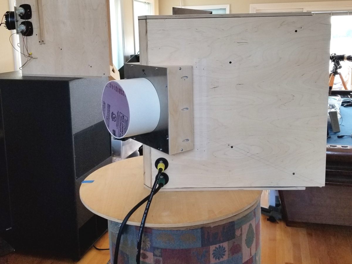

Just finished enclosing the four 4" mids. They were open to the back for the measurements above. A quick indoor raw meas showed negligible difference, if any, open vs enclosed.
Used the CD mounting plate to help form the small mid enclosures.
And added a thin PVC end cap to slip onto the CD.
Whole shebang to enclose the mids and CD weighs a little over a kilo!

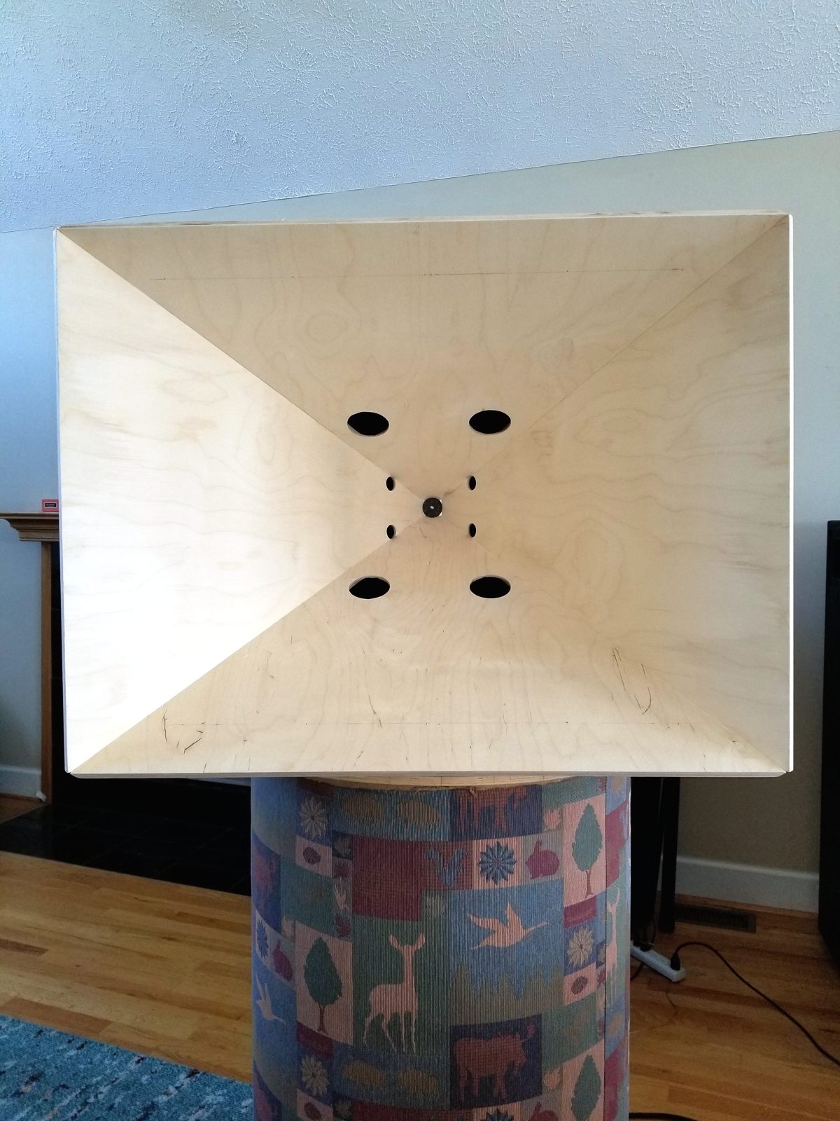

Hi Mark
That looks good. Very compact!
Could you provide a front-picture of the 75x60 horn, to see the port-holes.
I tried to find the post, where you specify the port-hole-diameters and their axial distance from the throat. It´s a bit mixed up. Maybe you could make a short write up of the most important details of Syn9v3?

Thanks Steffen,
Here ya go. 75x60 v3
Sorry for any version mingling/confusion in this thread.
It's the same pict as posted in #68, which gives port details.
Also see post #60 for 12" backside recess routing etc.
Please keep in mind, the 75x60 pattern is driven by the top and bottom 12" driver mounting strategy, that allows horn side walls to double as cabinet walls to save weight.
(If you don't care about weight, to heck with the strategy.)
Any smaller H pattern messes up getting the 12"s in when trying to keep 12" ports close to side walls.
With a narrower H, the 12" drivers get pushed out more towards the mouth, moving the ports farther from throat.
(But a single horn-centered port can fix that issue.)

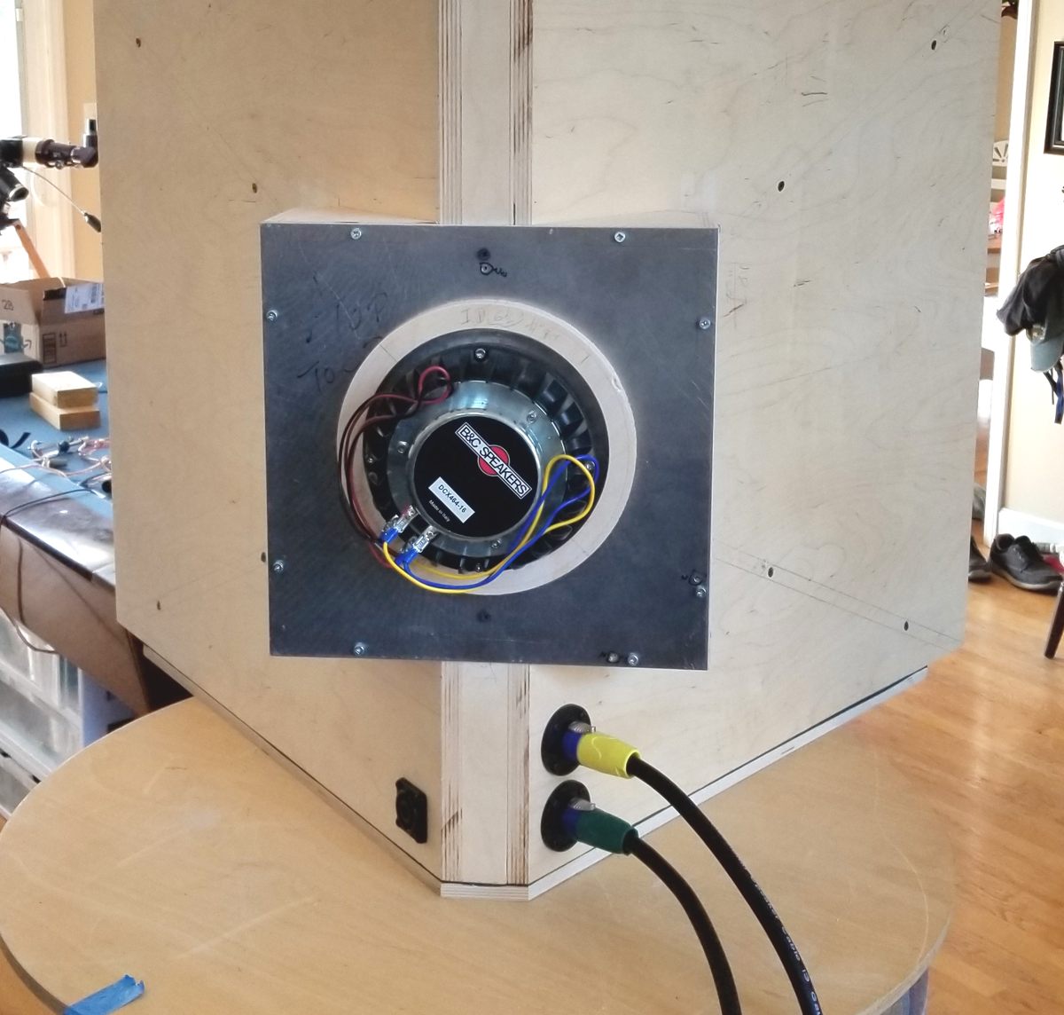

Hi Again Mark
Do you have a picture of the backside of the horn, where the midrange-drivers are mounted. Just curious how you did the routing and backside of the ports.
Also, did the enclosure of the midranges do anything to the lower roll-off of the midrange-drivers, shape of roll-off, frequency?
