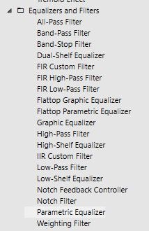

Yes, you could string together virtually as many EQs component as you want. By EQ, i mean a single Parametric Equalizer component:I should have read your comments much more carefully at the time; but I have, now. Three key questions -
the multiple EQ curves
.. which would be created separately - ie the room curve, a Harman type curve, etc ..
You said you can easily create a separate EQ bank for each of those tasks (with presets for each bank) - but can it add those curves - and run the 2/3/ 4 of them simultaneously?
From QSys help file: The Parametric Equalizer is a variable equalizer allowing you to individually adjust the Gain, Bandwidth and center Frequency of up to 32 frequency bands. You can also Bypass individual bands. Master controls, affecting all bands, include Bypass, Invert, Mute and Gain. Additionally, you can change any or all of the bands to either a high or low-shelf equalizer, allowing you to vary the gain of all frequencies, as a group, above or below a selected frequency. At the selected Frequency, the gain changes approximately +3dB or -3dB depending on whether the shelf is adding or reducing gain.
Presets can be made to turn any on or off, or change values within a single component.
Here's a list of available EQ type components
