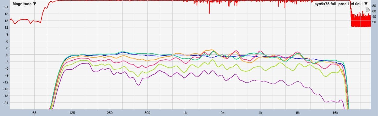

Here's a set from the 75x60.
Blue is 10 degrees off-axis and was the tuning axis.
Dark green 0 deg. Orange is 20 deg. Red is 30 deg.
So all those traces fit within the horizontal horn pattern. Little drop in SPL.
Light green 40 deg, and purple 50 deg, are outside the horns pattern, but still plenty of SPL i think.

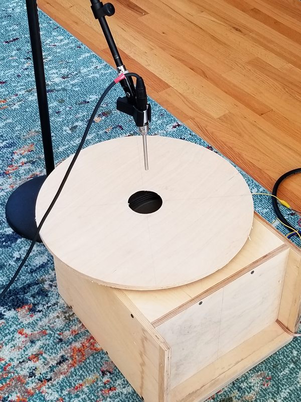

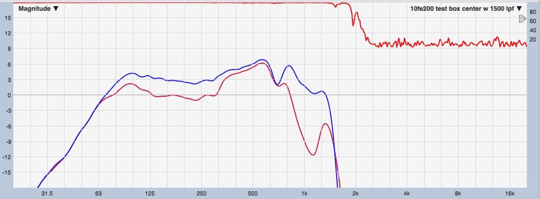

Ok, as a result of low driver port location discussion, i set up my most basic port test box again, which is simply a small sealed box that i can lay a plate with port holes over the driver wherever desired.
Nothing fancy... just this sitting on the floor.
Driver is 10fe200. Port is 2 7/8" dia.
Blue trace is port centered on cone. Red is port edge over surround edge.
It's just a one port test. I've had similar results trying different sizes and number of ports.
A single centered port has always had the relatively best overall looking trace.

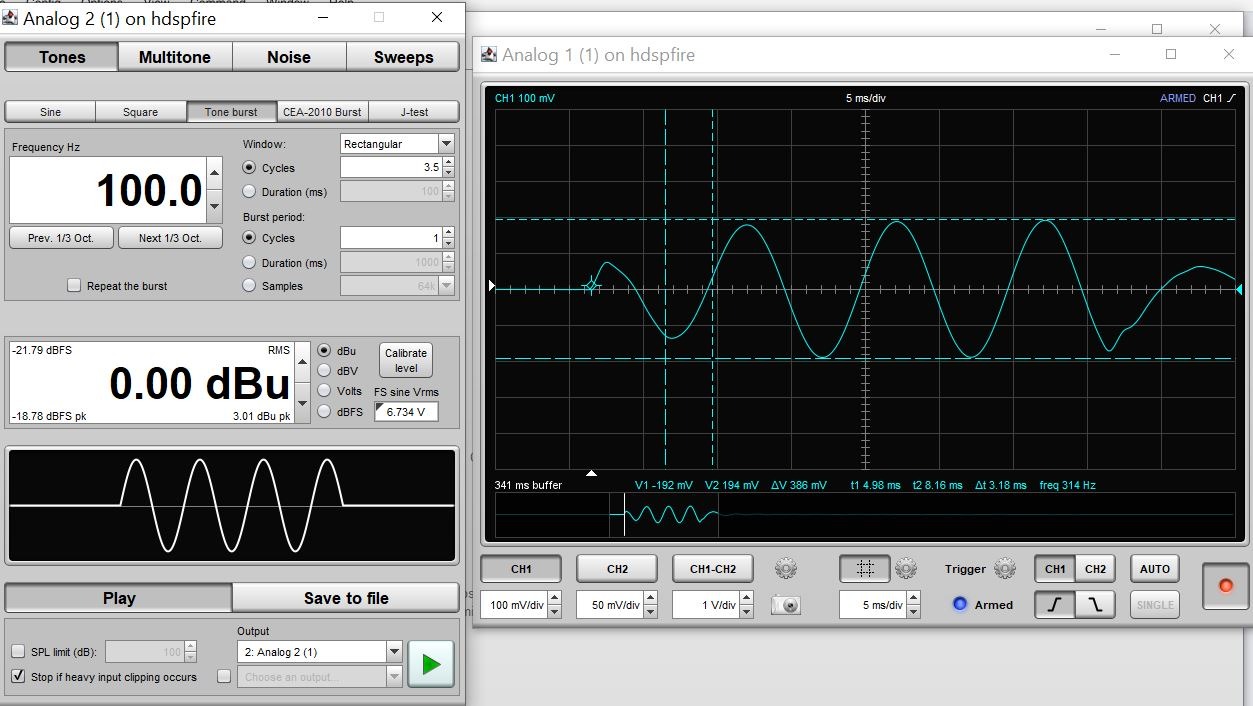

Trying to dig a little deeper, went to REW's burst generator and scope.
Here's edge first, then centered.
Peak to peak voltage, gives centered +2.2 dB.
REW's peak SPL meter gave +2.3 dB.
Both of which tie closely to Smaart's magnitude trace, i think.
Anyway, thought this might be of interest...and i must admit, i'm still looking for reasons to put low ports in the corners...

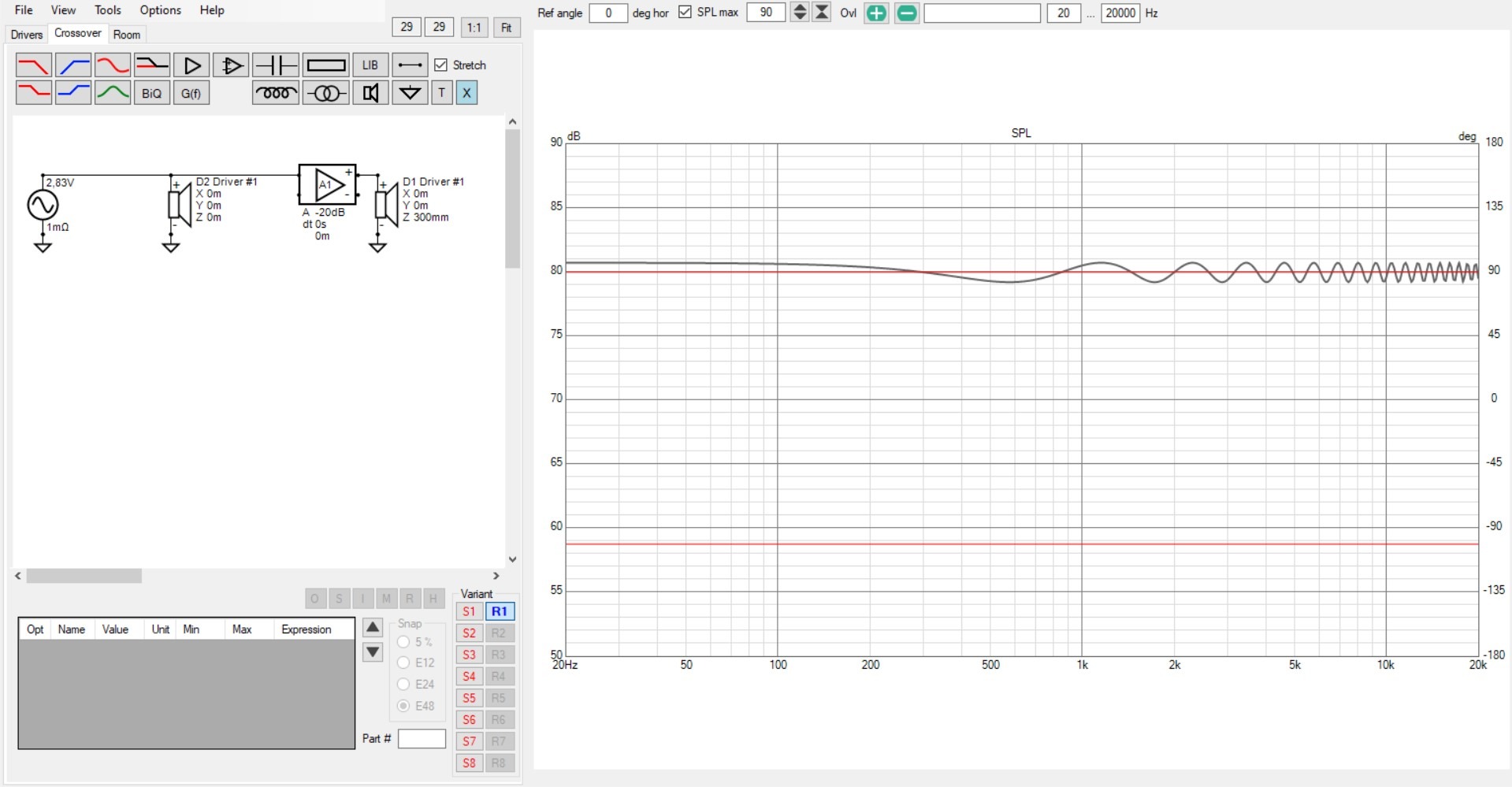

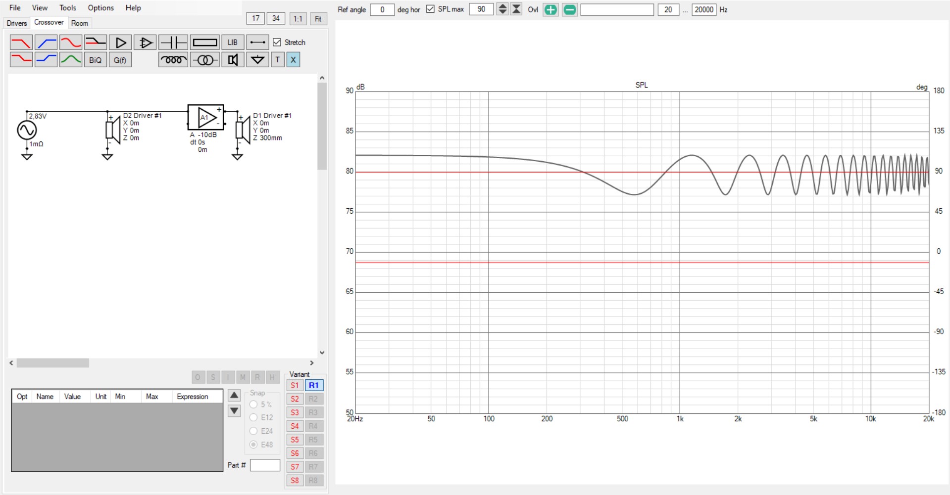

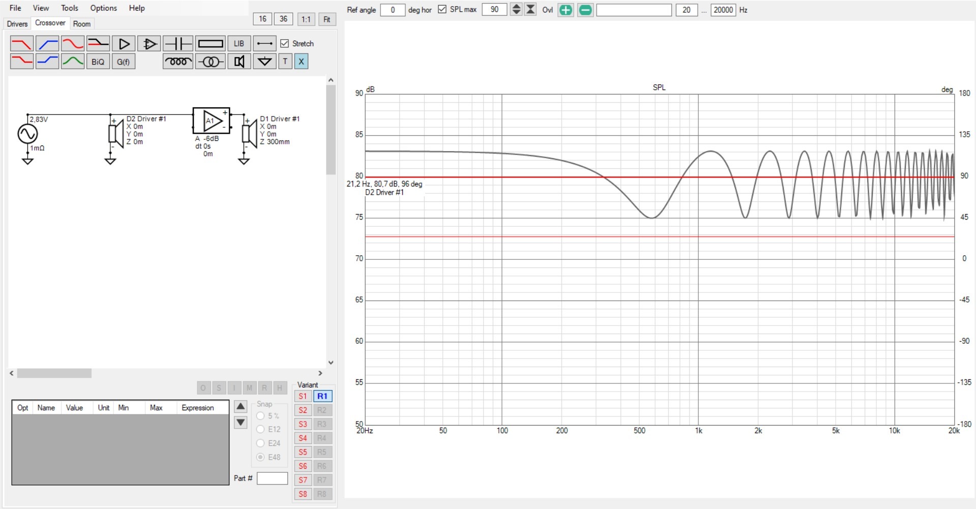

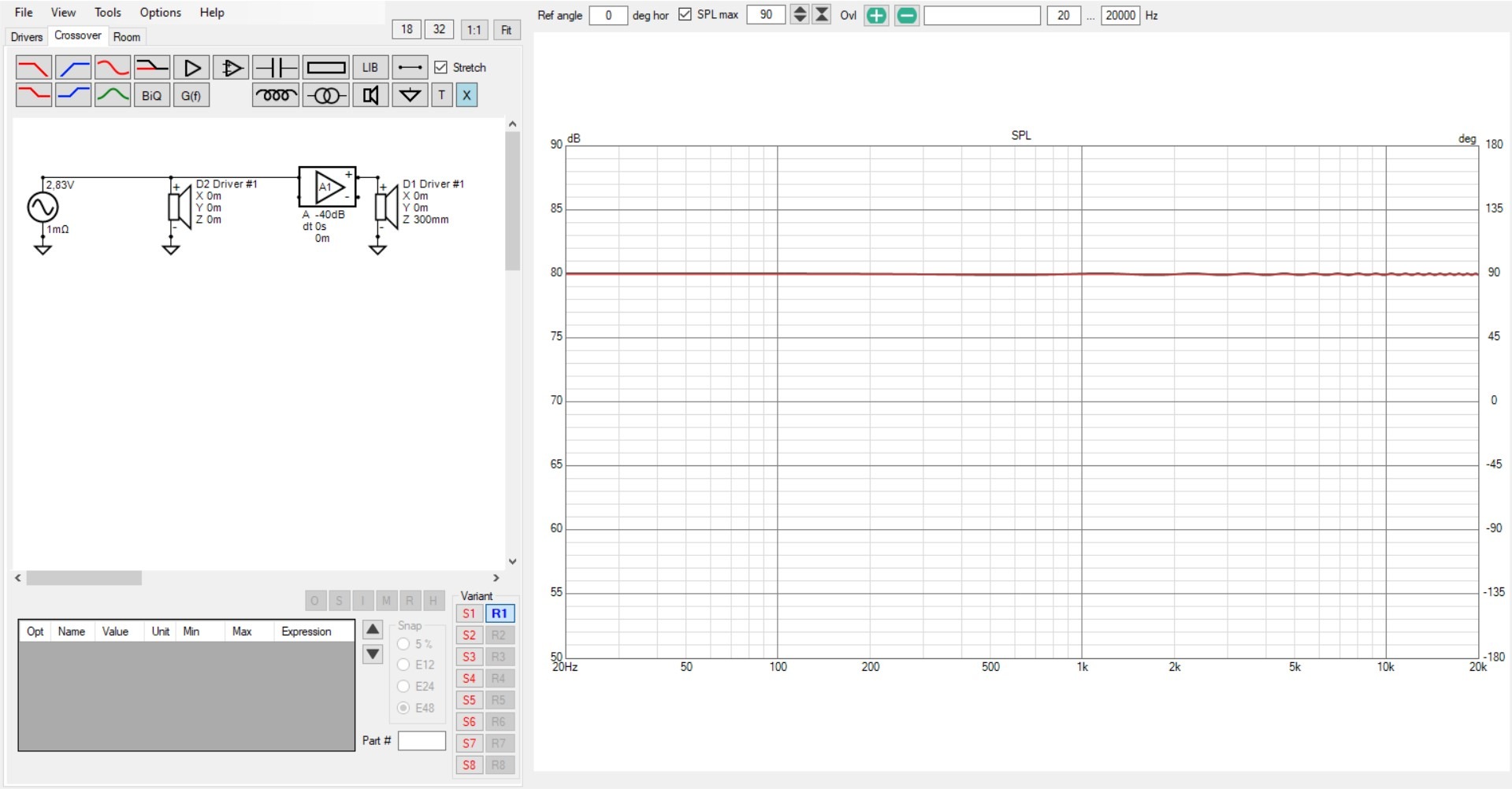

Simple test of "single ideal reflection" that combines to direct signal at ear attached. It looks like without attenuation 6dB peaks occur, naturally. To get the interference pattern down to +/-3dB the reflection needs to be attenuated about 10dB. Maybe there is proper math to this, but the very quick test in simulator is visual and thus easy to understand so I won't bother with math 😀I'd be curious how the polars differed. Perhaps the sound didn't change because off axis the SPL was so low it didn't contribute meaningfully to the combined SPL at the listening position? So a little more ripple might not be audible? I just don't know how low that off axis energy needs to be to behave this way.
If reflection point is close to source, then there is not much attenuation through air since path length is not that much longer than with direct sound, and heavy narrowing in directivity towards reflection point would be needed to reduce "problem". However, if the path length through the reflection is double to direct sound path length to ear then there is already 6db attenuation on the reflection without any help from speaker directivity. Add some kind of speaker directivity, count in some attenuation on the wall, and -10dB is not too hard to achieve in reality.
Nominal dispersion of 90 degrees horizontal would mean -6dB towards 45 degree angle. If such speaker is toed in (horizontal) reflection point could be at 90 degrees or more, which gets to attenuation around -20dB towards reflection point, which gets the interference to +/-1dB. If there is problem with reflections in this simplified thought experiment in context with full range waveguide, it is with floor and ceiling since those would have relatively low angle towards reflection.
Devil is in the detail! Very good products that have been optimized for particular application would have all (at least most) the details inline with the goal and ours might differ and require different approach for better outcome if the goal was something else (than max SPL in this case).You're welcome!
