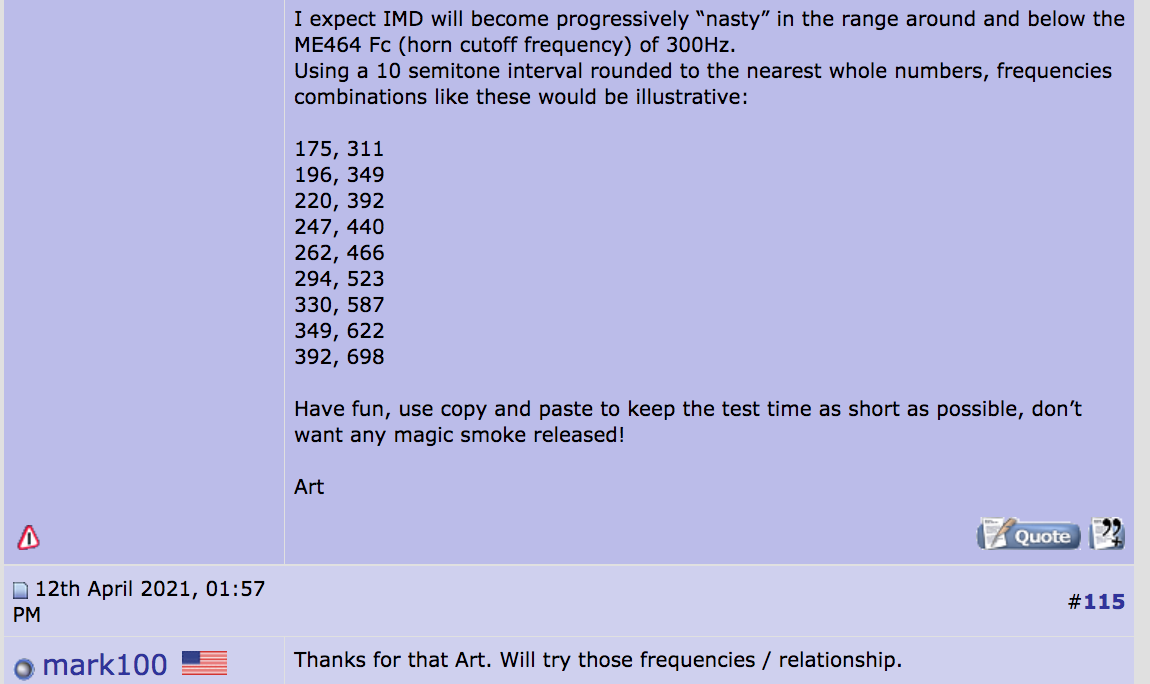

Mark,
Yes, had been hoping you'd do those IMD measurements we wrote about last April 😉.
Art
Haha Art, yes...i totally forgot about that project. (and forgot where the idea that IMD might be the culprit came from....from YOUR measurements 🙂)

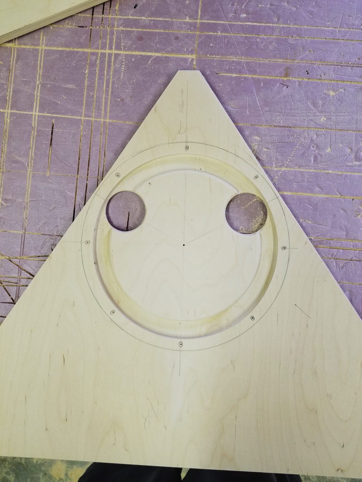

The dilemma that ports for a single large cone liked to be close to the throat for raising the cone's response up to the CD, but away from the throat for lowering the cone's response down to the sub became ever more obvious as experimentation continued.
At the same time, the talk of the new DSL Hyperion, with TomD's participation on ASR was going on. Mentions of the SH-50, how it can be (favorably) difficult to aurally locate, kept popping up.
My existing syns sometimes, but more to the rarely side, display that property.
When i added in my sometimes complaint of harshness with increasing SPL....

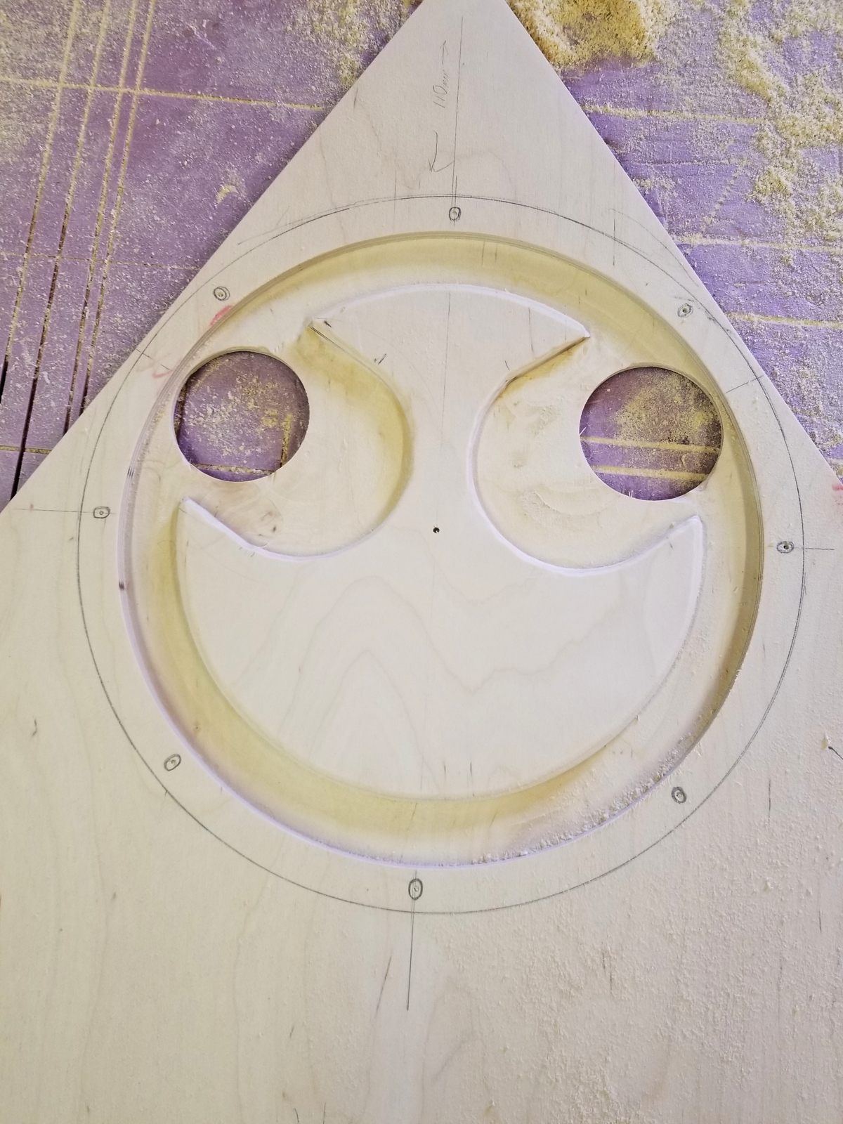

Well, i said screw it, time to try some small mids...allows better port placement for the large driver, and takes some of the load off the CD's lower end, and who knows...maybe helps with the magic.
I was speculating that using the CD too low is the source of the harness because I've cranked the CDs bigtime in other traditional builds crossed higher, without any trace of harshness.
You may be right about the lack of low end loading on the CD in the syn horns...maybe small signal response curves are simply not giving the full picture.
Anyway again, so i plugged up the test horn's holes that was being used in the Klipsch forum thread, and slapped some pretty cheap drivers on it, just looking for any improvements for any of the three issues. (lack of low end loading, sometimes harsh, and not enough of an aural disappearing act)
All three improved ! And I'm still shaking my head in a bit of disbelief about how much clarity was also gained.
So I built a 60x60 with better drivers. It's even clearer, but i screwed up the low ports by accidentally putting them too far out in the mouth.
The little 10fe200's in the old proto horn have a better bottom end than the 12pr320s in the 60x60.
I also don't like the 60 degree horiz pattern, compared to the 90 degree pattern of the proto.
(i move around alot...gave up sweet spot stereo along time ago, and remain very happy doing so !)
Ok, yet another build in progress.
I need a 60 degree vertical pattern to be able to mount the 12"s on the top and bottom of the horn (huge weight savings vs enclosing the entire horn in a box).
I've debated how far to take the horizontal pattern towards 90 degrees, because the 60x60 is a little clearer.
So under construction is a split-the-difference 75x60, using the better drivers.

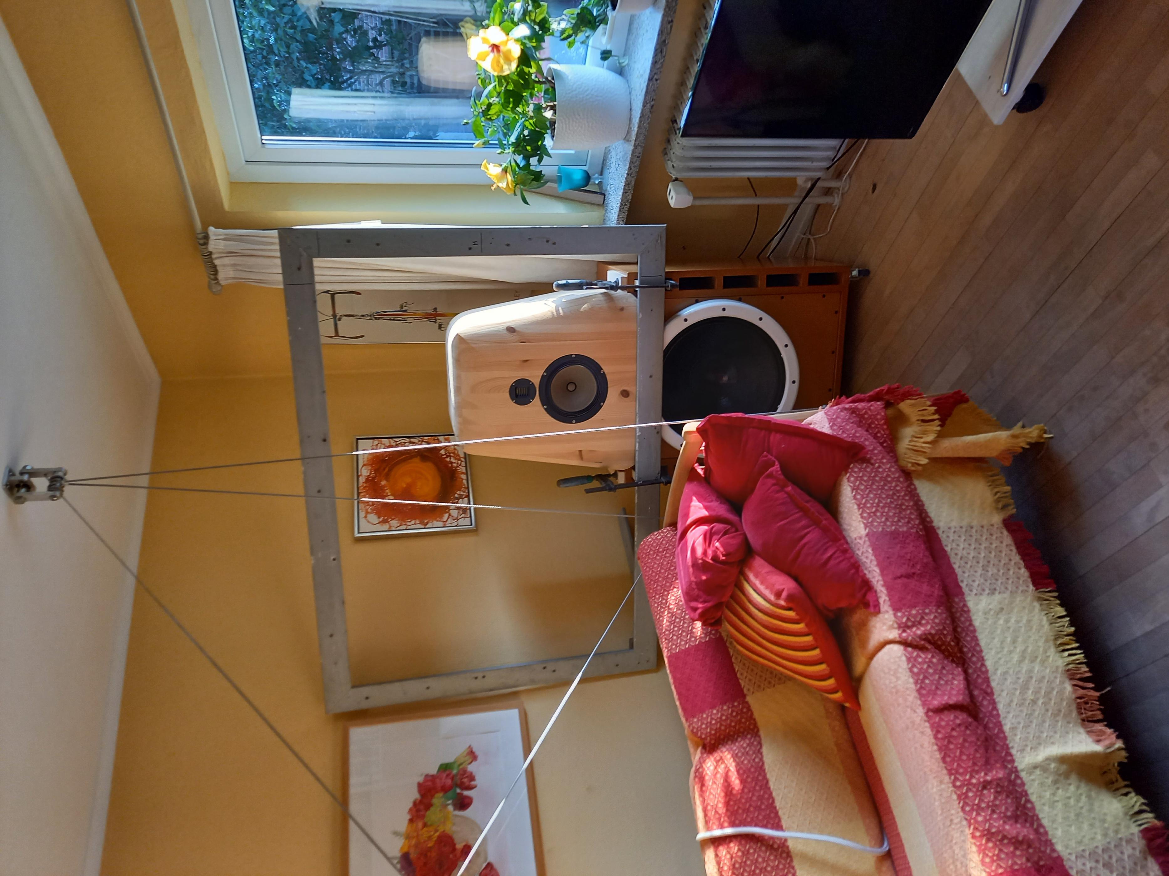

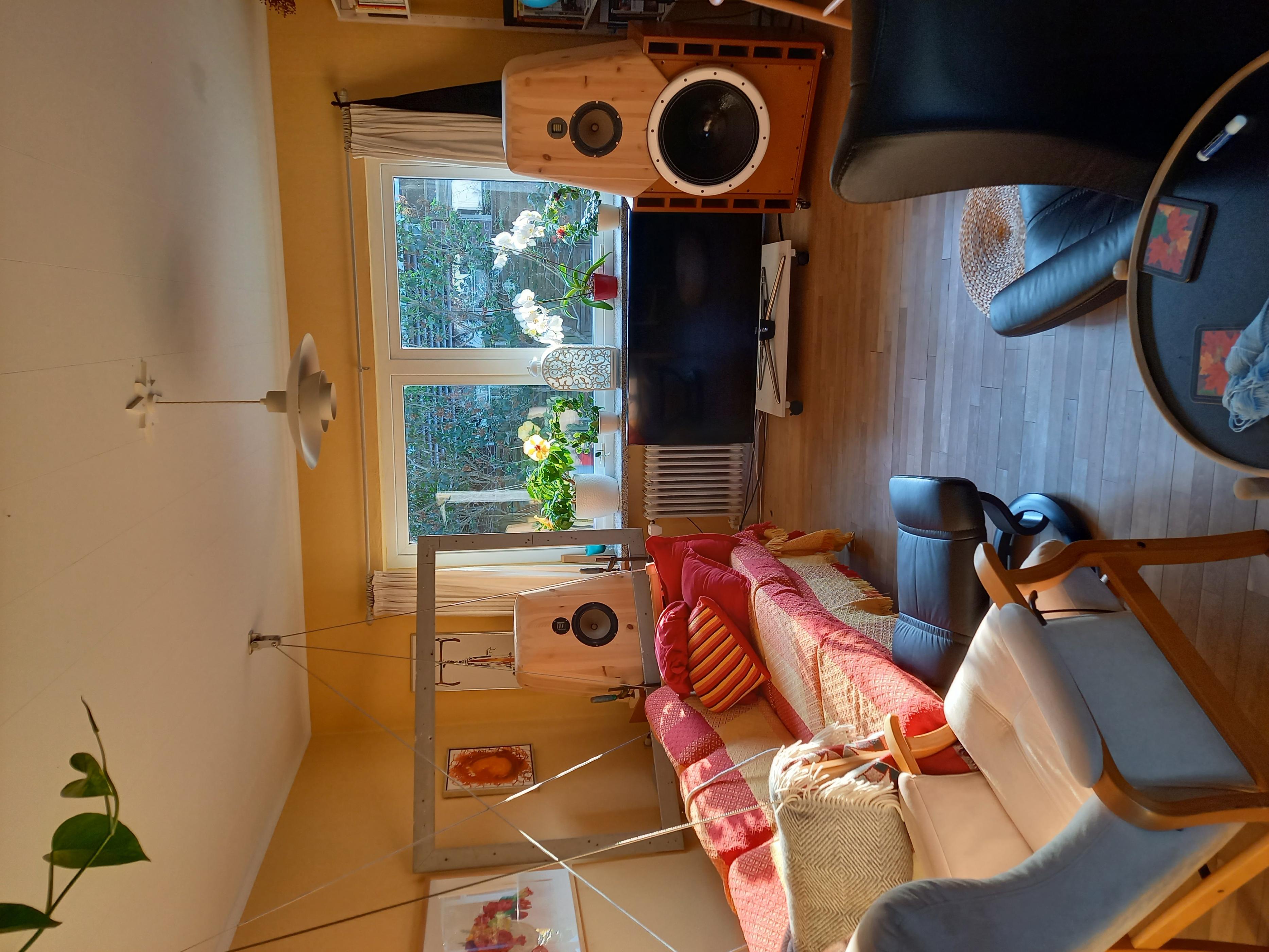

I have been drawing some sketches and started some kind of log-book with ideas and decisions I make along the way.
I had a stress-breakdown this spring, and my brain almost stopped working! So some projects in my house that I need to finish before building horns got on full stop. I have only recently taken up small projects again in small steps. One of the projects is to clear a room in my basement to become my horn-workshop. That implies some plumbing and electrical work as it is the washing room I am moving upstairs.
I walk a lot and mostly have synergies on my brain. I´m pretty visual, so I can build in my mind while walking and can turn the horn around to tinker with how to do. When I have had a good idea, I write it down in my book for later. Thinking on paper is a good thing too!
Recently I made a real life experiment, building a wood-frame to see if a 80x60 horn 59"x43"would fit into my room, up against the sidewalls. Well, I and my wife looked at it a while, and decided to shrink it 10% to be only 135 cm (53") wide 😀. Maybe I can manage to upload a picture of the mockup.
I have to go now.
Steffen

An idea for you to try maybe? In my sketch I made two smaller woofer-ports for the 15" woofers, instead of one bigger one, placed so that they kind of divide the area of the sound-bubble i four equal spaces, seen from the front. I have some idea/hunch that this will pressurize the sound-bubble most symmetrically!? It could also be an alternative to placing the portholes in the corners, where 1/4 wave-lenght distance (horizontally) begins to restrict, how far out the ports can be placed!? Just another thought.
Interesting you bring that idea up 🙂
Here's the back side of the top and bottom horn flares which mount the 12"s, that i made yesterday for the 75x60 underway..
I must admit though, I'm only trying it to see....I quit thinking about what kinda wave comes out of what a while back...simply seems too theoretical, or rather too far deep below real world signal to noise....

A little more work done on 12" ports for flow...now ready to reassemble horn 🙂
