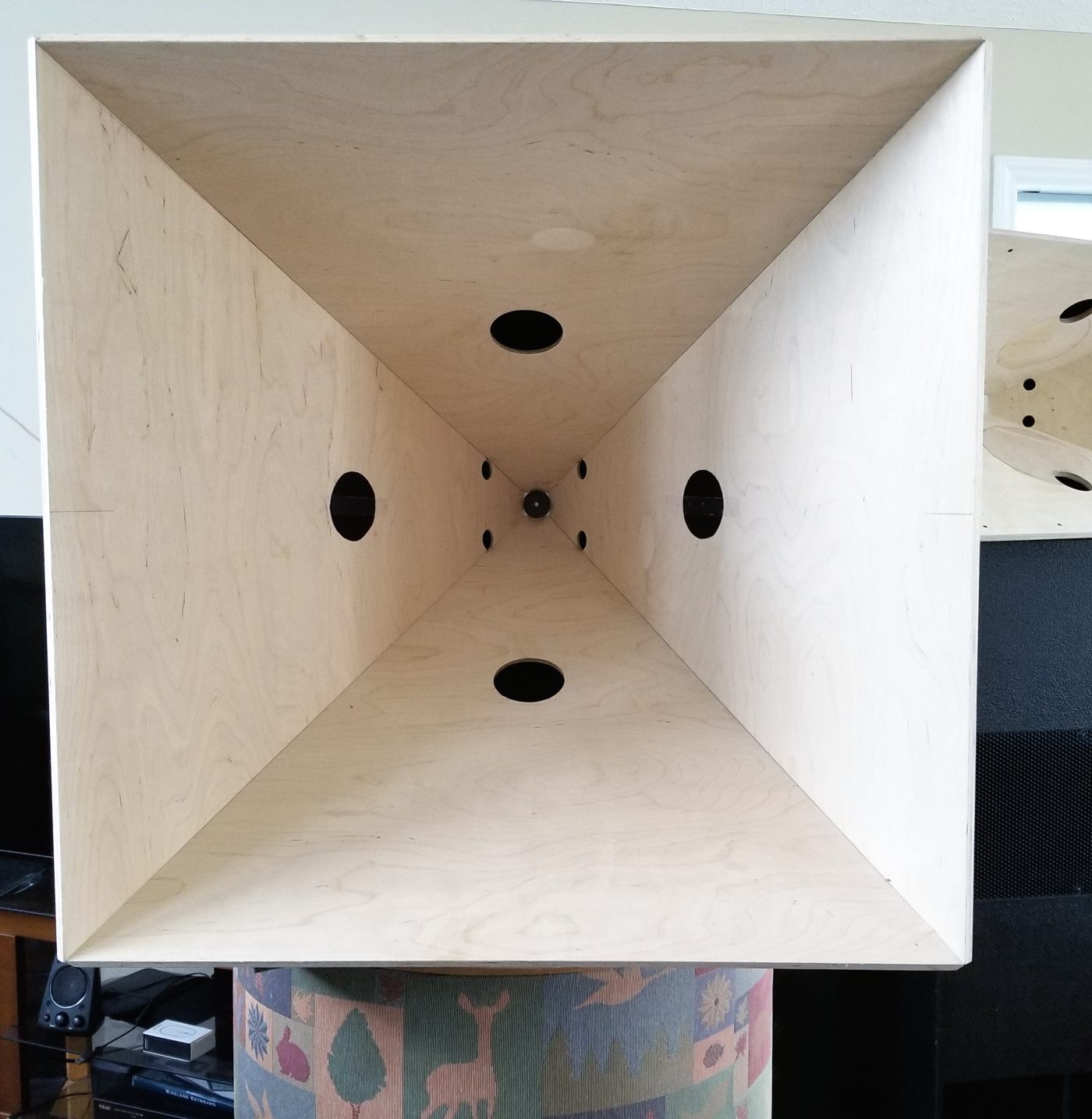

Got some observations on the 60x60 current project, also using small mids along with low reaching CD. (and stronger low end drivers with their own ports location)
The small mids (four 4NDF34) work very well on this one, just like the 90x60 proto. Takes the sometimes harsh sound away from using the DCX464 down to 500Hz.
Tried taking the mid to CD xover to 900Hz, but simply lost clarity.
Now using tried and true 650Hz xover freq. Beautiful & natural detail. Vocals I've never heard before.
The little B&C mids really crank ! 200Hz would be fine. Currently crossing at 250Hz. (have four 16ohm in parallel.)
Win #1 🙂
The low drivers, kappalite 3102LFs, easily reach down to 100Hz sealed.
Down to 85Hz is no problem, and still playing with best sub xover freq.
All i know for sure is it will be 100Hz or less.
Win #2 🙂
The 60x60 conical with no secondary flare, kinda doubles up the oscillations in the 1-2kHz range that have been there on every build I've made. (Secondary flares have always cut it at least by half).
All the other builds had aspect ratios of 1.5:1, so only one set of walls (the side walls) appeared to make the disturbance. Now both sets appear to.
It also makes a tight no-mans land around dead on-axis H &V.
Forget measuring there haha. But get only 5 deg off and things get better quickly.
I've learned to make 10 degrees off axis the tuning reference on all the 1.5 aspect horns. I've learned to make 10 deg off both the H&V axis for this symmetrical 60x60.
The overriding reason to go to a 60x60 was to fit the taller kappalites in the lightweight type box i like. This made a larger sealed chamber than desired, but i thought that's OK, especially if i need to add reflex ports which will be helped by volume.
Since the drivers work fine sealed, I now wish the box height and sealed volume were smaller (back to like in 1.5 aspect), but it will take a different driver.
Also, the larger sealed space made rougher raw response traces than I've seen before...so much so, I swapped in some md12n351's to compare to the kappa's. Exact same response practically. I'm gonna call PE today and maybe work out a swap..
Loss #1 🙁
The sound...every bit as detailed and clear as the 90x60 proto...probably even a little more so. Certainly capable of greater clean SPL.
The 'magic factor'...is definitely there like the beater proto. The proto seemed (by memory)to have a little wider magic listening window than the 60x60. Will need to compare more here.
With either one, listening right around the 10 degree reference tuning axis is just plain wowsville !! (for me 🙂
Nice Tie #1 😉
Anyway, right now I'm quite sold on adding small mids..
Oh, the dark circles that look like 12" ports are just pieces of cardboard added for visual symmetry effect. Without them, the ports in top and bottom created a strong optical illusion that made the box look extra weird, made it look taller than square when the mind knew it couldn't be. haha

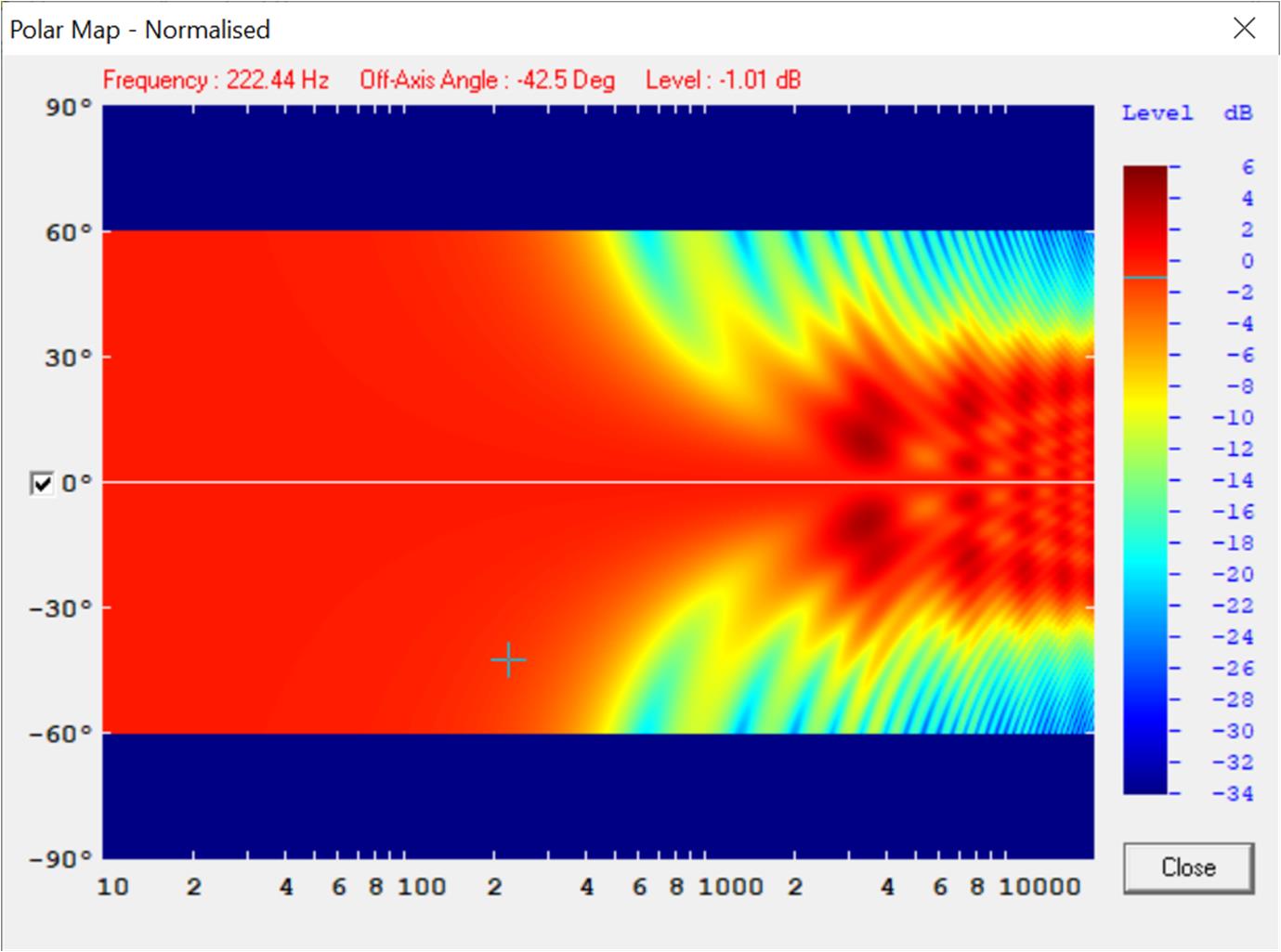

HR can calculate directivity for a single segment conical but not if there is more than 1 segment. This polar map likely explains the variation with angles you've seen. In the sim which I did several years ago, the horn had a mouth area of 2753 cm2, ~20" on a side, and a depth of 45cm
attachment.php

For 650hz cross point how far is the midports from the horn throat?
Thx

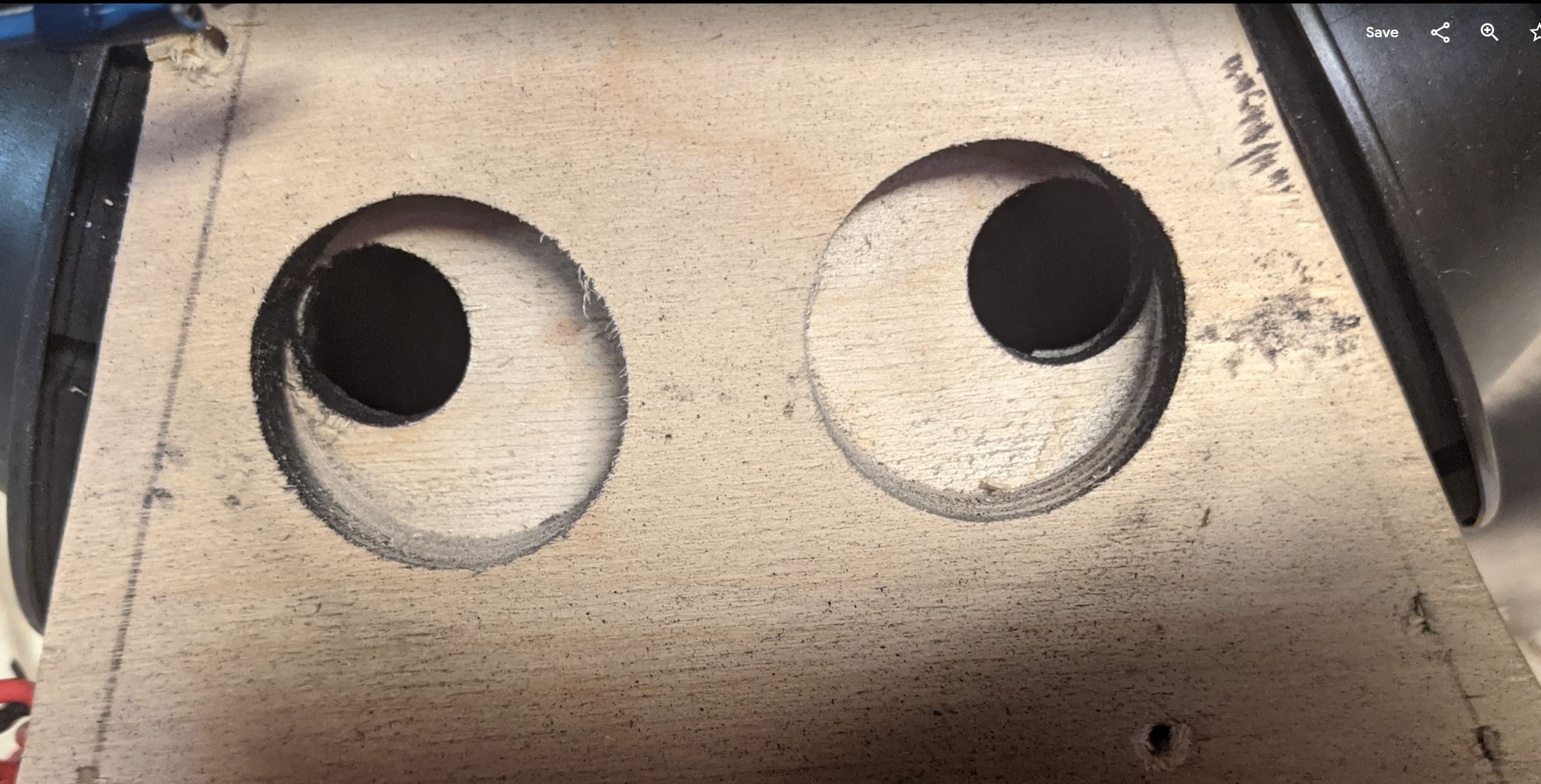

The two boxes in this thread use a single 15/16" hole per driver, 3.5" center from throat.
Good to at least 1kHz, maybe 1.1kHz.
i think 4.5-5" should work pretty easily to 650Hz..
Oh btw, you know all the attention that's sometimes given to putting frustums and such on the ports...?
Here's what a master (not me! 🙂) did in that regard...i love it, my kind of easy!
Yeppers, makes sense...
I'm guessing that sim was for something fortuitously close to a 60x60...?
For the 1k to 2kHz region, it's interesting how the sim shows 0 deg on-axis as pretty much OK. On-ax is where i find the shakiest response (within +/- 20 deg.
I think you might have missed the legend on the graph that says "Normalized" 😉

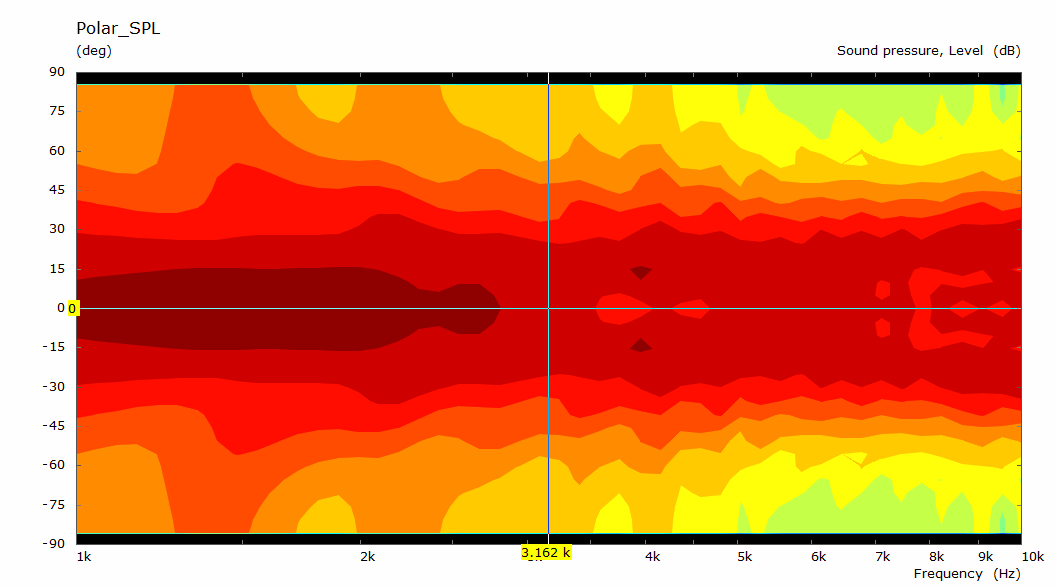

This is the non normalized polar from my 50x50 simulation with no secondary flare, 1 to 2K is messy for sure. This also in an infinite baffle so free air would be worse.
attachment.php

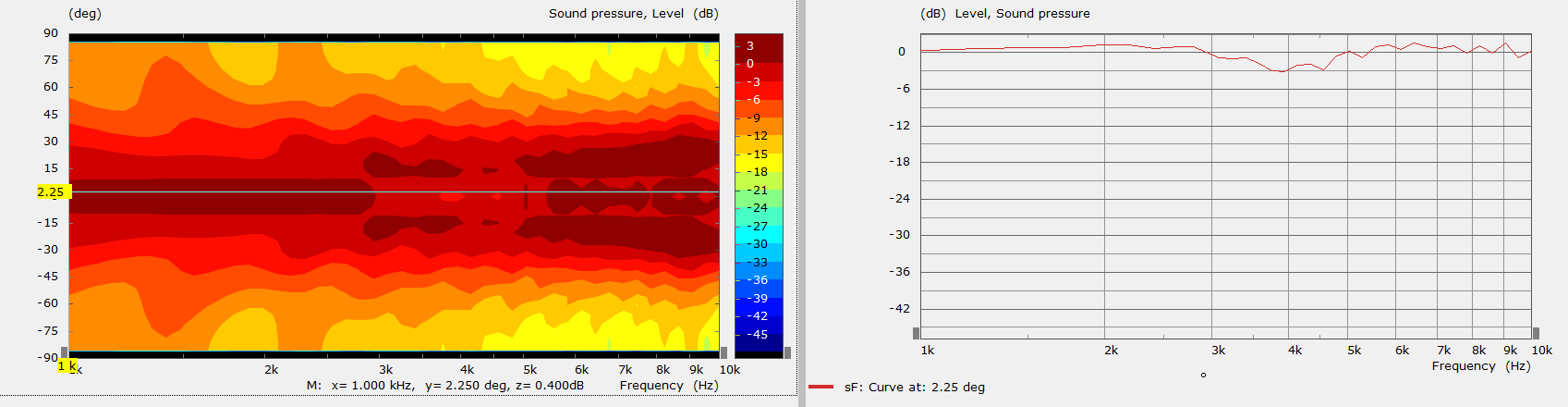

This is normalized to 10 degrees with the on axis response SPL response shown to the right. Attached below due to image size.
Interesting that you find the mids better over a limited bandwidth.
I'm also thinking that the audible difference between a horn with and without a secondary flare would point to how much value to place on improving the directivity smoothness.
Not the first thing I've missed, huh? 😱😀

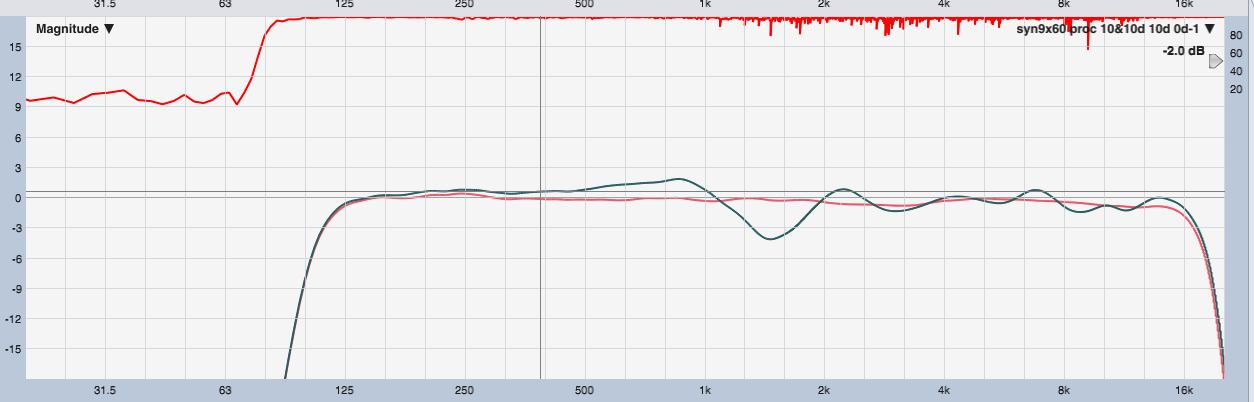

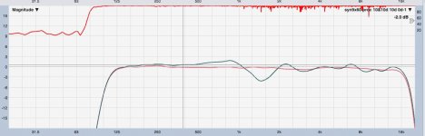

Here's measurements of tuning made to 10 deg horizontal and 10 deg vertical (red trace), vs on-axis.
Not the best measurements though...made indoors about 1.5m....all the things i advise not to do, haha.
Yep. I don't know what to think yet. I'm not at all convinced the secondary flares with improved polars, are making a real audible difference. But then again, like we were talking, it's hard to isolate that variable.
The thing that gets me, is how adding the small mids has made for such an audible difference.
My other syn builds using a single sized cone to CD, and with secondary flares, have better polar sets... for sure.
But they don't sound quite as real... for sure, too.
Audio is fun...keeps me guessing Lol
