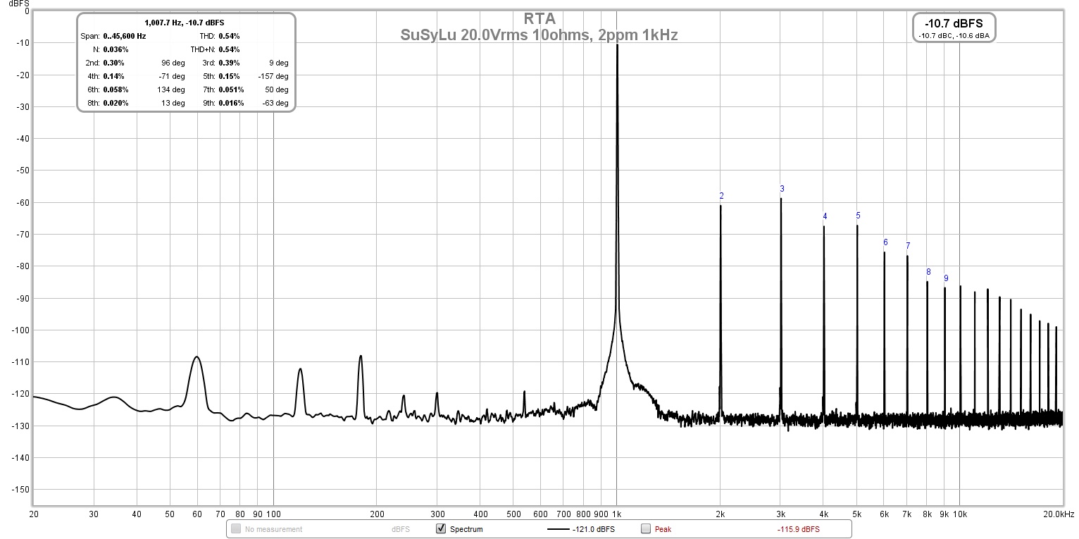

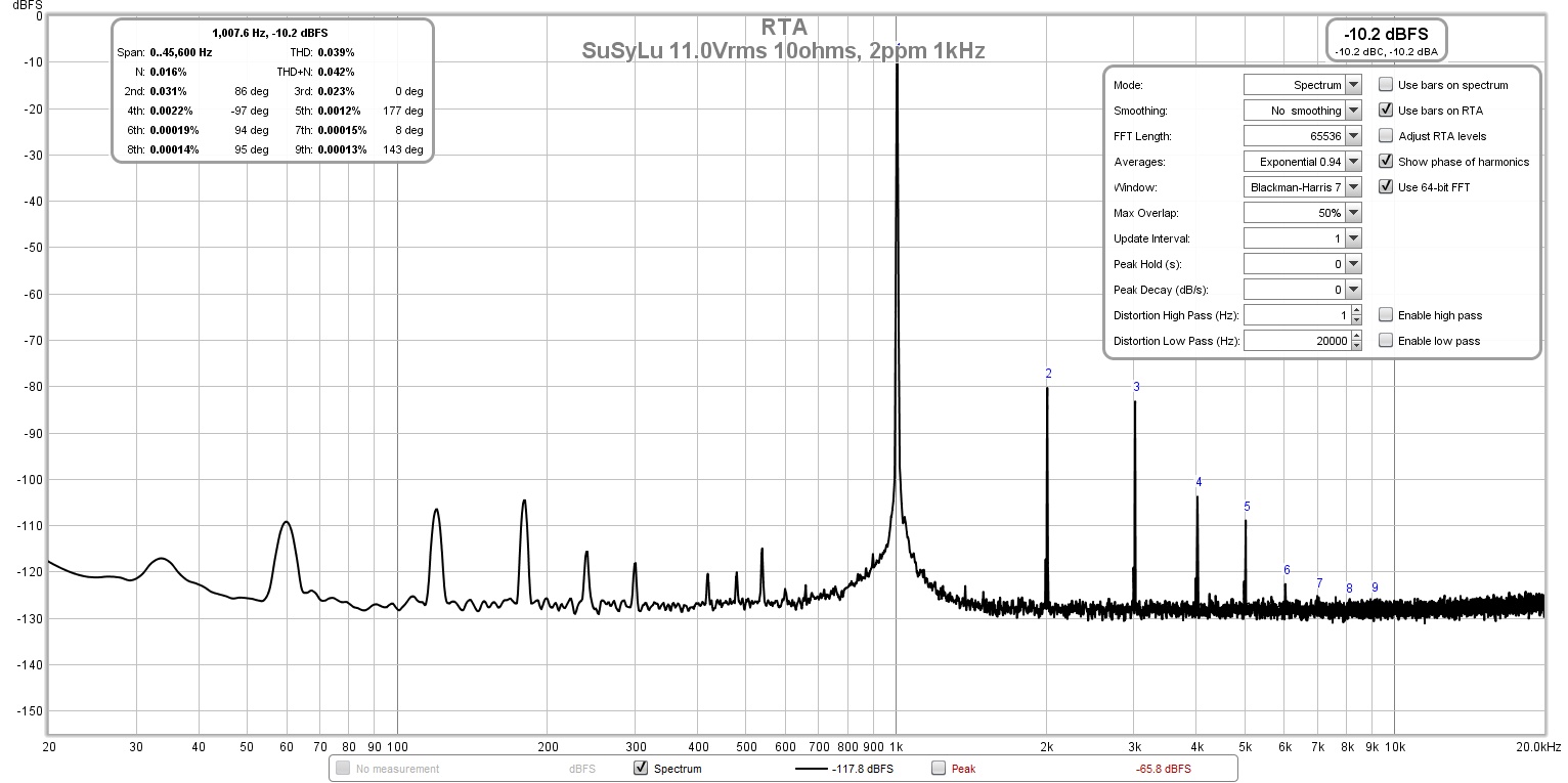

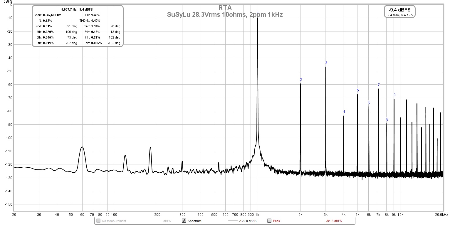

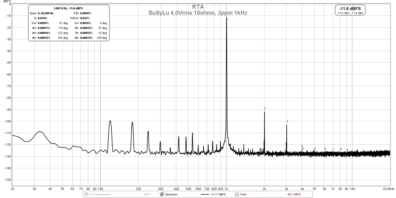

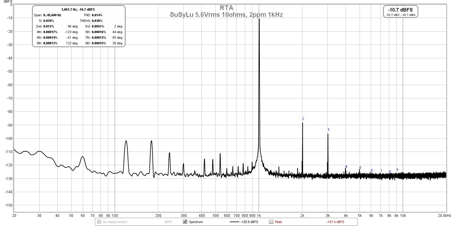

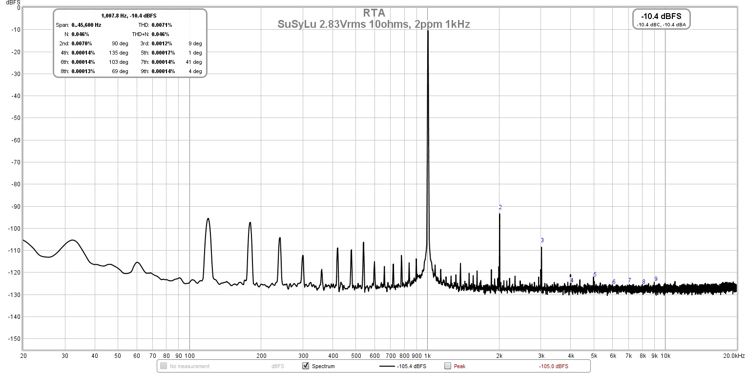

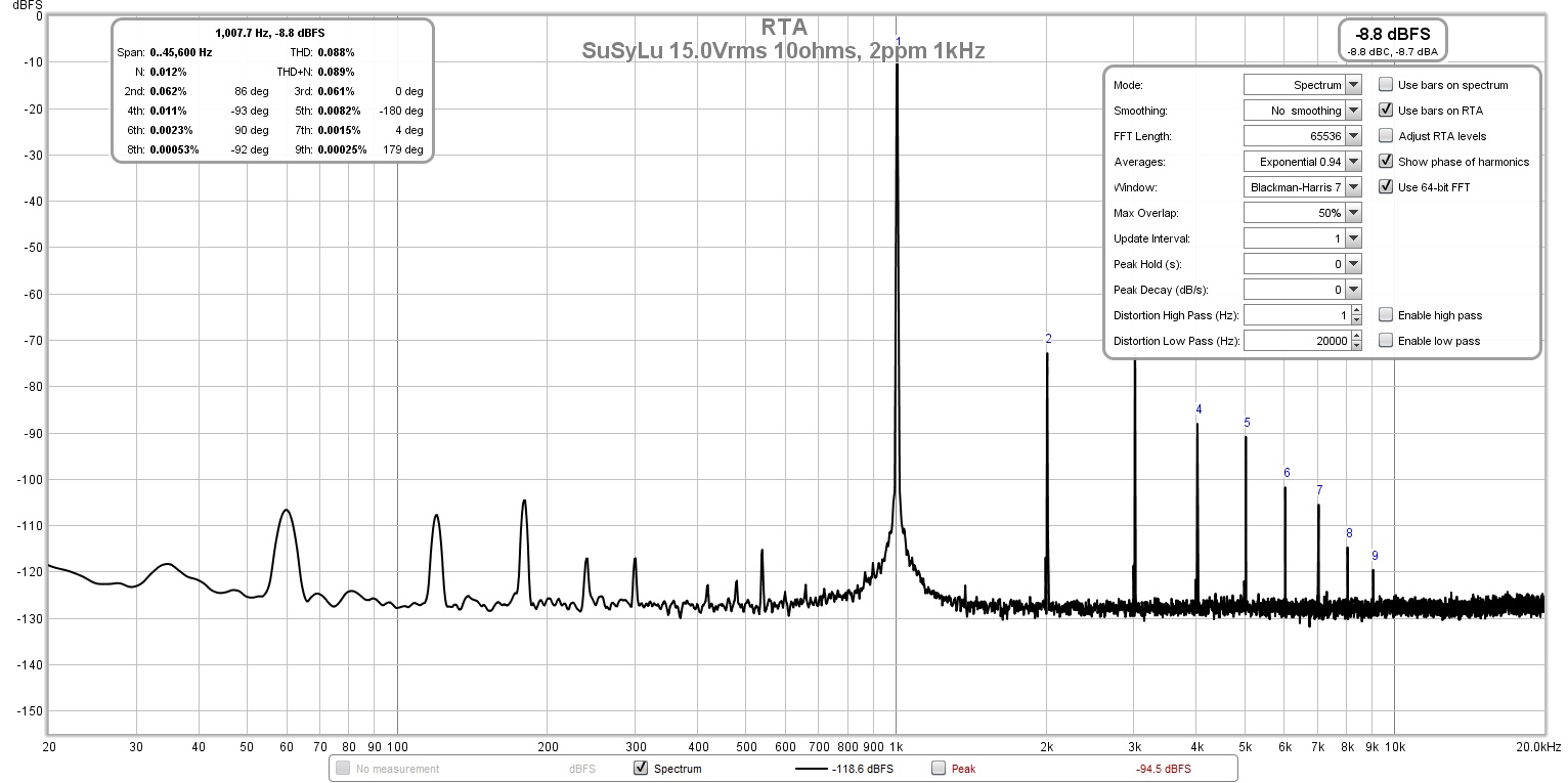

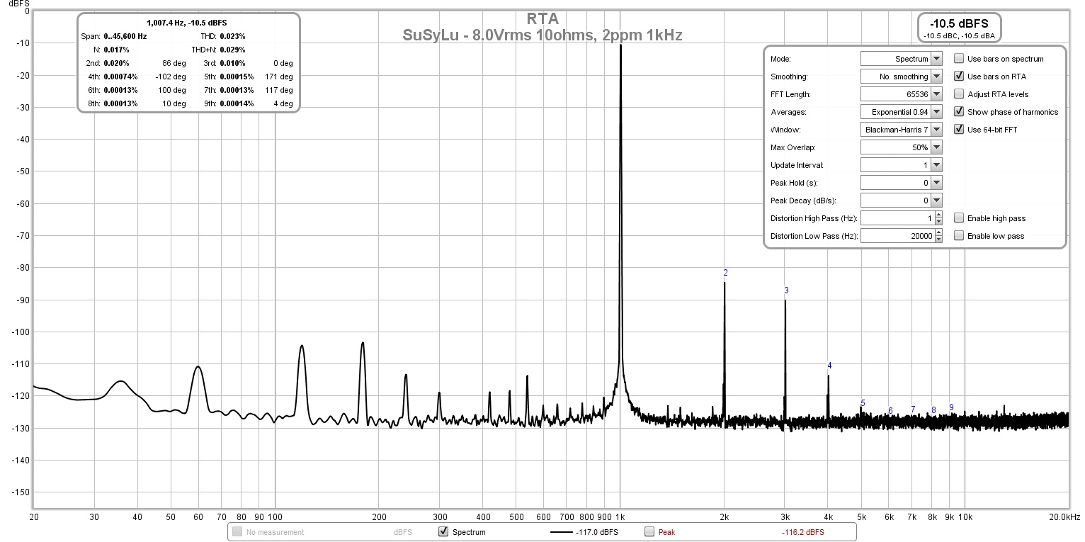

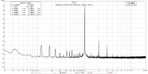

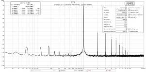

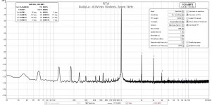

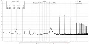

I was noticing some strange artifacts on my FFT measurements using the Focusrite 2i4 so I decided to use a different USB audio interface. I suspect the Focusrite front end somehow got damaged as the distortion looked really bad sometimes and the noise levels high. I switched to a Behringer UM-2 interface and used the provided ASIO interface at 96kHz. The measurements look cleaner now. The source is still the Akitika 2ppm 1kHz oscillator, single ended to balanced buffer is a BTSB Panel v1.2p with OPA1637 balanced line drivers. Dummy load is a 10ohm EBG UXP-300 fan cooled flat thin film power resistor.
Here are the measurements assuming 10ohms is close enough to 8ohms.
2.83Vrms (1w into 8ohms), THD=0.0071%:
4.0Vrms (2w into 8ohms), THD=0.0099%:
5.6Vrms (4w into 8ohms), THD=0.014%:
8.0Vrms (8w into 8ohms), THD=0.023% :
11.0Vrms (15w into 8ohms), THD=0.039%:
15.0Vrms (28w into 8ohms), THD=0.088%:
20.0Vrms (50w into 8ohms), THD=0.54%:
28.3Vrms (100w into 8ohms), THD=1.4%:

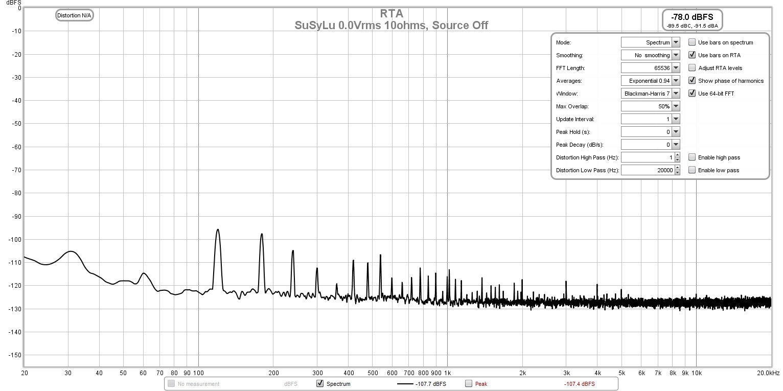

0.0Vrms - background baseline noise with source OFF:
The predicted THD at 100w matches the predicted 1.47% value from LTSpice. The THD at lower outputs are in general high, however the measured distortion appears to be 2nd harmonic dominant at lower powers due to mismatch of devices or components. This increases the THD slightly, but well worth the trade, IMO. The dominant 2nd harmonic profile appears to be good until about 25-28Wrms.

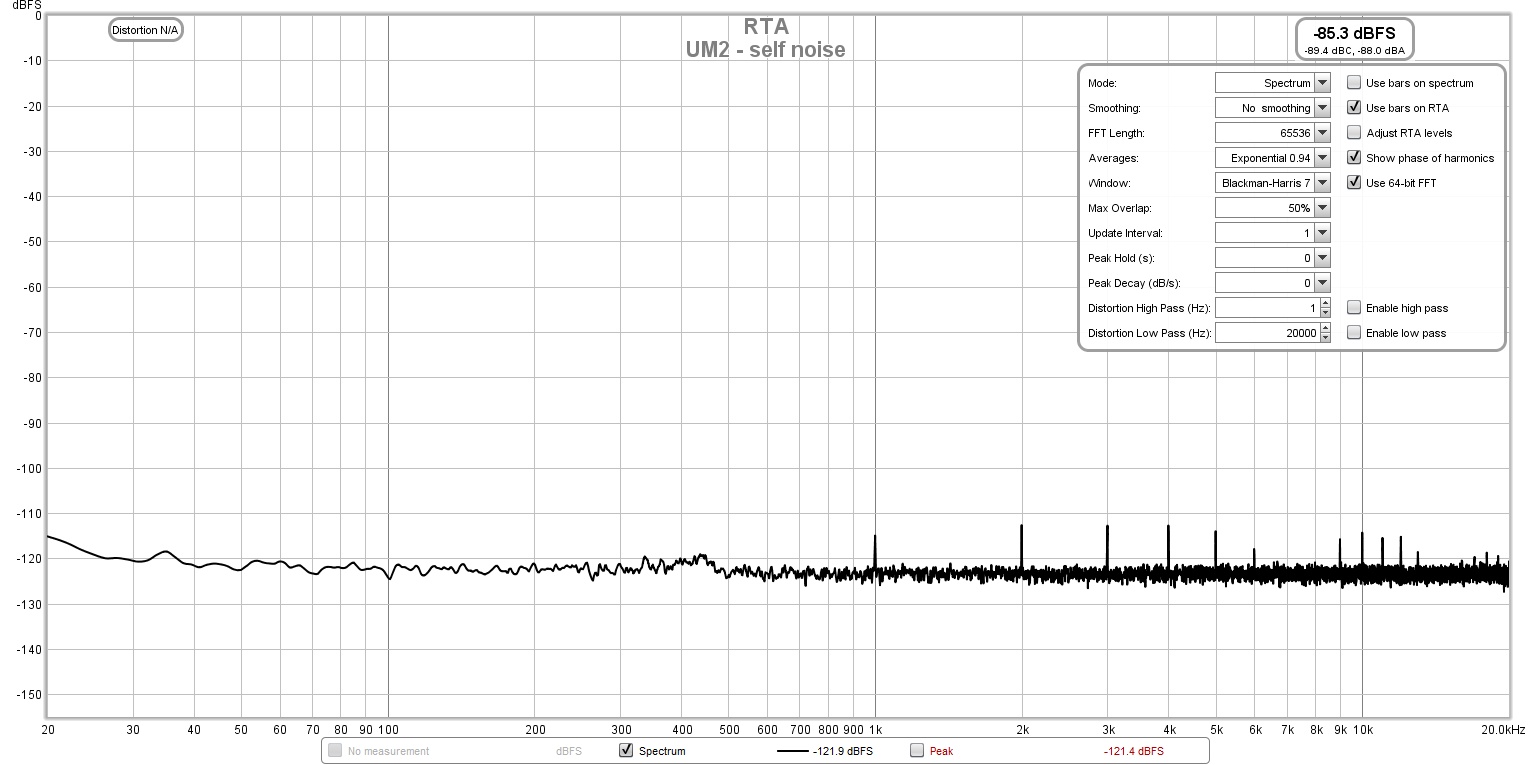

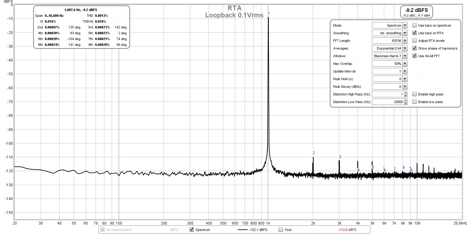

It would be interesting to see the residual harmonics of the analyzer. Can you show the oscillator directly into the analyzer?
Here is loopback test with Akitika 2ppm oscillator input directly into UM-2 input using a TS RCA plug adapter (shorts sleeve and ring or pins1 and 3 on XLR) so single ended input to balanced jack. Looks like limit of UM-2 is about 0.001% THD, which is fine for this purpose. The UM-2 appears to have some self noise near 1kHz at a low level, and its harmomics.
Loopback with 0.10Vrms ampitude gives THD limit of 0.0013%:
Self Noise (oscillator turned off):
Performance wise, not as good as Focusrite 2i4 (when it was working well), but price was only $30 vs $150, so not too bad for most casual DIY uses.
Well those are some informative graphs.
It seems that the SuSyLu prototype has a noisy power supply. Not horrible, but some room for improvement.
Either that, or there is still a (s.am ground loop somewhere. Maybe it's in the way the test equipment is hooked up to the amp. I am not worried about the residual 120 Hz peak though.
I was simply wondering if the low distortion numbers of the amp are accurate, or if they are limited by the test equipment.

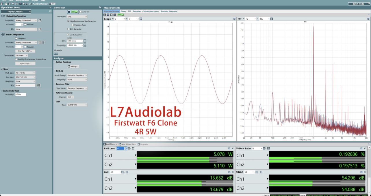

That’s actually very good for a simple CRCRC linear PSU on a Class A amp without a cap multiplier. Have you seen what a typical FFT from usual 25w Class A amp with only CRC (usual 22,000uF // 0.47Rx4 // 22,000uF)? The 60Hz/120Hz peak is about -70to -80dB if I recall.
Here is one from an F6 measured by ASR:
