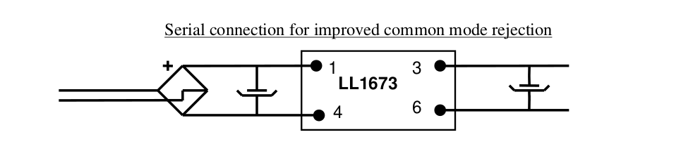

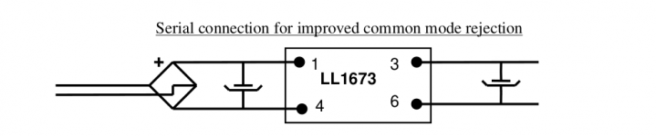

I am looking at the LL273/3.5A, which might be interesting for the SuSyLu, although it may not be enough iron at 2.5 kg only. Lundahl specified the series inductance of both windings in series at 95 mH, so each winding is 47 mH. However, they don't say at which frequency they specified the inductance value (I asked them).

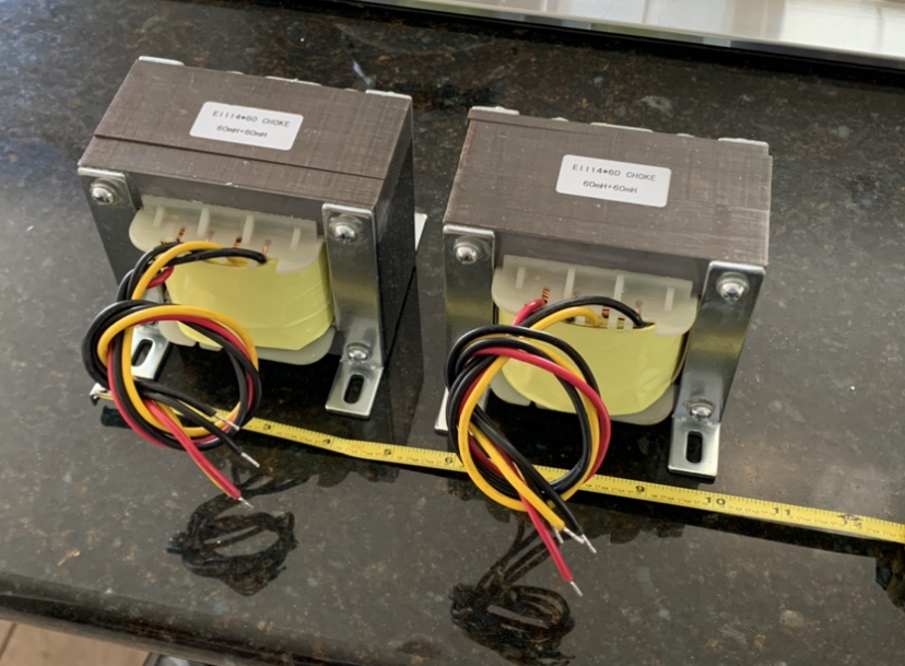

I think we discussed this - depends on how much magnetic energy storage you want for headroom. The custom dual balanced 600VA class EI core choke I have is 11lbs 5oz. The size and weight comes mostly from requirement of 14ga wire and 60mH with 0.5ohm DCR.

I am told that the 60mH and DCR spec of 0.5ohms is at 10kHz.

mbrennwa, with both winding in series being 95 mH, each winding is 24 mH, not 47 mH.
Oups, yes, you're right. I forgot that series or parallel windings act different when they're on the same core. I guess the Lundahl is out.

Hi X, when you have bifilar choke custom made, do they wind it with two wires at once, or each section separately? Just curious.
