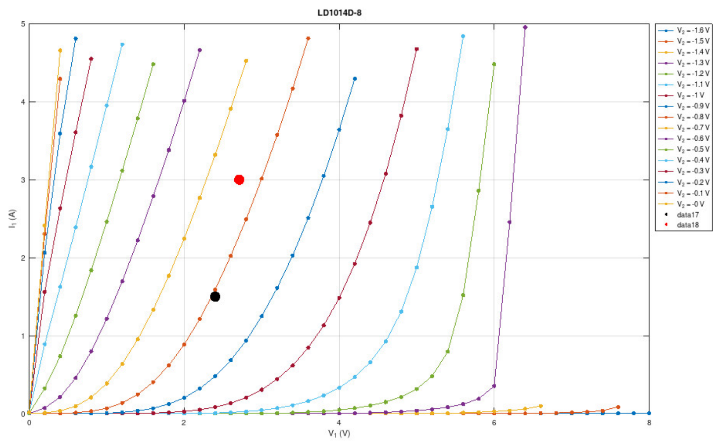

Interesting. I went through my stash of LUs and picked one with a similar Vgs spec as yours (Vgs = -0.806 V @ 2.4 Vds and 1.5 A Ids, same as woofertester test conditions). Let's say my LU is about the same as yours.
Now take a look at the curves in the attachment:
  • The Vgs curves are spaced at -0.1 V increments, starting at Vgs = 0.0 V
  • The black dot indicates the woofertester test conditions (2.4 V / 1.5 A), which is very close to the -0.8 Vgs curve
  • The red dot shows the bias conditions as indicated in your LuFo schematic: 3 A / 2.71 V
As you can see in the diagram, the Vgs required for your LuFo bias point would be approximately -0.76 V, not -1.5 V as needed for the 3 A current running through the 0.5 Ohm choke.
Biasing this particular LU at 3 A with Vgs = -1.5 V would require a drain-source voltage of about 8 V or so. That would be a dissipation of 3 A x 8 V = 24 W, which is too much. Also, this bias point would not be in a nice/linear range of the curves (data not shown in the diagram, because the current would have exceeded the 5 A limit set during curve tracing).
Either I am deeply confused, or something is not right. What do you think?

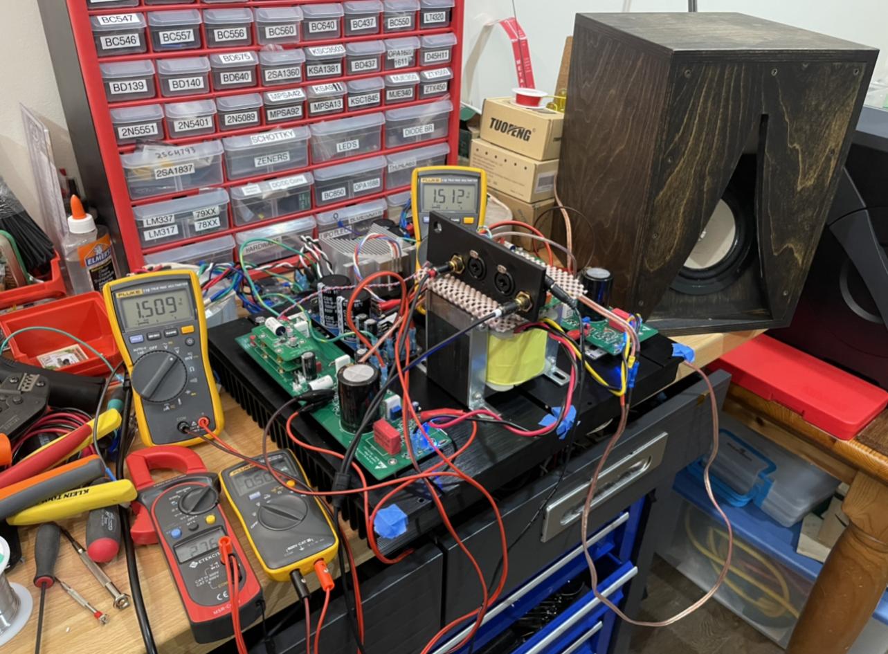

Here is the first power on test, the amp reached 3A bias current, the voltage at the LU1014D source pin was around 1.5v, and the voltage at the LU1014D drain pin was around 4.2v - pretty much spot on from the simulations.

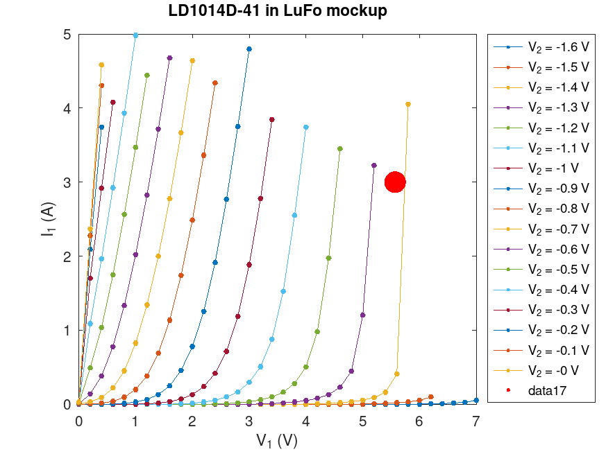

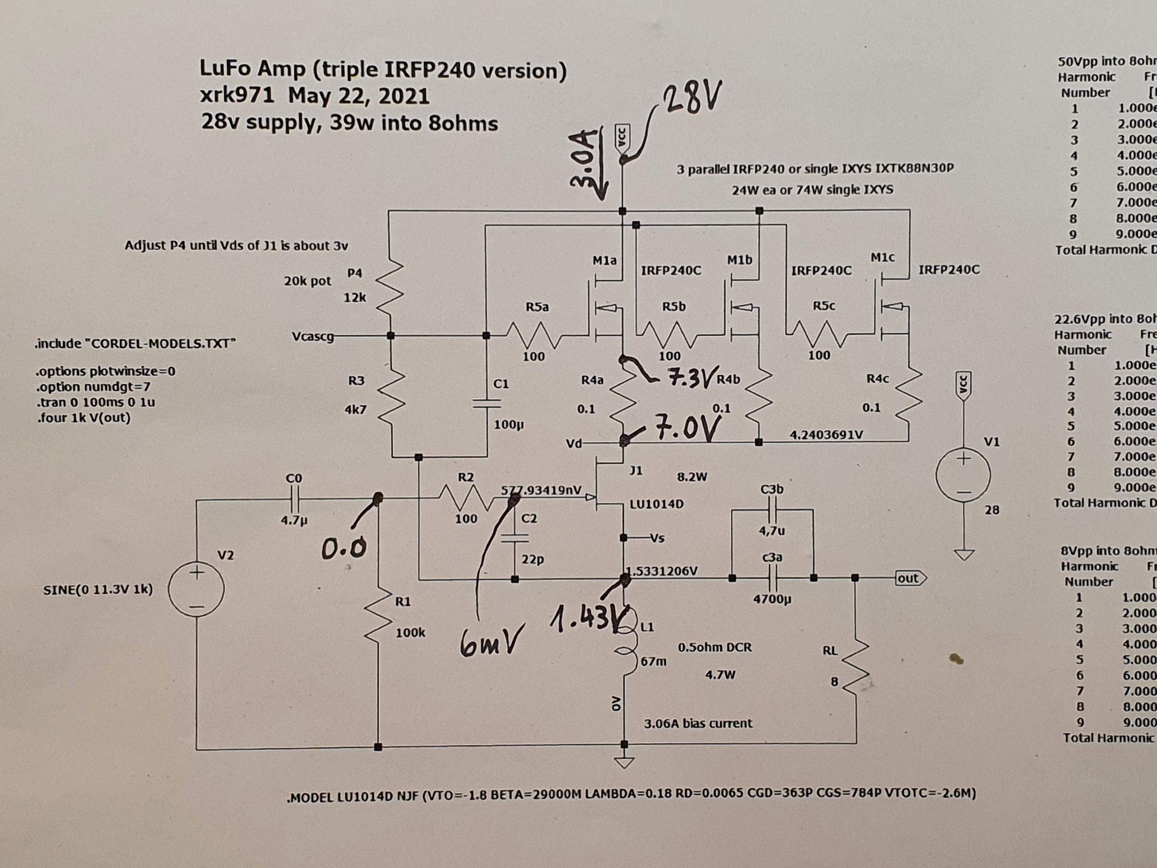

Following up on my question regarding the dissipation and bias point of the LU1014, I built a "mockup" of the LuFo circuit using parts I had on hand. The main modifications were as follows:
  • 1 x IRFP150 instead of 3 x IRFP240
  • 0.47 Ohm resistor instead of choke with 0.5 Ohm DCR (I only cared about the DC operation points, so I didn't need the inductance)
The LD1014 part used in the mockup has a Vgs of -0.92 V @ 2.4 V / 1.5 A, which is a bit more negative than the one used in my previous post, and the ones used by Xrk.
Once the cascode voltage was adjusted such that the LuFo was running at 3.0 A, I read the voltage values in the circuit as shown in the attachment. As I expected (see my earlier post), the drain voltage of the LU1014 was quite a bit higher (7.0 V) than predicted by the SPICE simulation (4.2 V). With the voltages observed in my mockup, the LU1014 dissipates (7.0 V - 1.43 V) x 3.0 A = 16.7 W, which is a bit (too) hot. Also, the bias point (red dot in the attached diagram) is not in the "nicely linear" area of the LU1014 curves.
I see two ways to cure these issues:
  1. With a fixed 1.5 VDC drop across the choke (0.5 V DCR @ 3 A), an LU1014 with an unusually high |Vgs| spec should be used to make sure it runs at a lower drain voltage.
  2. Use a choke with a lower DCR in order to lower the DC voltage drop, and hence also the gate voltage of the LU1014.
Both measures would reduce the drain-source voltage of the LU1014. This would result in lower dissipation and move the bias point to a "nicer" area of the curves.

Mbrennwa, I would adjust the resistor string that sets the cascode voltage. I would shoot for Vds of the LU1014 to be 2.4v just as Mr Pass uses in his F3 and his Zen V9.
When curve tracing the LU, the device is unstable at Vds above around 4V. By unstable, I mean that the gain becomes crazy large and the slope of the Vgs-Id curve becomes almost infinite.
At Vds around zero, the device is saturated and behaves with a pentode-ish character.
So, you want to operate the device above the pentode-ish behavior and less than the runaway gain behavior. .
Mostly, I would operate the LU in exactly the region Mr. Pass uses in his designs. He is the master. We are the imitators.
That said, you do what makes you happy.
Nice work. I would not worry about 16w dissipation. Where is the preferred “linear region”? I thought that’s where the curves are straight lines and not where the curved knees are. As you don’t like the earlier operating point either?
The linear region is where the load line crosses the curves at equal distances. This usually means the bias point should be where (i) the curves are spaced equally and (ii) away from the knees.
Yes. That's where I put the red dot in my diagram in post 221.
I believe the F3 and Zen V9 use a somewhat lower idle current than the LuFo, so extrapolating the curves from the F3/V9 point to the 3 A bias of the LuFo, a Vds value of about 3 V might be okay, too.

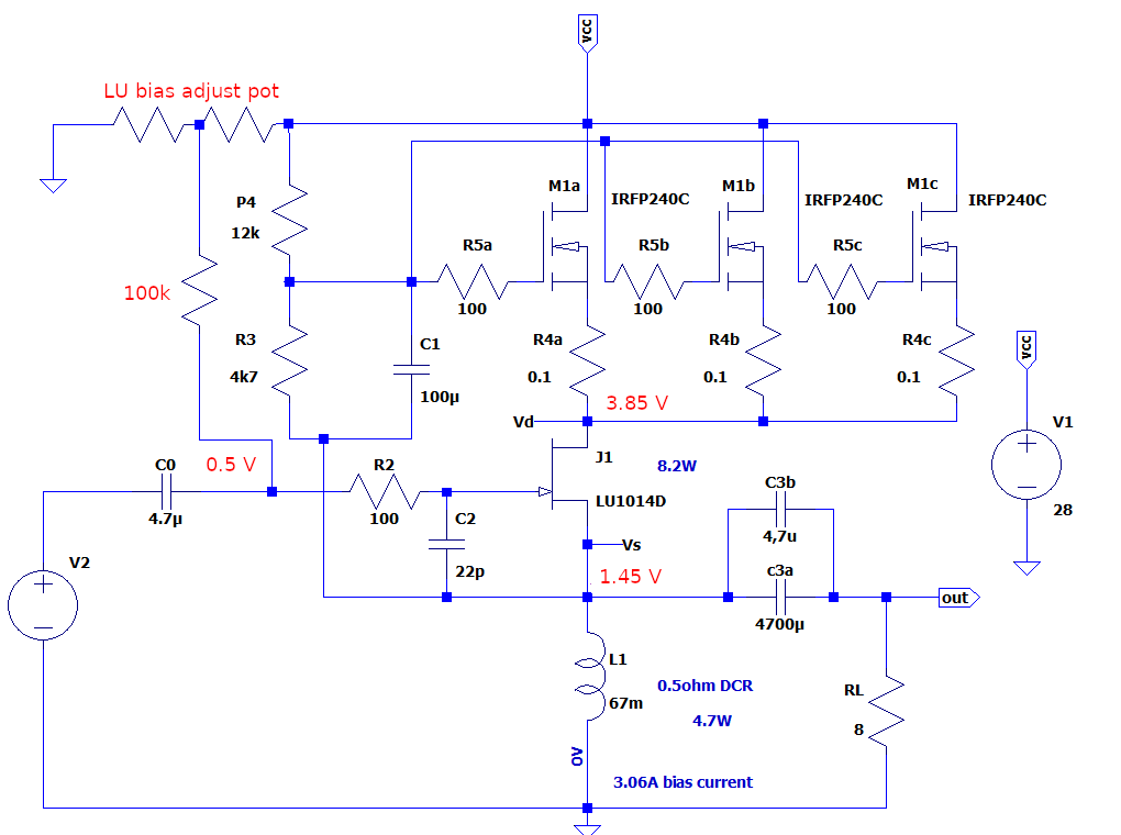

Alright, here's a revised version of the circuit that allows adjusting the Vgs for the LU1014. With this fix, I was able to set the DC bias to Vds = 2.4 V. This should work with just about any LU1014/LD1014 part out there, which removes the need for special/rare 1014 parts with unusually high Vgs specs. It's therefore much easier to build this amp.
I also found that with the earlier bias (Vds = 5...8V or so), the LU1014 gate was drawing a bit of current, whereas the gate current was essentially zero at Vds = 2.4 V. I prefer the setup with zero gate current.
I'd think it should be relatively easy to modify the LuFo PCB to add this (or a similar) Vgs adjustment for the LU1014, if desired.
