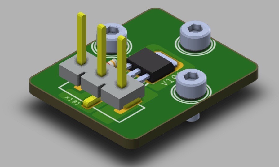

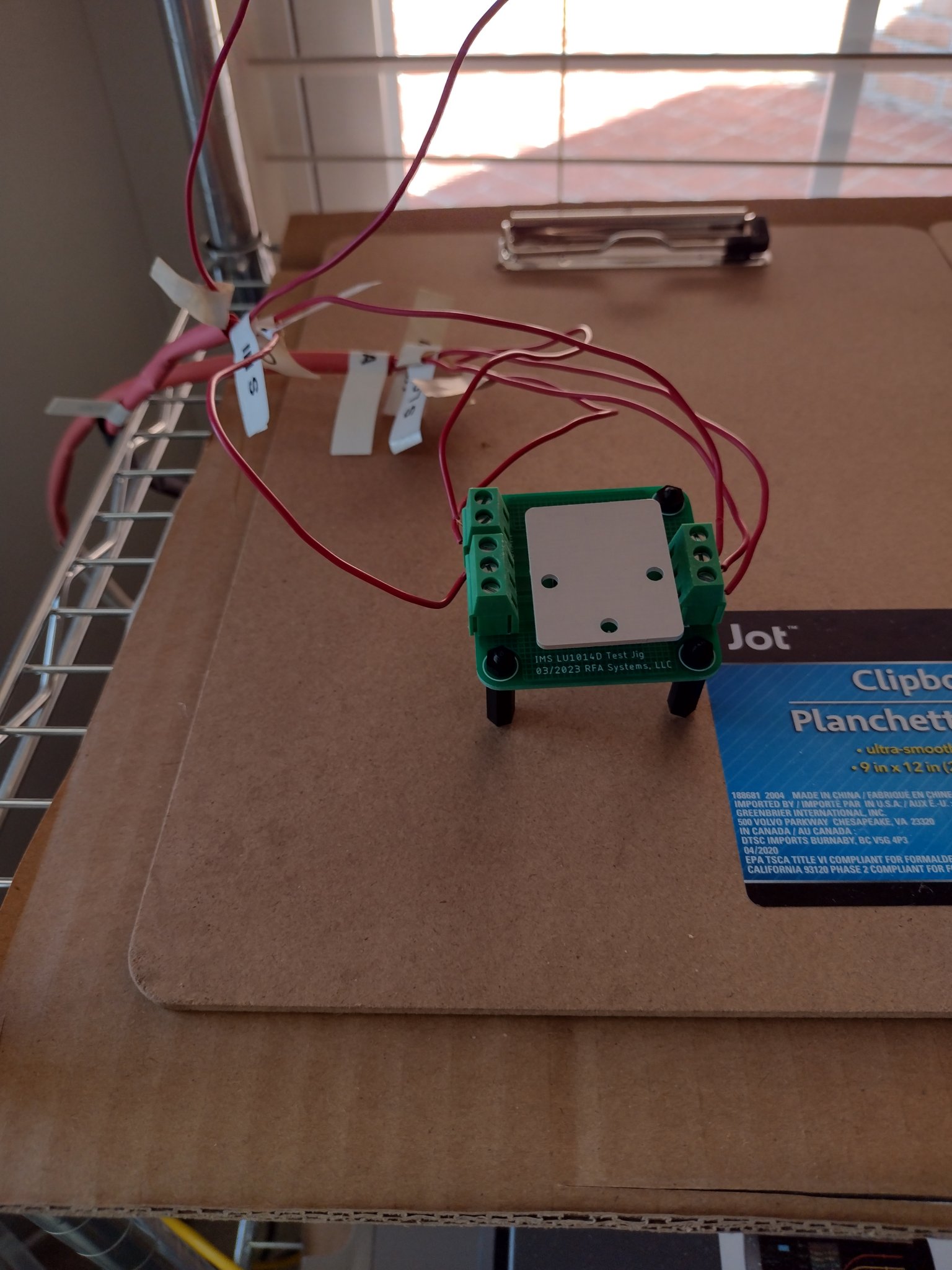

After a 1 year hiatus, I’m going to start the SuSyLu project back up again. Woofertester is helping me with the curve matching. His pro script-automated rig is working well with the TO-247 IMS adapters (mounted upside down here):

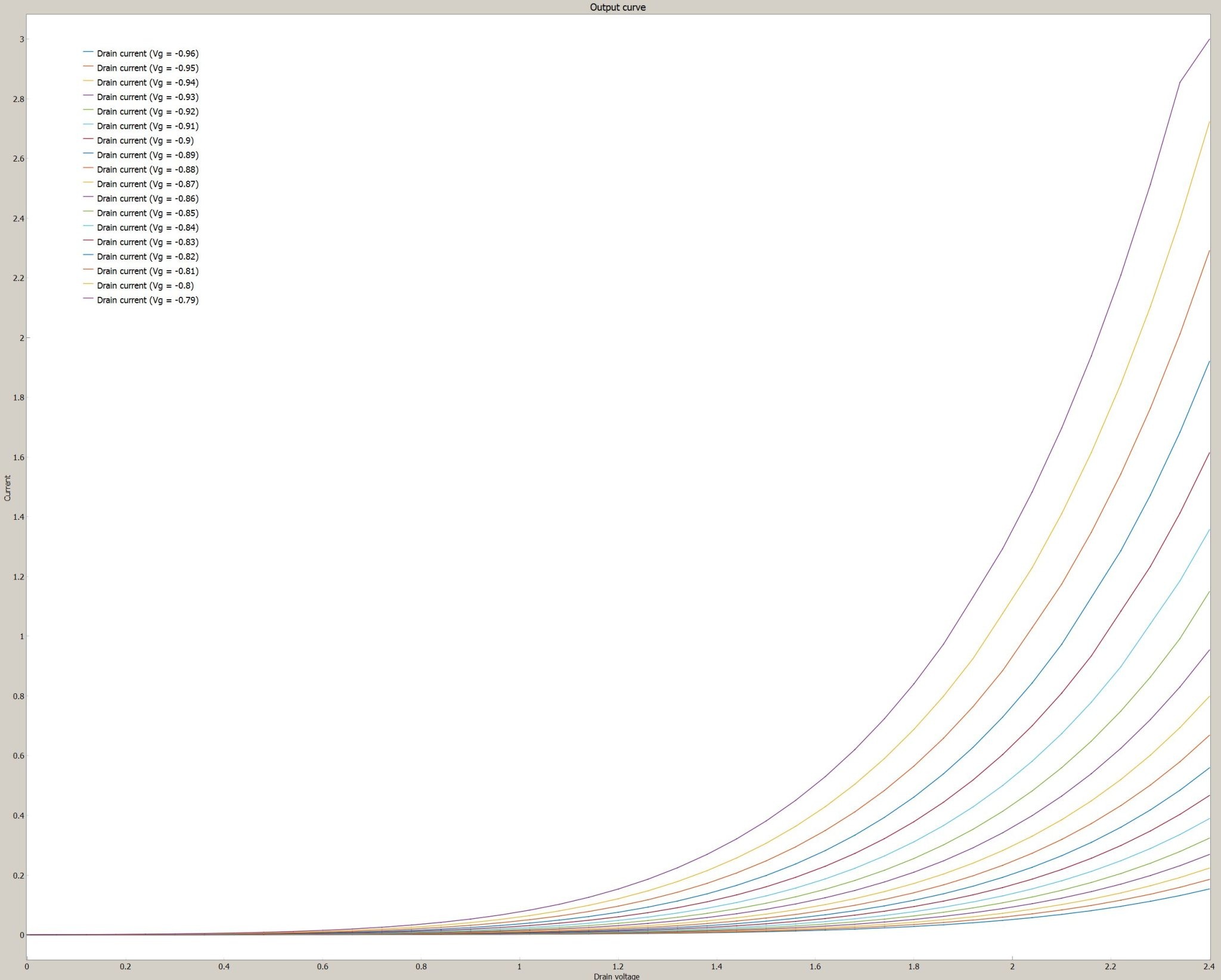

Traces from sample LD1014D looks beautiful:

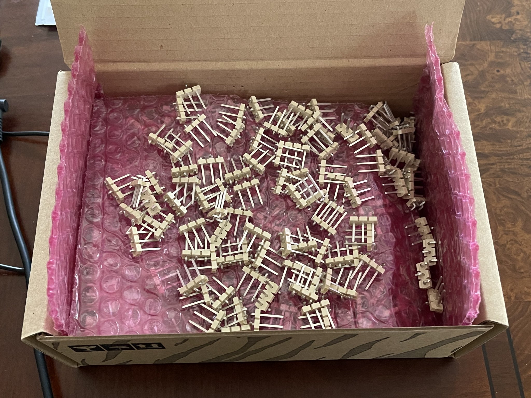

I am ordering the assembly house to start making the 600 TO-247 adapters with LD1014D and 100R mini MELF resistor and Samtec header pin.
