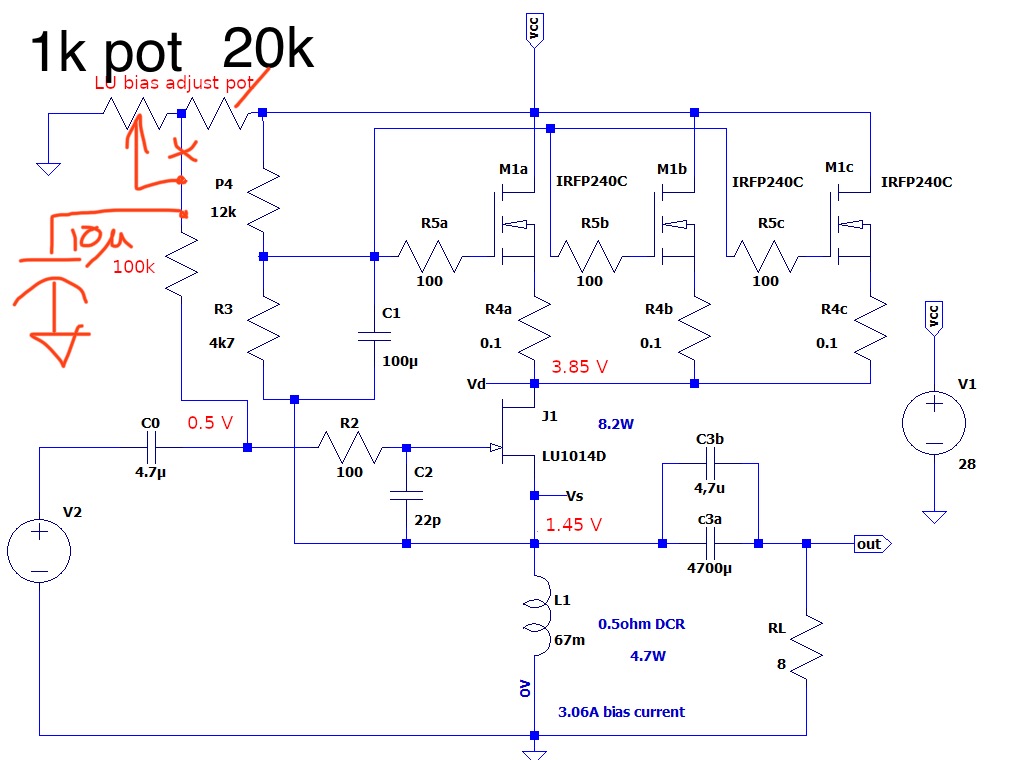

Here are the changes we will make to the layout per your suggestion of adding bias voltage adjustment for the gate of the JFET. For those who don’t want to use this option, simply jumper the 10uF cap to ground and leave off the pot and 20k resistor.

By "pot" do you mean a 20-turn trimmer? That's what I used, and I thought the multi-turn thing was good to have.
Yes, pot is short for potentioneter, typically 10 or 20 turn Bourns type blue plastic one with brass slotted screw driver knob.
Alright, here's a revised version of the circuit that allows adjusting the Vgs for the LU1014. With this fix, I was able to set the DC bias to Vds = 2.4 V. This should work with just about any LU1014/LD1014 part out there, which removes the need for special/rare 1014 parts with unusually high Vgs specs. It's therefore much easier to build this amp.
I also found that with the earlier bias (Vds = 5...8V or so), the LU1014 gate was drawing a bit of current, whereas the gate current was essentially zero at Vds = 2.4 V. I prefer the setup with zero gate current.
I'd think it should be relatively easy to modify the LuFo PCB to add this (or a similar) Vgs adjustment for the LU1014, if desired.
Hi Mbrennwa,
I addedthe JFET gate bias mod you suggested to the simulation and noticed that the overall output stage bias current rises with an increase the gate bias voltage (as expected since N-ch JFET needs a negative voltage to pinch-off). Did you have to iteratively adjust the cascode bias voltage pot with the JFET gate bias voltage pot to achieve the desired overall bias current and JFET Vds of 2.4v? I was not able to find a setting in LTspice that gave me Vds of 2.4v AND a 3.06A bias current overall, except whent I set the pot for the JFET gate to 0 ohms (back to original circuit).
Maybe it is not working because the model of the JFET I have in LTSpice is for a higher Vds unit?
Yes, its an iterative process. Adjusting the LU gate bias will affect the idle current and cascode operating point -- and vice versa.
It's not surprising that your SPICE model for the LU wants the LU gate at ground, as this is how it was before the bias mod. That SPICE LU model is obviously just a model, not reality. You could do a curve trace in SPICE and compare it with the measured curves to see the differences.

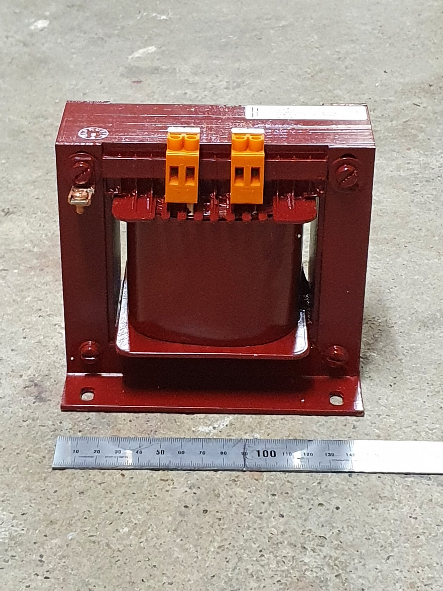

I found a transormer maker who is willing to make these for me. He asked if the 0.1 mm airgap is the true geometric width of the gap, or of this is the effective width in the sense that the gap is distributed across the three "joints" where the E and I meet. In other words, the magnetic flux passes the gap once at the middle of the E, and then a second time at the top/bottom of the E. Since the flux passes the gap twice, the effective width is twice as much as the real geometric width. Soooo, which one does the "0.1mm airgap" refer to?The specs are 600VA class EI core made of grain oriented silicon steel (GOSS). There is a 0.1mm airgap.

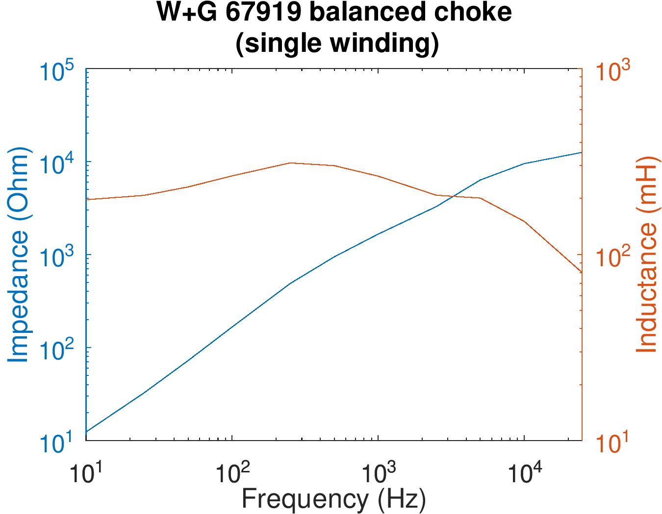

Ok, thanks. It looks like the manufacturer did not wait for my feedback on the gap size, as the postman delivered the chokes/transformers this morning. I briefly checked the inductivity vs frequency, and it looks good (way higher than 60 mH all the way up to 25 kHz, DC resistance is 0.4 Ohm). However, this quick test was with no DC load on the windings. What would be a good test setup to test the chokes with a DC load?
The easiest way is to run it in the amp and see what setpoints you get. To build a rig to run 3A with appropriate voltages is not trivial. Might as well use real thing. I think you will be fine. Can you show photos?Ok, thanks. It looks like the manufacturer did not wait for my feedback on the gap size, as the postman delivered the chokes/transformers this morning. I briefly checked the inductivity vs frequency, and it looks good (way higher than 60 mH all the way up to 25 kHz, DC resistance is 0.4 Ohm). However, this quick test was with no DC load on the windings. What would be a good test setup to test the chokes with a DC load?
That was fast!
The chokes were made by Wagner + Grimm in Switzerland. They are big, heavy, and red 🙂
Photos and measured impedance and inductance data are attached. DC resistance is 0.4 Ohm per winding.
If testing them in an amp, what would you look out for? How can I tell if they are running into saturation?
