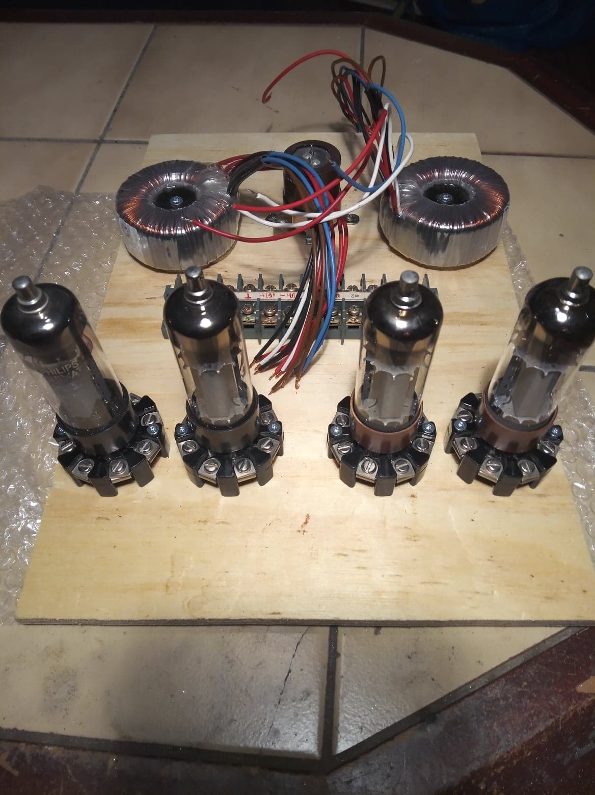

OTOH, there is also a parallel path going on here - I’ve got a box full of both of the smaller ones, 20-0-20 and 30-0-30 that I bought surplus (for a song) maybe 25 years ago. More than I’ll ever use to build small solid state amps and therefore more expendable. Both lend themselves to running sweep tubes low and hot (in class AB, i like power) either singly or interleaved. Could also run massively paralleled 12W6’s.

OTOH, there is also a parallel path going on here - I’ve got a box full of both of the smaller ones, 20-0-20 and 30-0-30 that I bought surplus (for a song) maybe 25 years ago....... Both lend themselves to running sweep tubes low and hot (in class AB, i like power) either singly or interleaved. Could also run massively paralleled 12W6’s.

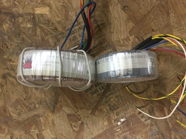

At least 10 years ago while I was still living in Florida, I found a bunch of toroidal power transformers in a dumpster. There were 3 designs each with it's own "Boca Systems" part number. There were two vendors for each part number for 6 distinct types of transformers. I also have about 8 160 VA Isolation / Power Filter transformers with 4 X 120 volt windings on each.
I tested all of them for use as P-P OPT's and came to some conclusions. Two transformers with the same part number on them, but made by different vendors can behave totally different from each other in OPT use. One of the largest (about 250 VA) was totally useless with a very lumpy frequency response in the 2KHz to 10 KHz range and severe rolloff above 15 KHz. The other was the best toroid tested as an OPT. All tests were done using E130L tubes at a relatively low voltage. Each toroid was tested with all possible combinations of primary and secondary windings for best performance. The larger 250 VA toroids have two 36 VCT and two 28 VCT secondaries, these are too high to be useful. These, and the 4 winding isolation transformers were tested with a new "secondary" wound through the core with hookup wire.

When Kodabmx posted about his favorite toroidal power transformers listed at a parts distributor for under $15 each instead of the usual $42 I bought 6 of them. Some experiments with them will occur and maybe I'll even build a new reactor.

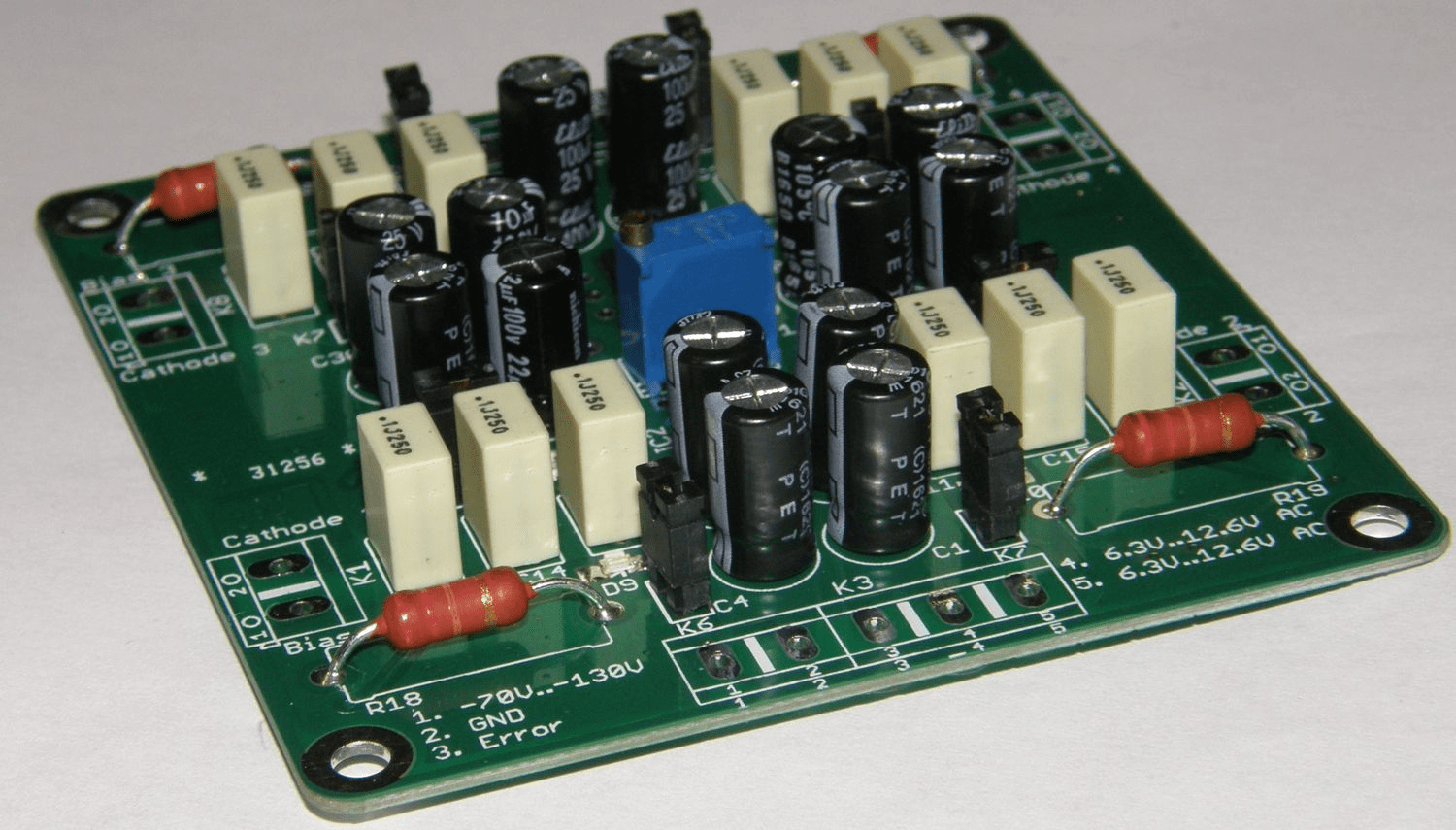

BTW, I can send you a pair of my VA/PI/DR boards to play with, too. Send me your address and let me know if you need a pair of 6F12P to go with them, too.
I'm just thrilled by the performance TBH and think you'll like the results.
I haven't done many experiements with pentode, but trioded sweeps work very well (I also use automatic fixed bias boards so there's no hogging or runaway).
I've designed my sweep amps to run a voltage double/quad to get 320V/600V from a 120V coil as to keep costs down. 320V for the output stages, 600V for the VA/PI/DR boards. They will swing over 200Vpp into the triodes so EL509 and the like are easy. I use a -150V bias supply for big sweeps, and -75V for small ones.
Thanks for the offer, but I have 5 different pairs of driver boards that are already built and working to play with. I still have a pair of unpopulated UNSET boards to hack up which will likely be the basis of the next round of push pull experiments.

What I need to figure out is a bias servo that keeps the average current balanced between the two banks, and at least MONITORS the dynamic balance within a bank - with the goal of controlling it. I’ve got a batch of 21EX6 to play with on lower voltage with the 8T800 as an OPT, then on the real supply and OPT to get this part developed. Run it on 8 ohms to get half the power (and dissipation, letting me use 23W tubes). Until I’m satisfied that things can be kept in balance, the LW6’s stay in their boxes. As with large solid state amps - designing and building the supervisor circuit is 90% of the work. And you don’t deploy one in the field without.
There are many schemes for this, but I prefer the Pavel's AB-4 from Audioamp.eu - That is, if you're looking for a turn-key solution. https://www.audioamp.eu/module-ab-4...he-amps-circuit-with-ttl-error-signal-output/
If uses external 10R sense resistors (good when there's high currents in the amp). I would also upgrade the 100µF/25V caps to something longer lasting. I've had one or two dry up but it didn't seem to effect the biasing.
You can use more than -130V bias - I use 200V regulated to 150V by VR tube - AFAIK the SS parts are 400V (besides the JFET opamps (TL082). If you tend to blow the opamps with static, overloads, shorts etc Pavel will make you boards using socketed DIP-8 versions.

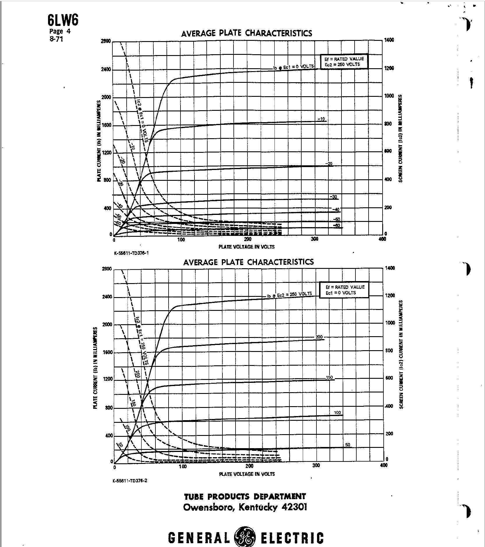

there are no curves to look at on the LW6. It was when playing with 26DQ5’s at 500V - they were happy at 30 mA.
Someone emailed me some 6LW6 curves. I also made some pulsed tests for areas not explored in the data sheet in the PDF......up to 600 watts of dissipation for 1/2 second!
