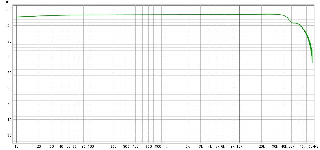

I was messing with a 230V/12V/105VA toroidal I have laying around, and here's what gives:
The DUT is driven at about 1V with a small amp (lo Zo) connected to the 12V side, and the 240V side is loaded with a 300pF capacitor and fed to the differential mic input of a Focusrite, through a couple of 2.2M resistors.
My goal is to find an alternative way to drive my electrostatic headphones, hence the 300oF.

Those are almost ideal conditions in which any transformer would perform well . For tube amp has little relevance
Shoog has a good point here: If the ambition was to build a tube subwoofer amp, then using undersized mains transformers as OPTs would be a terrible choice 🙂 Still, 5W at 30Hz isn´t bad for someone like me who has high efficiency speakers and a preference for class A triode amps.
