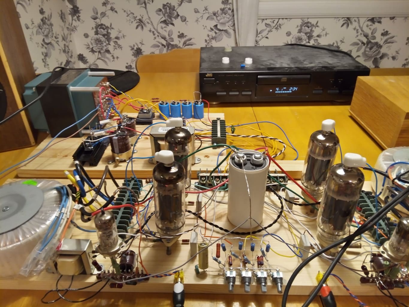

Made a new breadboard with a better power supply* and a 12AT7- based LTP phase splitter. Results:
Clipping just below 40Vpp @ 7,5R load, and I have reasons to believe that the phase splitter runs out of juice before the output tubes.
With zero GNFB I'm 1dB down somewhere around 25Hz at full power and the HF irregularities went away with the LL1660, now it's pretty much flat past 50kHz. Not bad, not bad at all!
* The new PSU is still not big enough to run the tubes att full power, ie 35W each. Currently I run them at 280V 73mA each, with fixed bias.

I ran some quick tests with my vintage tone generator and oscilloscope, so take the results with a grain of salt:
At 26V peak into 7,5R (45W) the waveform starts to get visibly distorted at 40Hz, 30Hz at 20 Vp (~27W) and 22Hz at 15Vp (15W). Tweaking the DC balance has no visible effect on the distortion.
This leads me to the conclusion that these transformers can be used in a hifi amp up to maybe 20-25W (ie no point in designing for class AB) OR in a mammoth sized guitar amp.
BTW, yesterdays not-very-critical listening test went fine, no complaints.
Time to change back to cathode bias and see how the circuit can be optimized.
