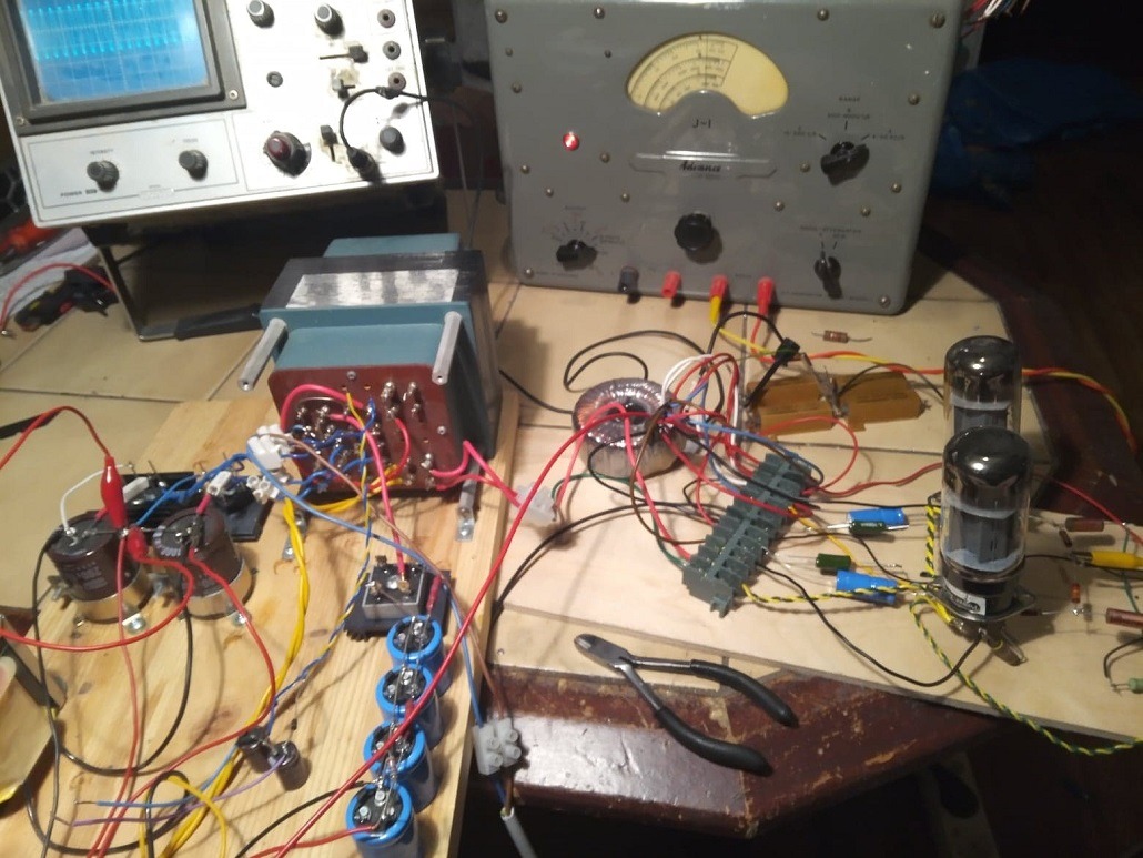

The transformers are what they are, useless for a high power fullrange amp but, unless I'm missing something, fairly adequate for a class A amp with two large sweep tubes per channel.
Right now I'm seeing ~30W with 320V B+ and 340R + 220uF in each cathode "leg". At 285V 95mA per tube you can feel the heat radiation from two feet away 😀

Next up is to replace those whimpy 6L6s with something more...knuckle-dragging, and rewire the transformers to ~2k/8R and see what happens.
Although I fully second wg-ski's arguments in #53, I'd really being itched to try something like this for myself and see/measure what happens. Just have to find a suitable transformer, as 115 + 115 Vac ones are rather scarce here in Germany. Cathode NFB surely will significantly reduce distortion and the final pair's output impecance the transformer looks into, but we can't completely disregard nature's laws.
Btw, I've calculated your primary impedance at [(115 + 18) x 2]² x 8 ~7 k.

The 115+115 primary are the ones we find all over the place here, especially the low budget options. Having 2x18 AND 2x9 secondaries (as long as both are for a decent current) is a real find - as you’ve got LOTS of impedance options, although some are going to be pretty low. If you had two identical you’d be in hog heaven for experimenting.
Let´s see what we have here: With 230V 50Hz across both 115V windings I get 20,2V on the 18V windings and 10,2V at the 9V windings, unloaded. The highest possible turns ratio would then be (115+115+20,2+20,2)/10,2 = 26,5:1, or ~5,6k:8R.
5,6k a-a is a suitable plate load for a lot of different tubes, although the ~5W power rating at low frequencies points in the direction towards triode connection and class A operation for quality rather than quantity.
The next option is to connect the two 9V (10,2 unloaded) in series and get 13,25:1 or ~1,4k:8R, an interesting plate load for bigger sweep tubes running "low and hot" in class A. This connection should be good for about 20W at 30Hz if my clalculations are correct.
We could also connect all the secondaries in series as one 27-9-0-9-27V winding , ground the 0V point, connect the 27V points to cathodes and the speaker across the two 9V windings. This would result in a 14,25:1 ratio or 1,6k:8 and give us some extra CFB voltage as a bonus.
