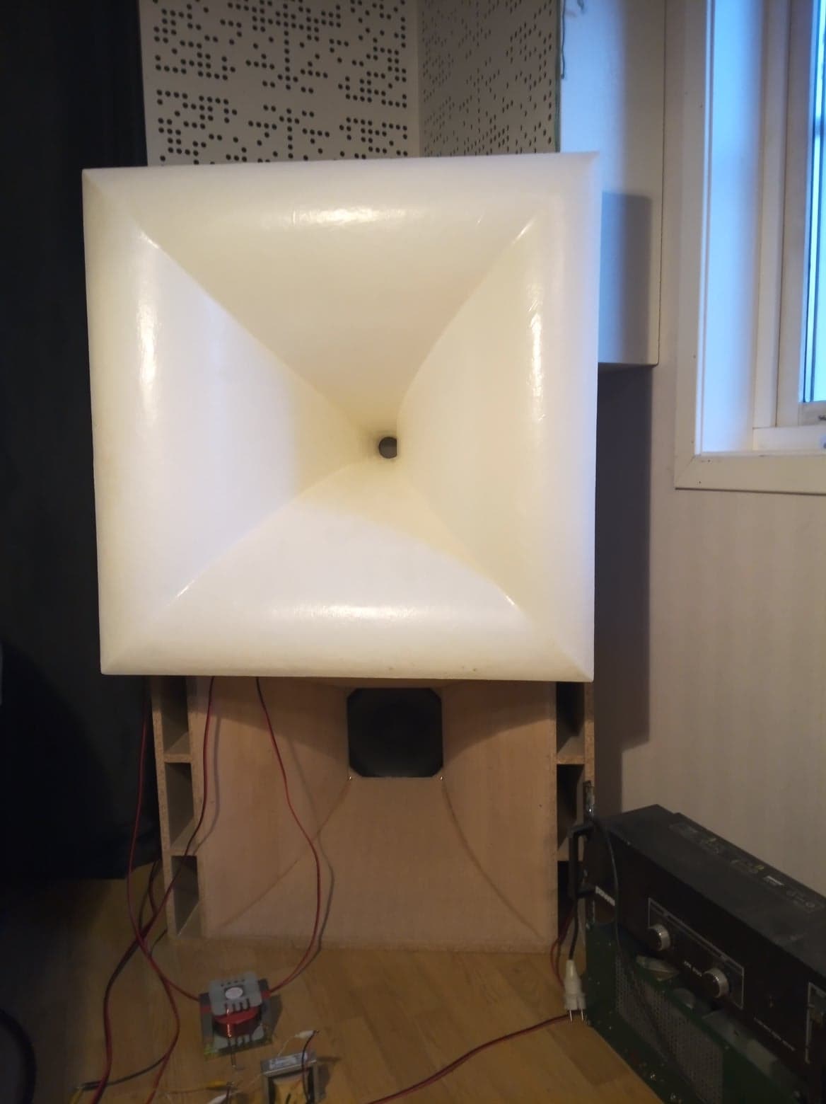

The tube subwoofer amp part was mostly a joke, although I have a pair of bass horns that will need amplification some day. My new ported midbass horns made the bass horns more or less obsolete but a lite extra below 50Hz or so wouldn´t hurt. No need for any monster amps though, the bass horns are loaded with 16 ohm 8" midrange drivers with very low Xmax.

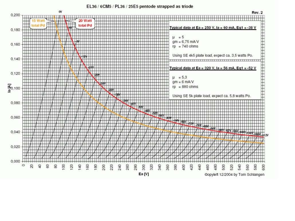

I don´t think it would be necessary to go to any extremes when choosing tubes to go with these transformers, a pair of triode wired 6L6s worked surprisingly well and I believe pair of trioded PL36 should work even better:
