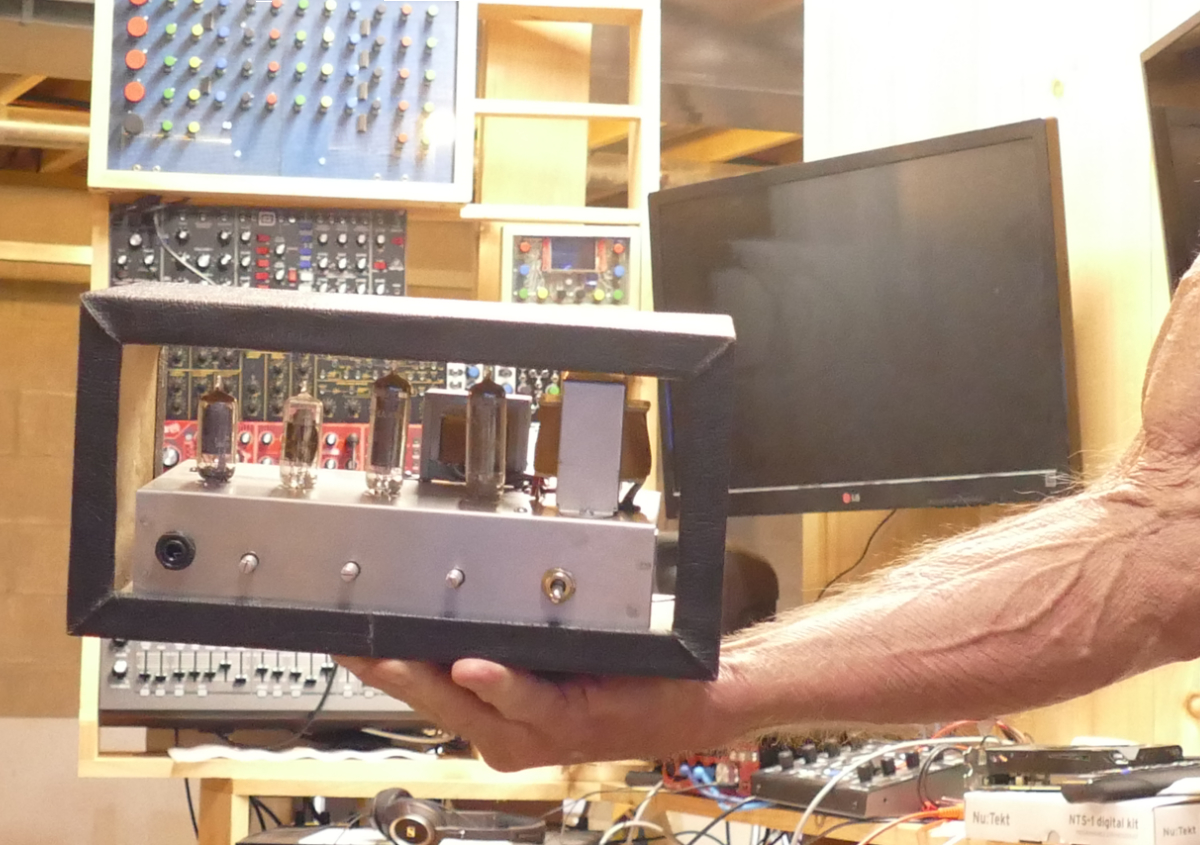

Why would I want to build a 1 KW vacuum tube amp when THIS (cabinet still not finished) is the guitar amp I use most often. It makes a blazing 4 watts which is quite loud even in a 2000 square foot basement? I'm still questioning myself about that one as I work on it.

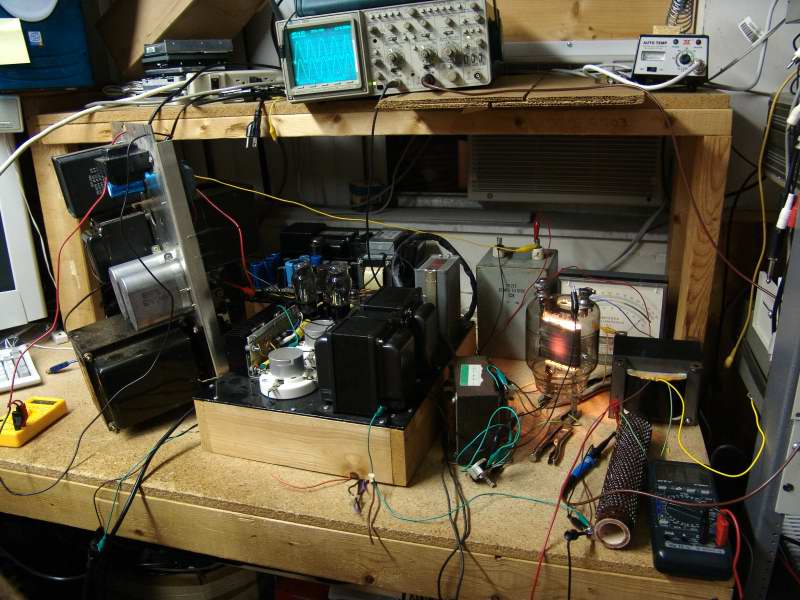

As for the vacuum tube subwoofer, I still have the 833A's, the OPT and a much smaller power transformer to build a sub or killer SE guitar amp based on this experiment I did nearly 20 years ago. I have a TI class D EVB that makes a bunch of watts (over 500 depending on configuration), so the 833A stuff will NEVER happen. The parts will be for sale at the Dayton hamfest.

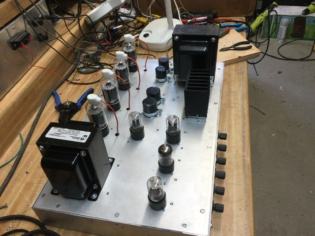

1000 maybe, but just 100+ isn’t impractical at all. It still a lot smaller/lighter than a speaker cabinet. The 200 watters started out as “the bass amp” but after listening to one for five minutes convinced me not to have it relegated to amateur-hour instrument amp duty. I ended up with a more practical 136 watts - but used standard off the shelf output trafo. The power trafo was home made (From a $15 donor core, end bells that were lying around, and maybe 5-10 bucks worth of magnet wire). All cheap off-voltage tubes - easy when winding your own power trafo. When trying to save money on transformers often the place to START is with the power trafo - solutions there are much simpler than the output trafo, even for large or very large amplifiers.

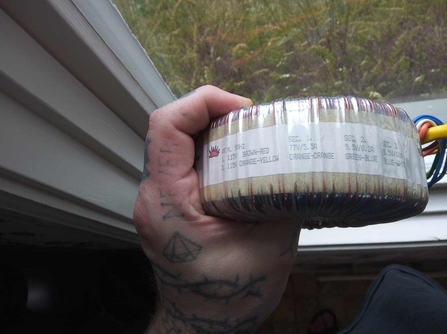

I found something mildly interesting in my junk box (read: junk room) last night: a ~400VA toroid with 2*115V primary windings and a massive 77V 5A secondary plus two 9,5V low current windings. Since we´ve been talking subwoofer tube amps lately, this one tickled my imagination a bit. 80R p-p is too low for a plate coupled amp but perhaps a sweep tube PP cathode follower or a Circlotron would work? Think "OTL assisted by a 3:1 transformer for slightly better impedance matching". OTOH, limit ourselves to tubes? Perhaps a pair of big mosfets with Schade-style local feedback and/or CFB from the 9,5V windings would work wonders here?
