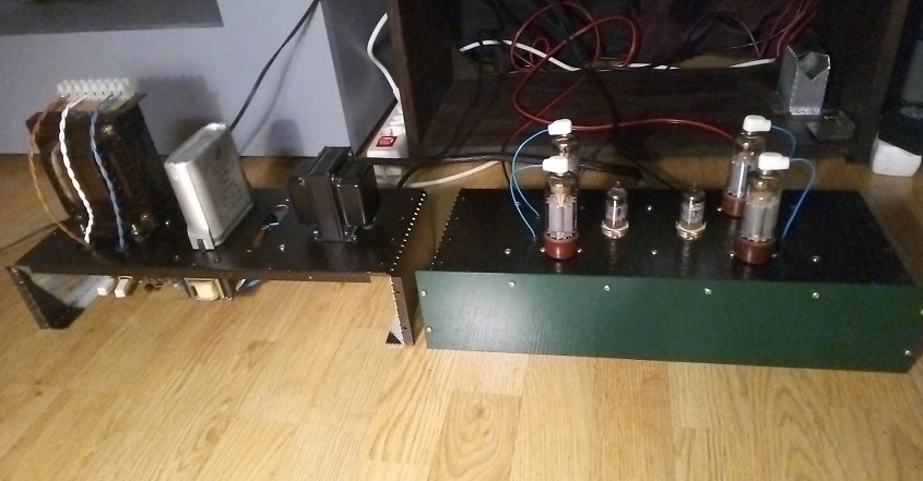

Time to get back to business after a long summer break. The big pair of toroids are resting on the shelf waiting for the energy crisis to be solved, in the meantime the smaller ones are actually playing music for the first time. My first attempt was with a pair of PL83 (15A6, N309, 15V heater version of EL83/6CK6) but they where a bit too weak for my taste and the load lines looked uncomfortably steep at 5,6k p-p. The mkII version uses PL36 (25E5, 25V version of EL36/6CM5) which allows 12W in the midband and 8W @ 40Hz and 4W @ 30Hz before the waveforms collapses due to saturation.
The output tubes runs at 250V B+ with 135V at the screen grids, minus the 15V drop across the cathode resistors (240R).
With 12AT7 LPT input stages and zero GNFB the voltage gain hits a slightly devilish x6,66...😈 PL36Widowmaker.jpg

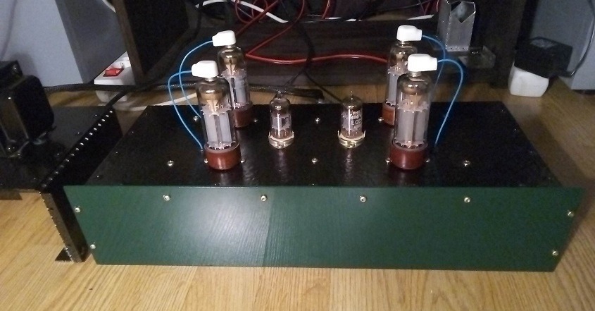

After failing miserably to use the smaller pair of toroids in a PL84 (~6CW5) amp, I've finally built something that actually works. Nothing wrong with the PL84s but the whole project was plagued by an aggressive buzzing sound that I couldn't get rid of, probably caused by diode noise from the rectified heater windings. When I found this big 230 + 28 VAC >150VA EI transformer for a good price I decided to tear the amp apart and rebuild it with AC heated PL36s (25E5) instead. This time I put the PSU in a separate chassis to get some extra distance between the mains transformer/choke and any parts that might be signal carrying parts. The whole effort paid off quite well, now I have a very good sounding amp with zero mechanical noise and very close to zero electrical noise/hum.
In fact it does sound so good that I almost regret using cheap sweep tubes (even if they have very nice triode curves) with these output transformers, I can't help thinking about how nice it would be to use 6S4S (russian 6B4G) instead🙂
The pair of bigger toroids from the beginning of this thread are still on the shelf, waiting for me to find a suitable power transformer for that project.
Thanks! I haven't measured anything yet (been busy with other projects) but if it works as intended it should produce around 7W per channel, running the output tubes as triodes at ~235V 50mA each into 5,6k a-a. The tubes are running fairly cold, another 30V or so of B+ would be nice but I'm stuck with the power transformer I'm using. 10W in class A PP shouldn't be a problem from a pair of trioded PL36.

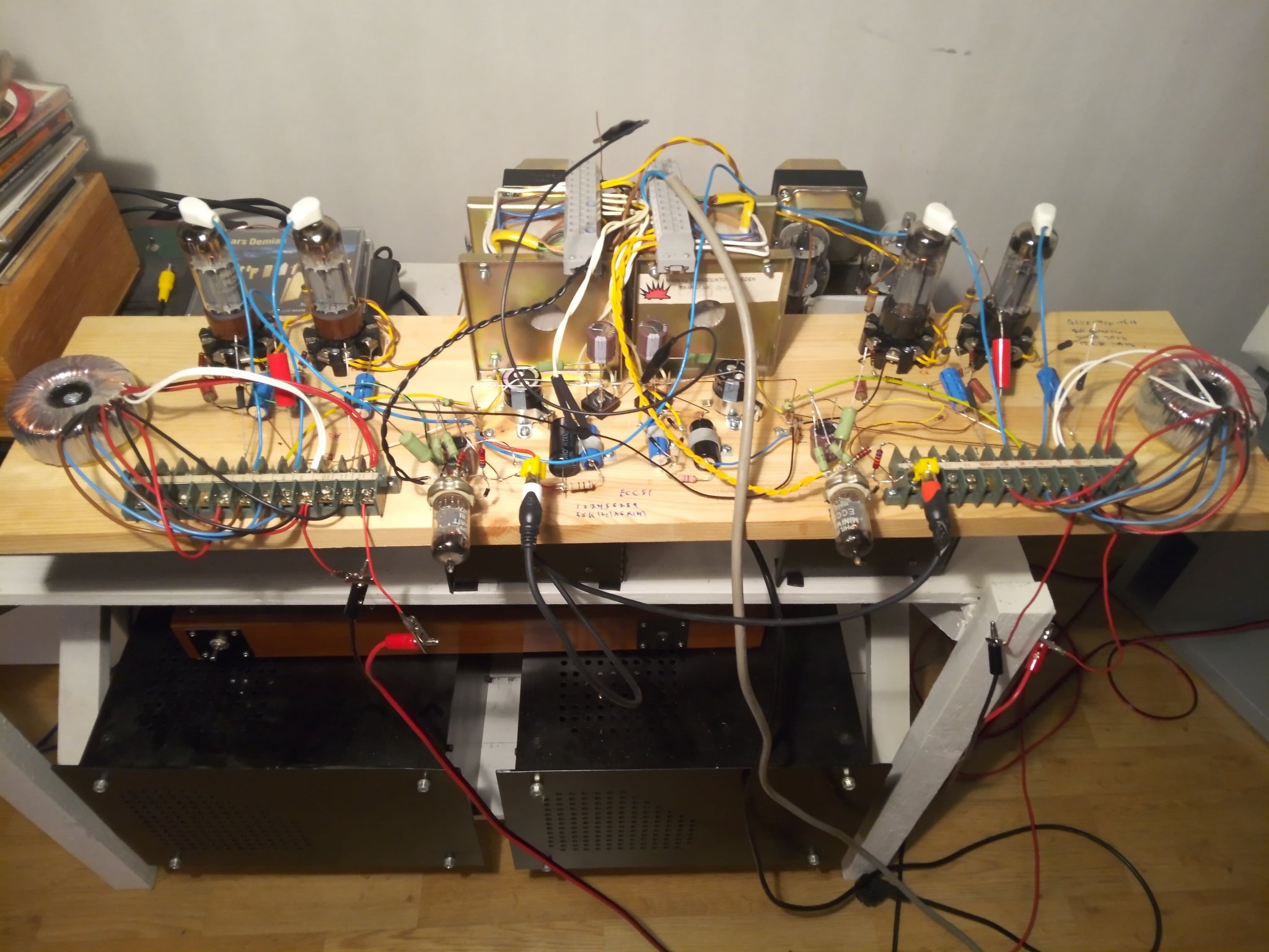

I keep thinking about the bit toroids from the beginning of this thread. IIRC they worked fairly well up to 25W or so and now I've found another big toroid with a multi-tapped 230VAC winding, very useful for a low-ish voltage, high current PSU. I also have over two dozens PL84s left from the failed project that was rebuilt as the much more successful PL36 amp, and some small toroids that could handle their heaters without messing with noisy rectifiers.
4x PL84 per channel should work nicely with 2k a-a at 200-250V with the sgreen grids fixed at 160V or so. The biggest challenge would be to build a phase splitter/driver stage that can deliver at least +-50V swing per phase from such a low HT rail.

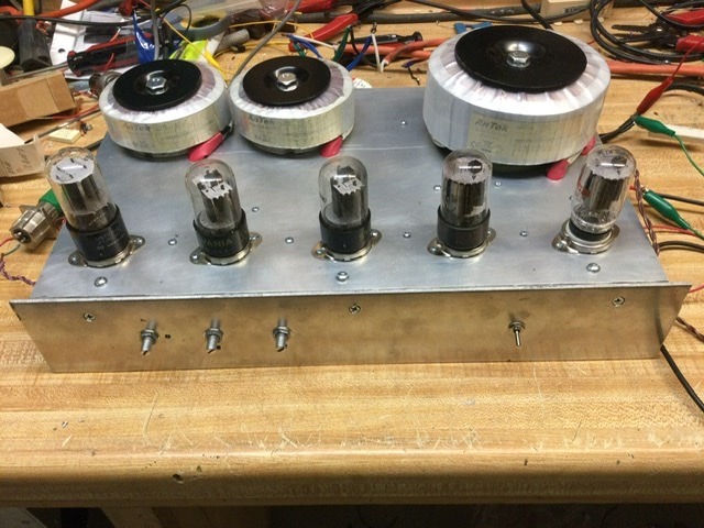

Why would you need that much drive? I ran 10EM7 power triodes off a 250 volt supply and the driver was able to supply the needed +/-37.5 volts. Not much to spare off the concertina, but it worked, cleanly. You need a bit more than half that to drive CW5’s. Sounded pretty damn good for an all cheap toroid amp.

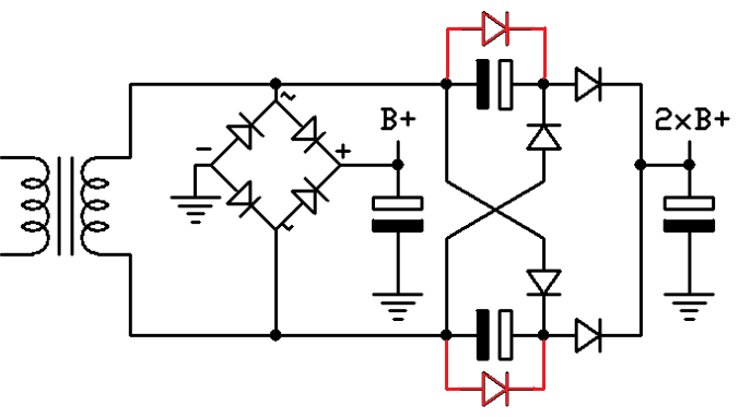

* Adding an extra transformer or a 4X8 voltage doubler to boost the HT for the driver stage. Probably the best and easiest way to do it.

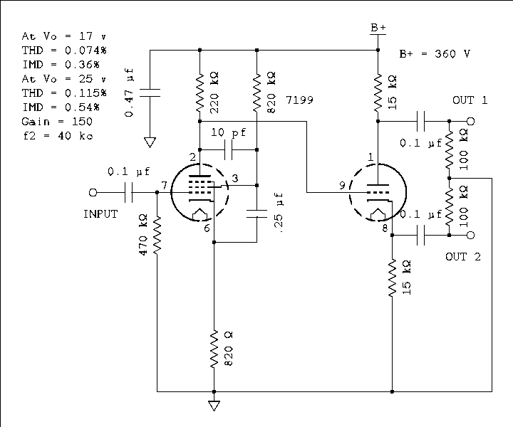

* Using a Mosfet Concertina phase splitter that can swing rail to rail.
I see… local feedback on the finals. With some schemes it needs more oomph than pure triode. I’d probably just add extra B++ if not much current is needed. Another surplus transformer and you’re in business (One that only cost five or ten bucks). Or a home brew wind job, which I tend to do. Even in normal pentode I’d end up doing that - separate plate, screen and bias voltages. Easy to add a higher B++ for a preamp if your already going to that trouble.
Mosfets can swing rail to rail, but if you don’t want coloration you need to keep 25 (sometimes up to 50) volts on them. To keep the capacitances from going horribly nonlinear, which is the reason for avoiding solid state in the first place. The usual 300 to 350 volt supply seems to be the reasonable way to go.
I was originally going to run CW5’s with those OPTs, but I didn’t want to spend the time to wind a custom power trafo at the moment. I had an off the shelf power trafo on hand that was perfect (maybe a bit oversized on VA) for running those horizontal amp triodes - in PP class A. Threw one channel together on the bench as an experiment, and later that afternoon started a full build. Now I’ve got to get another pair of those OPTs. Probably a couple more, at a different secondary voltage too.

I intend to run the output tubes "low and hot" at about 200V 60mA for about 14W of class A operation, fed by a 165V tap on the power transformer and filtered with a simple CLC filter. Not much voltage headroom for the drivers with that power power supply even though I possibly could get away with a Concertina phase splitter followed by a balanced pair of low mu triode drivers, like 12B4A or similar.
This would allow some interesting additional local feedback loops but adding a higher voltage rail and using two PC86s as an LTP input/driver stage would be less complex and probably sound better.
Been thinking a bit more about this subject. The power transformer has a high current 9,6V winding that I intend to heat the input/driver tubes with. PCF80 (9A8, or 6BL8 with a 9V heater) would fit the heater winding quite nicely (I have ten or twelve NOS Philips), and if I use a 4X8 voltage doubler to get a 400V rail I might get enough linear swing out of a Concertina DC coupled to the previous stage using that tube. If not, I could pick tubes that can swing closer to zero volts, like 6DJ8 for input and 12B4A for the Concertina.
