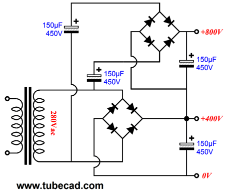

I have a amp i made almost 50 years ago where I just stacked 3 bridges on top of each other and put caps from the the middle briďge ~ inputs to ~ the next in both directions to get -300v,+300 and +600v. I stacked the output caps too.
I guess both would work equally well, and both should be able to deliver the 30mA or so needed for a decent input/driver stage. Perhaps a small negative voltage could be derived in the same way from the 9,6V winding?
Yes, sure, but at 9.6v the diode voltage drop may need consideration. I used doublers quite often, especially at high voltages and lowish current, or if i had to stack caps and/or diodes because of voltage limitations anyway. I also used multistage multipliers as crude, but almost lossless constant current sources for feeding shuntregulators by adjusting the capacitances connected between the ~ inputs
Since I probably will need to elevate the 9,6V winding at some level above ground to avoid hum problems, it might become messy to use it as a source for a negative rail at the same time.

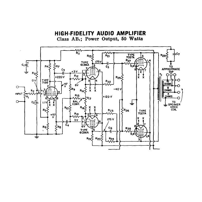

I've been peeking a bit at the RCA 50W amplifier with nested feedback. Perhaps a similar input/driver could be made with 2* PCF80 per channel, using the triodes for input and concertina duty and the pentodes as balanced drivers with local feedback loops from the output tube plates to both driver plates and driver cathodes. More complex than the stuff I usually build, but food for thought:
Yes certainly, you need the freedom to be able to elevate the heater.
I remember to have seen something with a E or PCF82, but I cannot remember where...if it comes back i let you know

Fuling,
Your Post # 162
Danger . . .
That is ready for the electrolytic capacitors to short, open, or Explode!
There are two electrolytic capacitors that have the + end of the cap connected to Both an Anode, And a Cathode.
That means the capacitors will be reverse biased 1/2 of the time.
You will need to use non-electrolytic capacitors.

6A3sUMMER: That schematic is just something I "borrowed" from Tubecad as an example. I agree that it does look a bit suspicious. If I decide to build something like that I'll probably use large film caps.

Posting a schematic that will blow up, is like lining the farmers field with LandMines.
Newbies Beware!
Do not use that schematic that is in Post # 162!
And Tubecad . . . stop doing that kind of thing!
Newbies Beware!
I googled a bit and found a similar schematic on another forum. Here's what some people had to say about it:
However if the upper rail is shorted, the caps receive a variable dose of AC.
No. In normal operation they are correctly oriented on the OP's schemo.do those caps need to be bi-polar?
