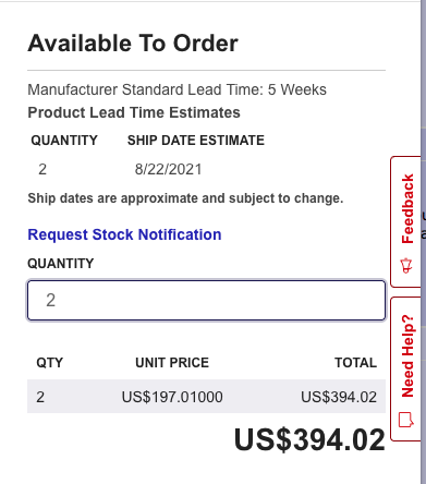

I put a couple into a Digikey shopping cart and got a probable ship date of August 22. Then on the cart list it showed 'Backordered'. My experience has been that backorders usually ship. Often before the date they gave.

Well it’s probably going to take that long to get everything else put together anyhow, and I would also venture digikey is a big enough company to make it happen or return funds if it doesn’t.
So what say all, is the visaton the my most viable avenue to success? Here again there is also another set of speakers in my collection that I’m sure would benefit a visaton on top if it doesn’t work on the mtm.

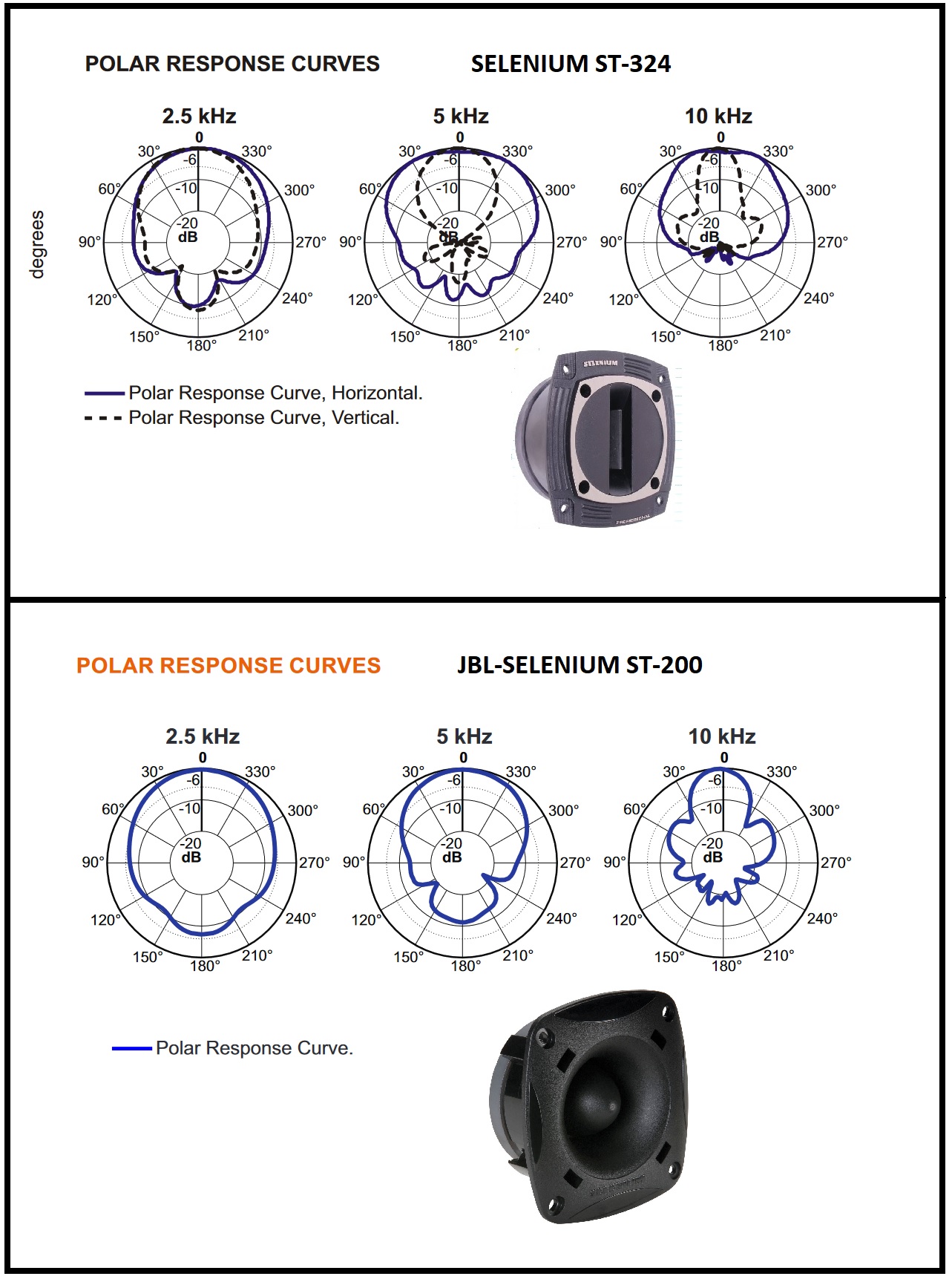

The ‘rat shack’ tweeters seem to have a decent fr curve Radio Shack / Realistic 40-1310 Horn Super Tweeter
The curve is good on-axis, but like the JBL 075 or 2402 bullet tweeter, the dispersion is extremely narrow, dropping to around 20 degrees at 20 kHz. If you can hear up there, you won't hear it other than in a small circle ;^)
Of interest, if a 2405 diaphragm is used in a 2402, the on-axis response increases in level with frequency. IIRC, in the variant 16kHz was at least +3dB dB up from 8kHz, while the stock bullet drops about 4 dB in that octave.

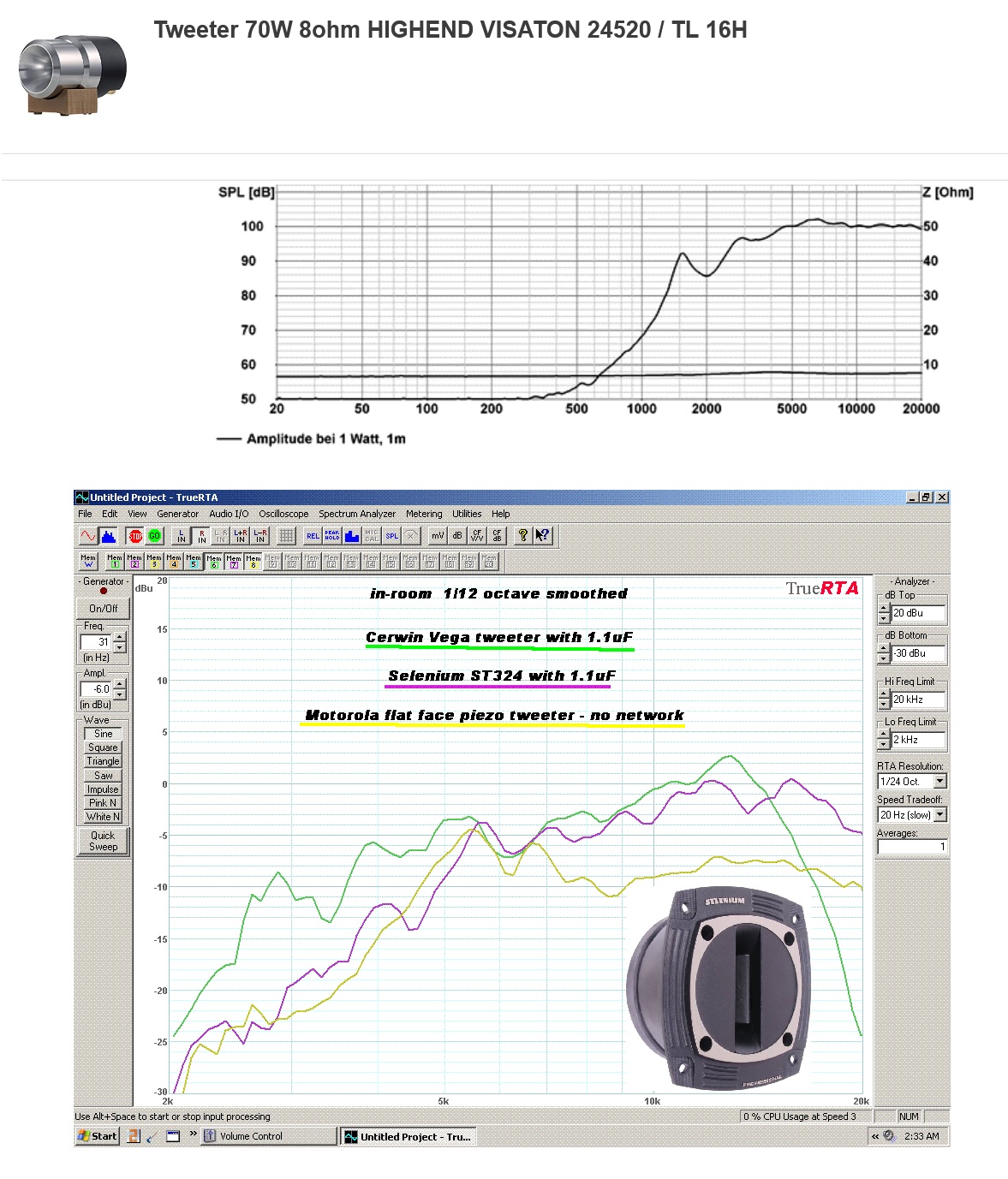

At least the Visaton has published polar plots that look legit. You'll know what you're getting into. There just isn't a lot of info out there about any of these drivers.
The Visaton looks head and shoulders above the rest of their line-up. Makes me wonder if it was a pet project that went commercial.
I had either an Audax or Polydax budget bullet tweeter which made a perfect on axis graph to 20K but preferred the cheap and cheerful Selenium ST324 and its heavier aluminum faceplate relative, ST320. Did the craze for bullet phase plugs drive the slot variety out of existence ?
(btw - it would have been interesting to drive that flat face Motorola piezo with a step-up transformer)
