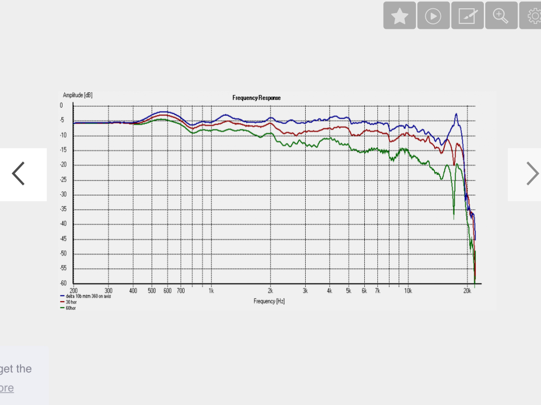

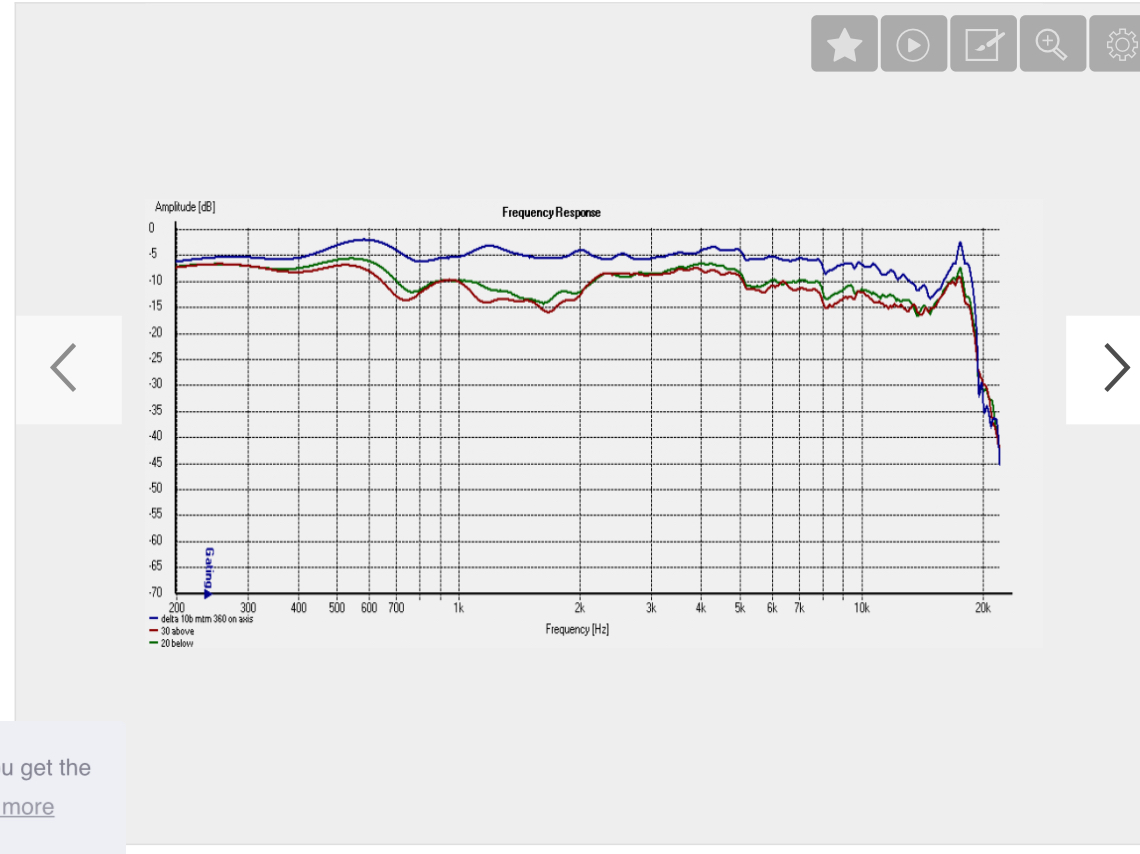

Allen, apparently they have very narrow vertical with wide horizontal dispersion......member ICG mentioned it somewhere in there....the mtm I'm building are described the same way.
the 20 deg of vertical coverage the future mtm will provide will be centered optimally for the seated position.......im afraid there will be a higher freq dead zone when standing.
all hypothetical at this point.......just seems like the perfect setup to try super tweeters.

I'm sceptical about generalising MTMs that way. D'Appolito originally intended the MTM to widen the vertical lobe through the crossover, and a dome tweeter used above that is going to be wide vertically.
It’s actually not as bad as I thought, I remembered it as 10db down not 5db.
My plan is to eq out that spike @ 18k+/- and fill down to around 14k with super tweeter/series cap (6db) looks like that should work well?
