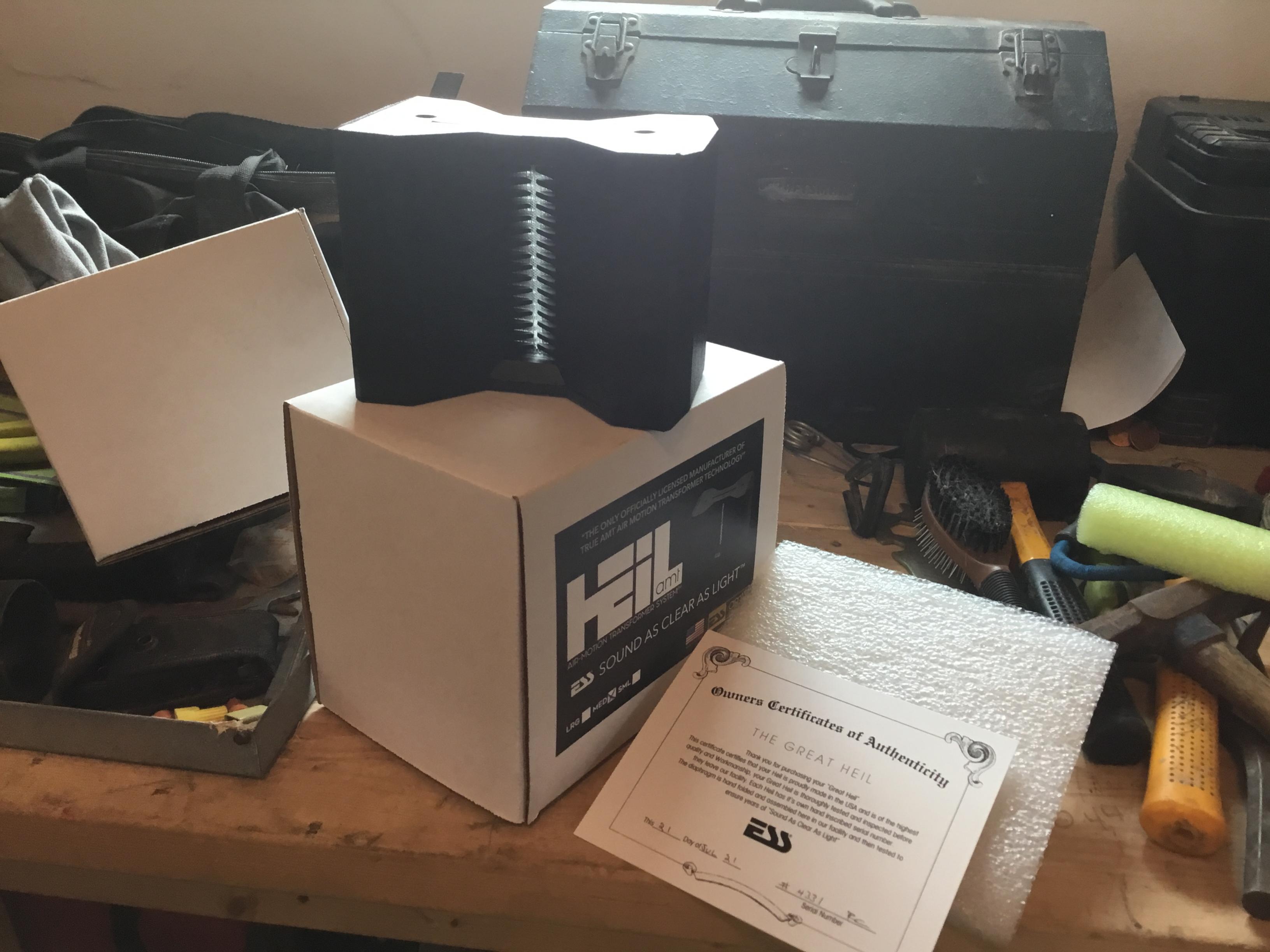

Not sure if I’ll get to do much with it today but maybe set em up on top of my ns670 and try with a 1uf series cap just to hear them.
The ns 670 would probably benefit the least but it’s all that I have set up at the moment.
