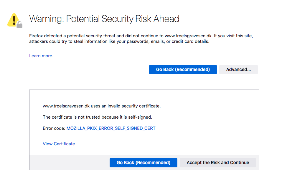

Pano, I remember Troels made a mini reviews of super tweeters, included the Visaton in the Loudspeaker I pages if my memory serves me well, but often it doesn't ( The Loudspeakers II ?)
I remember seeing that page too and tried to go there just now. Firefox took issue with it. So did Safari . . . . .
Does everyone else get this?

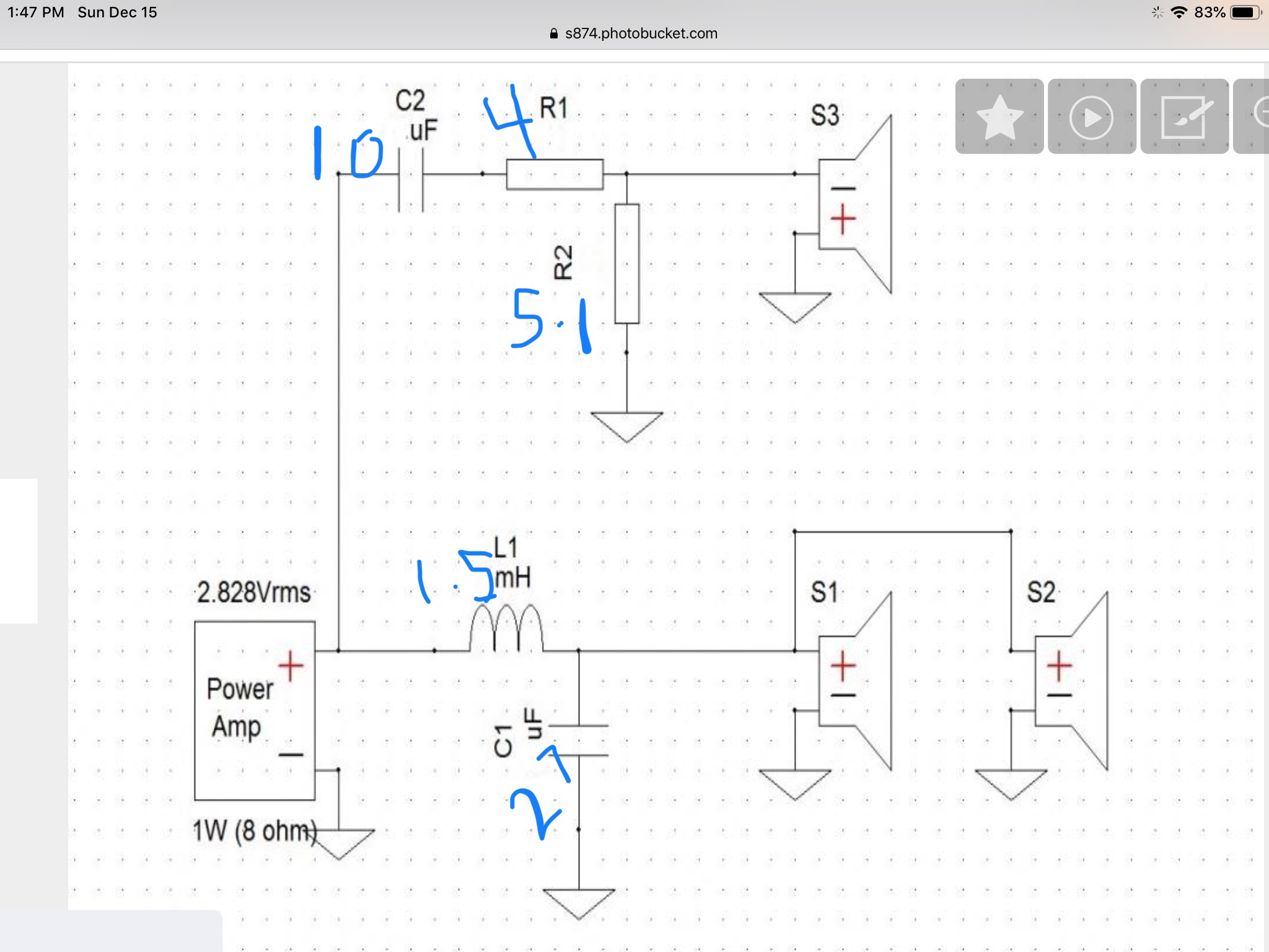

Here’s the original link and I’ll also post the XO values as they were not supplied in the link. Driver are B&C de250 and eminence delta 10b (16ohm)
Fusion 10 Max Official Thread | HiFiCircuit
