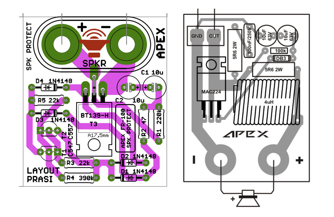

I have found two different speaker protection circuits done by Apex. Which one to use with SR150? Is it possible to use them with another amplifiers - my Sony receiver, for example?
This type of circuits - could damage Your amplifier, be careful.

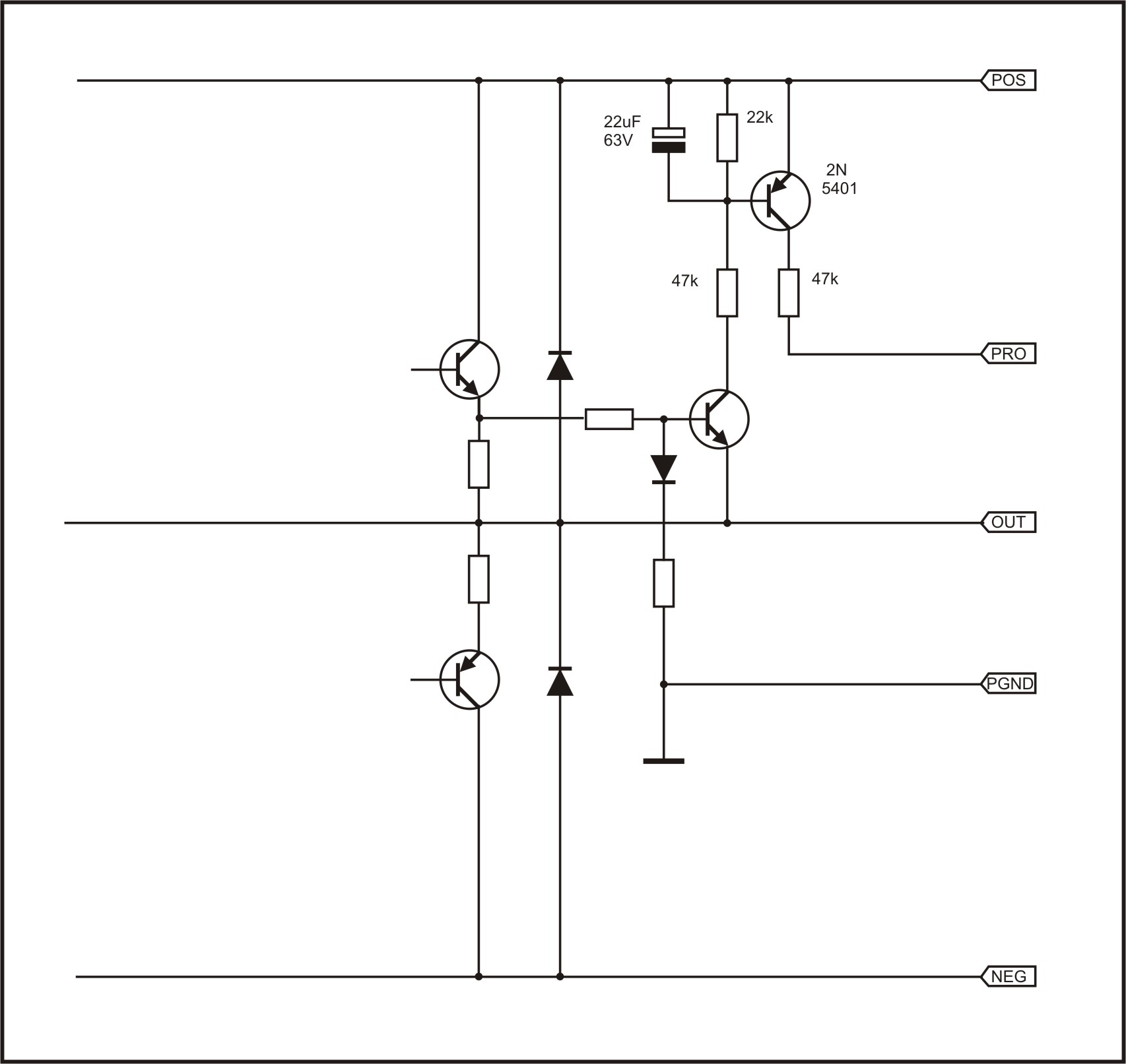

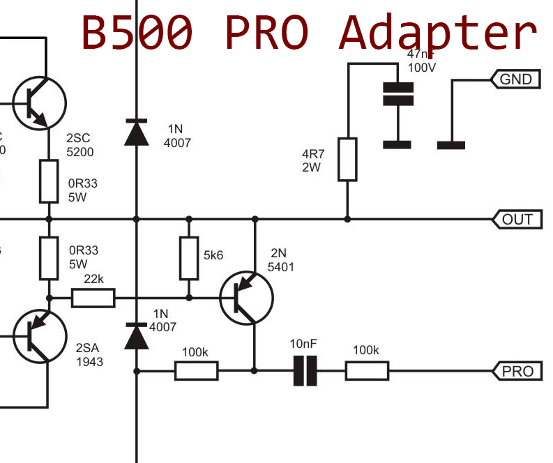

i want to add limiter(NSL32)
and pro adapter for SR200 which one will you recommend to be used in DC555 and H900 Protect circuits i like to often use these relay type protect.

Use this circuit.

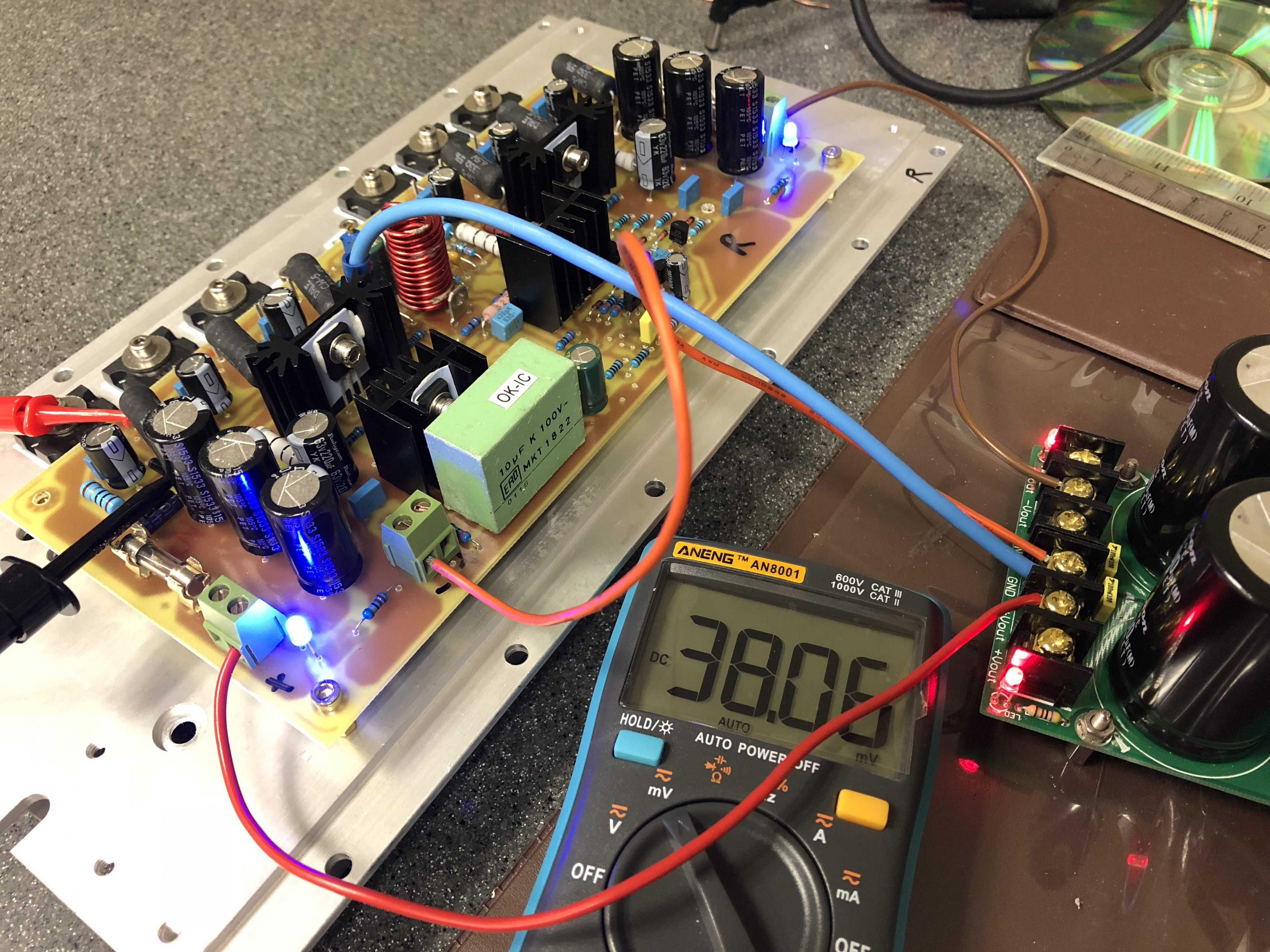

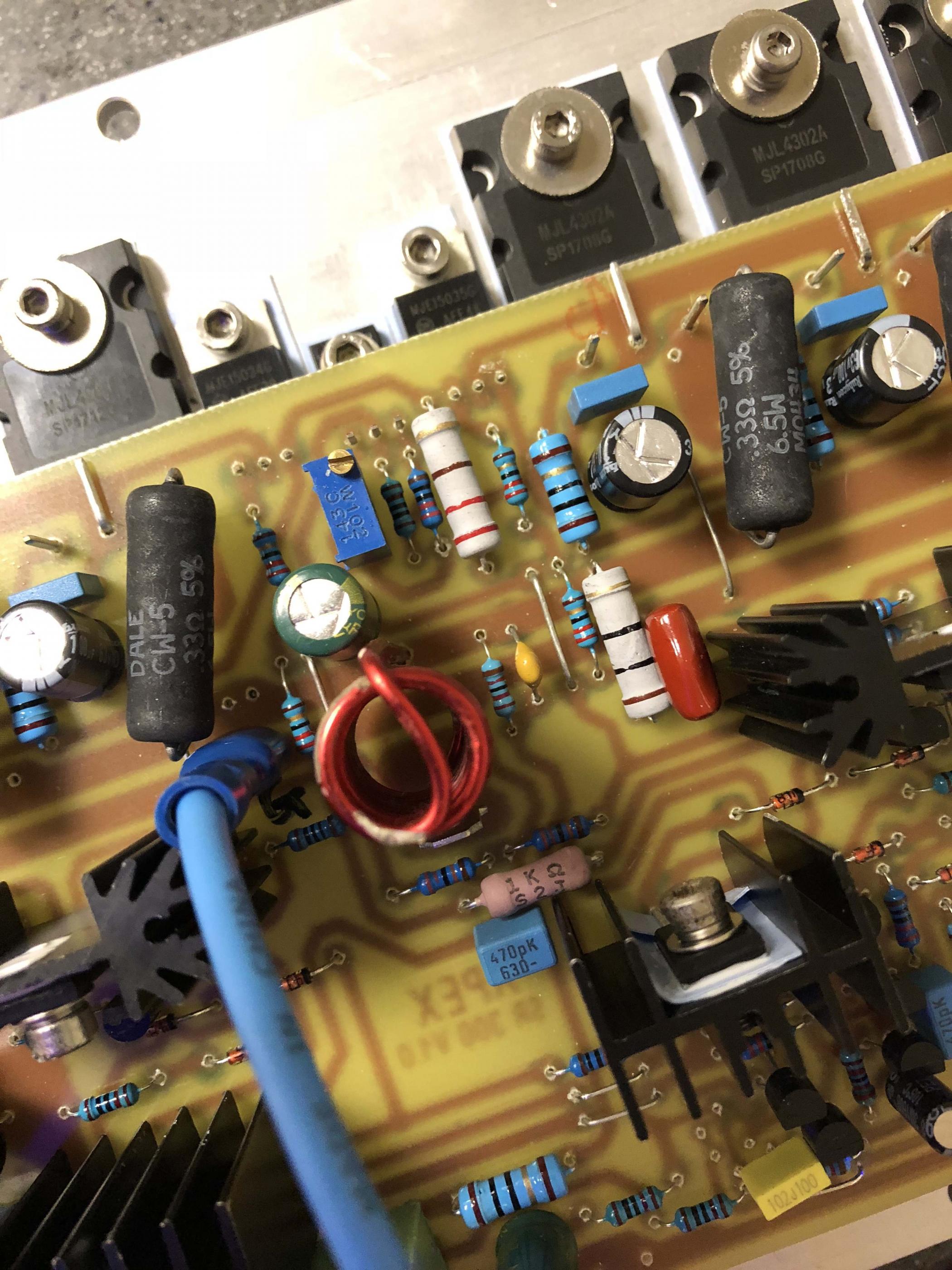

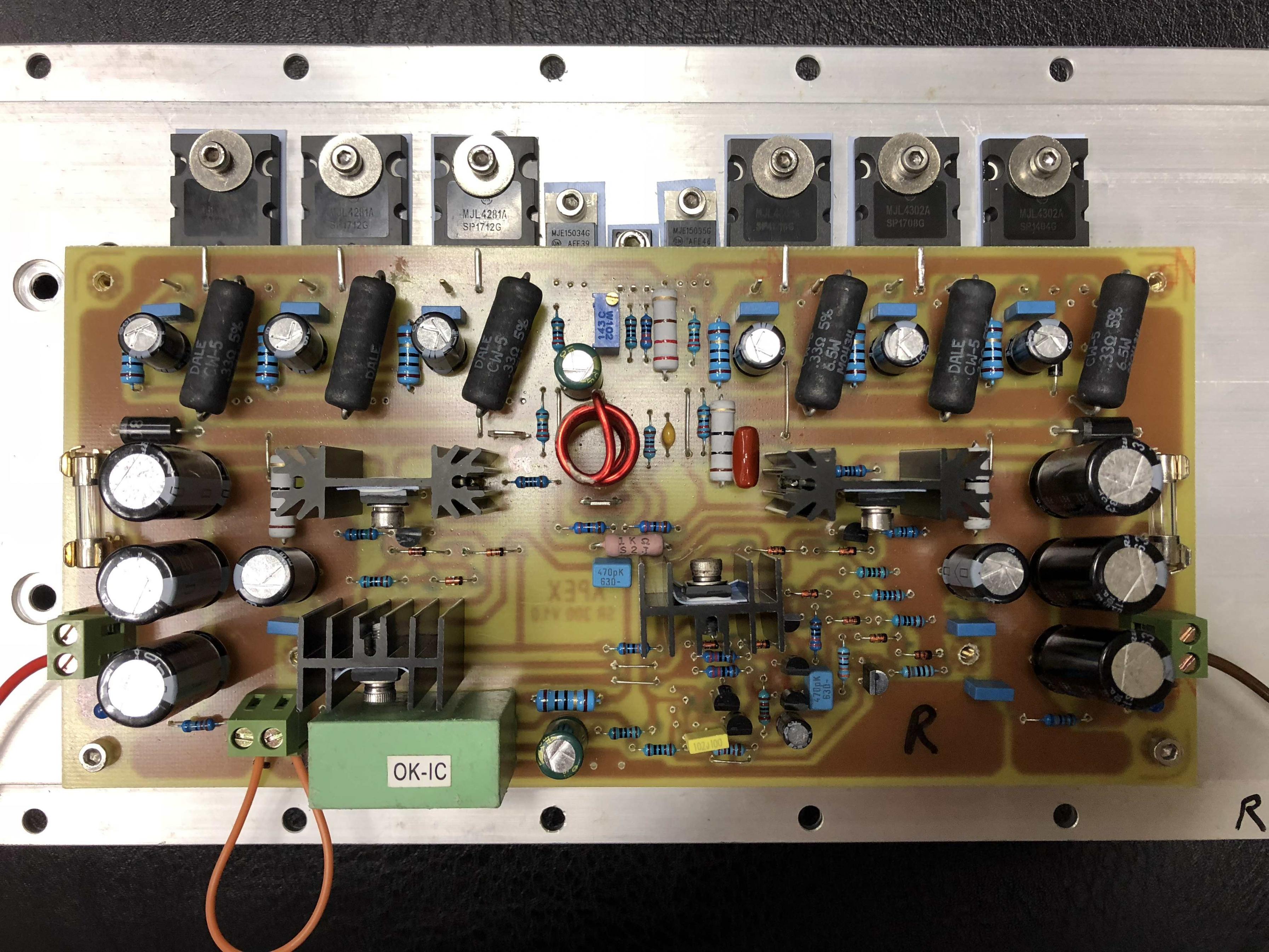

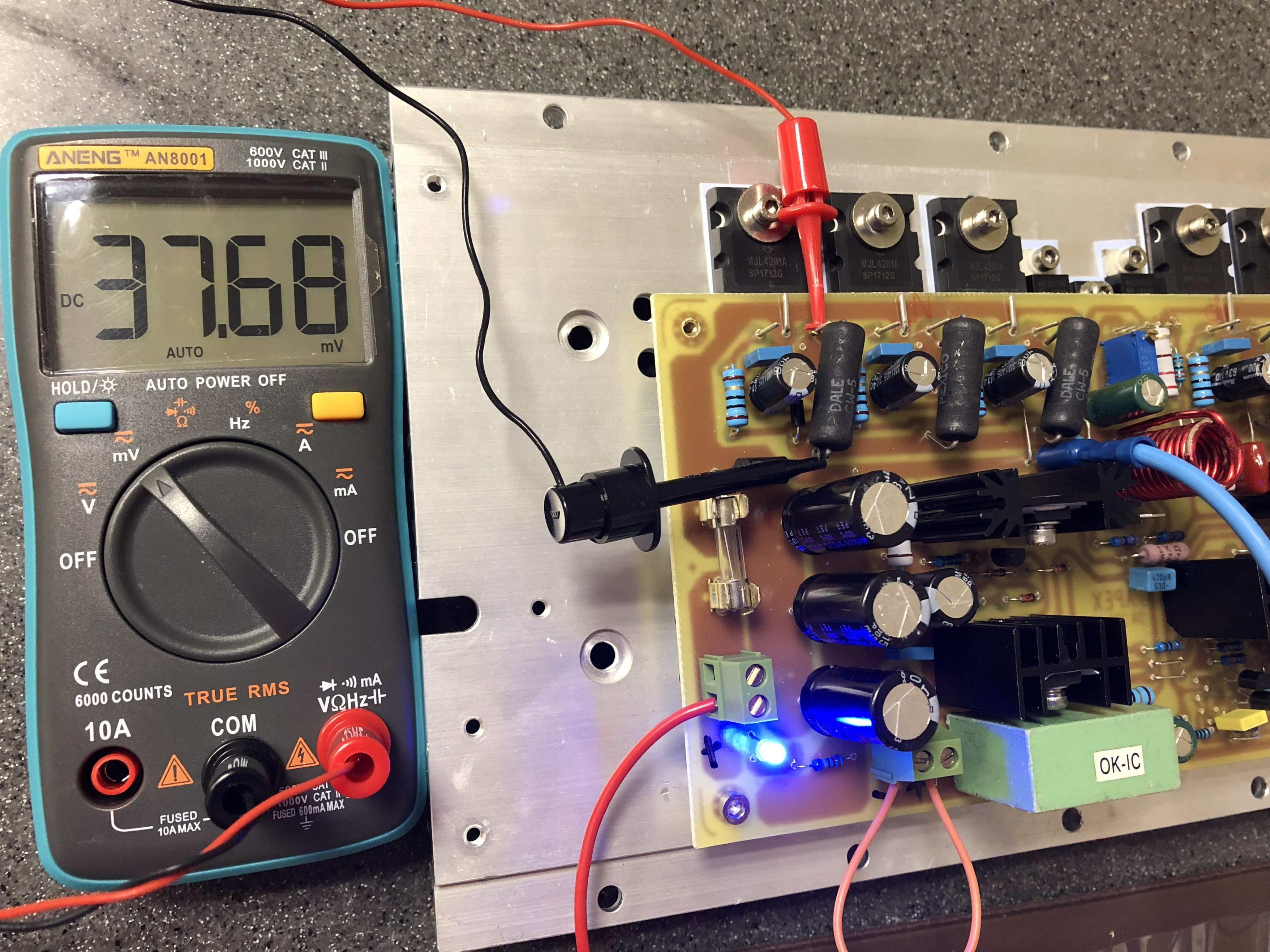

Hi, every one , I just make a SR300, apply +/-50, I tuned bias maximum is only 120mA, It is normal? What is the design bias?
Thanks! my English not good! (I use MJE 15034, 15035, MJL4302A, 4281A)
Can you post pictures?
I tried, same result!You should also connect the input GND to power supply GND
38mV isn't something wrong for an amplifier without servo.
Using matched pair at the input stage you can see lower offset voltage.
As i can see you have the signal gnd connected at power gnd but amplifier input is open.
It is 0.33R voltage, not output offset!38mV isn't something wrong for an amplifier without servo.
I want to know SR300 maximum BIAS is about 120mA is correct or not?
A sorry,yes i see now the test leeds.
Can you post schematic diagram?
Is it a classA,for a class AB it is a little high.
I follow this Circuit to build, (SR300 alex mm #2515)Hi,
120mA is OK but if you want set higher bias replace 1k resistor in bias circuit to 1k2... nice work
