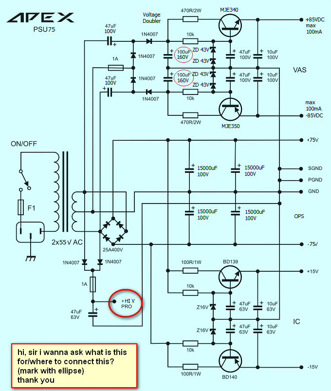

thank you so much for the advice sir, i will then make a list of components for that 800W amp. and try if i can make such amp work.
i will first use that psu 7 for test (shown on pics) using small 42-0-42VAC trafo.
then if succed i will make PCB for PSU75. may i ask which is more reliable 2x15000uf or 3x10000uf per rail? how about caps impedance?
further, does this need to be regulated or not?
thanks,
regards
Please show as the schematic or link of your choise for that 800W amp,
maybe we can help you analyzing the schematic and find possible errors,
that is everything OK, before you start the project.
Like AndrewT already told you,

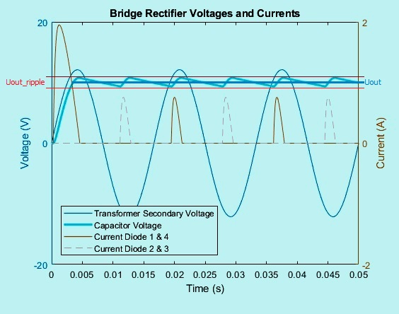

the U_out _ripple with same load would be equal with 2x15000uF or 3x10000uF bulk elkos .
But if we look the inrush currents from trafo through bridge rectifier diodes to the group of bulk elkos,
the first of identical elkos in the group/bank (who has the shortest leads/path to bridge rectifier) will suffer most inrush currents.
Good practise is use some smaller elkos in "first" place, then follow with big ones:
for example
-from trafo secondary we put the secondary snubbers, (see Mark Johnsons secondary trafo snubbers)
-then power bridge rectifier with rated voltage and current,
-then we start paralleling 1uF//100uF//1000uF//15000uF//15000uF bulk elkos in group/bank
and from the last 15000uF we then take our PSU OUT
If you look in below graph, bulk elkos bank is charged from trafo through bridge rectifier in pulses (see red pulses)
and those are very high amperage inrush currents with use of some very big bulk elkos.
R_esr*(I_inrush)^2 = P_bulk elko ESR losses and elkos will dried out faster with exaggerated losses.
So we must find ours bulk elkos with:
-nominal/rated capacitance and rated voltages
-with low ESR (10 - 20mOhms), low ESR losses
-Ripple currents @ low freq (10A @ 100Hz), those are elkos inrush currents
-Life time @ rated temp (example 5000hours@105°C)
-tolerance of rated values
The OutputPowerStage (OPS) (Drivers + Output power pairs) can be unregulated,
but input stage with VAS and predrivers if we have poor PowerSupplyRejectionRatio (PSRR)
then is almost mandatory use of good regulated PSU for that stage.
See Apex PSU75 for details :Voltage doubler with Cap multiplicator regulated +/- 85VDC (100mA) PSU

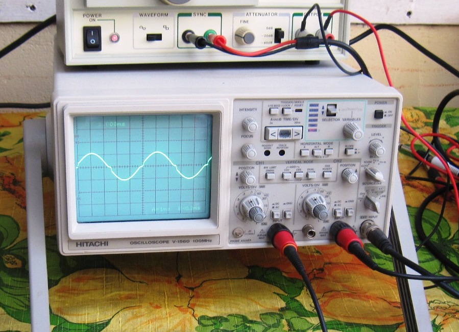

crossover distortion can only be observed accurately using a scope....
saminnografix,
keep in mind that all computations presented here
are engineering estimates.....they may or may not jibe exactly with
real life measurements....
only FTC testing of your built up amps will confirm what you really got...
this is how cross over distortion looks like on a scope...at 2.8v ac into an 8 ohm dummy load and 1khz signal input...

unfortunately sir i do not have one. i used to test with the help of university professor and his scope before but this year he went to la union for his doctoral so i only use my ears in testing with Analog and Digital MM companion. i am not Electronics but i have basics of electrical course. i am a student and manage to live with my few phpeso from Electrical and Computer servicing.
besides, thank you for the advises of diyers it fertilizes me and hope to grow somehow.

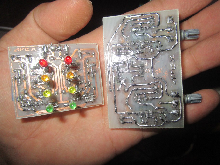

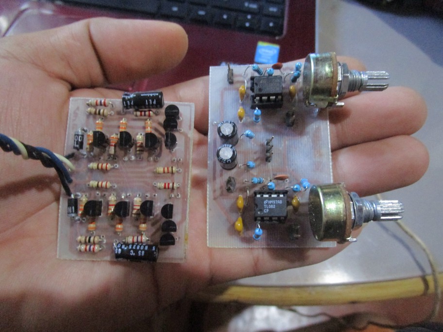

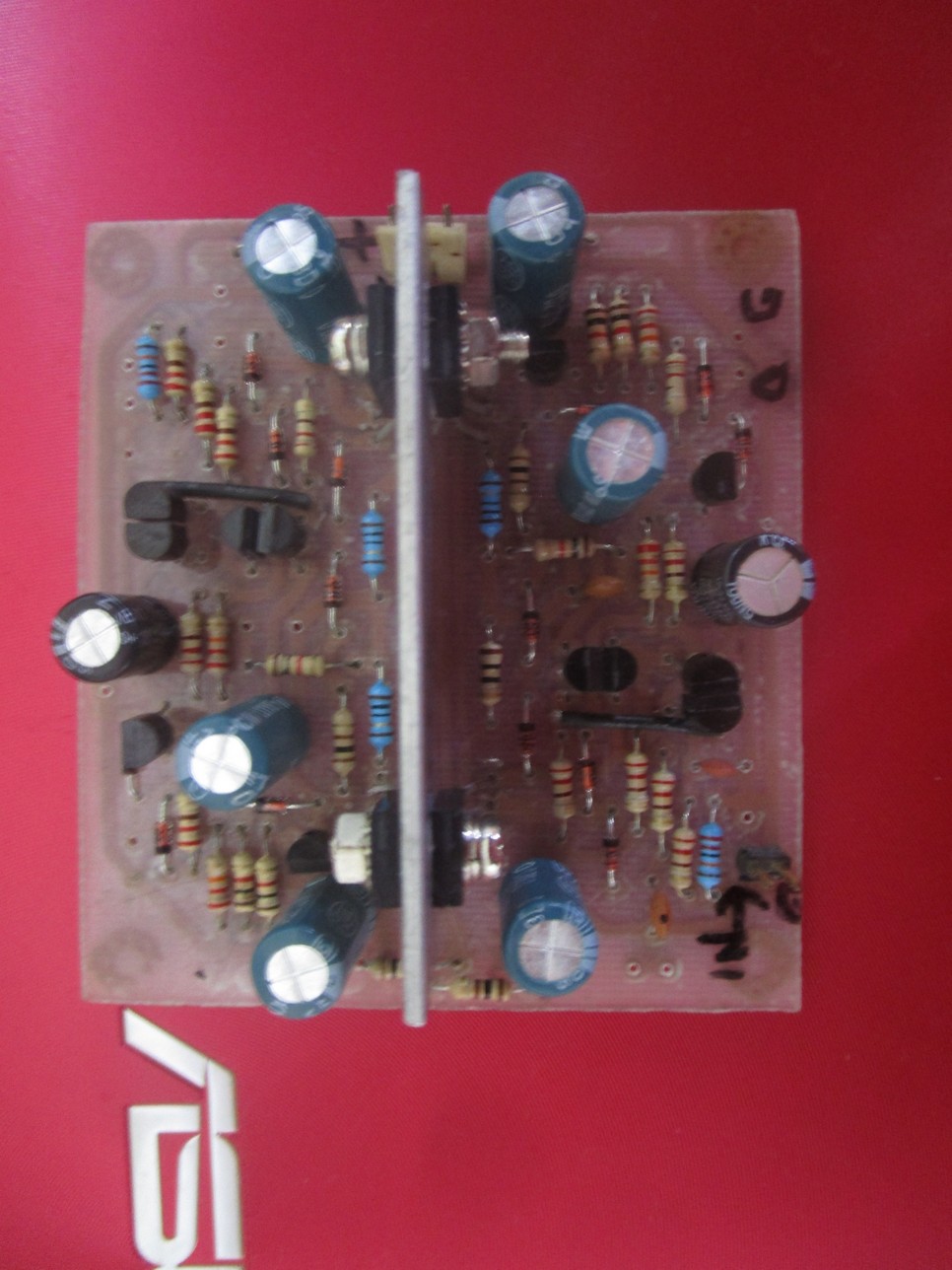

SR PP8 working good does the BD's 139/140 needs heatsink because i already did.
here are some pics and would like to have some suggestion if its ok to use.
2 x SRPP8 + OP Line amp to 2 x SR200 amp.
regards,
SAM

hi sir,
where/what in the use of +40 Pro for
thanks
+40V PRO is for protect suply... no need to be use.

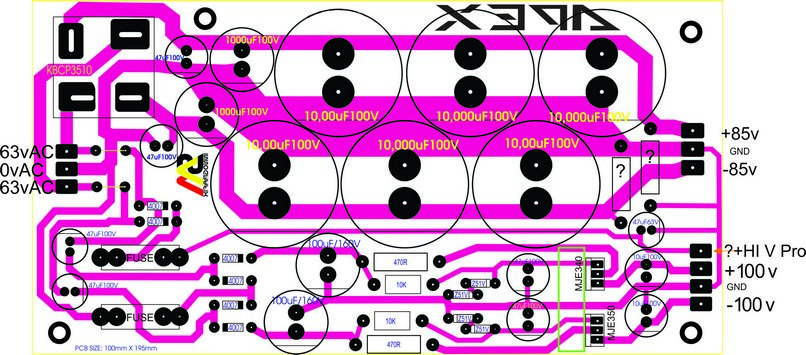

PSU
thank you sir
here is the PSU please see if it is correct. i will add the +/-15v on the other side later for 5pair SR.
thanks again
sam

why use thin traces?, fill the damn thing with copper where ever you can... copper on the copper clad is free, why waste it? etchant (ferric chloride) isnt free either!
regards
Prasi

thanks for noticing but i have drawn it in one stroke only, i intend not to fill it to aid checking i'm not an engr. like most of the people here--just a hobbyist, on final i will just give 2-3 mm distances (to minimize loop - as some diyers often advise).
regards
sam
