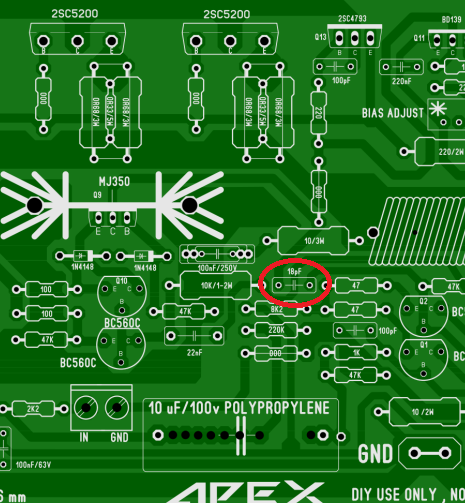

Hi mister Mile, hi Alexmm,
I started populating the first channel of my SR-200 amp. The PCB (v3.2) designed by Alexxmm has a cap of 18pF which is not on the schematic. The cap is connected between the collector of Q9 and the base of Q2. See attached picture for details. I have a few question in regards to this cap:
* What is the purpose of this cap?
* is it required?
Thank you.
* is it required?
Thank you.

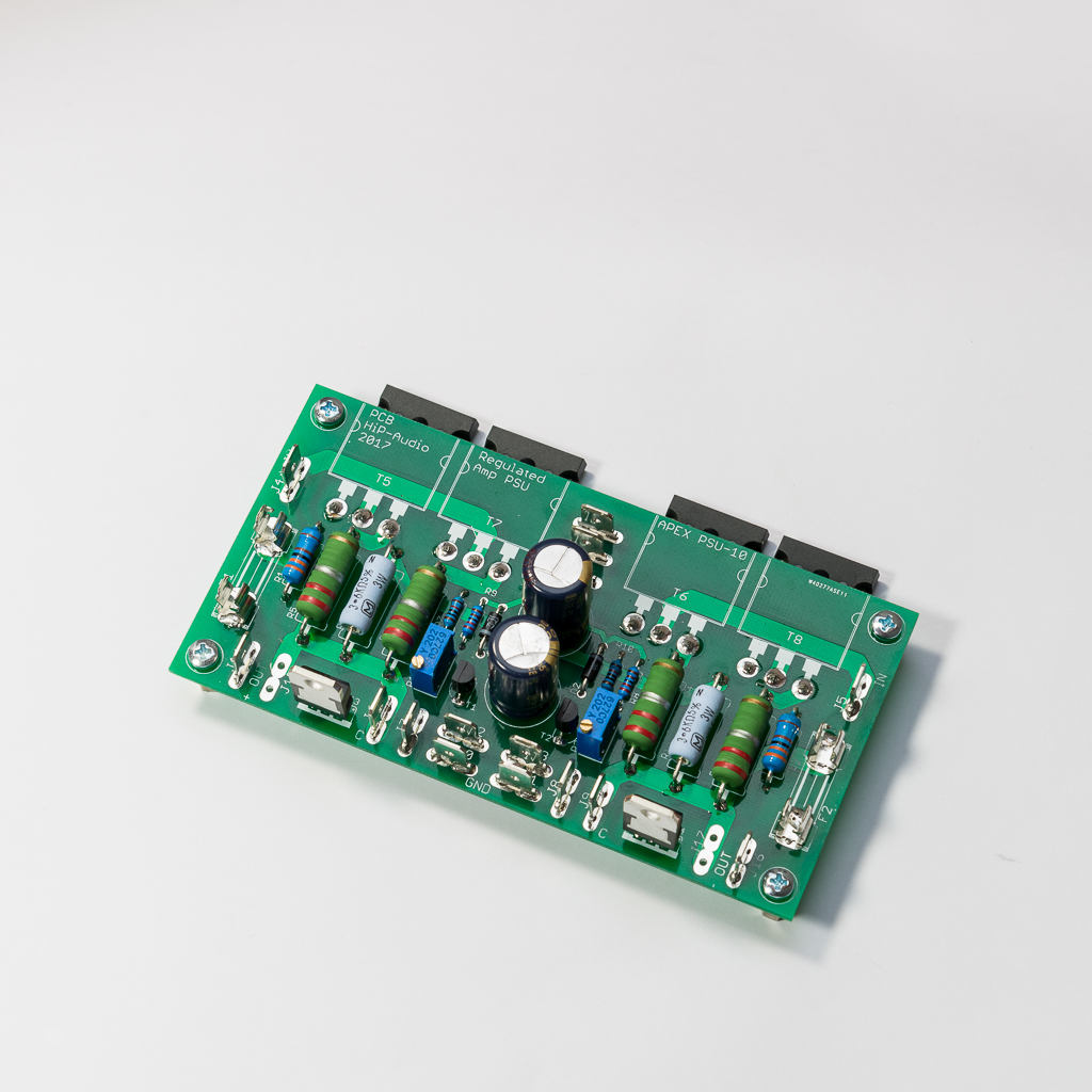

PSU-10
PSU-10 assembled and tested.
Since I only could attent 83 volts max with my lab power supplies I used that voltage as input of the PSU-10. According to the schematic it should be about 92 volts (65 volts AC). With 83 volts input I'm able to adjust the output between 68 volts and 81 volts. When lowering the input voltage, the adjustable range reduces too.
I will do some experimenting with resistor 2k2 (instead of 3k3) and 12 volt zener (instead of 20 volts) and 70 volts input. That should give me an adjustable range that includes about 60 volts output.
During testing I found out that there is an error in the Eagle library for the MPSA42 transistor. The device in the library has C and E pins reversed...
I attached a picture of the finished PCB. Note that the big caps are off the board.
