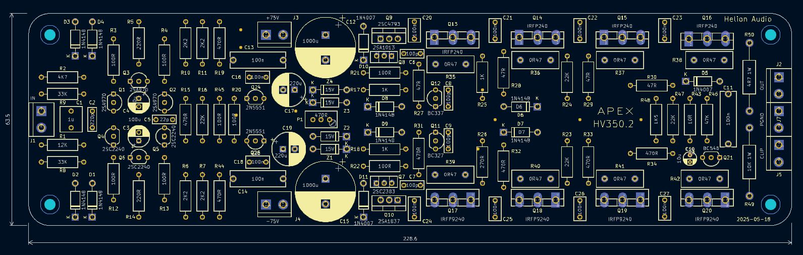

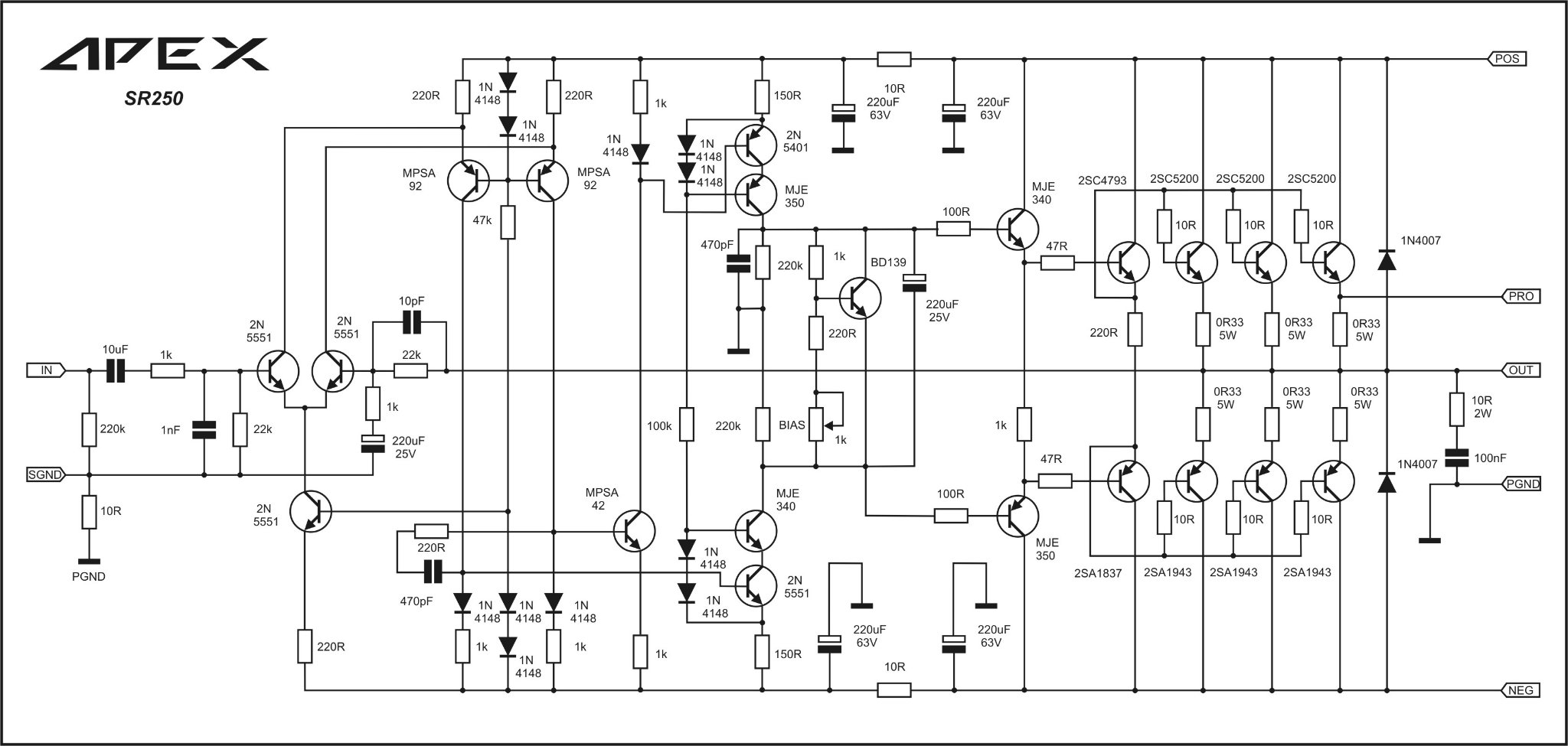

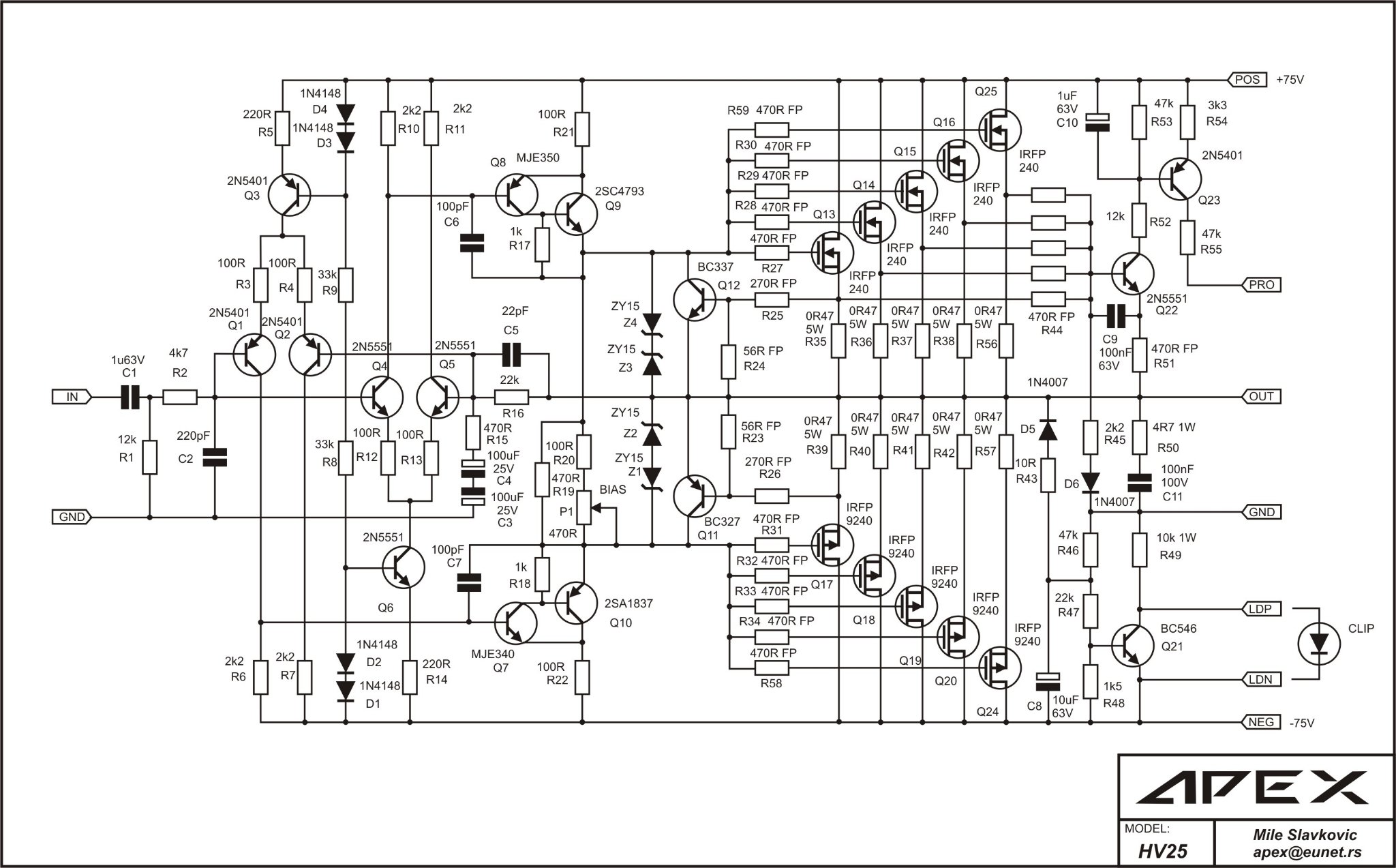

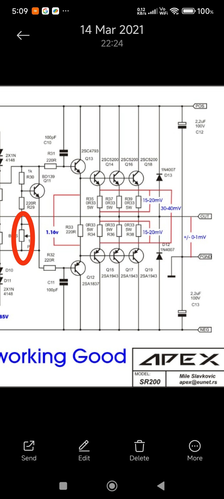

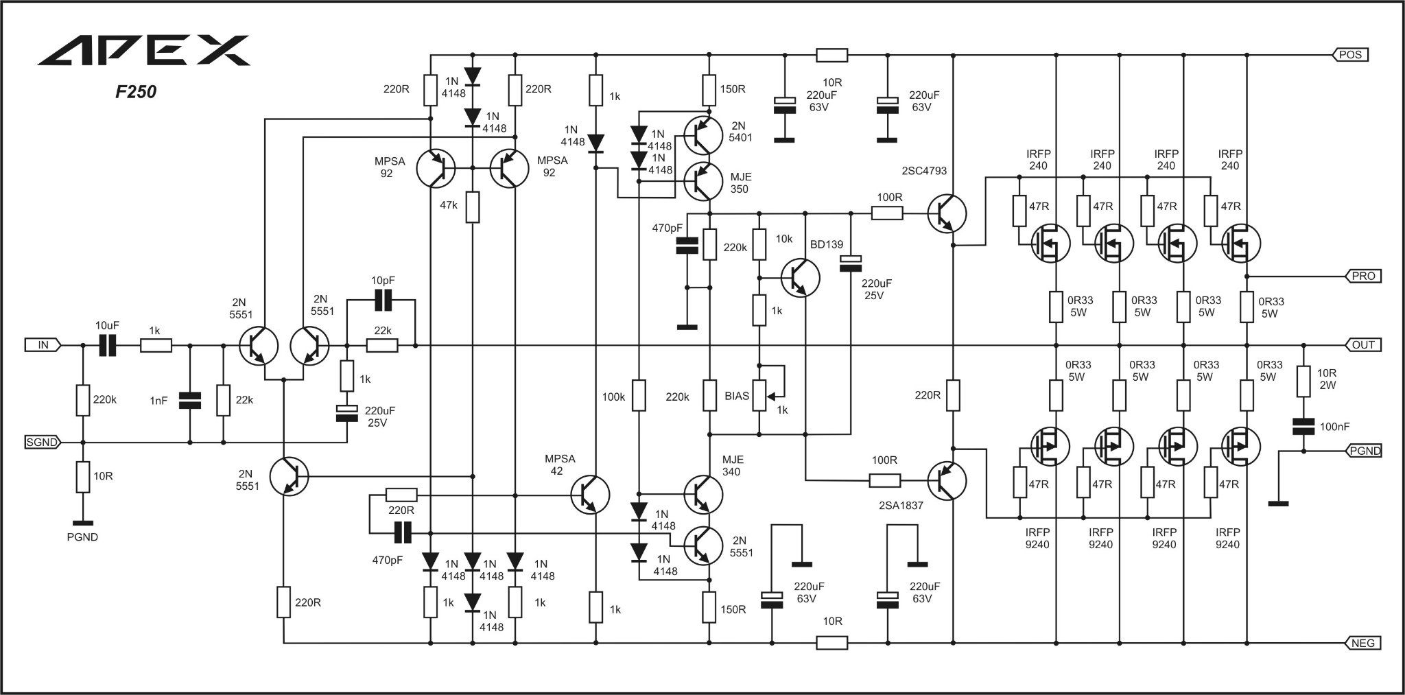

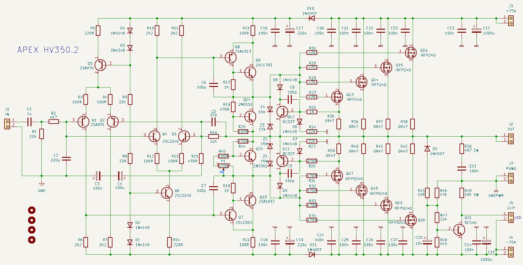

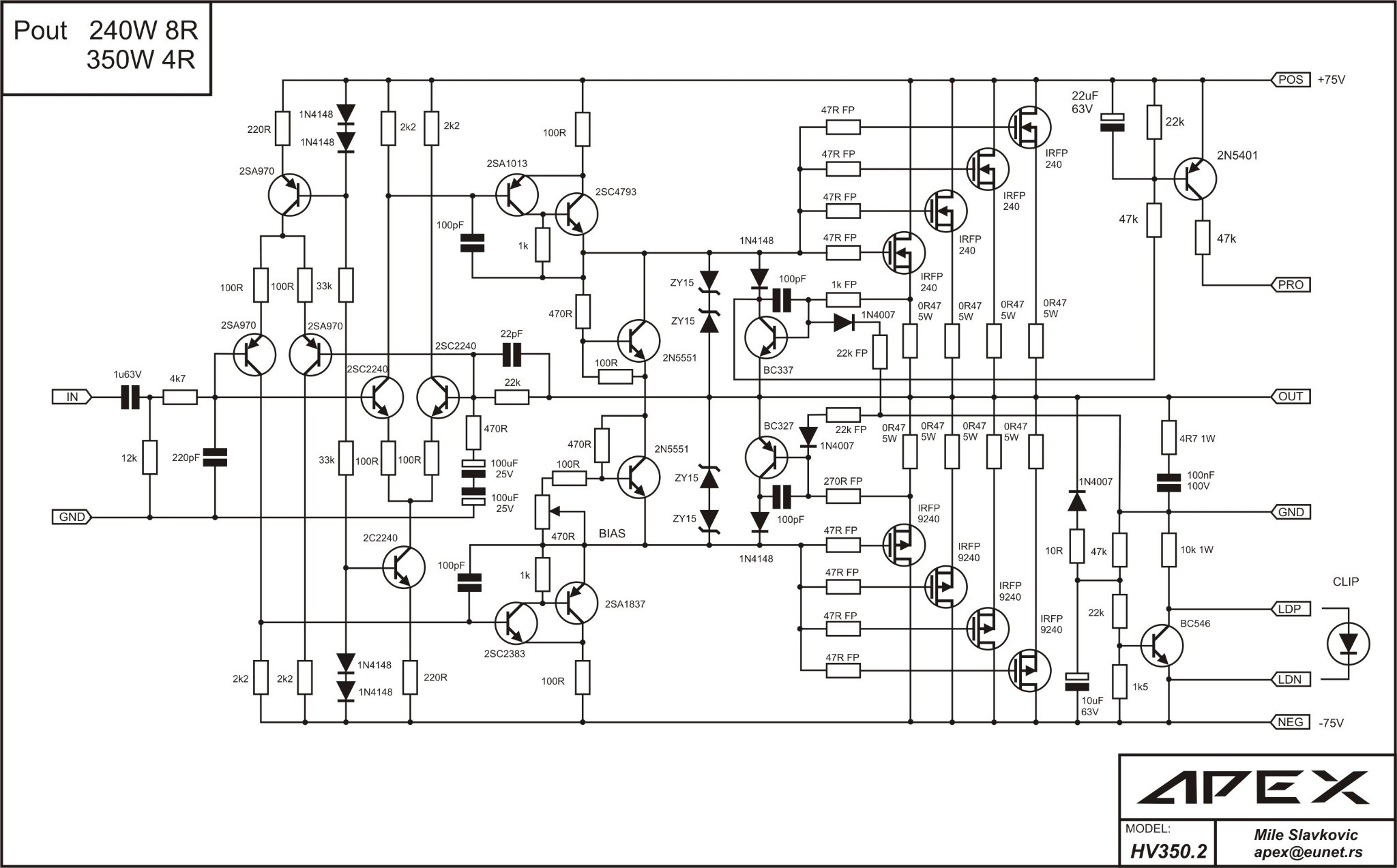

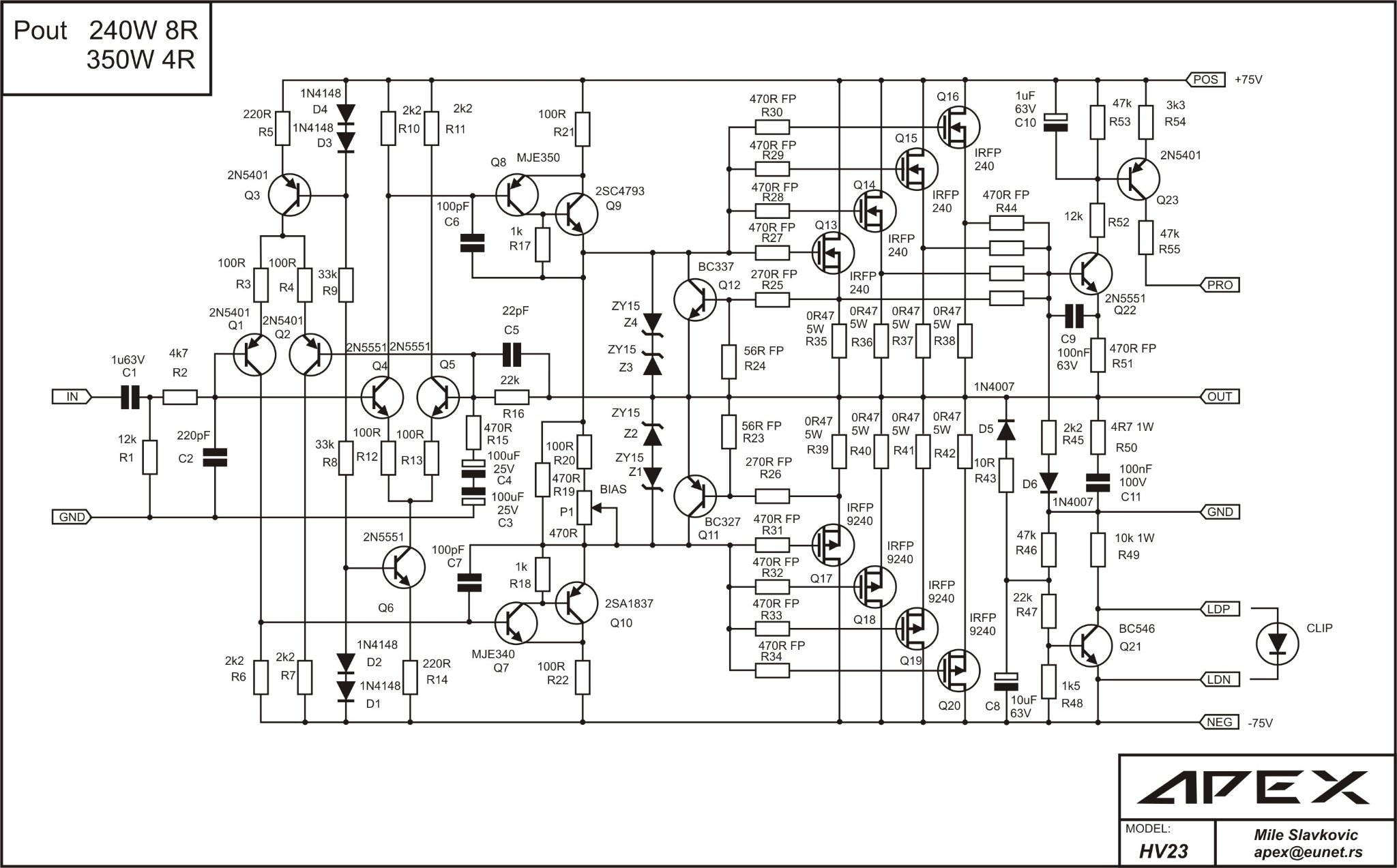

Together with a friend, I want to build one of the higher powered APEX amps. We already have a few decent transformers in the 800-1200VA range which needs to be put to work.
At the moment I have come down to 2 different basic designs in 5 (not so) different amplifiers.
Not having the expertise to immediately say which of these would be the better choice, I ask the experts.
The ones I have in mind are the following_
Non symmetrical input: F250 and SR250
Symmetrical input: HV23/HV25 and HV350.2
I have a few questions:
1 - Is one basic design "better" than the other in these amps?
2 - In each group, which amp is going to perform "best"?
3 - Is there a clear overall favourite? (Which one would Mile recommend?)
4 - What supply voltage range is usable for these amp?
Thanks for any input on this!
🙂 morten

These designs need a boosted VAS voltage to deal with the MOSFET threshold voltage loss and the degenerated VAS loss, which is required by the symmetric IPS (and/or cascoded VAS). An extra +/-6 to 10V would be appropriate. VI protection creates an abrupt output impedance change when in protection that has undesirable results. I would use it to activate an input reduction so that the protection is not fighting with the global feedback. I assume you have built a few amps before. Building a high-power amp is a classic mistake that beginners make that inevitably leads to much sorrow.
Thank you for your thoughts. I have built a few amp, but I don't design amps. So I try to gor for proven and finished designs, or at least some that I think are.
That's why I thought APEX would be a good choice. They have benn build using the published schematics for many years, as far as I understand.
To modify them would be above my understanding.

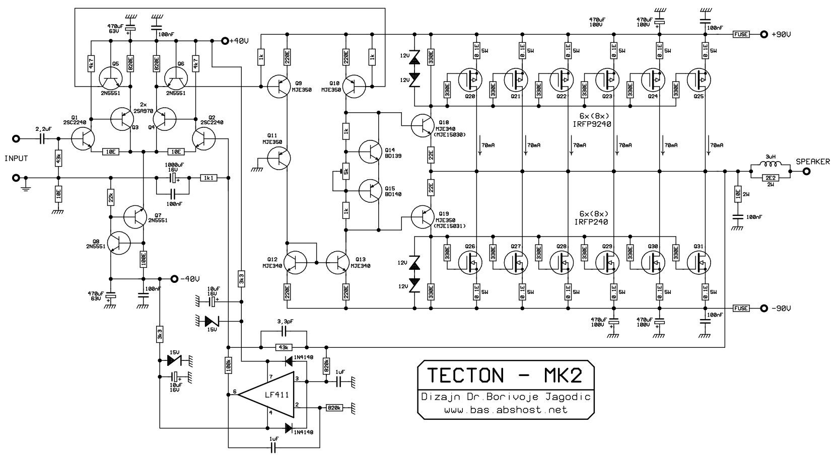

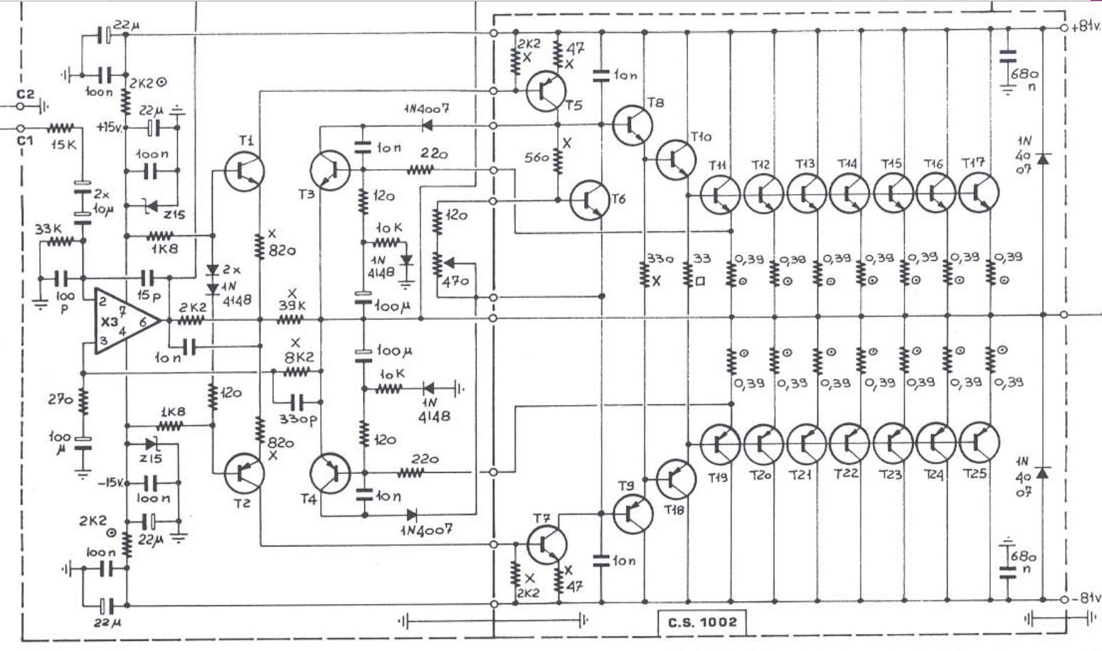

Two other designs are on my list, along with the APEXes. The Montarbo 1002 and Tecton MK2.
Do you think they would be a better choice?
