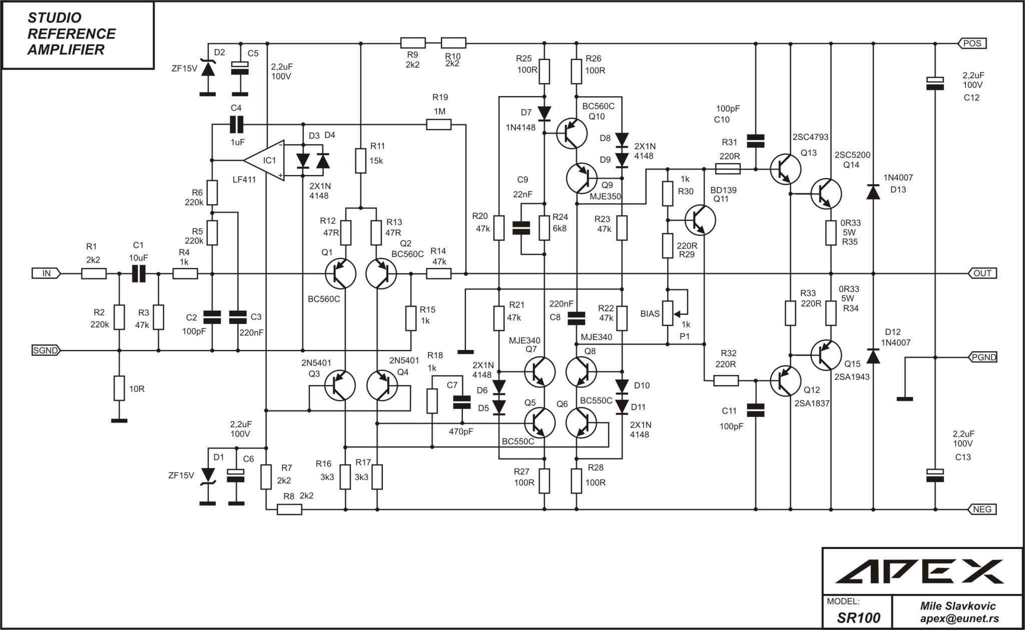

Can anyone tell me what is reason for burning R26 in sr100 and what is the right value for R30 its 220e or 1k

I assembled the SR100 amplifier and am using it on a -30/0/+30vdc source, I would like to know if it is safe to use the SR100 with a -45/0/+45vdc source at 4ohms, and if there is a need to add 4 resistors 2k2/2w instead of 1K/2w? as there are layouts with these two resistor values on the boards.
I really want to try this amplifier. Is the supply voltage +-75v? Can I use mje15030 and 15031 instead of 2sc4793 and 2sa1837?

Here are the schematics mentioned above. Not familiar with the Klout so unsure if I am posting everything.

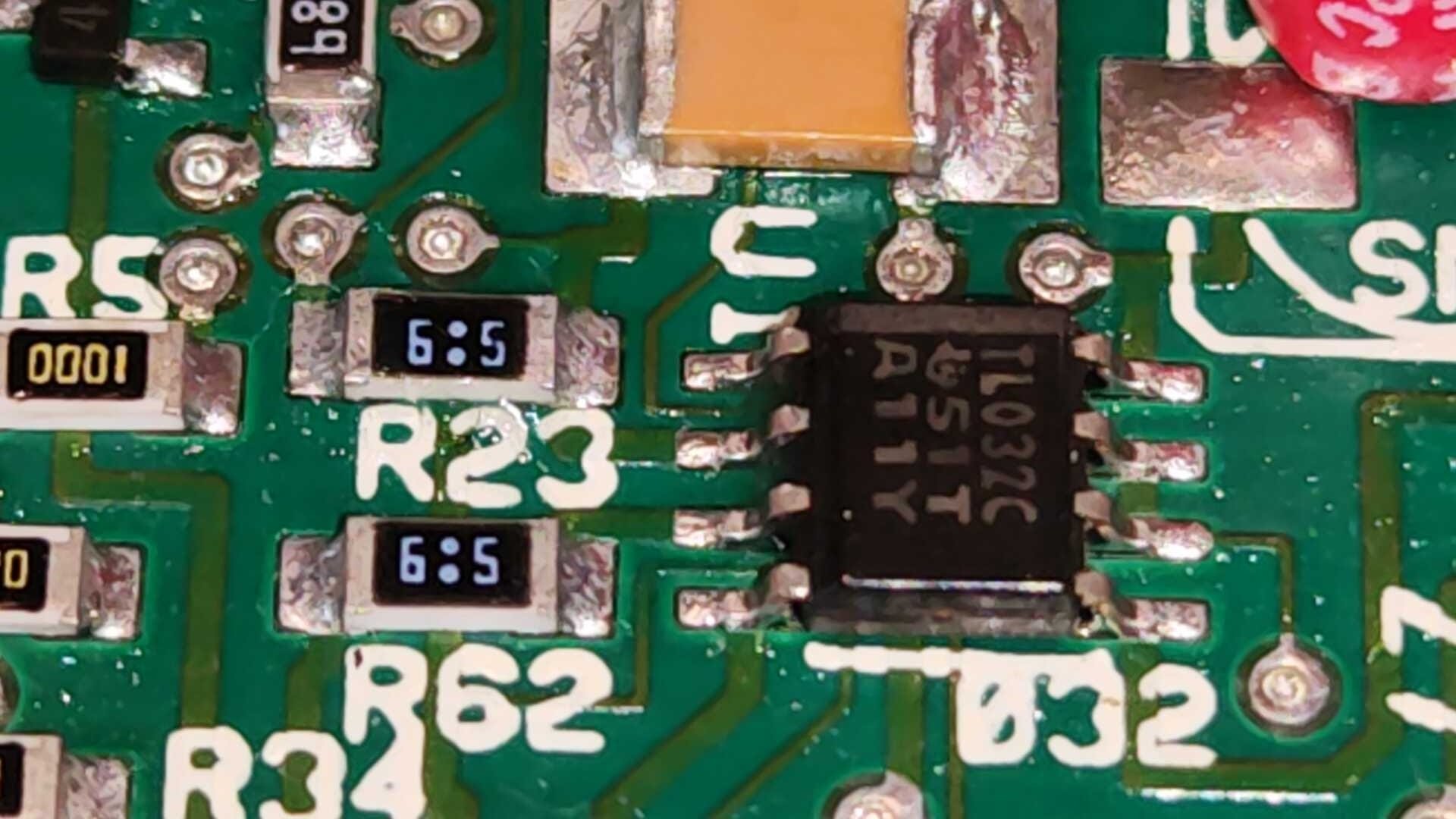

Hi everyone, although I'm not an expert, I'm trying to repair my Klout. On a control board (PCAS 161) I replaced a ceramic capacitor (C11) but I saw that the resistor R23 also burned out. The code for this one is 6:5 but I can't identify it and therefore I can't find it from retailers. The intact one measures approximately 5Mohm. The strange thing is that if the positive tip of the tester is placed on side 6 it gives the value of 5 Mohm, if placed on side 5 it gives 6.9Mohm. Does anyone know this type of resistor and where can I buy it?
