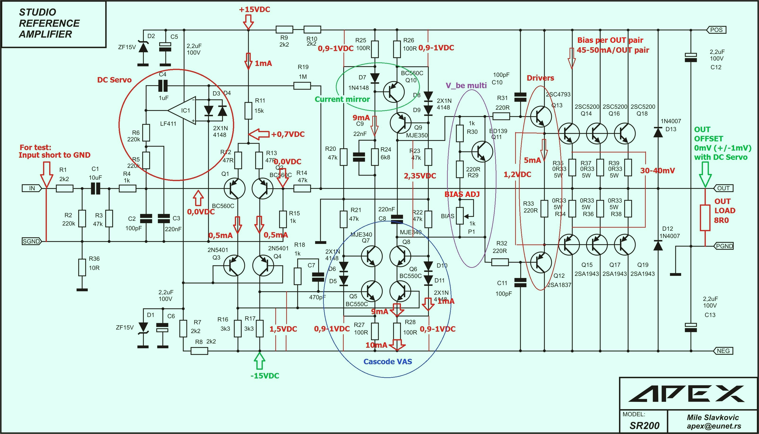

Do you observe the problem in one channel or both chanets?
What are the idle currents of the output transistors and the drivers - in the "bad" channel and the "good" one (if there is a good one)?

only right 1 channel not working well, the other channel is good,
and the truth is i do not know how to measure the current on those.
i have tried replacing both driver and pre drivers but still the same problem offset is about 15mV now

Hi Sam,

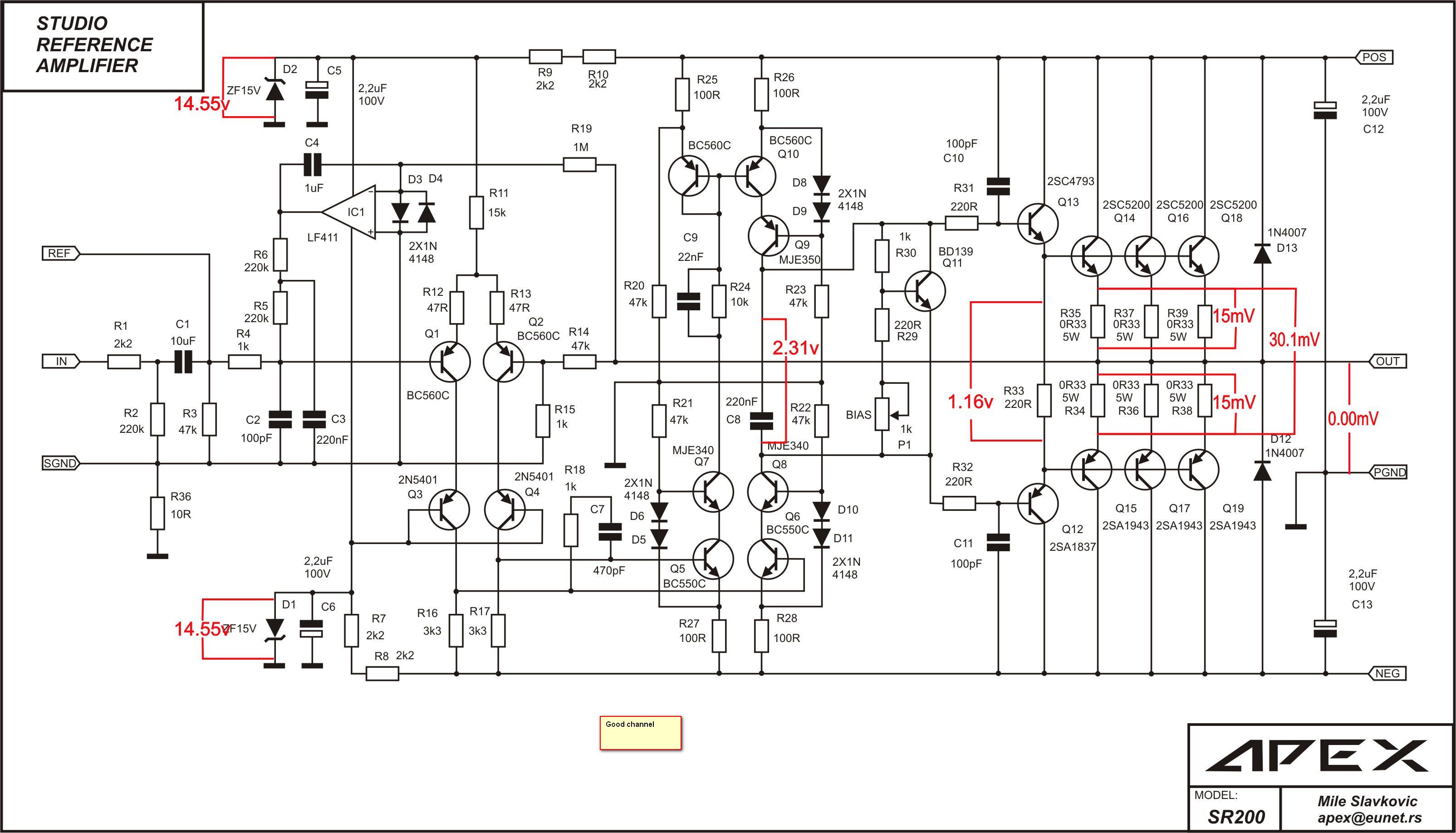

Can you please measure the voltage in both good and bad channels:
1) Across C8;
2) Across R33;
3) Across both R35 and R34 (between the emitters of Q14 and Q15).

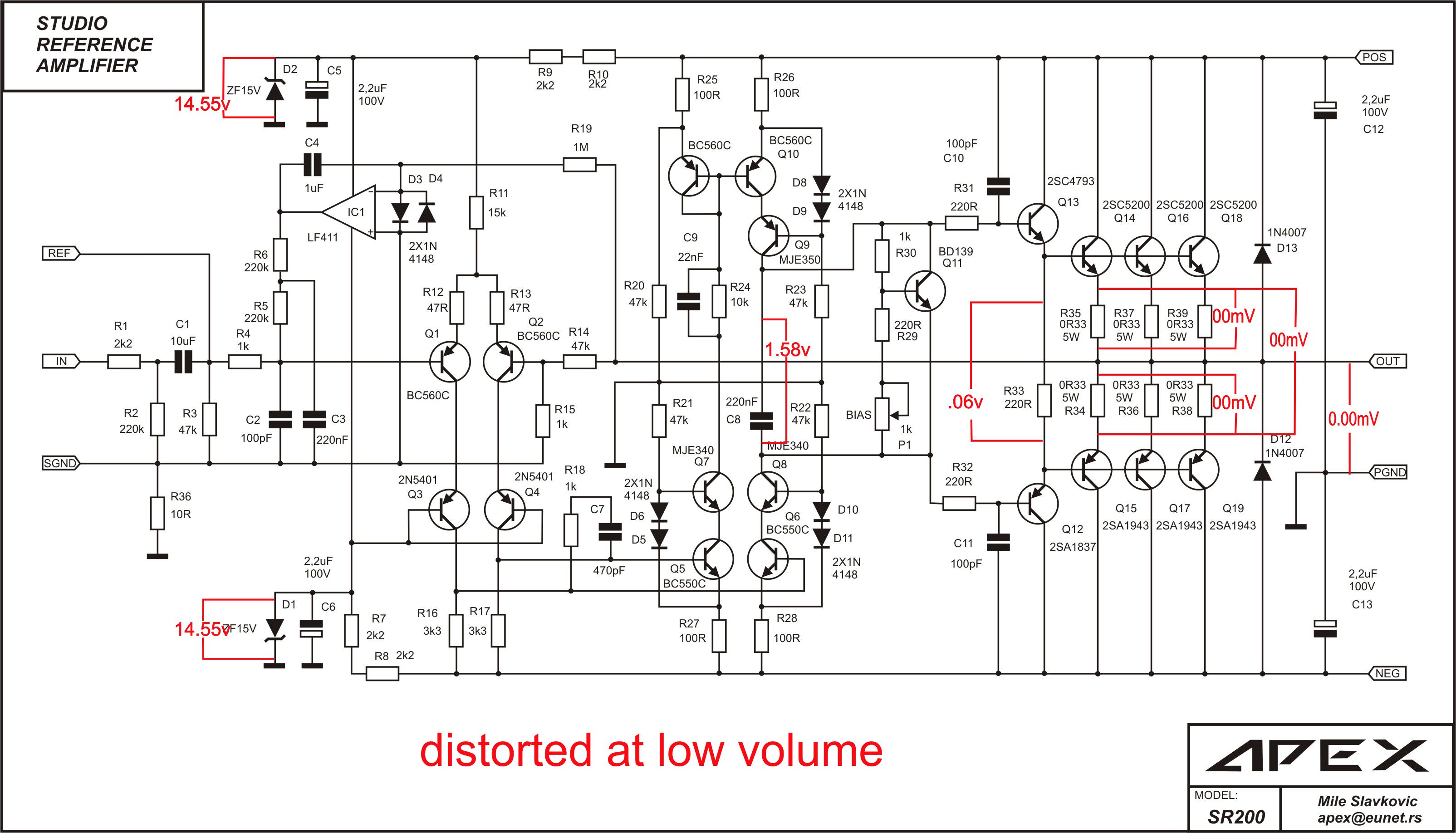

Good day Sir,
attached are the two measurements
i've check almost all transistor and diodes no problems on components being individually checked.

Hi Sam, ok - as I and Tony suspected, OPS in the distorted channel is certainly under-biased. However, OPS itself seems to be fine - the reason is not enough current through the VAS stage. Next step - let's check the voltage drop over R25, R26, R27, R28 in both channels.

If you look @ named "Good channel" the Bias of output BJTs are
30mV/0R66=45mA/output BJT pair
and the predrivers C4793/A1837 works with 1,16V/220R=5mA
and that`s OK, crossover distorsion are minimized.
With amp witch distort at low volume you have almost "0,0" Bias current,
amp works deep in the class B region
and you can notice high crossover distortion at low levels.
You must increase the bias current with P1 so you can measure with DMM
=30mV across both R35 and R34 (between the emitters of Q14 and Q15).
The amp must run for about 10min to achieve some heatsink temp.
Then readjust bias if necessary.
I will try also increase predriver bias from 5mA to 10mA changing R33 from now 220R to 100R-120R
so also predrivers will have more class A bias current at low and medium volume.
LP
Dragan

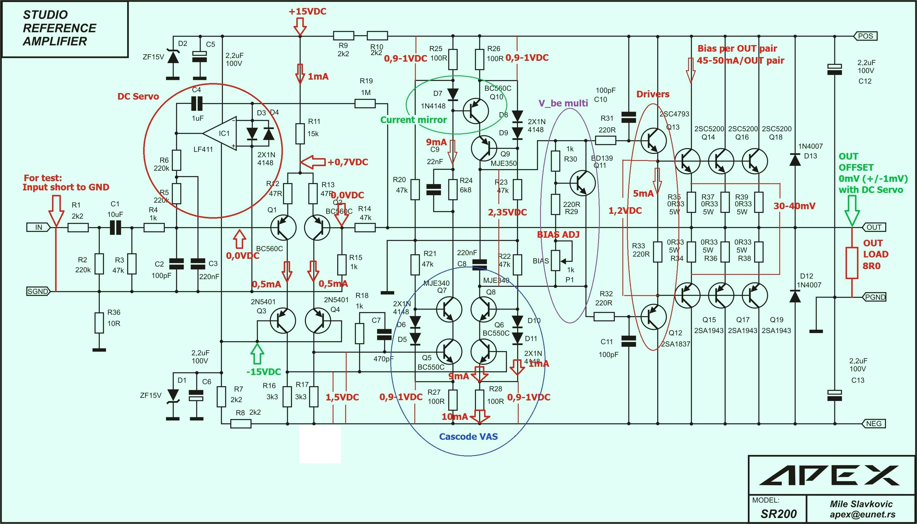

Here are some SR200 voltages and currents thru schematic that`s my help.
Values my vary for some 1-2%
Your -15 volts indication is not correct.
Right, so as soon as Sam shows us his measurements, we will know if we've got that 10mA through the VAS stage emitter resistors (leaving 9mA through the VAS itself).
If that's the case - something's wrong with the bias spreader.
If not - we move our checks further on to the left 😉

Yupp, my mistake...TXYour -15 volts indication is not correct.
(-)15VDC must be on bases of input diff.cascode.
On picture there is (-)Rail!
Corrected:

Good day sir,
i regret that it took a little while before i have replied due to haloween vacation with family.
i have found the problem some resistors changed value. i have replace them now working fine. i have attached pics and measurements.
thank you so much for your support, your detailed guide with specific details does not just solved the problem but gave me education how an amp work.
