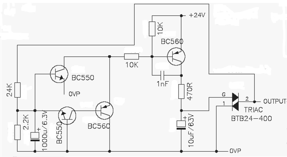

DC protect with triac without diac.

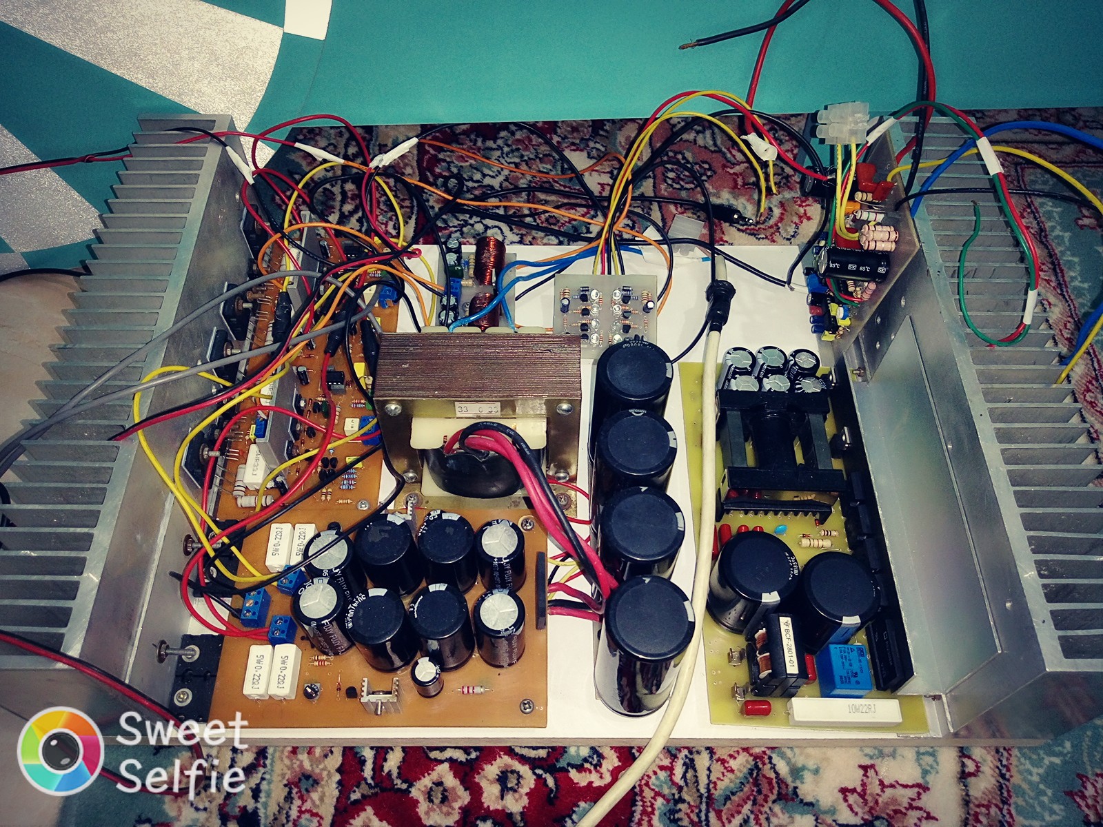

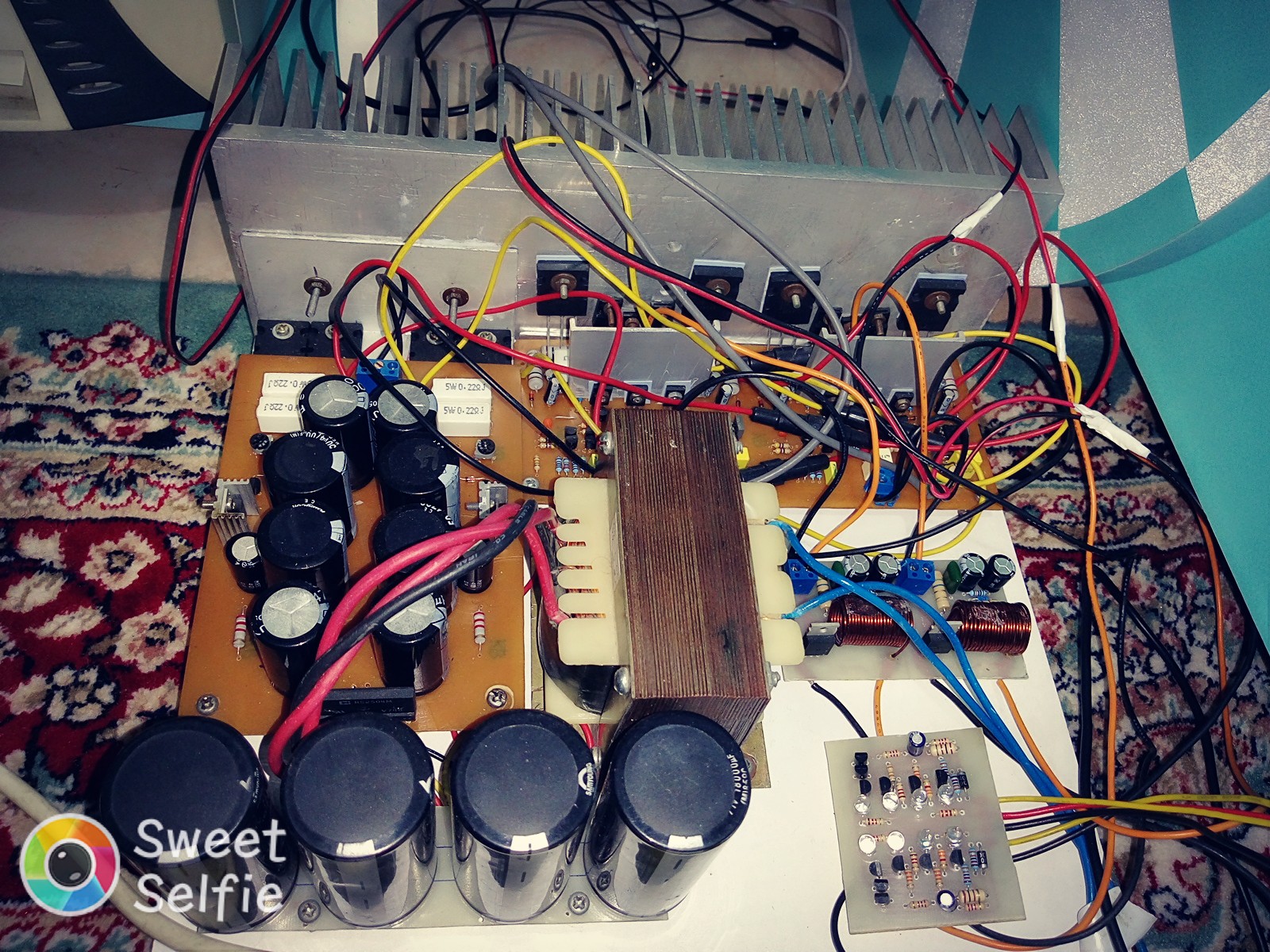

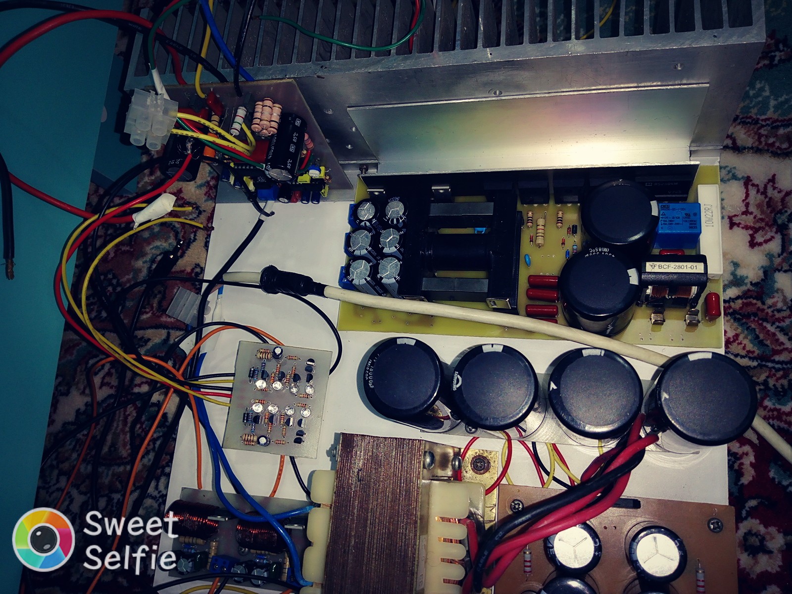

hi friends
i built a 2.1ch system for my com A few months ago:
2*sr100 amplis
psu-10
zobel network
+33/-33 2a traffo
1.2 kva detex smps(Under Construction)
1500w class d ampli from detex(for subwoofer)
and apex vu meter
the sound quality is very good and detailed
i have a problem
when signal source is connected and audio volume is 30% and upper sound is good and not problem but when audio volume is 0% my traffo gets hot after one hour!🙁
why?
respectfully
