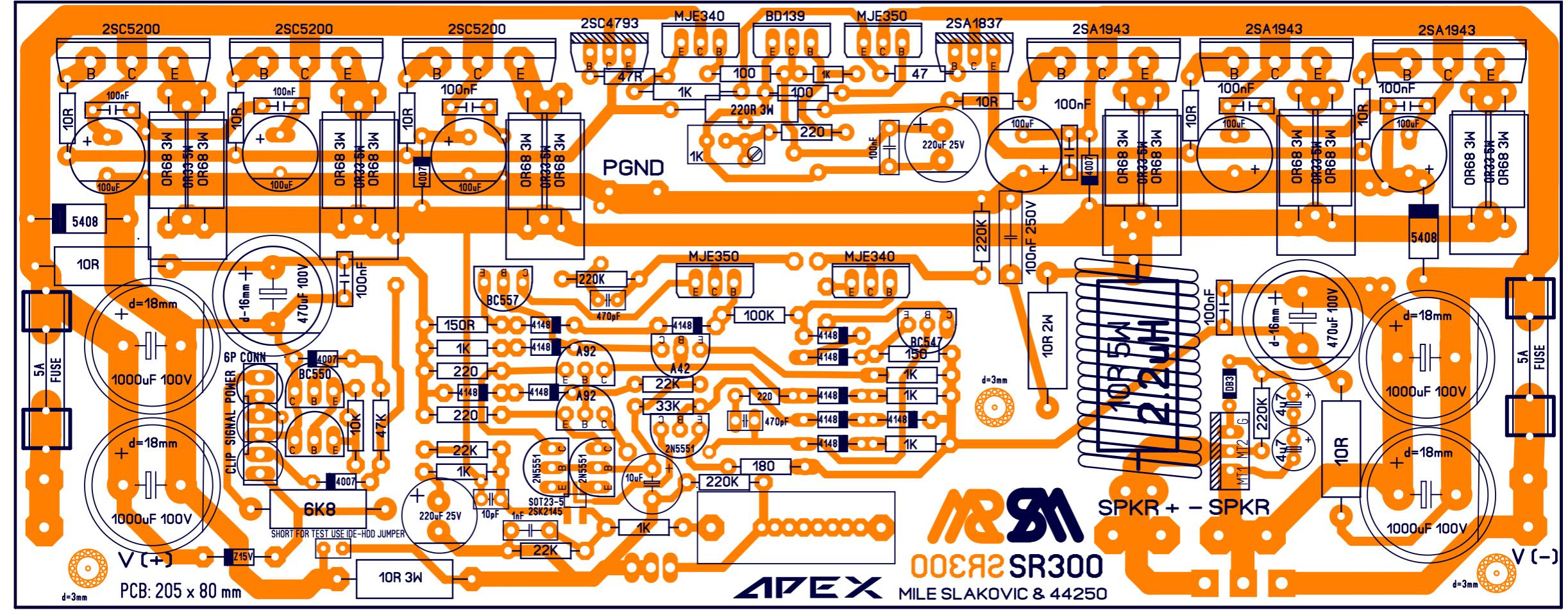

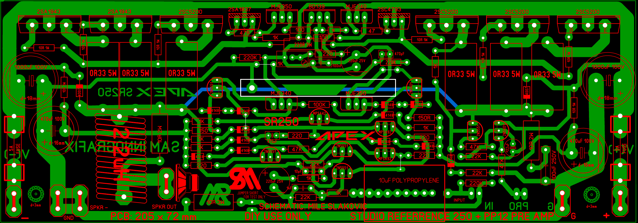

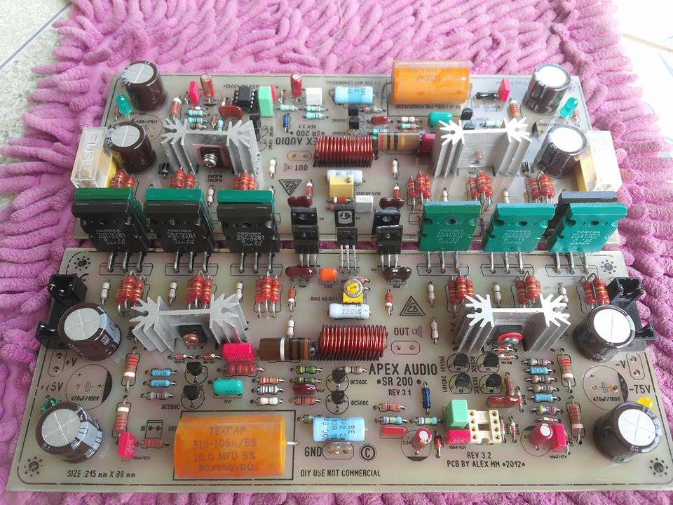

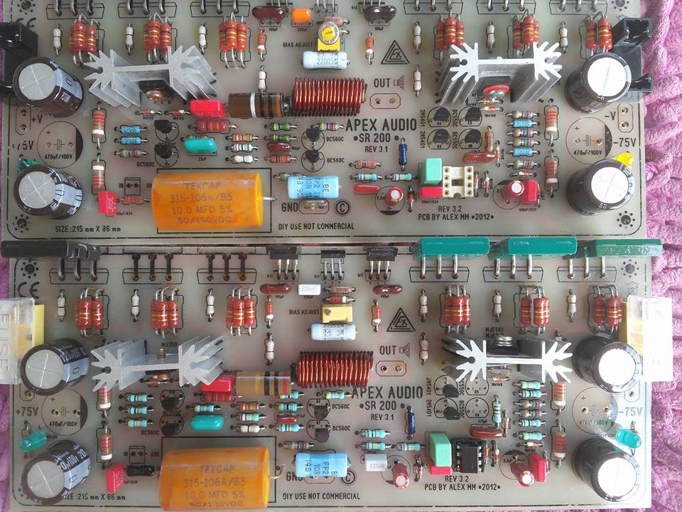

i have revisited the forum today i suppose to attach my SR300 layout for perusal in post#2660 but was not there so i am uploading it now and i added my SR250 too in case some can give inputs too......so i can correct it before making the PCB.🙂
regards
sam

at sr300,I would only switch places of + and - connectors with fuses,so when current comes from PSU than it flows through fuse than to first large capacitor,to second and than to output transistors. that way you have constant flow of current in one direction instead forward - backward to and from those big capacitors. I like all the rest you did there!
Copy that, thanks,
regards,
sam

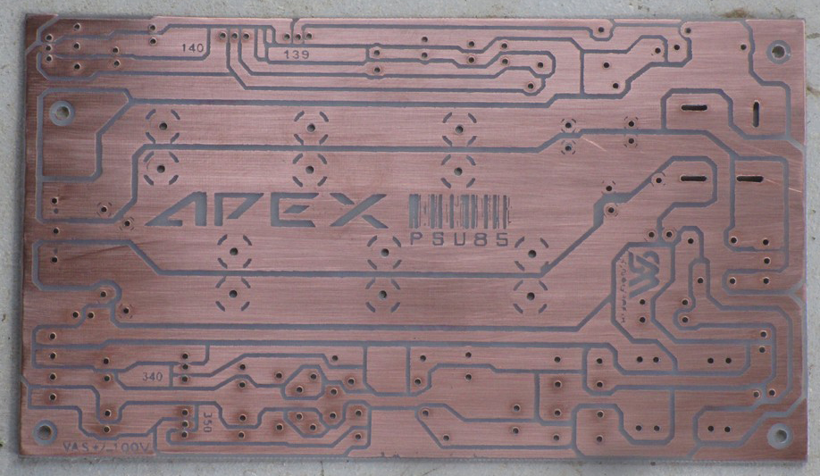

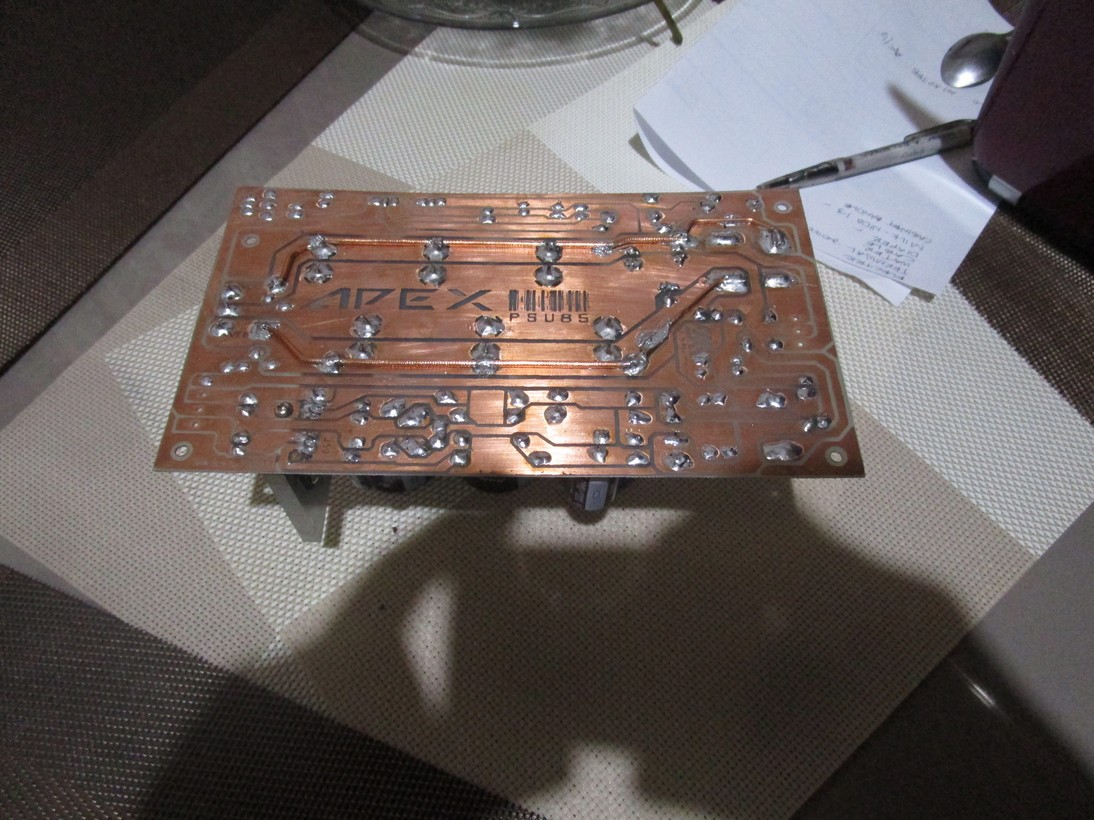

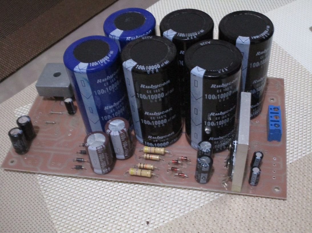

i have made PSU 75 before, but labeled it with PSU85 for having 63-0-63vAC that might be good for SR800 here are some pix,

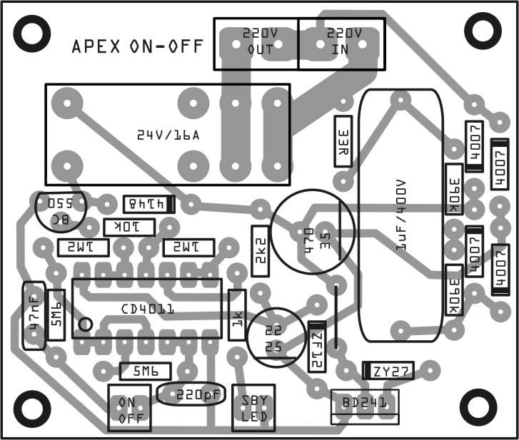

i have some question for the attached soft start in case of brown out will it reset? second what power switch do i need is it momentary switch or latching switch? i am powering up a 2.5-3.0 kVA traffo,.... i like this softstart so no high voltage on front panel.
thanks
regards
SAM

This circuit isn't a soft start circuit!
It is just a push on push off circuit and uses main voltage for 4011 i. c. Use switch button suitable for main voltage only!!! :RIP:
These are <<alwayes live circuits>>.

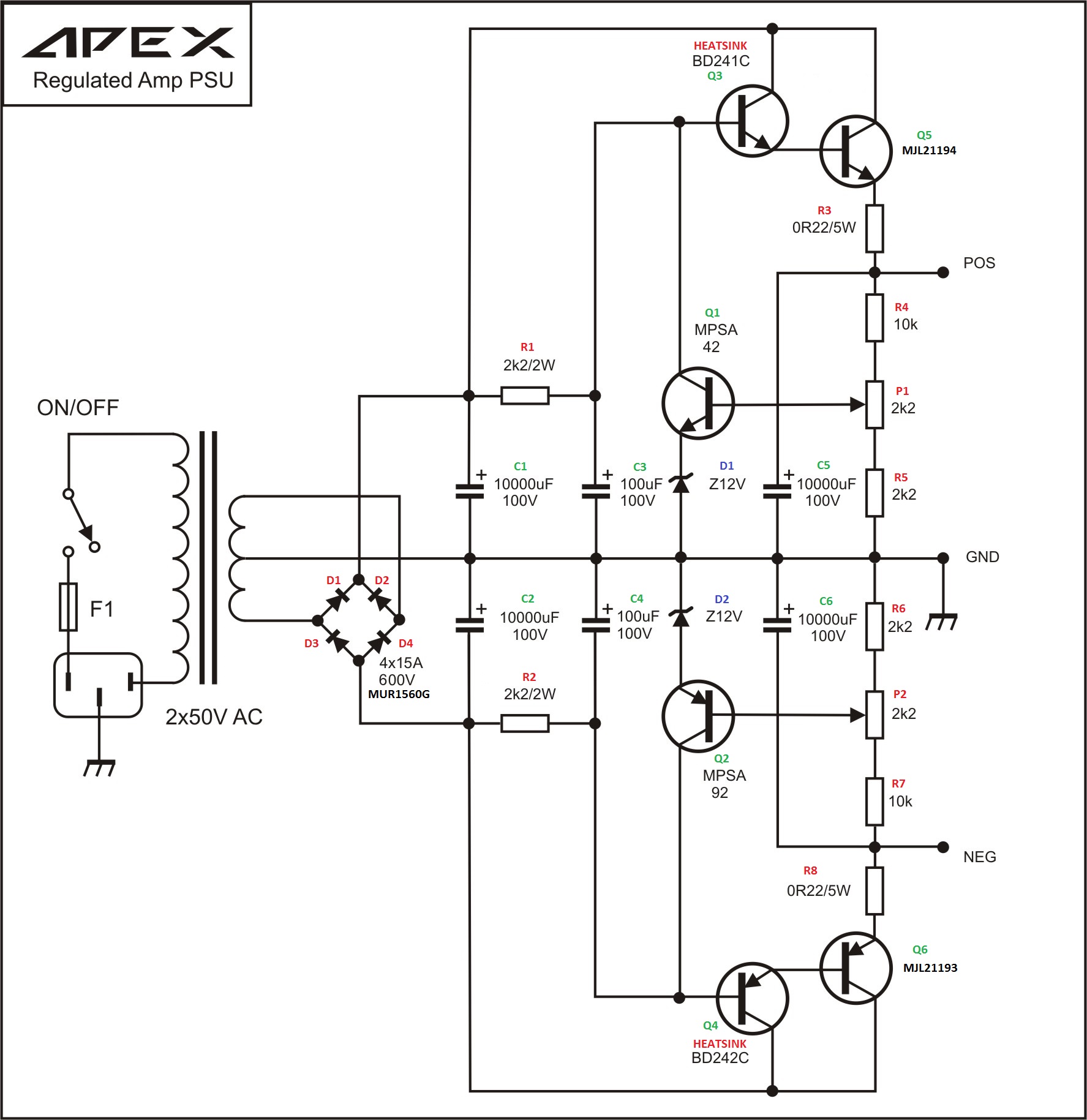

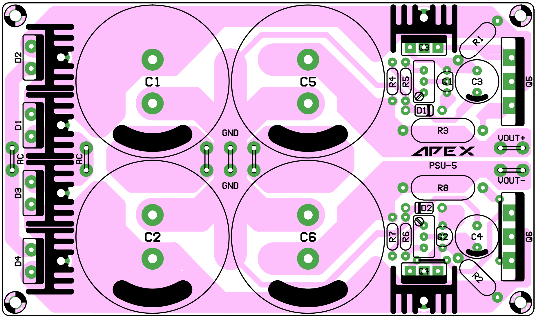

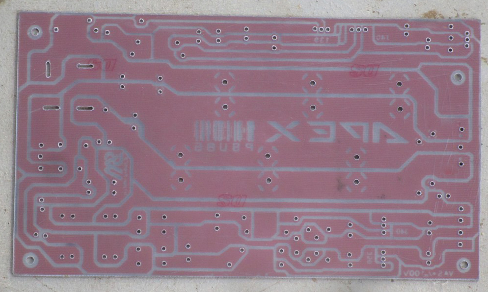

Regulated PSU PCB V1.0
Here is files for Regulated APEX PSU-5 V1.0.pcb in pdf is mirrored ready for toner transfer so when you are making PCB please make sure that you need to mirror it if you plat to use it for photodevelopment of pcb.

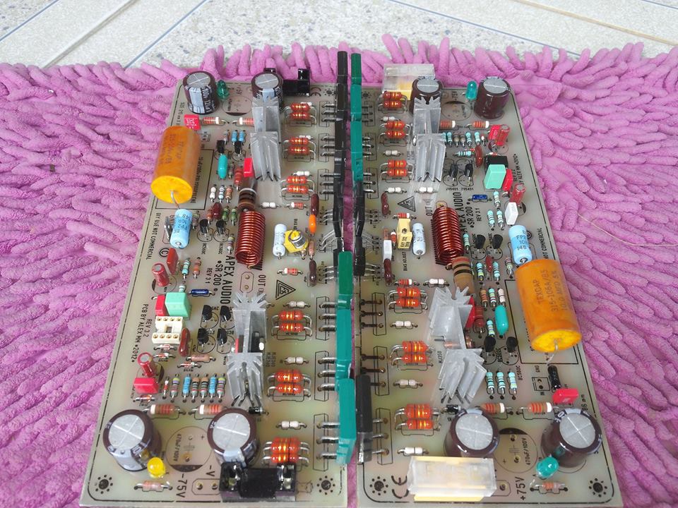

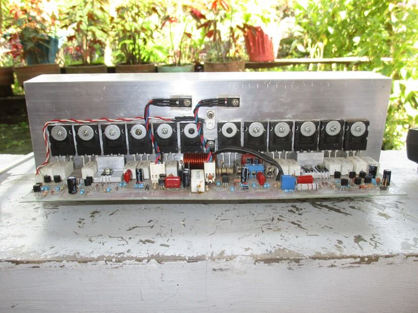

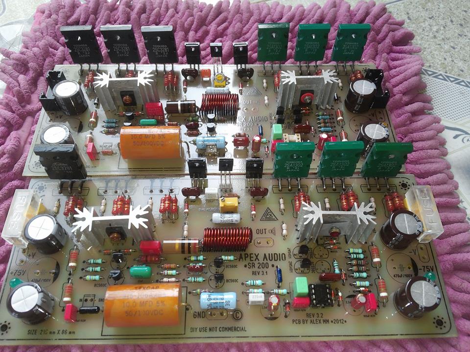

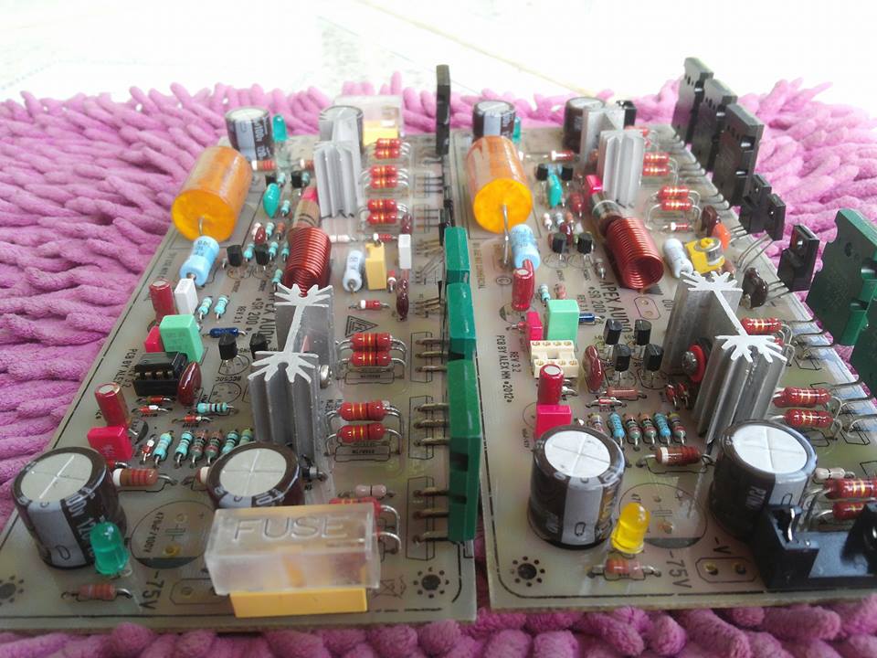

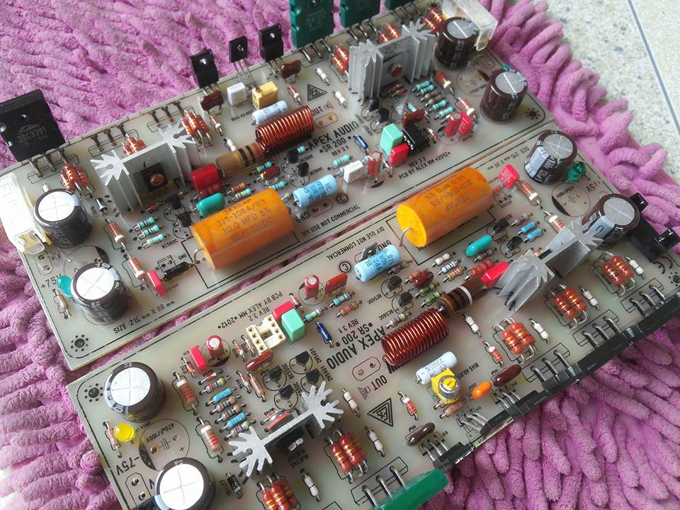

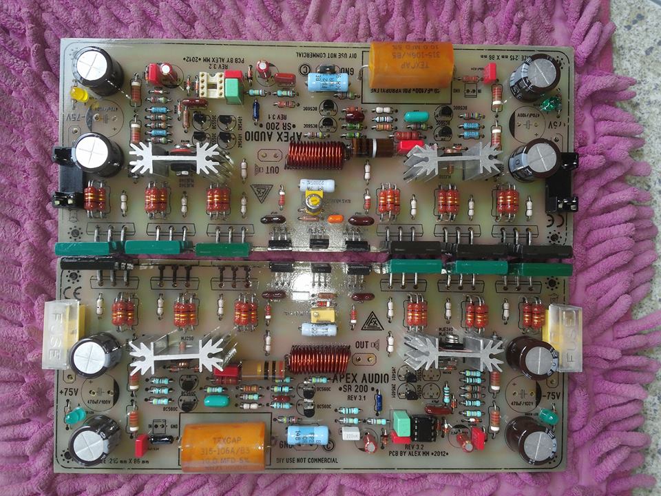

sr200 version by hand
