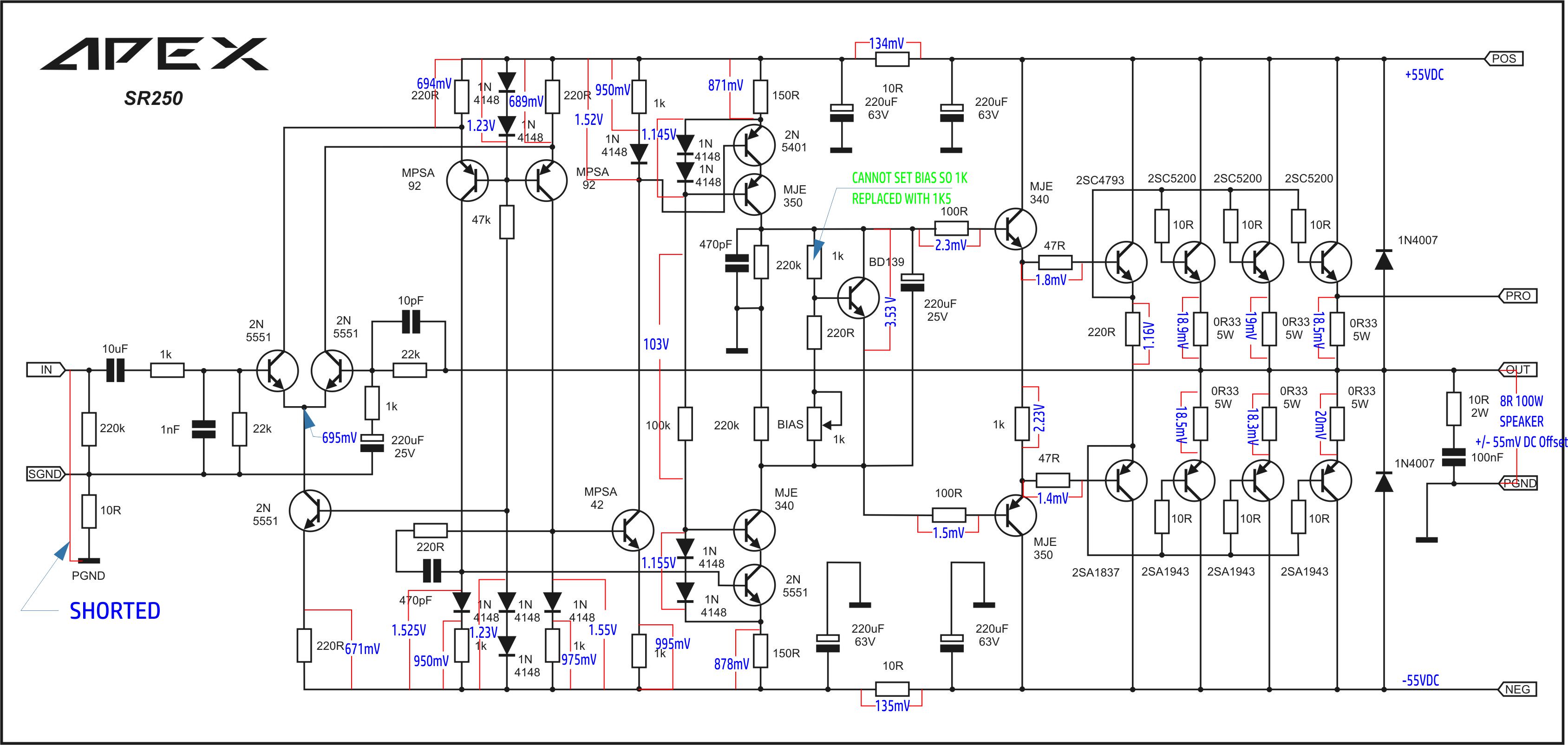

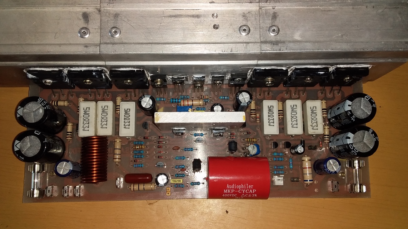

to sir mile thank you for this amp. it was tested the result was at first i cannot adjust bias so i replaced resistor in BD139 (B-C) 1K with 1K5. now i have set some bias but DC offset was high at about +/-55mV tested @55VDC
i think the bass was very reach, mid and high are just enough not that loud compared to my "SR200" or "AX14(3pairs)". with the following measurements attached. i hope for some advices...
these measurements was taken with shorted input but with 8r100w at output without resistor or bulb in series...
regards
sam

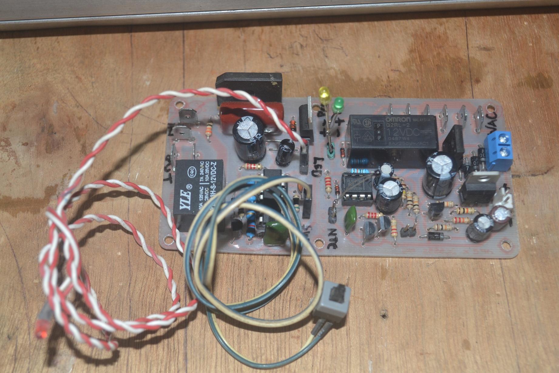

This circuit isn't a soft start circuit!
It is just a push on push off circuit and uses main voltage for 4011 i. c. Use switch button suitable for main voltage only!!! :RIP:
These are <<alwayes live circuits>>.
yes it's not i notice it when i redraw that circuit based on available components, but i continued since i have most of parts from salvaged units and the IC was available on local stores not expensive, used it for 300VA traffo
not a soft start thanks for reminding pls see the attached picture of completed work.

Hi ! In order to get low DC offset, you should match 2N5551 input pair, with the same HFE.
