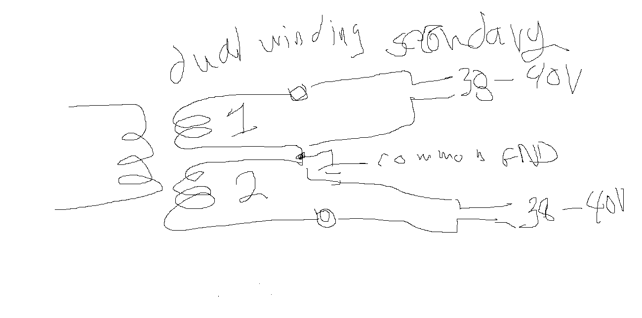

AC voltage after rectification you can go with 40V AC after rectification 56V DC with filter cap will increase to 60 +/- is 3 pairs so about there even with 38V AC will also work I did tested many times on simulation sorry for the bad drawing 😛

OK Sir .Sir I have 55 0 55 15amp transformer.which amp best for this transformer. best pre amp for sr200.can u give PDF or other of preamp. Sry for my bad English
just search here Apex have many good design I do not design them is the comunity of diy that does that like I say I'm just a follower
