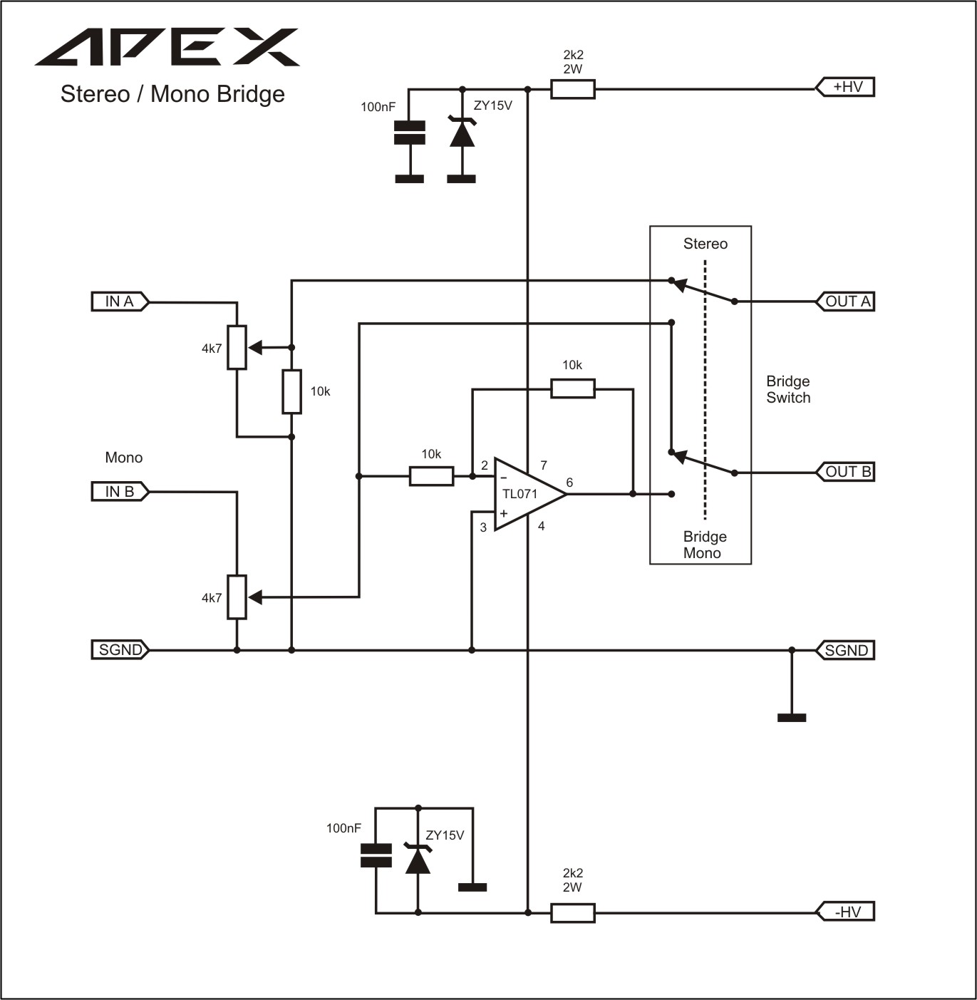

With +/-110V rail voltage, Can I bridge the SR200 circuit to have 1500W/8R? If so, what are the parts I may need to change?
Thanks,
Blueice23
With +/-110V rail I suggest 12 pairs of outputs (it's class AB), and you need add bridge circuit on separate pcb with balanced inputs and low-cut filter...

Hi Mr. Mile Sir,

This is circuit for stereo/bridge mode.
Hi Mr. Mile Sir,
I have an existing bridge adapter circuit already and i'm using it with my other amplifier. It has a balance input configuration too.

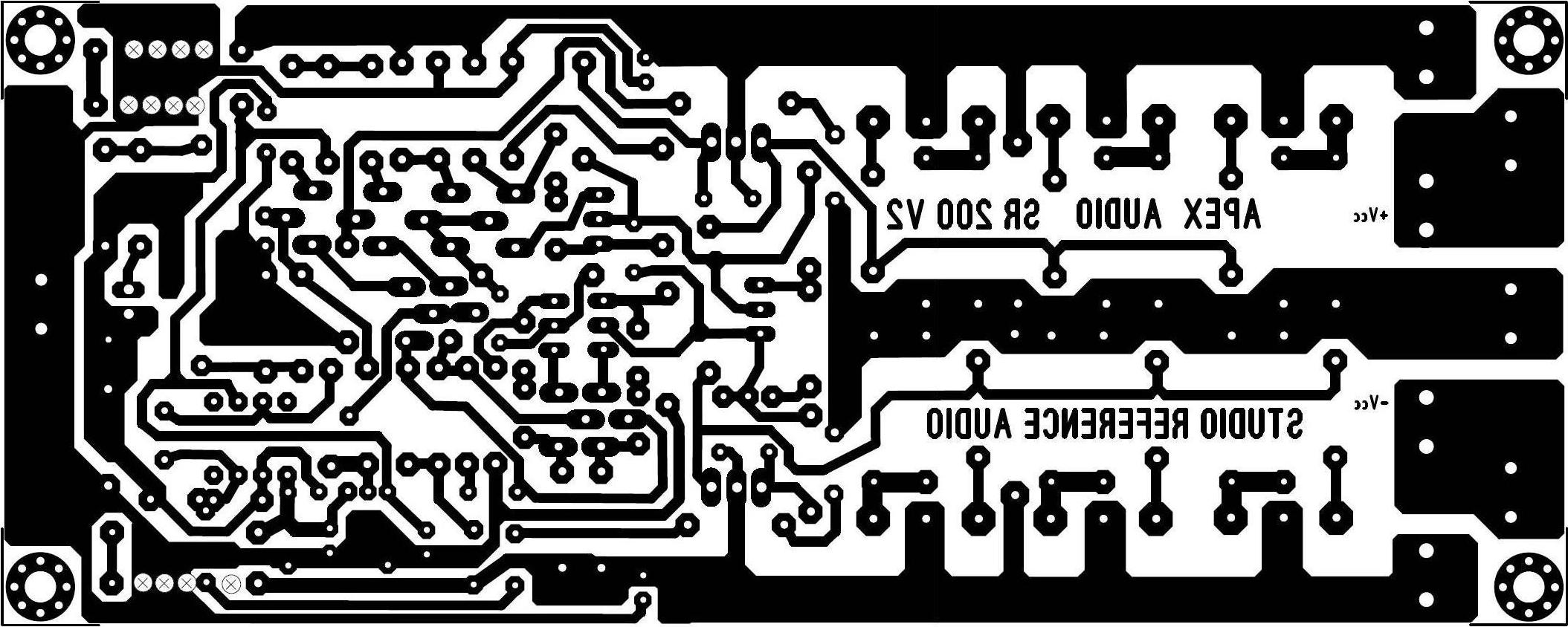

Hello Mr. Mile Sir,
I just want to know if this PCB layout is correct? (please see the attached files)
I will use this PCB for my SR200 ref amp.
Blueice23
This pcb design by 'alex mm' not tested, but look OK, you can try it and come here if there was some problem.
