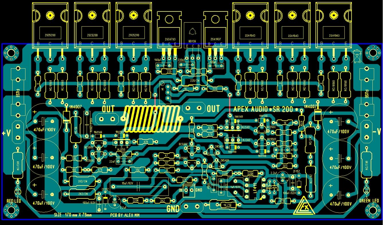

Apex, what is the maximum voltage can be used for this SR200?
I suggest +/-75V DC rail voltage for SR200.
which version is correct v2 or v2.2?
Both versions are correct.

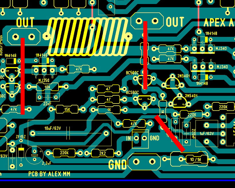

why is two out in this pcb and there is two resistor in one place?
Out without inductor is for use with speaker terminal, resistor 0,25W or 1W is only for test, gnd for amp input connect to PSU gnd with separate wire.

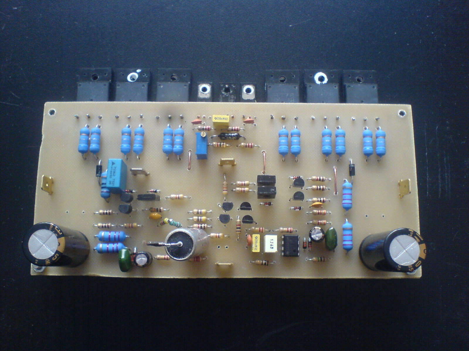

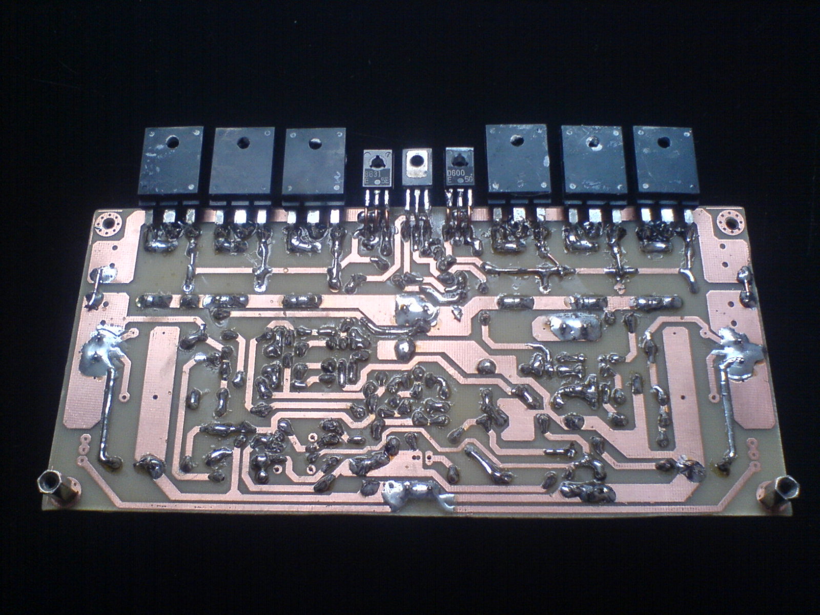

which output transistor u use .
why is two transistor opposite side.?
here 1837,4793 transistors are sri lankan ruppees (25rs) thats mean (.20 us dollars) what purpose u put subs.
if u fix like this in opposite its not a professional look and wasting time.
This SR200 on the pictures is not my work, drivers transistors in TO126 case have oposite pins compare to TO220.
sorry for the misunderstand.
If drivers are 2SA1837 and 2SC4793 use normal position (back to heatsink)

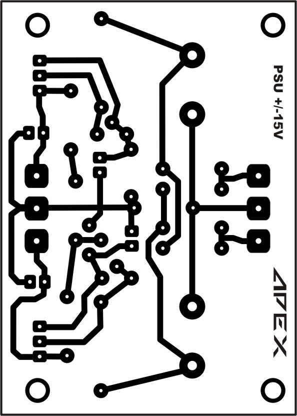

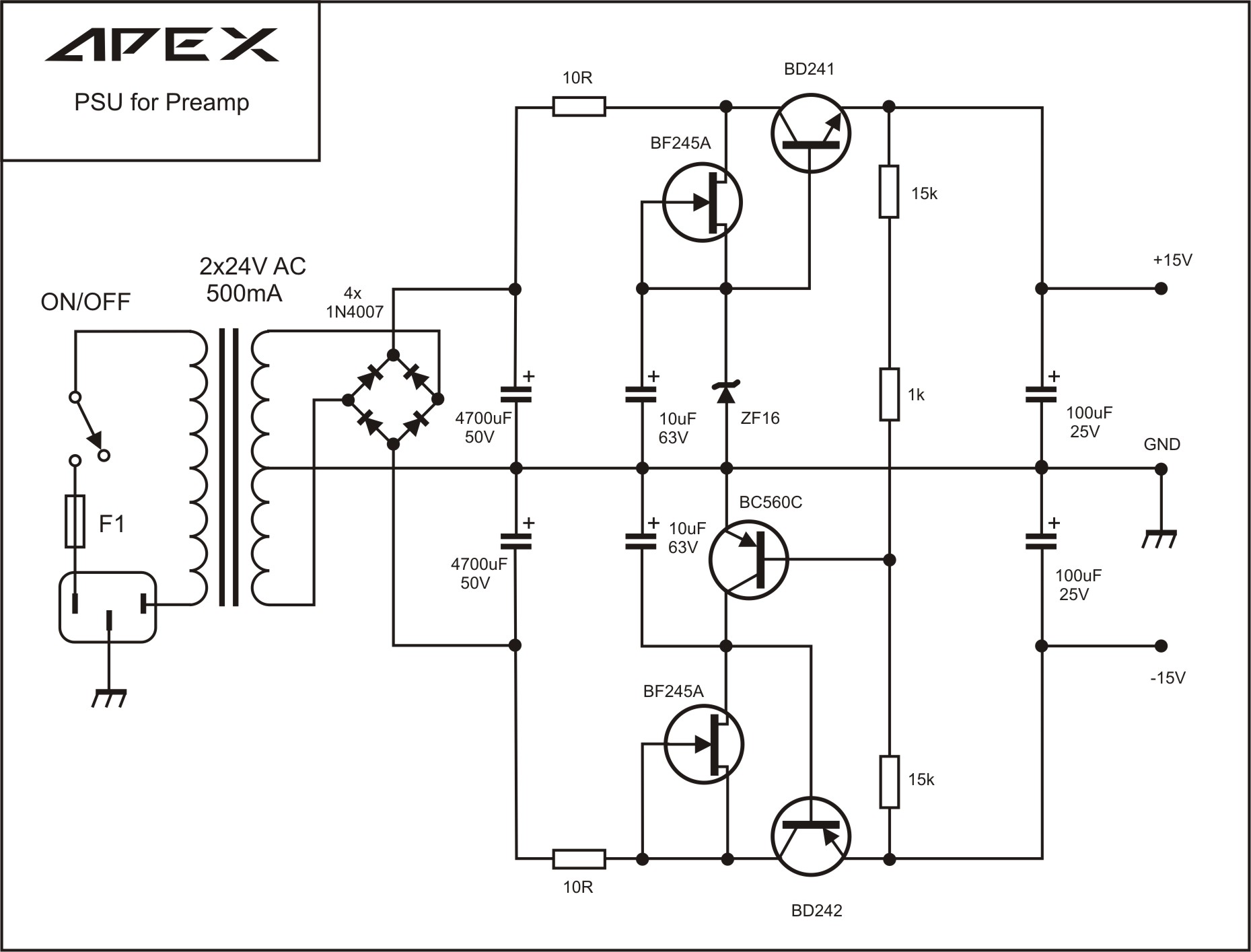

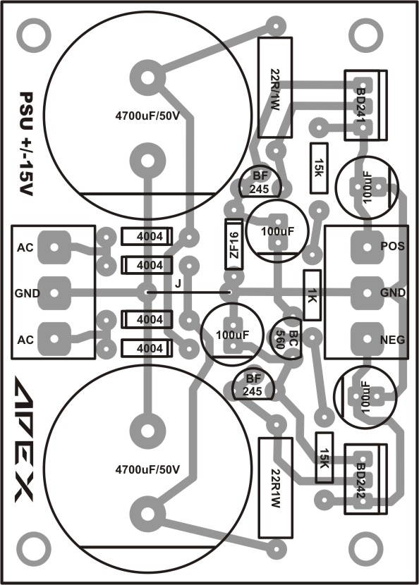

PSU for preamps. I suggest this +/-15V regulated psu instead 7815/7915, 317/337. This serial regulator can give more current than shunt regulated psu (1A max).
