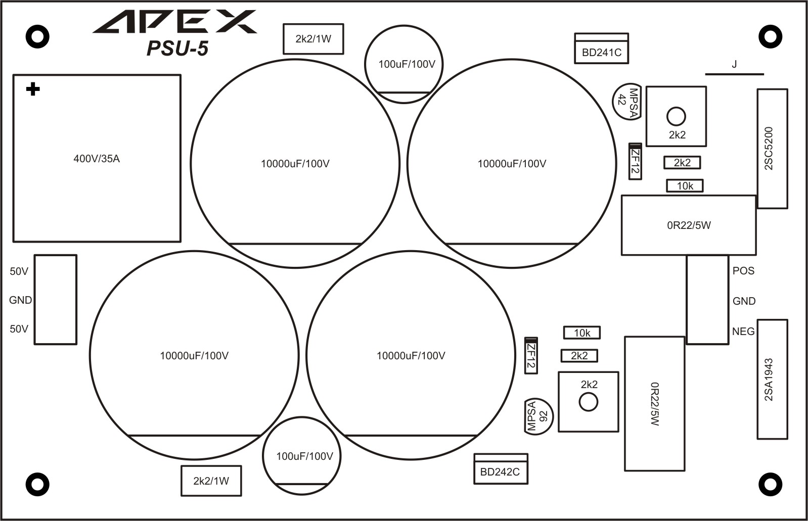

Question Apex, is this an 8 ohm only amplifier? if not isn't PSU filtering a bit small ?
regards
regards
regards
Why do you think 4x10000uF/100V per channel is to small?

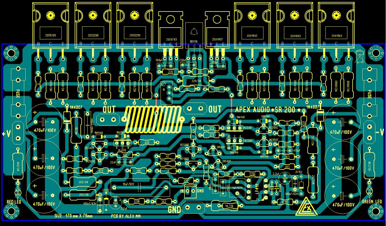

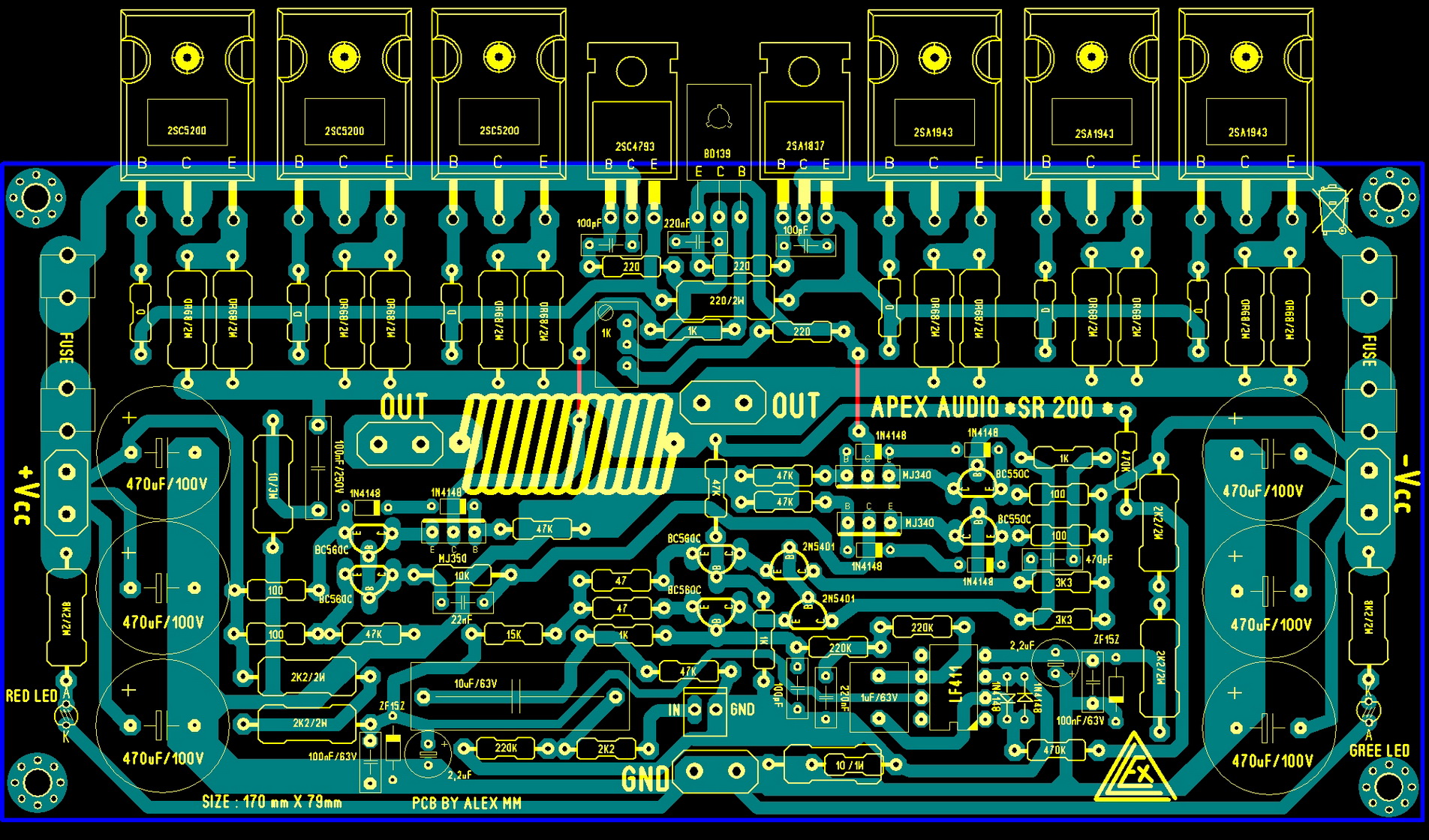

.....I have try to layout PCB for SR 200 V2 but it's difficult to do sigle sided ...
Thanks for try🙂 15k must be connected to +15V not to +Vcc...

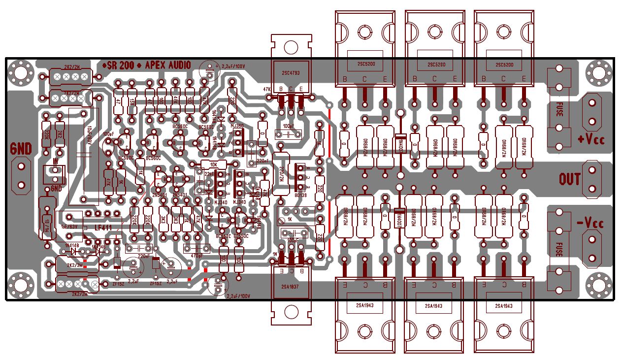

Revised PCB .....
..... Revised PCB this time , much better I hope ....🙂

This pcb can be use, what is the size? BC639 can be use instead BD139, and only need 5mm hole in heatsink for TO92 case.
Regards
..... size of PCB it's 162 mm x 65 mm . 🙂
Regards Alex.

POWER SUPPLY

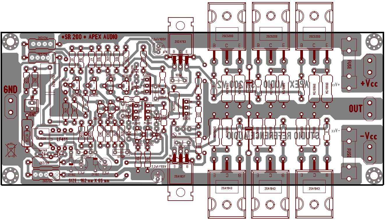

Alex can you please add DC detect and other protection circuits ? either to the same layout or as a add-on ?
Also can I have the gerber files so that I can get my PCB's done here !

Hi ,
negativ , I don't ,but in change here it is another PCB with output BJT in line 🙂
Regards Alex.

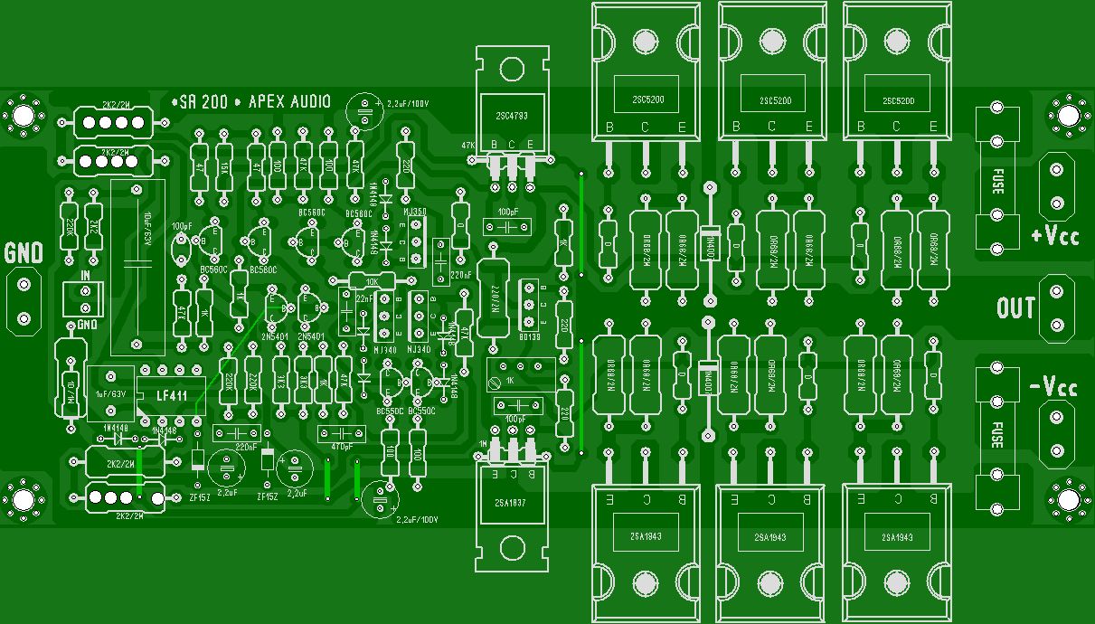

Nice pcb again, bases of 2N5401 in diff cascode must be conected to -15V (pin 4 of LF411).
Regards

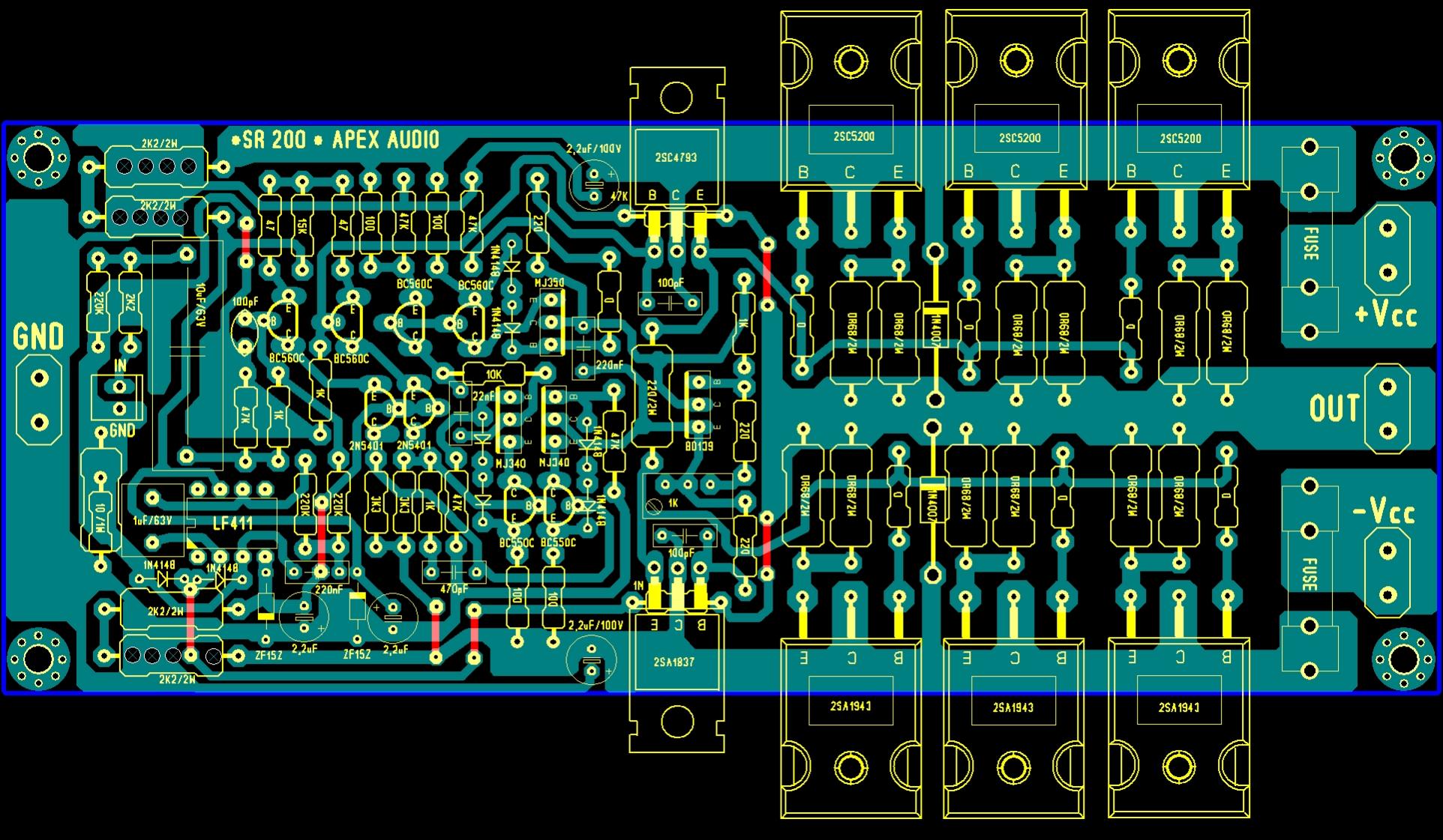

Revised PCB .....
Hi Mile ,
Yes it's my mistake, it was late and sleepy, but I corrected the error, now I think it's good.
Regards Alex.🙂
Hi Mile ,
Regards Alex.🙂
Hi Mile ,
Regards Alex.🙂
how much power into 8ohm?. what is the coil turns and diameter.?
Power of SR200 is 200W/8R, coil have 12 turns on 10mm diameter with 1,2mm wire.
