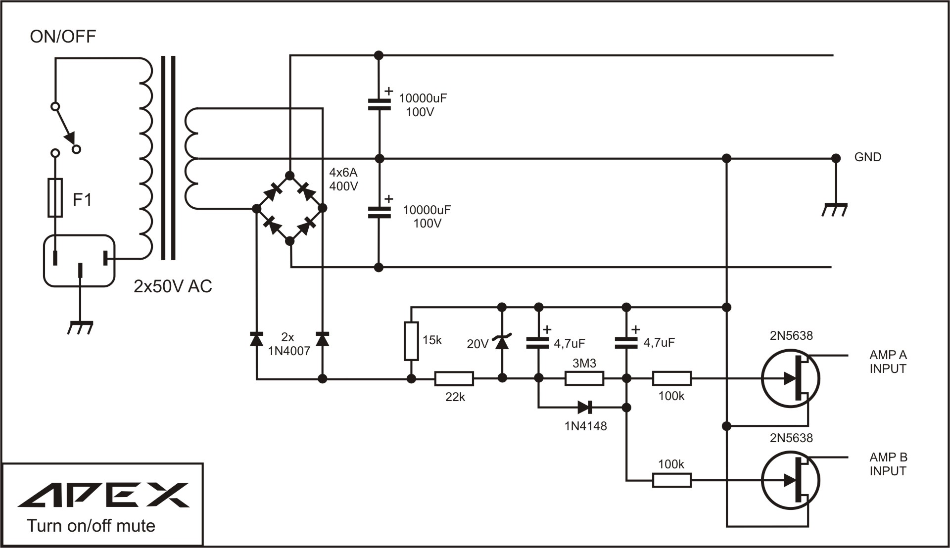

Turn on/off mute with FET
Hi Mile ,

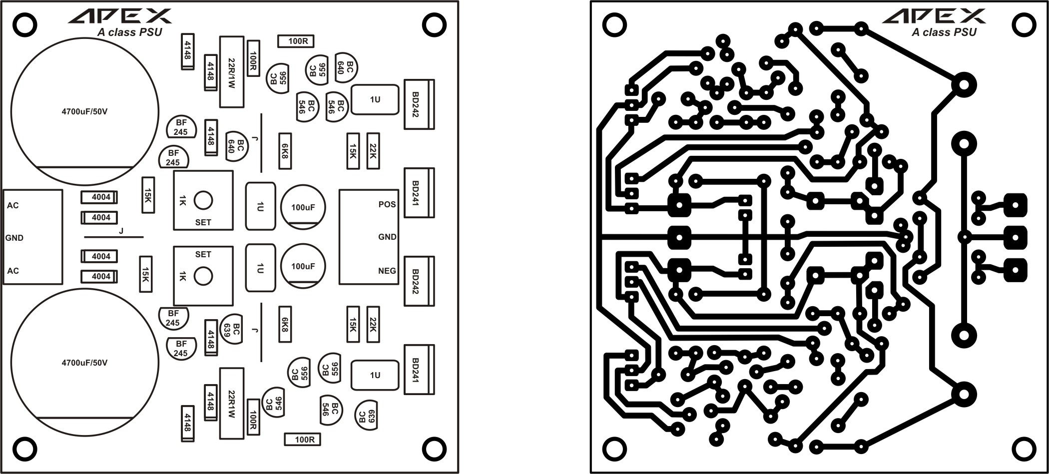

No, I have corrected, adding two jumpers on PCB . I intend to layout PCB for SR amplifier ....nice schematic . Thanks for sharing so many projects .
Regards Alex .

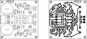

Hi Alex,

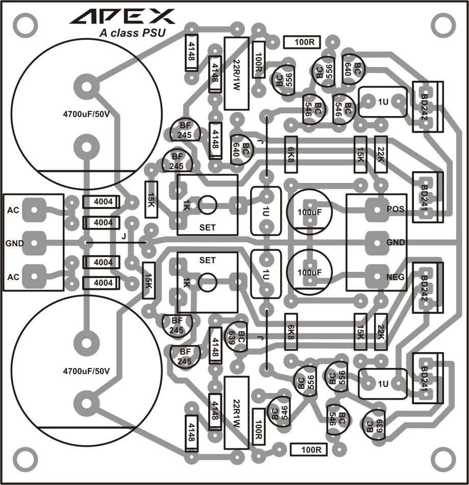

I must redesign your pcb, pins for transistors are too small, and BD241/242 are in revert position to heatsinks.
Regards

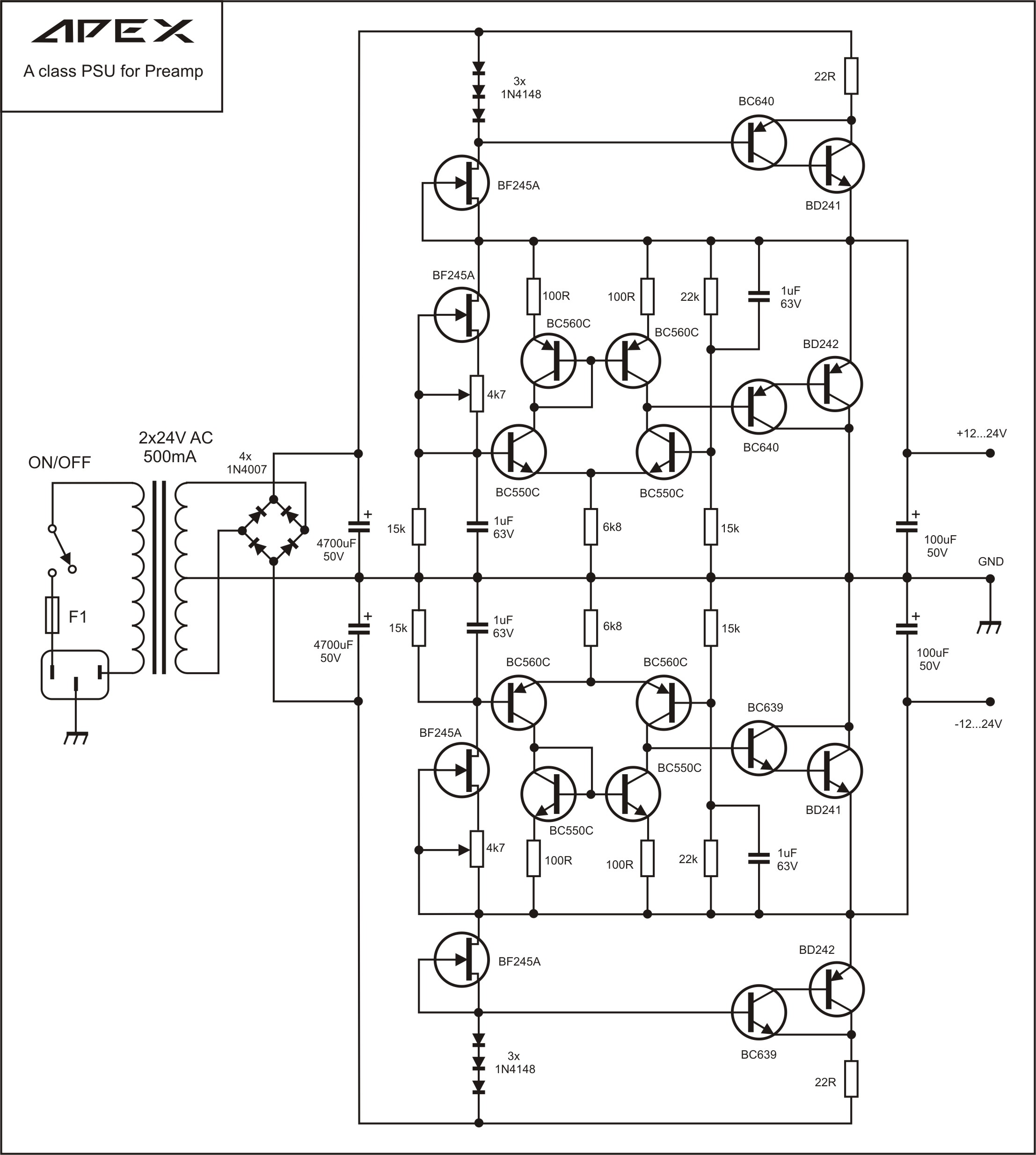

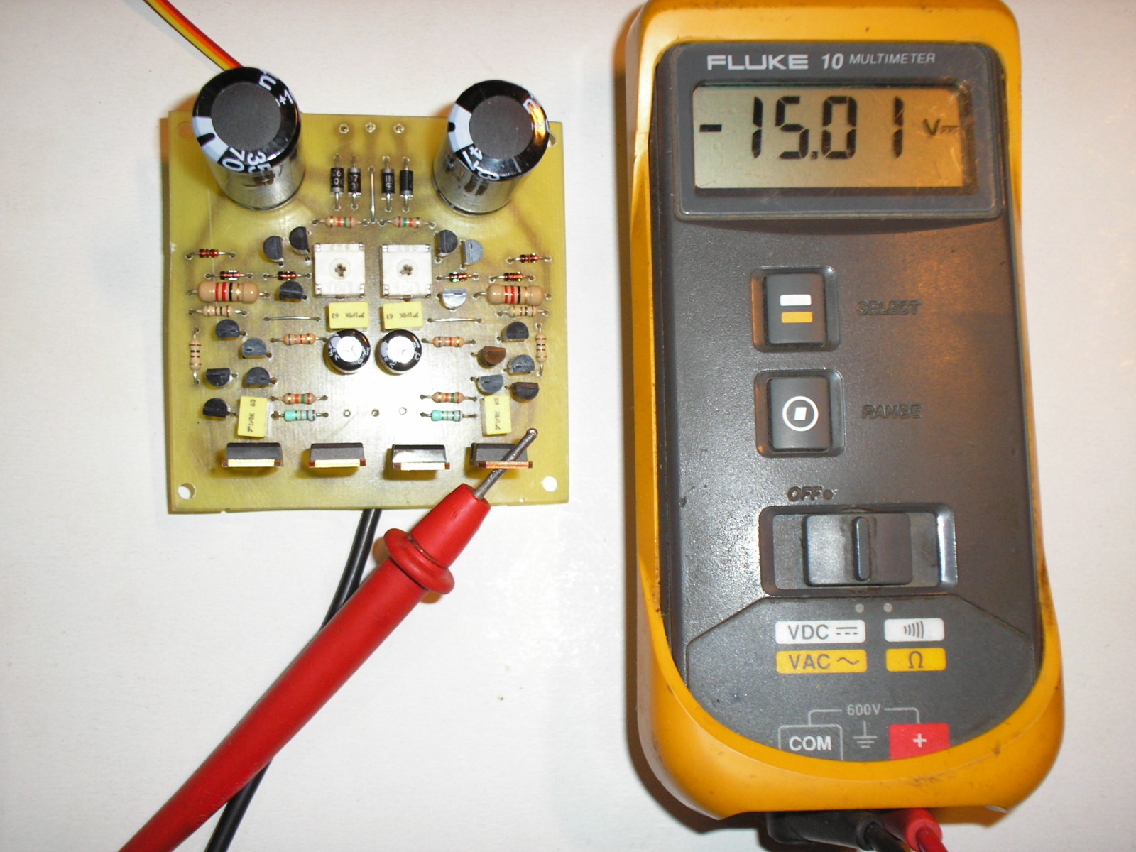

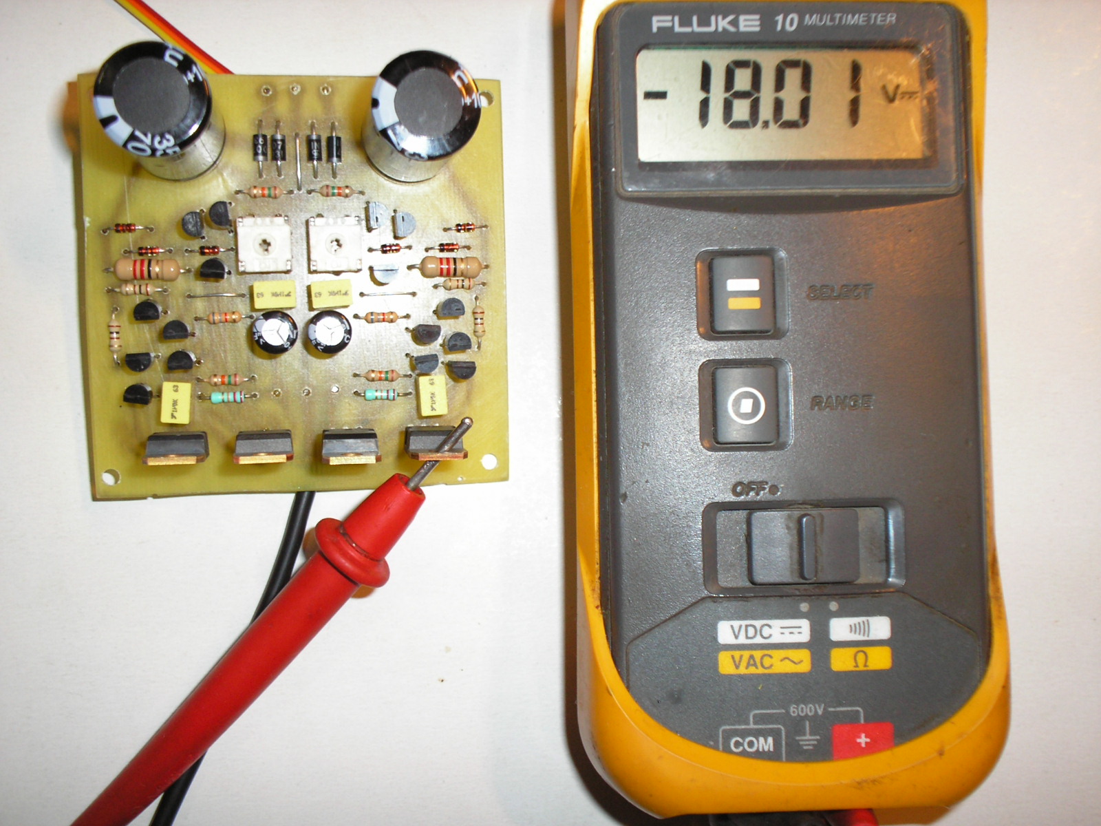

VR 1k must be replaced with 4k7, output voltage can be set from +/-12V up to +/-24V, outputs must have heatsink.
