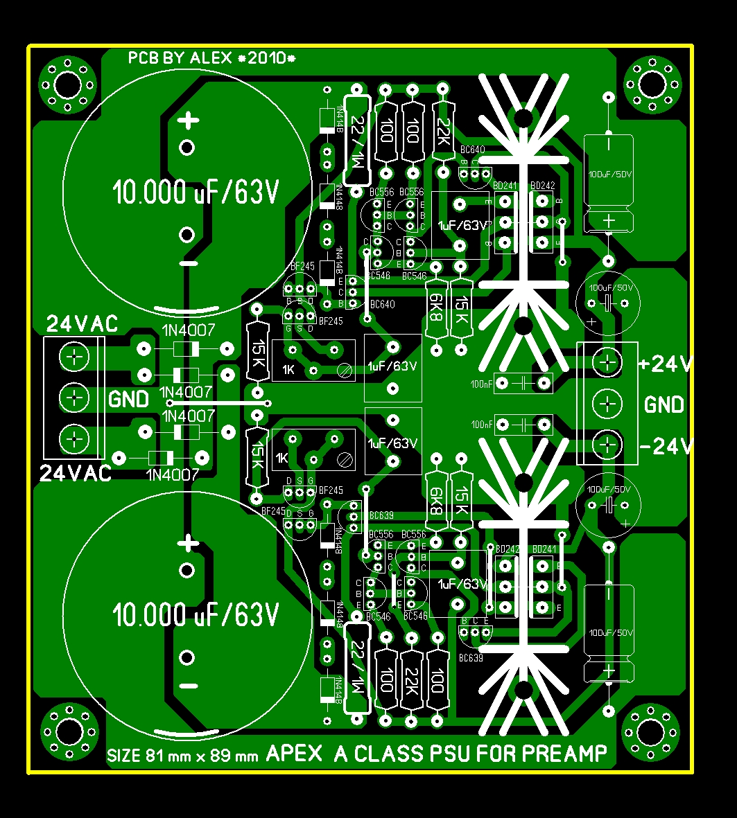

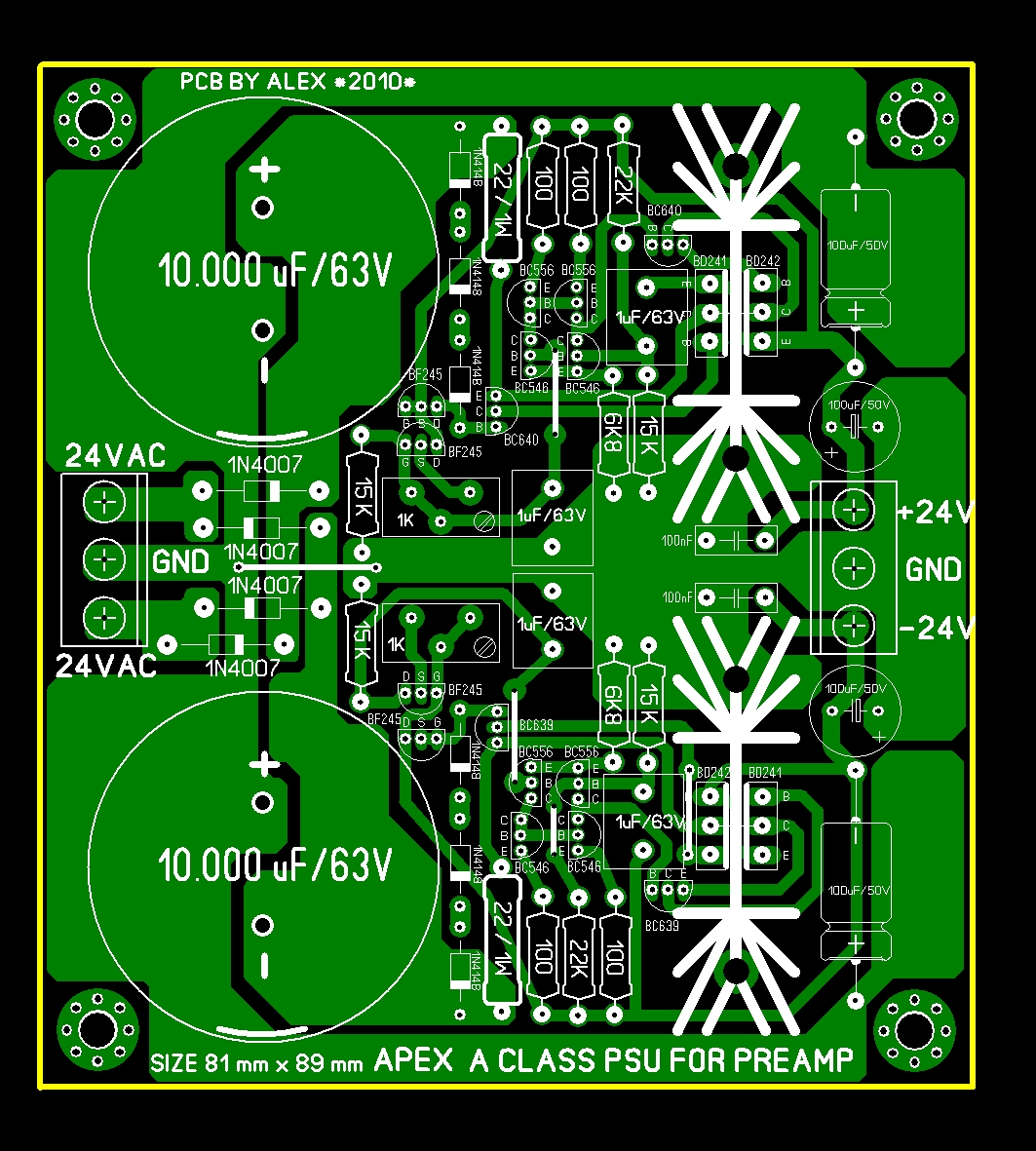

PCB for PSU +/-24 v
Regards Alex.
......now you have PCB for PSU but must be check if it's correct 🙂I have not pcb layout for this shunt regulated PSU for preamps, if someone have time for pcb design..
Regards Alex.
Regards Alex.
Thank You for this design, it's be very usefull for many diyers includeing me.
Do You use heatsinks to connect colectors of BC639/640, BD241/242 to GND?

PCB corrected....
Hi Mile ,
No, I have corrected, adding two jumpers on PCB . I intend to layout PCB for SR amplifier ....nice schematic . Thanks for sharing so many projects .

when i change zener diode it work.now can i use 70volt ac and then can i variable until 50 or 40 volt dc?zener still can change or what?PSU regulator will work, just use 6,8V zeners instead 12V, and you can set output voltage about +/-30V DC.
With zeners from 5,6V to 24V you can get voltages from 24V to 95V.
Regards
apex.can i use 110vac for this psu?With zeners from 5,6V to 24V you can get voltages from 24V to 95V.
Regards
to find high VA transformer is very difficult.at my town supply is 240v and i want to step down to 110V.then i can use 110v to your psu and then variable to low voltage.so i can get high va power supply.what u think?What will be purpose of this PSU?
step down is low price then toroid transformer
