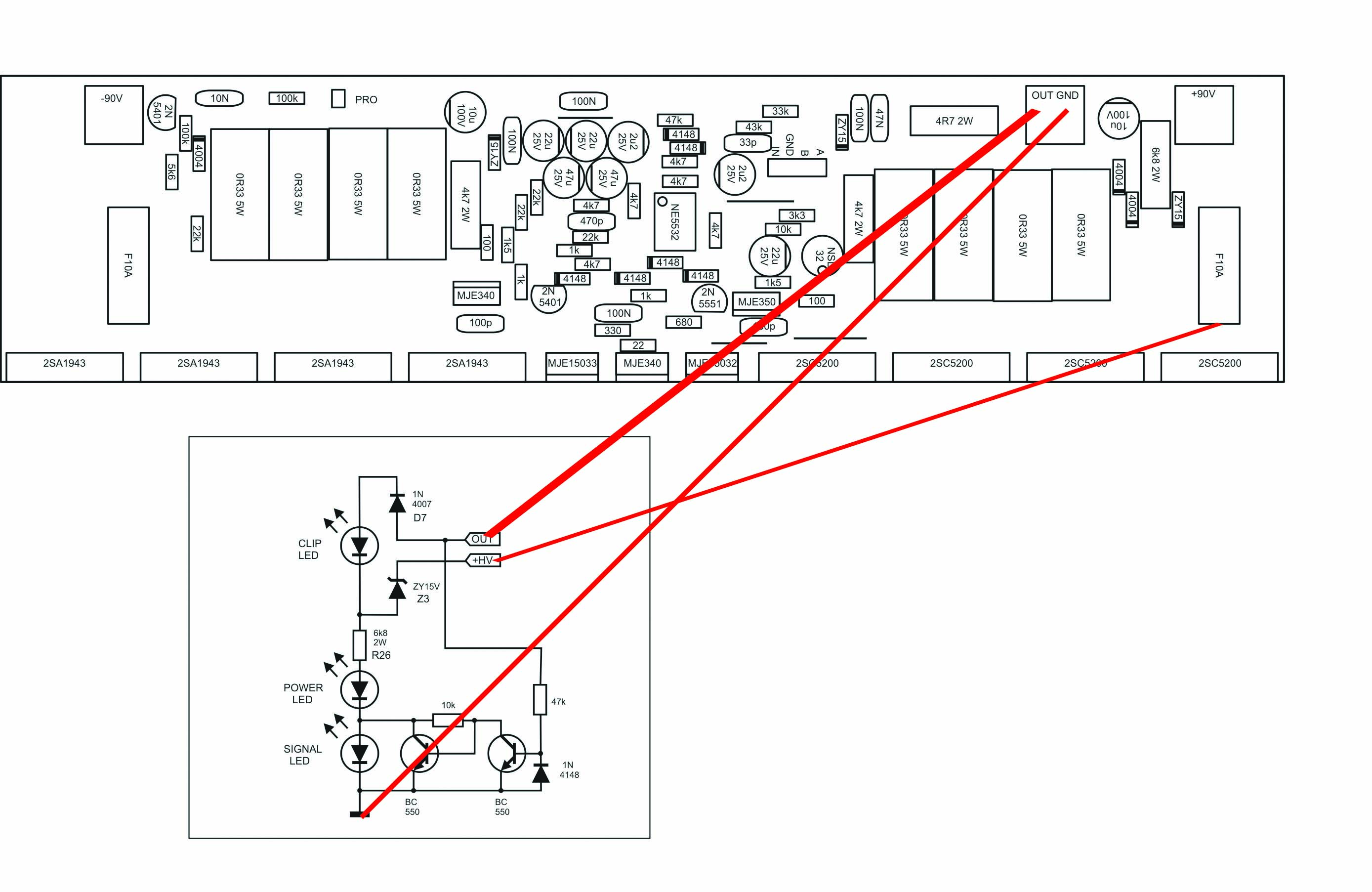

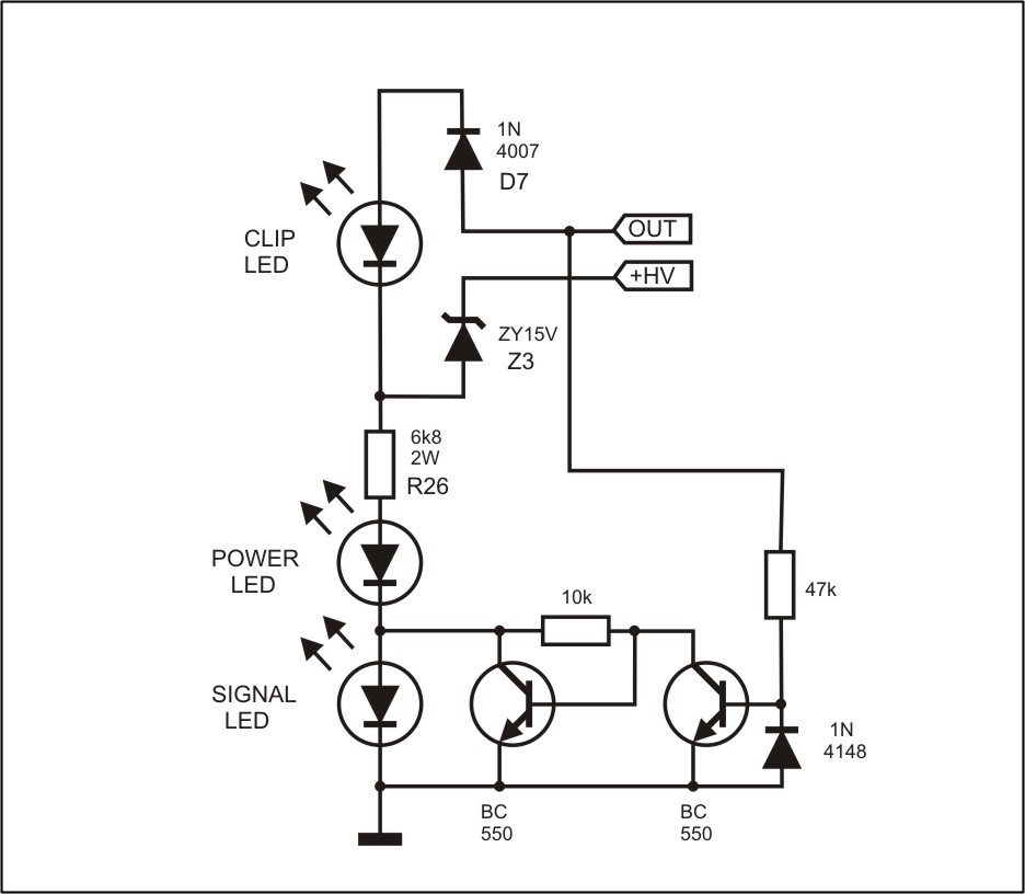

how abbout bias setting?if i use 45vAC supply,.and hw to add signl+clip led?
Set bias to 100mA, and use this circuit for leds.

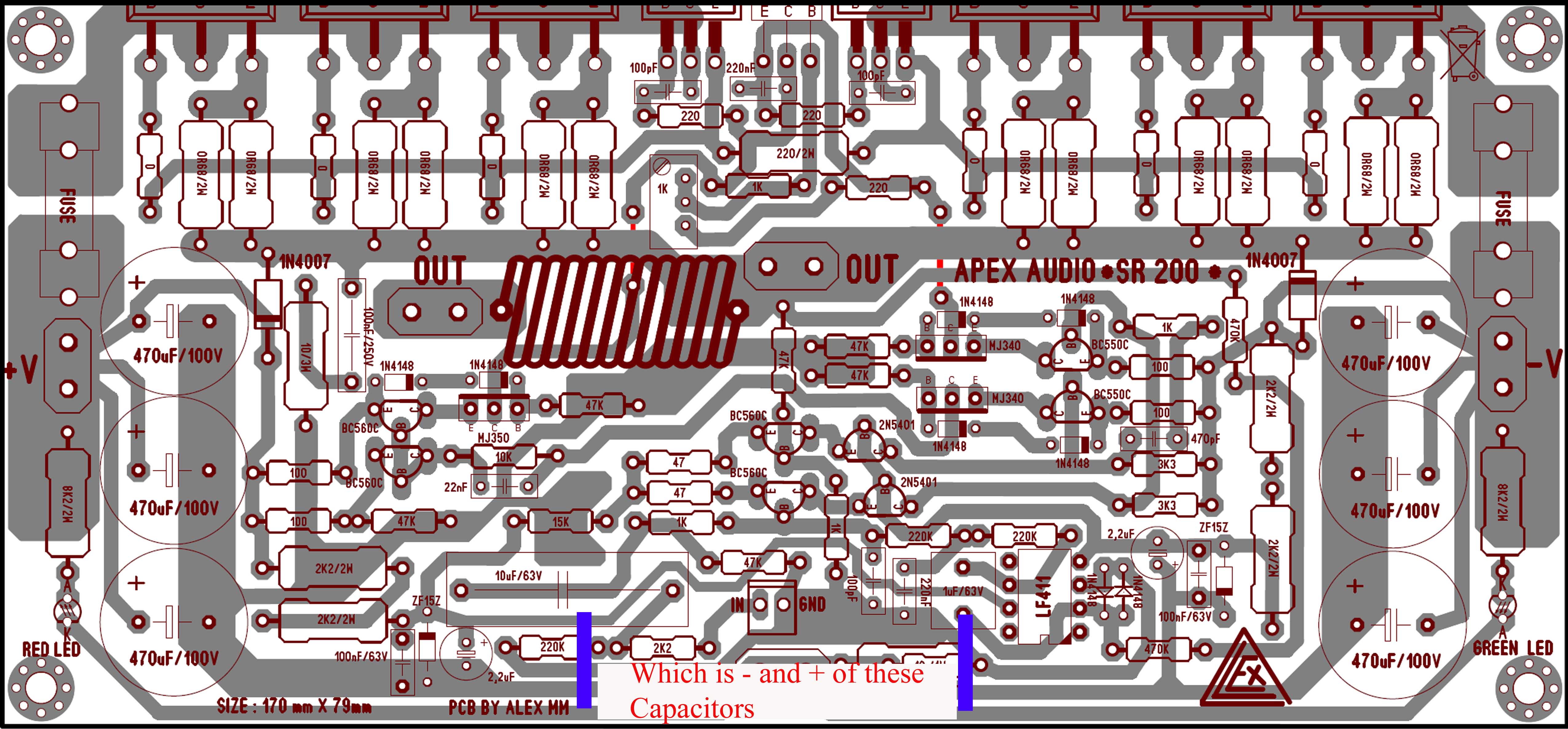

hello, What is the + and - of the capacitors 10uf /63v and 1uf /63v
For testing purpose i will be using 37-0-37 v 5 amp transformer, do i need to make any changes to the components value. and the resistor is it Or68 or zero R 68.

.... use only one resistor ,with value 0.33 ohm/ 4W or 5W se schematic 😉
Alex.
My bad , i should have seen the schematic, thank you so much.

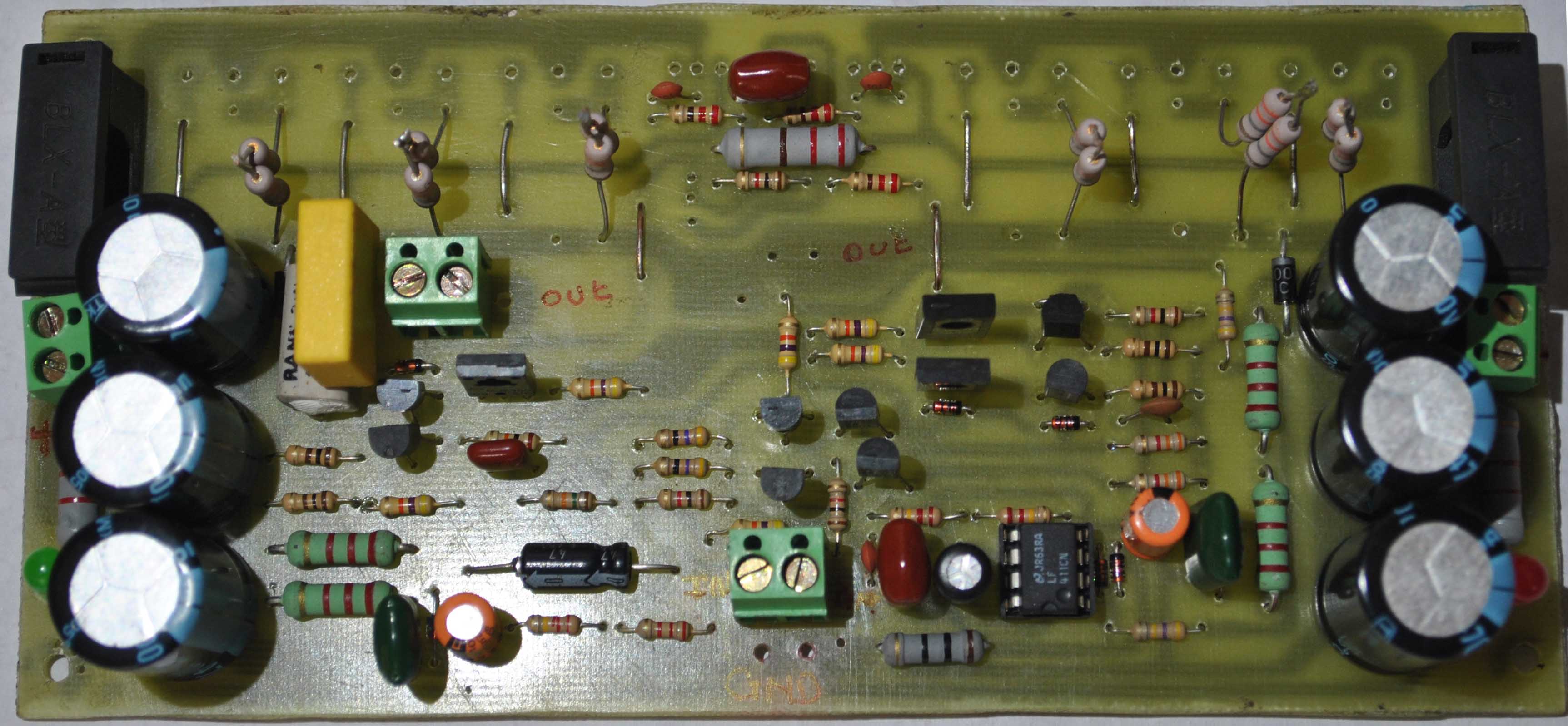

Hello,
Finished assembling most of the amp pcb, except the transistors.
Please check before i finalize it.
My test psu is 37-0-37 3 amperes, is it fine. What test measures should i take for proper running of the amp.
How to set the bias for each transistor , I have never done before😕😕
I did not get 10uf bipolar 63v, so 50 v is mounted.
did not get e33 5w so e33 1w series mounted.

Hi ,
Very nice board , but please change resistors to correct value 0.33 ohm /4-5W .
It's only one way to find how will affect by replacement , but pakage MT200 are a little to big for this . IMO not will affect the sound .....🙂 You cannot set bias for each transistor , just for all tranies from one rail , positiv /negativ adjusting 1Kohm trim potentiometer (wich is missing from PCB )

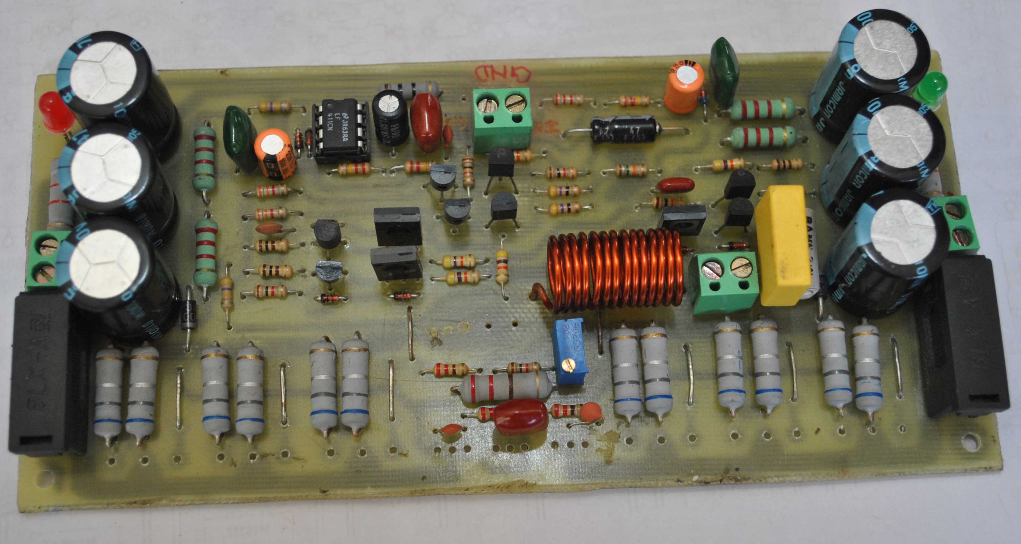

Hello,
Got the trim potentiometer mounted, 0.68 ohms 2w resistors mounted, Coil at speaker out.
Alex what is the purpose of coil at speaker out.
Should i keep 10r 1w which is connecting Input gnd and Psu gnd, or remove it.
Is it possible the output will distort at high volumes if not using protection board
Will mount transistors today after your review.
