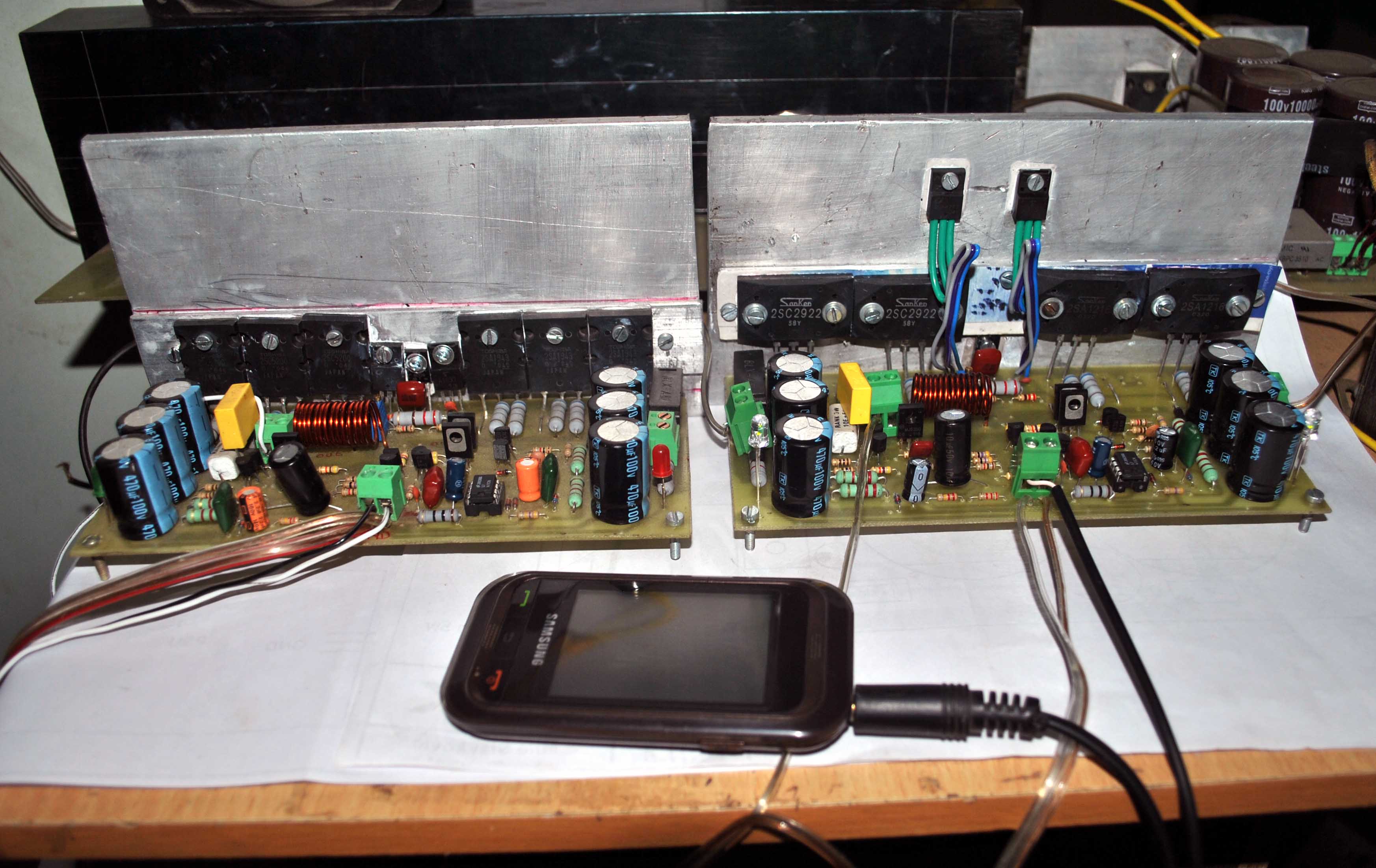

Hello,
OK, I have not paralleled the resistor to inductor, Will do it.

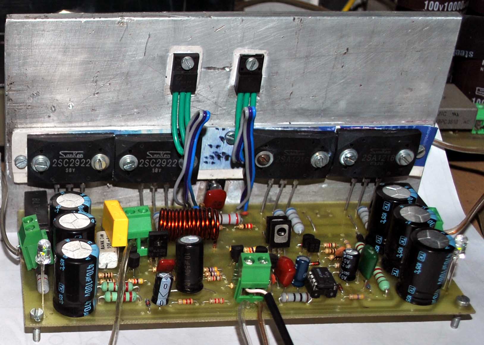

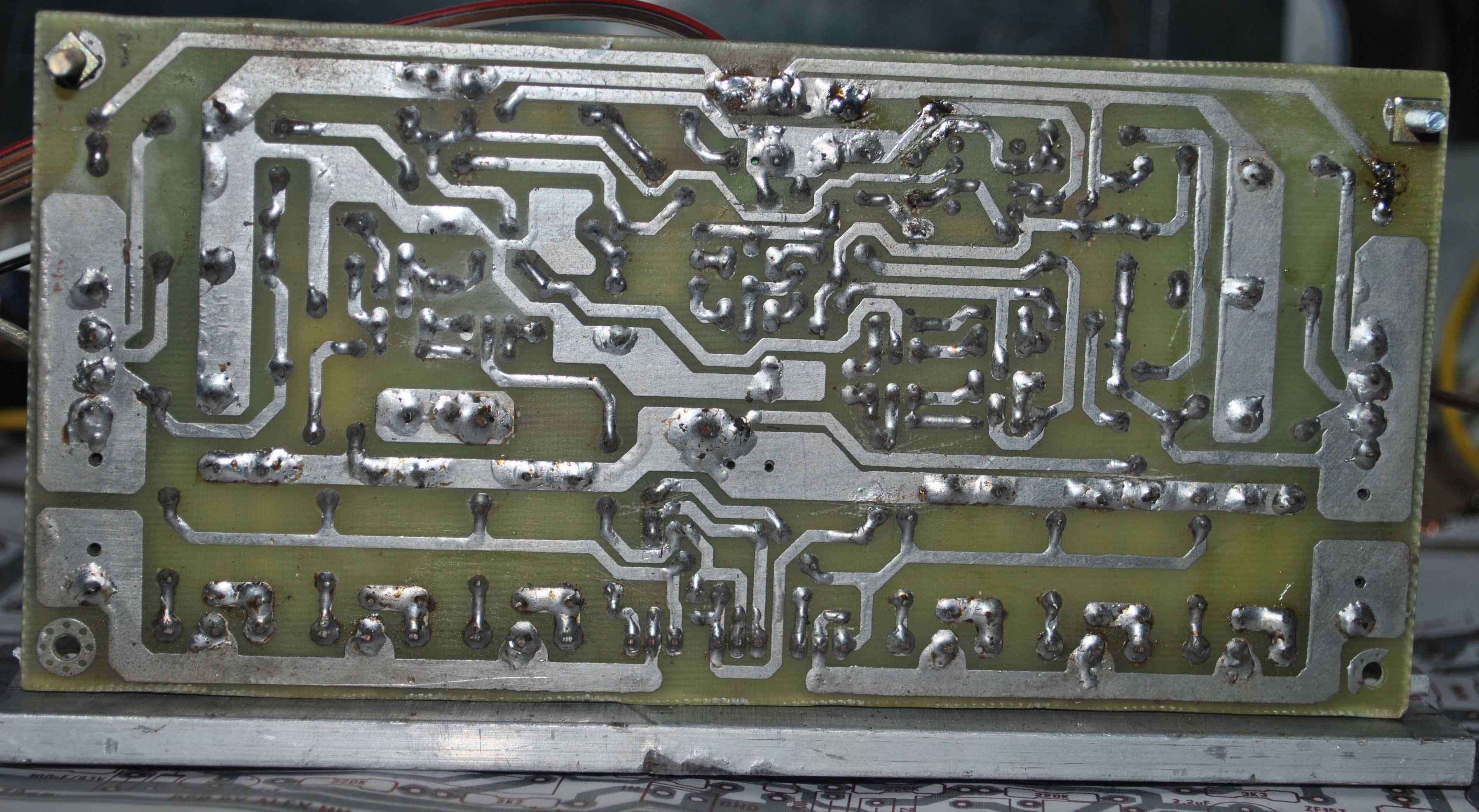

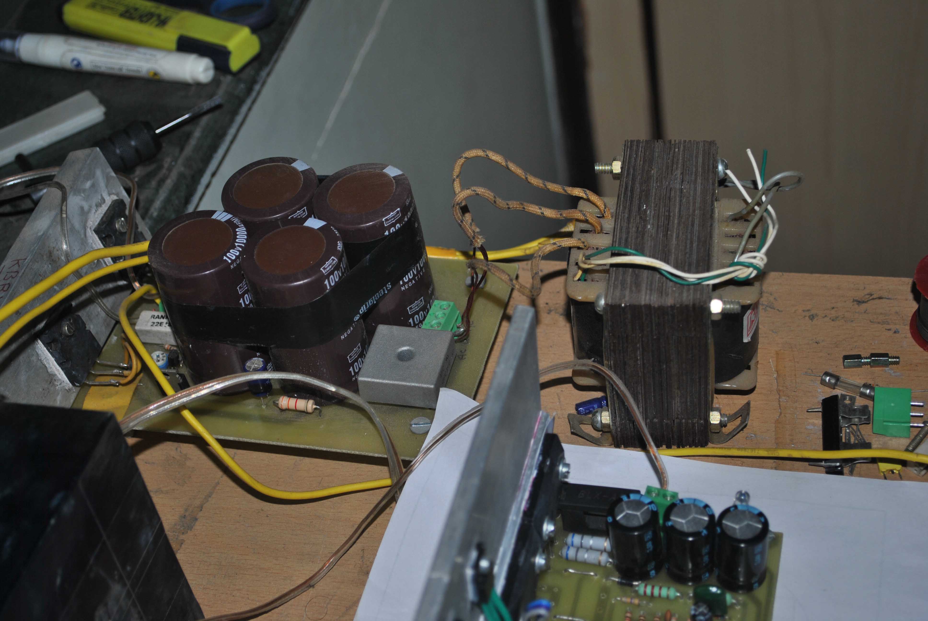

Alex I mounted the transistors, and connected to psu.
Fired up and connected to mobile phone---- No sound.
Mobile disconnected Touch input pin with hand it make lots of noise and 22e resistor on psu gets extremely hot.
Checked all the connections.
Checked for shorts- No shorts.
Checked transistors for short to heat Sink- No short.
Disconnected speaker gnd from psu gnd- Psu resistor does not get hot, Connect again gets hot.
what Could be the problem
what Could be the problem.
And how do I Measure and adjust the Bias, Please Show exact procedure, I have never done it before.

Hello,
Sorted the problem Short at two places.
Now amp is superb sounding. Will Populate second pcb to complete stereo set. Not checked the bias still, Please help.

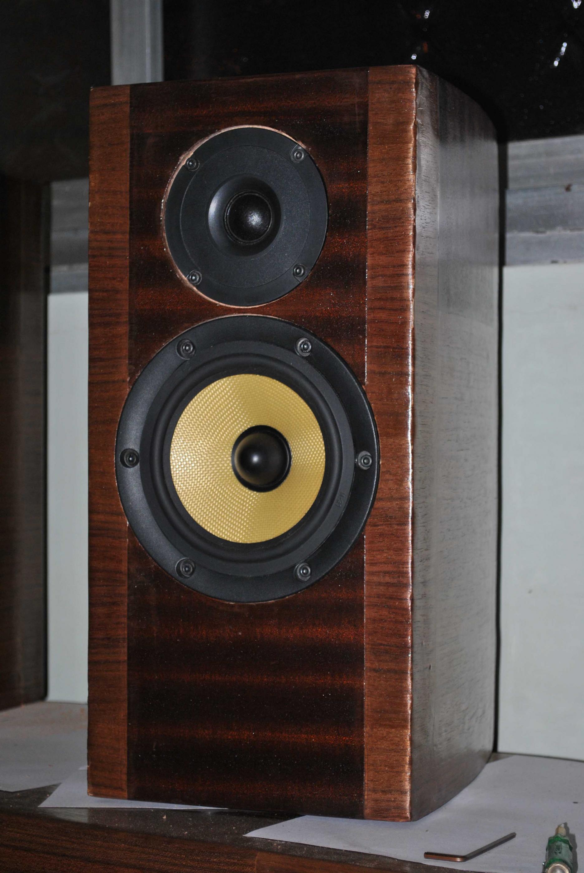

Viki, what speakers you use for test this amp?
Regards

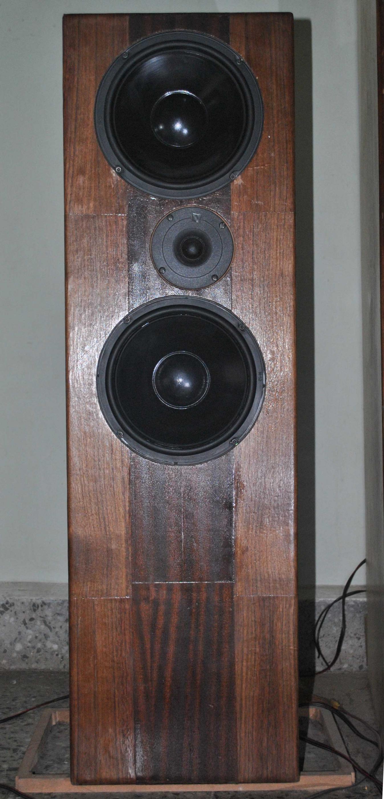

Hello Mile,
For testing i used bookshelf Speaker 5 1/4" Kevlar cone woofer and 1"Fabric Dome tweeter both from Peerless India.
Floor standers are using two 8" Woofers and 1"Fabric Dome tweeter from Peerless India in MTM configuration.
But now I think I will make it a full 3way Design by modifying the baffle and adding a 5 1/4" midrange woofer.
I am targeting the amp to drive These floor Standers. and Bookshelf's.
As only 1 channel is complete I have not been able to check the big speakers fully.
I do not have any preamp, Signal Input is Mobile phone.

Sr200 Amp Assembled second channel

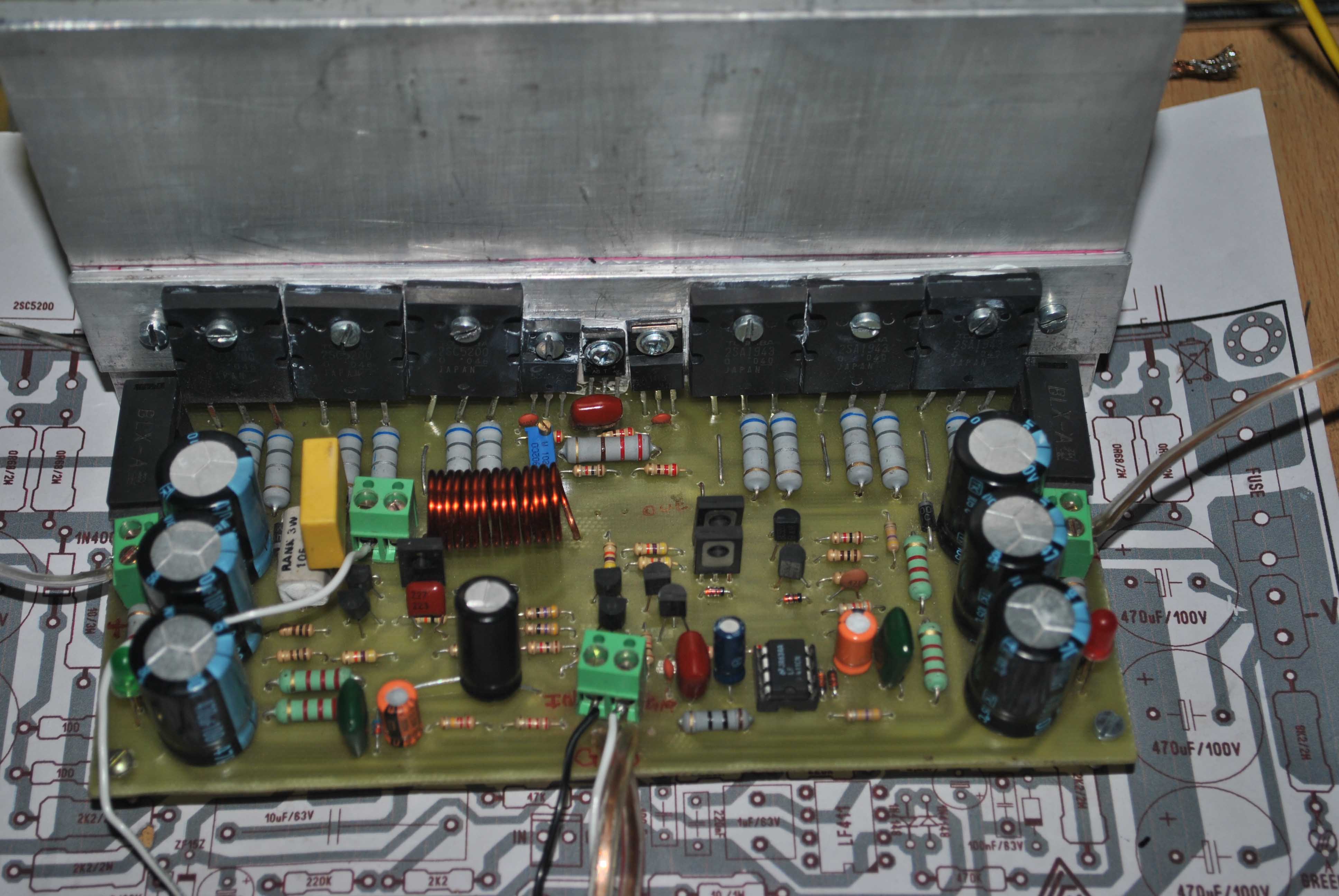

Hello Mile and Alex,
Finished Second channel with 2sc2922-2sa1216 pair.
This time no problems working fine at first start. The pcb seems to be a bit small for components, Not the transistors.
Regarding Sound- There is Big difference. Amp with 2sc2922-2sa1216 has more controlled and defined Bass, Mids are more open and highs are more crisp, Not that first Channel lacks anything , Just the difference I Experienced .
Will have to give more time for both the channels to break in. Some upgrades should bring out the best. These transistors are very well worth Upgrading , only factor is price, Here 2sc5200-2sa1943 sell for 4$ a pair and 2sc2922-2sa1216 sell for 14$ a pair Big difference.
What will be the output with two pairs 2sc2922-2sa1216 at 8 ohms and 4 ohms. Will add another pair soon. MY psu is lower capacity will upgrade it soon.
Chassis will be coming soon, Will Post images when done.
I want to upgrade to better components to find the difference, Can you suggest what upgrades should I do to make this amp sound to its Best.

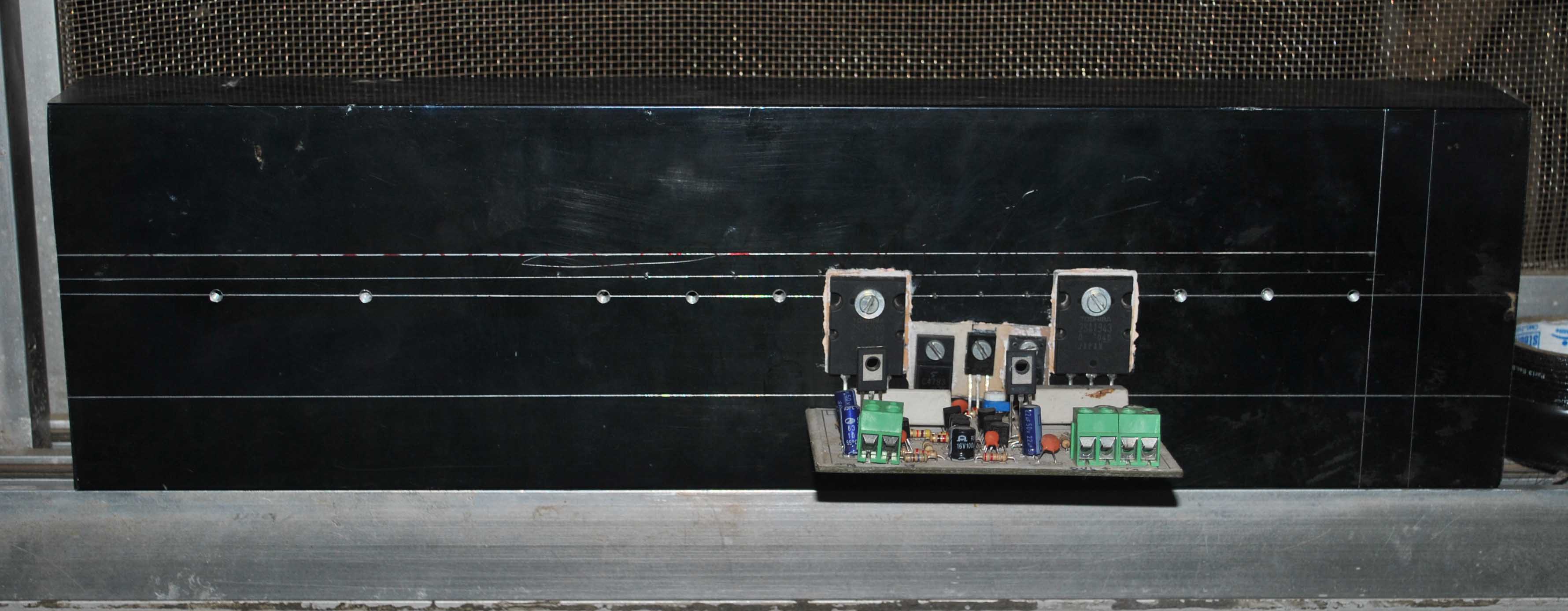

Will be using this heat sink for 1 channel hope tit is sufficient for full power.
