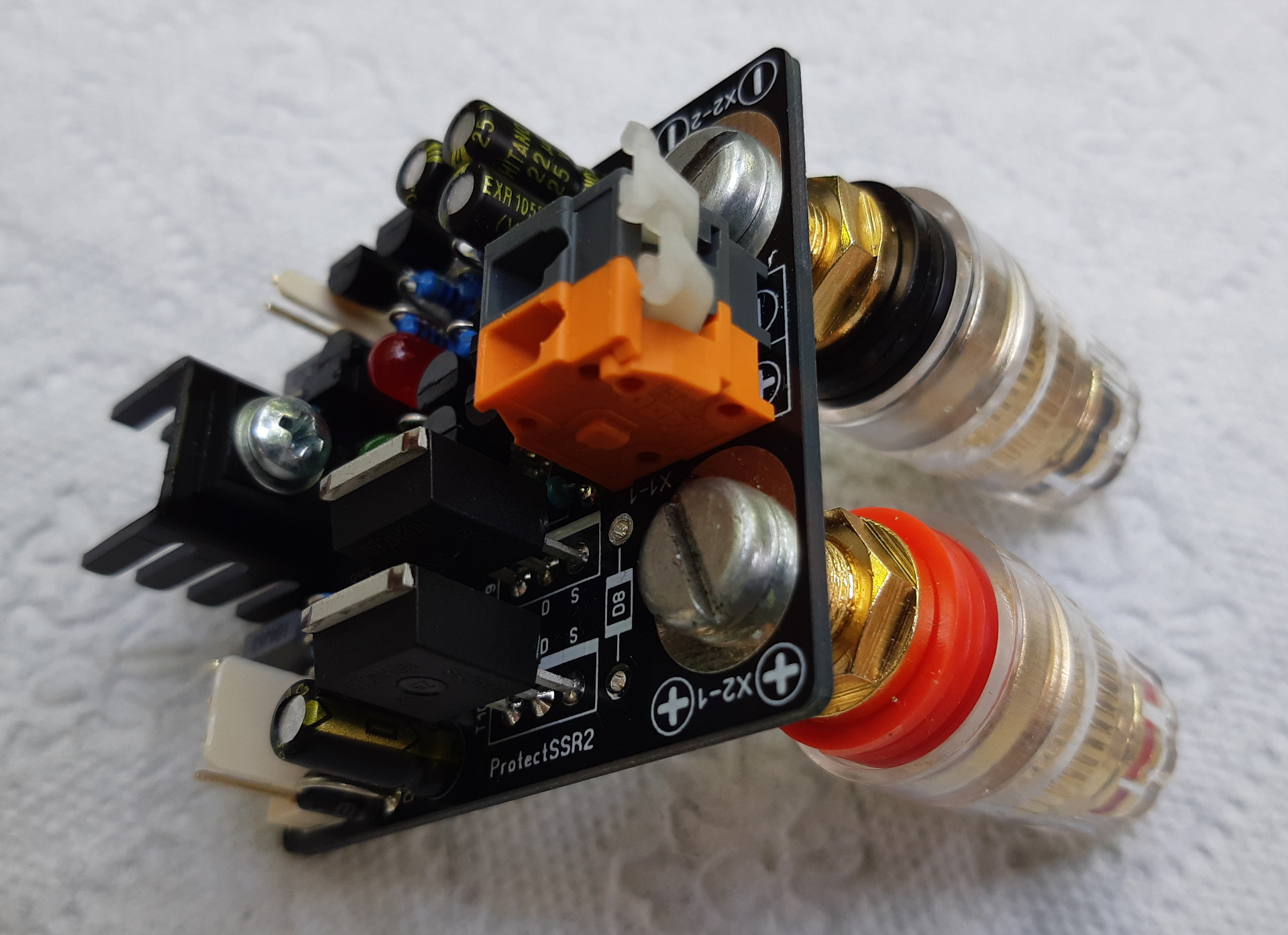

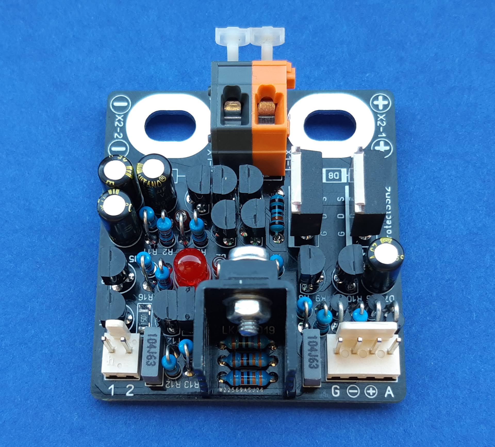

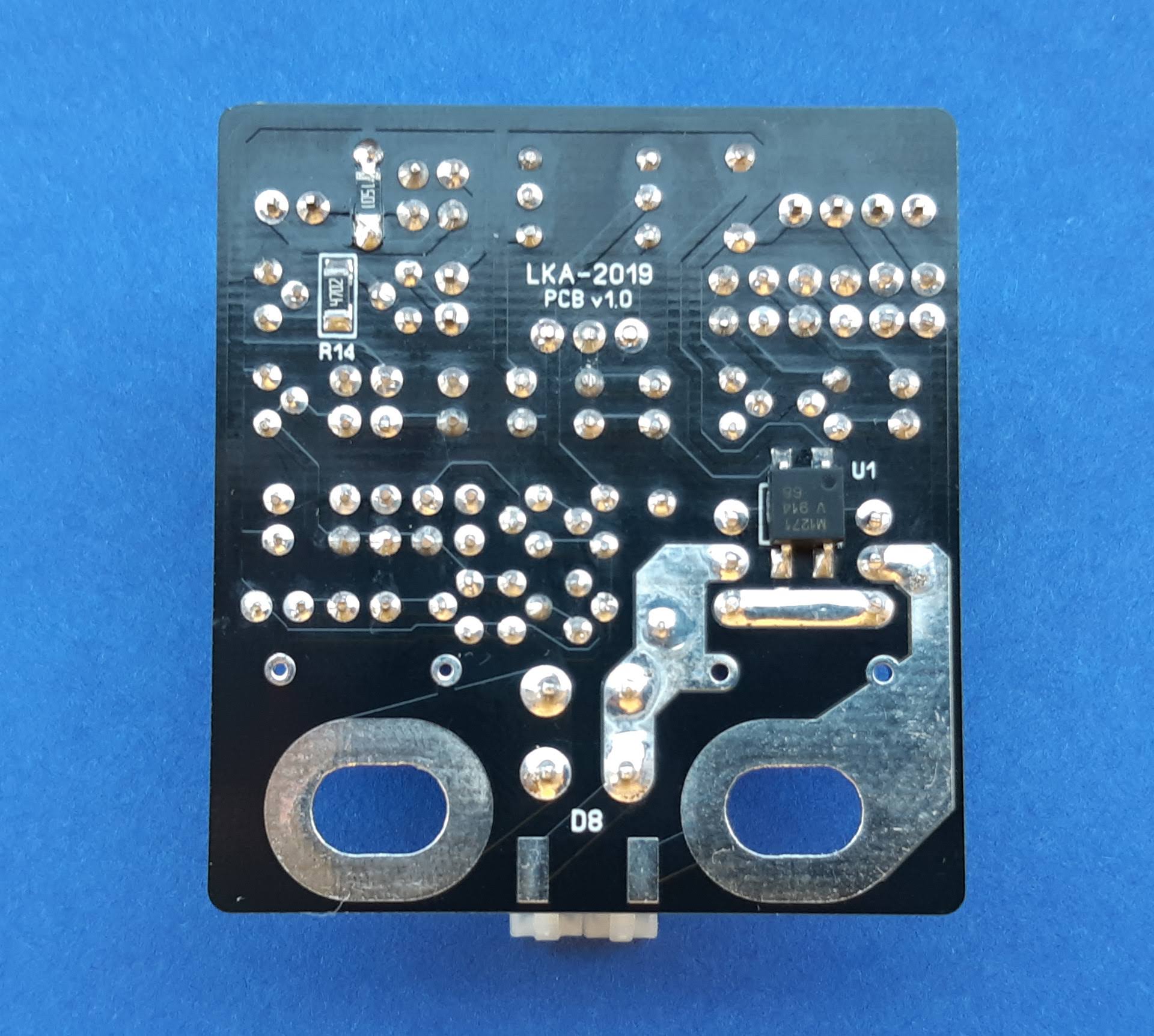

Finished SSR PCB
Just finished and tested my SSR.

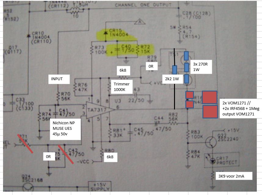

SSR is based on the TA7317 chip which operates 2 VOM1271 photovoltaic drivers which outputs are parallelled to drive 2 IRFP4568 FET's.
Measured DC resistance is 14.5mOhm. This is measured with currents in a range from 10ma to 3A. DC resistance doesn't change. (Measured with fluke 8808)
Turn off thump is not existing, turn on delay can trimmed to about 10seconds maximum.
DC detection is according graph a couple posts back.
This PCB is getting the mains supply from the soft start PCB.
Forgot the pictures

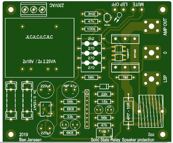

PCB tracks for signal are as short as possible, but the output air coil can pick up noise... yes, I think I can follow you. I'll keep it in mind for the next revisions of my SSR PCB.

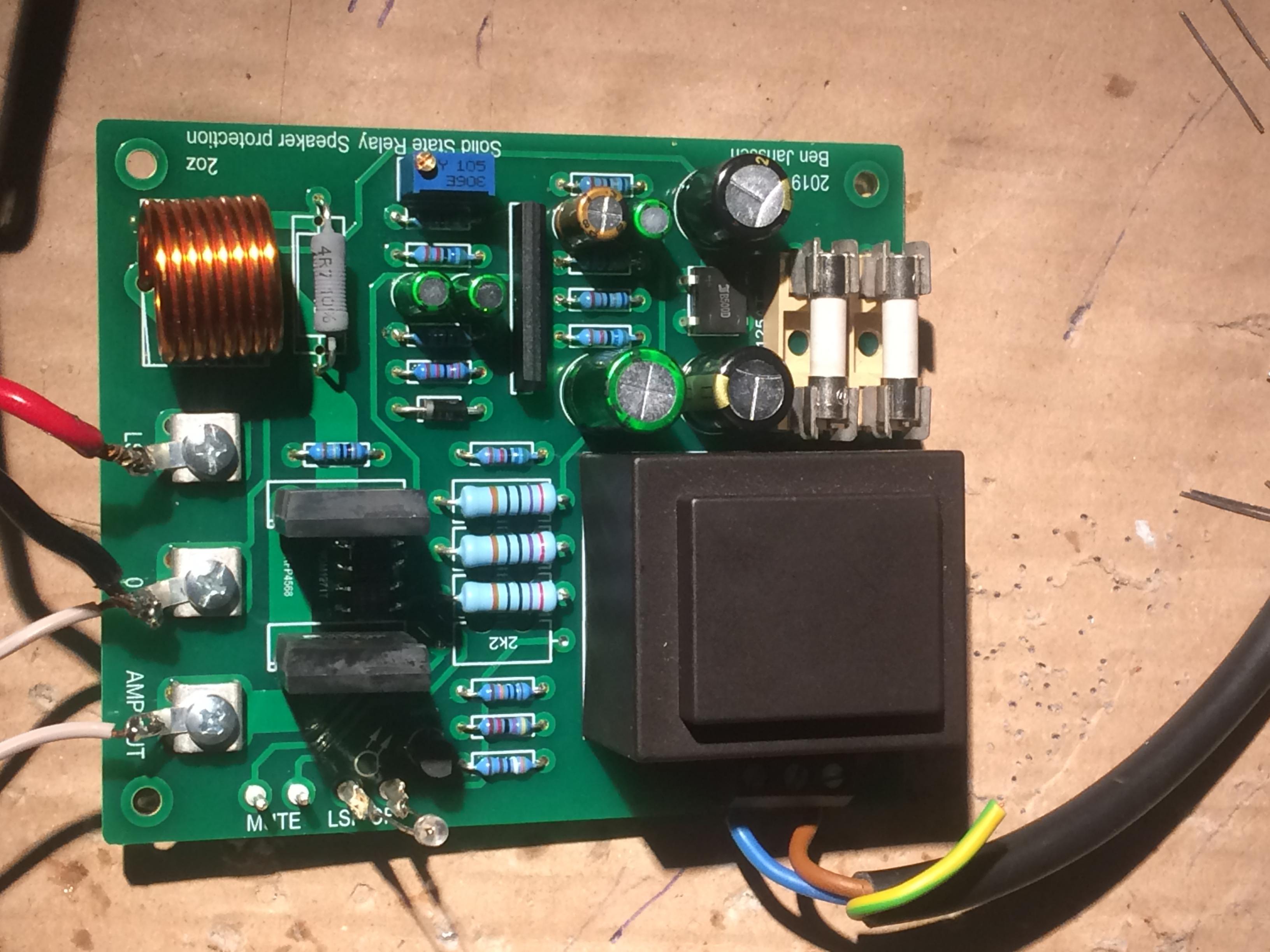

I have designed 3 generations of speaker protect circuit.
The left one is a mechanical relay with dc detect and power up delay.
The middle one is solid state relay with dc detect and power up delay.
The right one is solid state relay with dc detect, over current detect and power up/down detect. All three use a PIC micro to get some intelligence into them.
Could you share schematic and code (source code and hex) from the biggest board (the one with over current), please?
We all in forum thank you to provide us your expertise.
Ronaldo
Ronaldo
Code below picture.

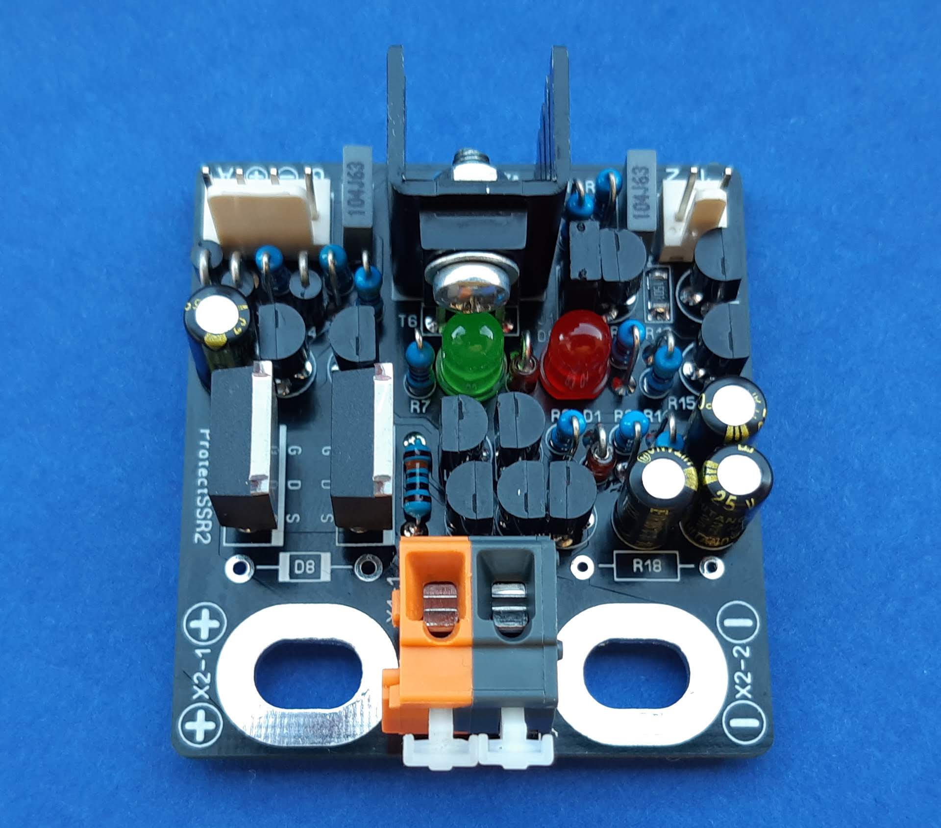

LKA, thanks you for sharing..Great protection
Will use the SSR with a 12V Aux PSU
Can you give us some guidance on how to select D8 TVS bipolar? too many and confused..Thanks
FR
(Mosfet Vds) > (2x PSU_V+)
(PSU_V+) < (TVS Vr) < (TVS Vc) < (Mosfet Vds)
So, for 120V mosfet (max +-55V PSU at idle) use
P6KE68CA,P6KE75CA - TH, pcb front side
P6KE75CA Littelfuse | Mouser Europe
or
SM15T68CA - SMD, pcb back side
SM15T68CA STMicroelectronics | Mouser Europe

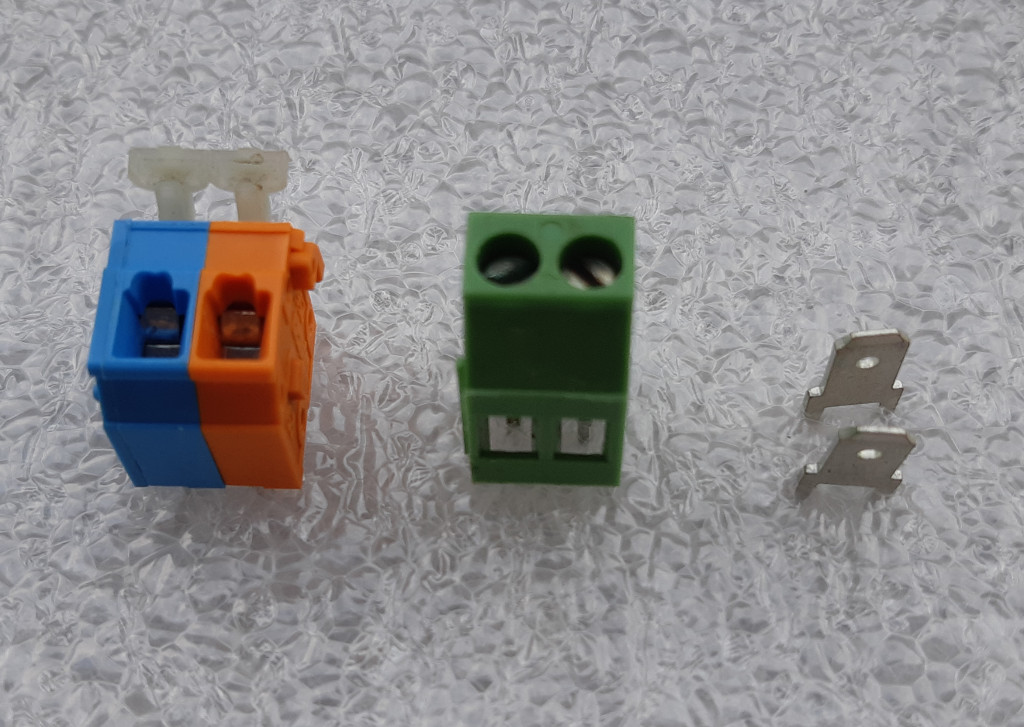

X1 terminal options
WAGO255
https://uk.farnell.com/wago/255-401/terminal-block-wire-to-brd-1pos/dp/4015319
SCREW
https://eu.mouser.com/ProductDetail...=sGAEpiMZZMvPvGwLNS6718PaoTt7FM7cmRmr0lx4Kvg=
FASTON
https://eu.mouser.com/ProductDetail...EpiMZZMvz8LftK4jeru53zRJYi%2BfP%2BP2t3D/egnI=
or
X1 terminal options
WAGO255
SCREW
1711026 Phoenix Contact | Mouser Europe
FASTON
726388-2 TE Connectivity / AMP | Mouser Europe
Thanks LKA, great
hi LKA, one more thing for now, I have a very hard time to find the heat sink for T6 with this exact dimension, It's very close and very tight between the components and i don't have much choice.
Could you post the model or the link please?
for 12V you don't need heatsink
24V - use 532-577102B00 (mouser partnum)
above 30V - use 532-577202B00
40V-55V - you can add 470R-1K/2W resistor to the V+ line

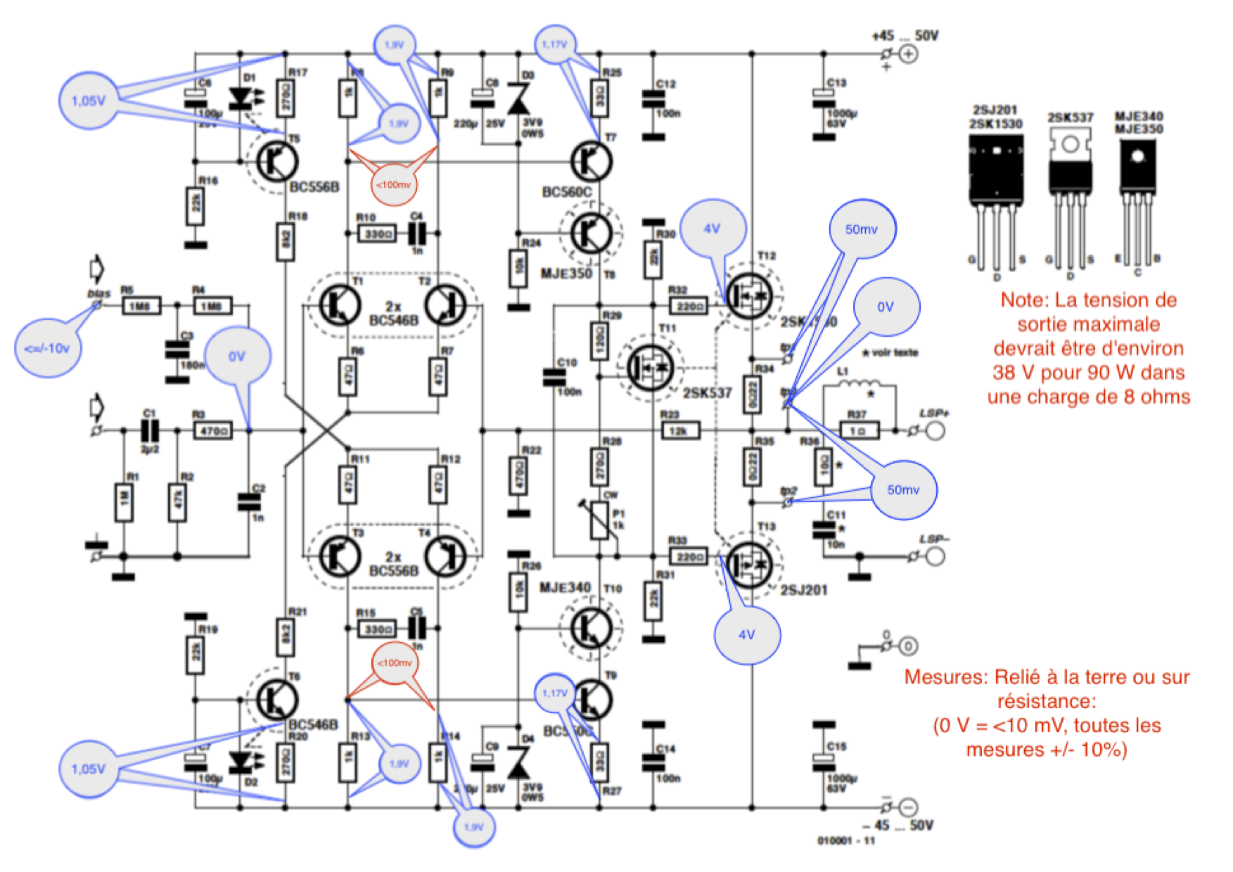

I have an other project (crescendo Millennium) i am not very confident with the Elektor SSR Protection included, i plan to add your over-current protection and option 1 to it.
I will follow your guidance for RS1 and RS2 in post #61
RS1=100R and RS2 not populated, is that correct??
