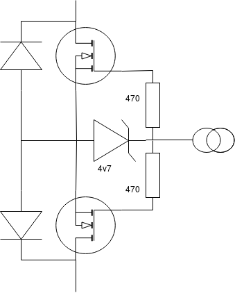

how much voltage are we dropping across the SSR?
Were switching these mosfets at audio frequency, is it audible?

Here's a schematic of our speaker relay boards. Voltage drop across the SS relay isn't measurable with properly selected mosfets, they 2.5 milliohms resistance in switch mode on a good mosfet. Switching is inaudible, the only possible noise wound be turn on thump from DC offset which shouldn't be there, otherwise it shouldn't turn on.

Thank you, thats a serious mosfet. Specs show one needs 5v to turn it fully on. In tests does the turn on thump prevent the relay from turning on? seeing that your not implementing delay else where. Class A buddies might be upset adding an active switching stage to the 'pure' signal path

Turn on delay and latching off are controlled by the microprocessor in our system where it's easy to adjust time intervals. With the circuit in the .pdf any DC above 1.2V will prevent the relay from turning on.
Some people can hear the difference between blue and red wire. If someone chooses to believe the nonsense that a couple milliohm resistance (this is less than most relay contacts) will cause an audible difference in a system they likely won't be running any protection anyways.

Its good to drive the mosfet gates directly from the DC detection circuit (fast) and then to use the uController to hold it off or do any other housekeeping/detection etc.
I am switching a 60A 10ms pulse in <100uS using 2 x VOM1271 - each provides about 16uA forward current, so total drive is 32uA per channel.
Mosfets don't suffer from secondary breakdown and can handle very high peak energy levels - see the data sheet of your respective mosfet for details. You just have to select a mosfet with a suitable energy rating - there are formulas for estimating the peak energy based on current and rise time. With lower energy rated mosfets, you will need to switch faster to stay within the energy dissipation boundary.
On my gear, I look at gross current overload (sensed directly across the emitter degen resistors with an opto), DC offset (typically +- 1.5V~2V) using a 3 transistor DC detect circuit. Both of these switch the mosfet gates OFF directly and also feed into the uController.
The 2nd DC detect loop is off the DC servo. I trim the DC offset to zero with a pot so that under normal operation the DC servo output is only around +-100mV. If there is a gross DC offset fault, the servo output slew to one of the opamp supply rails and that's the other input that drives the mosfets directly. If there is a partial short, the servo output will also increase dramatically, so these faults are also caught in most cases.
In effect, the microcontroller is in parallel with the DC fault detection circuits (so reliability of catching a problem is improved) and will decide whether to keep things off or not depending on the fault - e.g. a temporary short circuit of the output. For example, If there is a gross short, I turn the amp off and it won't come on for at least 3-4 minutes to make sure all the output transistor die temperatures have cooled off.
I monitor heatsink temperature as well.
If you are using a uController, make sure your watchdog facility is used - you don't want it hanging up.
I've also measured my amps with the SSR in situ and bypassed - the distortion is below the QA401 noise floor so the SSR can be effectively discarded as a source of non-linearity. This does stand to reason since in the ON condition, the total SSR end to end resistance is 5~10 milliohms while the load is 3 orders of magnitude higher - any ON resistance modulation (and there is very little of that) is completely buried by factors.

My SSR speaker DC protect uses a PIC micro.
If it sees DC for > 500mS it turns off the relay.
It also has anti thump power on delay.
I used a opto coupler from the PIC to the mosfet gates.
I used a dual secondary mains transformer, one secondary for the PIC and the other for the mosfet gate power supply.
I buffered the output of the opto coupler with a totem pole.
To do without a heat sink I used very low RDSon mosfets.
I can get upto 500WRMS into 4 ohms with my current mosfets with no heat sink.
