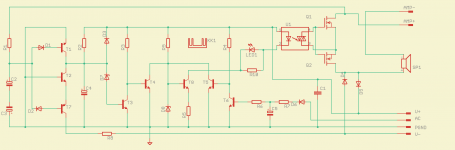

That looks like a good solution. I'm glad you added the diodes D7 and D8 because many amps don't include them.
Can you give us some guidance on how to select the resistor values RS1 and RS2 for the over current circuit?
Choose RS1=100R (current limiter for IR led)
PC817 has forward voltage approx 1V. If RE=0.22R then Ith=1V/0.22R=4.5Ap
If you need higher current threshold, add RS2 (voltage divider).
RS2=100R Ith=9Ap, etc

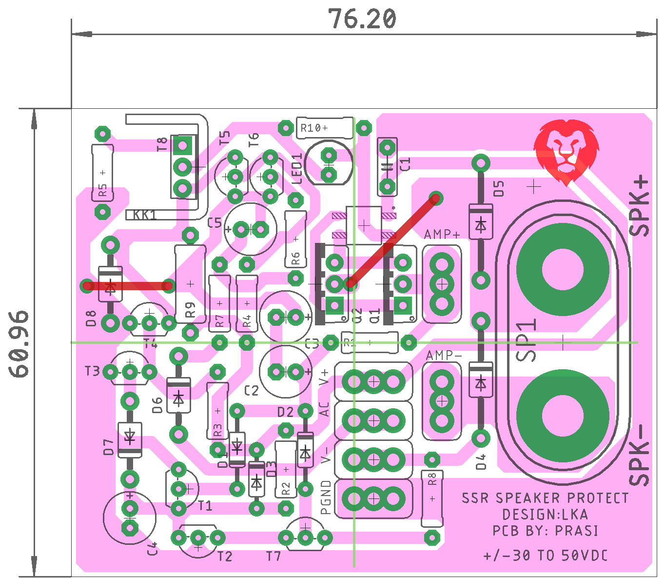

Still a rough design, need to see if binding post on a side can support PCB components. Otherwise , a hole for plastic standoff on the left side would provide necessary support for the PCB.
Regards
Prasi

I have been searching for a proper SSR protect too for a 60-100W home amplifier, so stumbled here by chance. I made the PCB for diyers, so thats why single sided, (for home etching).
regards
Prasi

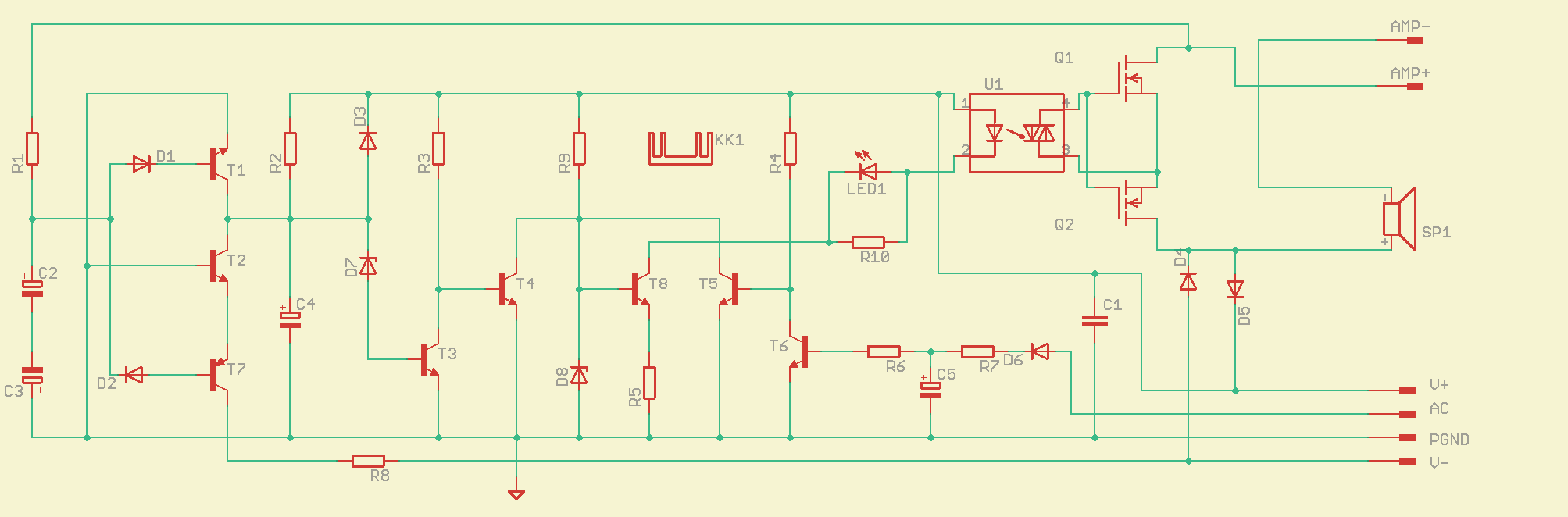

Hi, You can leave out D1,D2 (or short them out).The detection threshold will be lower. If you want more symmetrical detection, just short out D2.

Pl note that this circuit is based on post no. 31 by LKA.

Thank you LKA for your suggestions. I will keep them on the pcb for the present. One could short or just remove D2 as per his preference.
Regards
Prasi
Another suggestion. Connect T5 collector to D3-D7 junction. C4 discharging will be quicker when AC is lost. (component numbering, post 65)
Check my last schematic, post 58.
