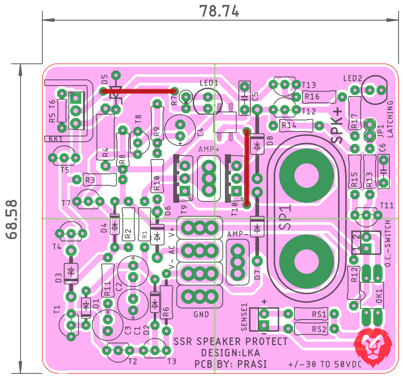

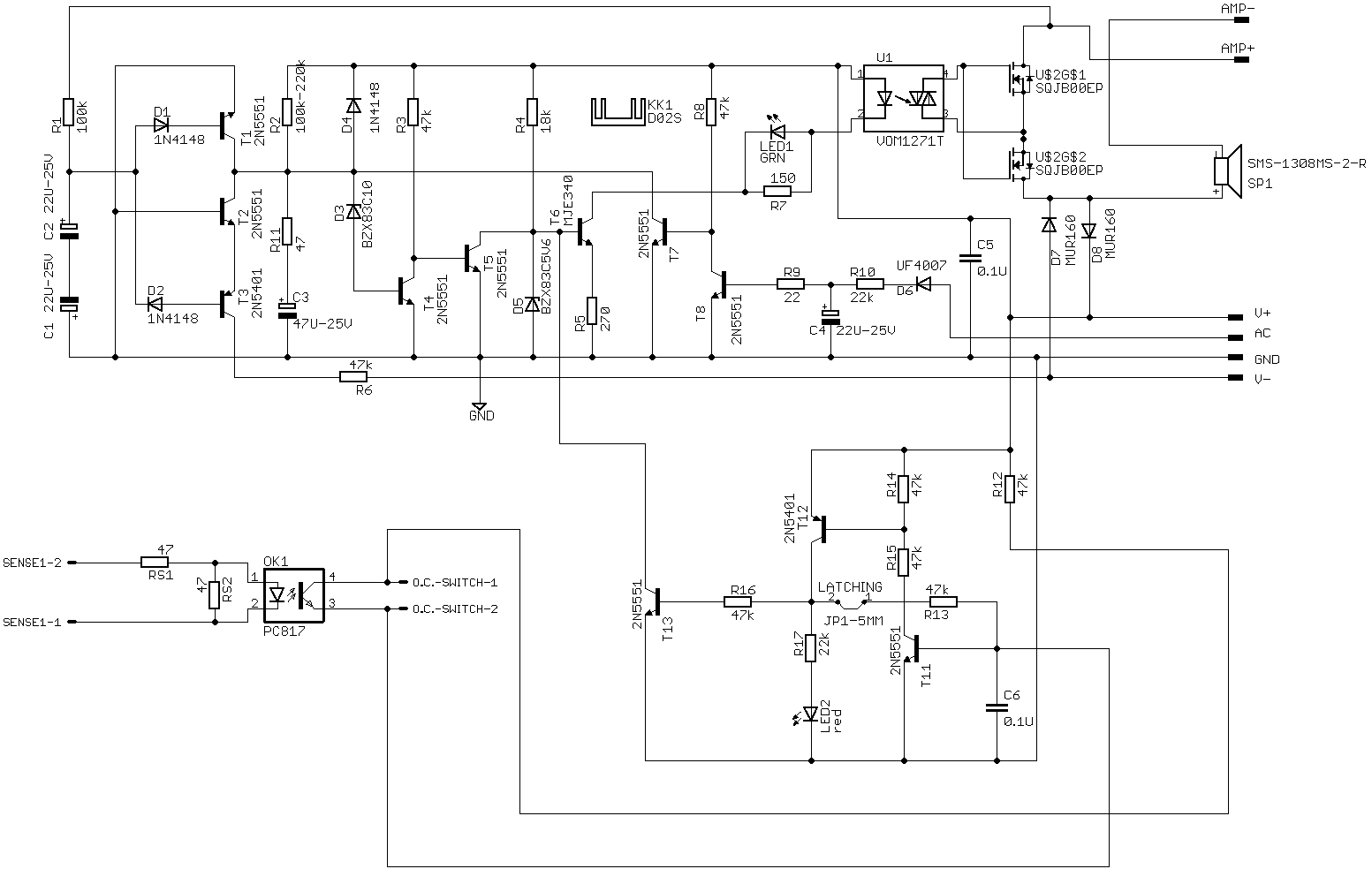

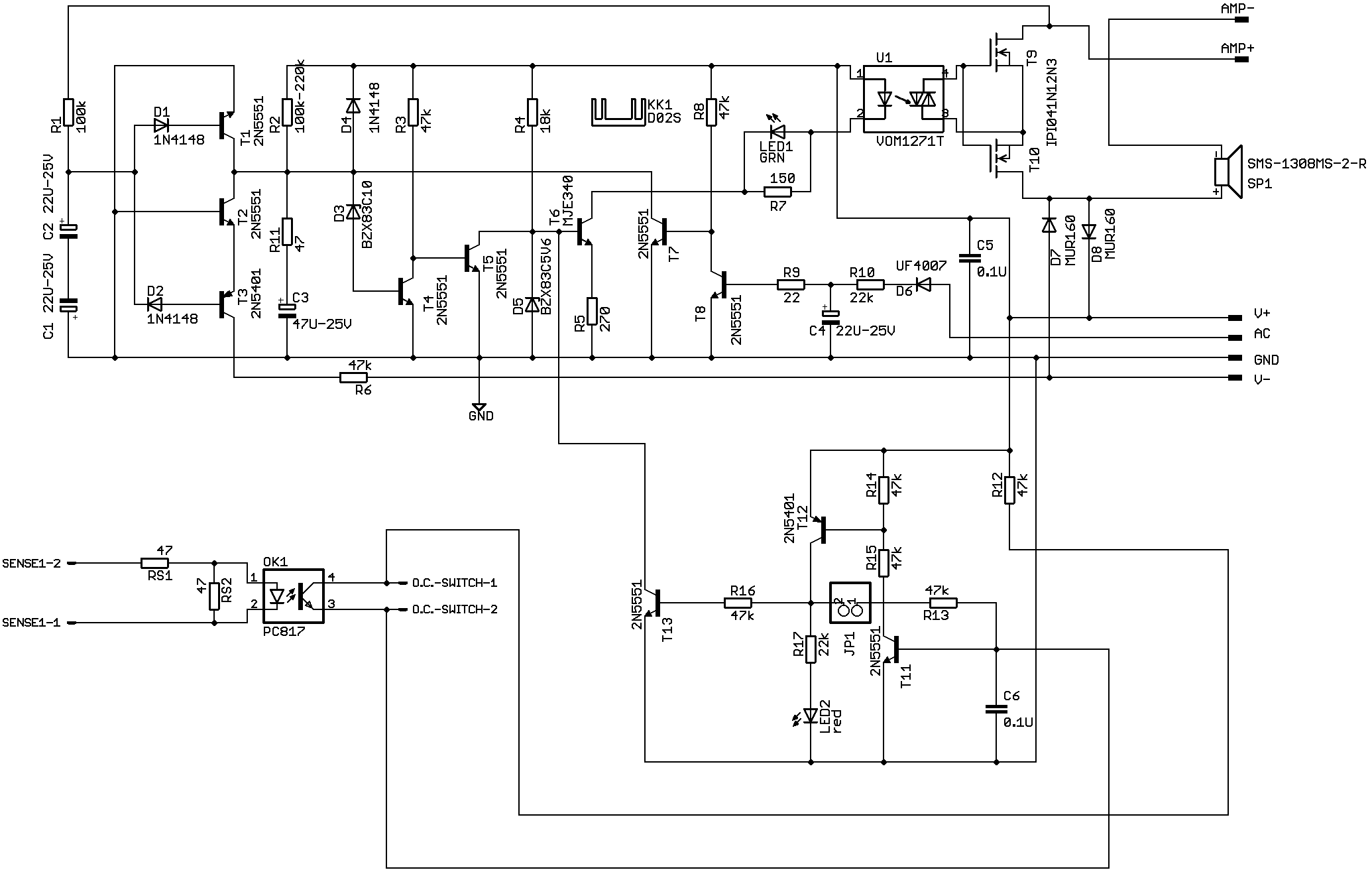

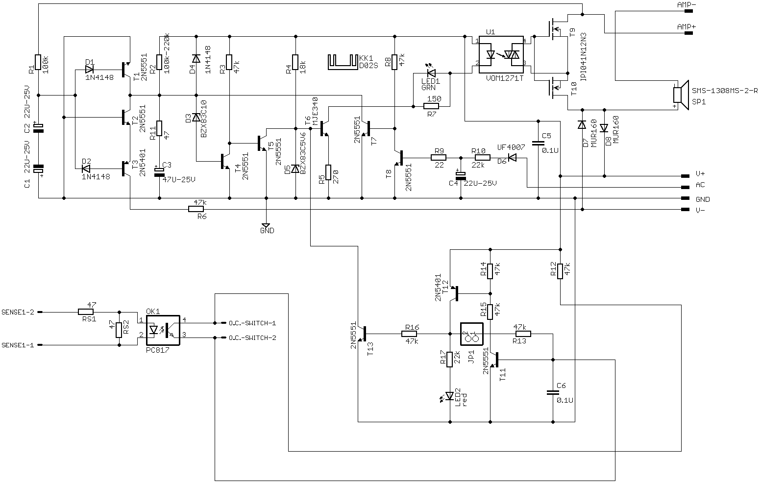

Another suggestion. Connect T5 collector to D3-D7 junction. C4 discharging will be quicker when AC is lost. (component numbering, post 65)
Check my last schematic, post 58.

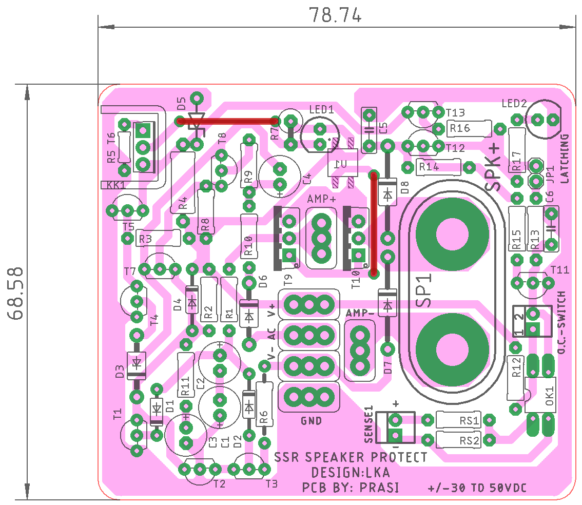

Thank you for the suggestion. Here is layout as per post no. 58.
Love the circuit and PCB design, but it makes it impossible to stack for an multi-driver active speaker.
Hi LKA, do you mean "Connect T5 collector to D3-T7 junction" ? I don't see any D3-D7 junction !!!!!!Another suggestion. Connect T5 collector to D3-D7 junction. C4 discharging will be quicker when AC is lost. (component numbering, post 65)

Prasi - RS1,RS2,OK1 - should be a part of power amp pcb.
Hicoco, schematics have different numbering. D3-D4 junction on last sch, see post 82.
Hello LKA,
I put RS1,RS2,OK1 on protect pcb so that this SSR protect can be used on an existing power amp which does not have these components.
Regards
Prasi

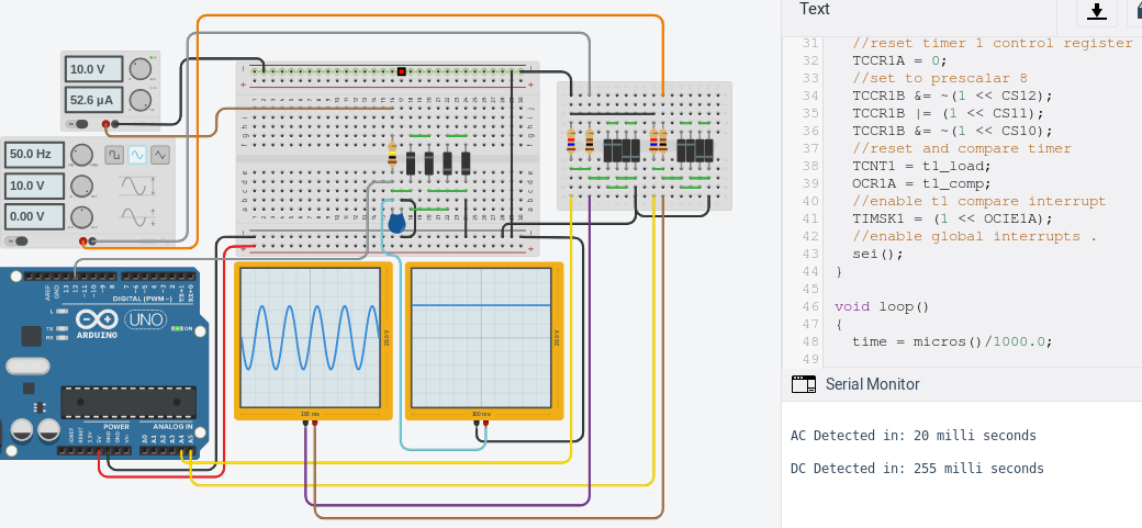

Interesting thread, have been playing around with using arduino analog pins to check for DC and resolve within 100ms one might say that that is too slow considering above presumably detects and resolves in 380us. The AC lp filter 100k + 10uf will feature a 3.3 volt zener across the capacitor to protect the arduino input, other pins will check temp, over current and short circuit featuring lean code and timer interrupts. output pins will shut off power and trigger speaker protection, plus printing out on LCD the protection event.
Yes the analog domain is faster, however the digital domain is still fast enough.
We use an analog circuit to detect DC which in turn disconnects the SS speaker relay while at the same time pulling an interrupt pin low on an Arduino. The Arduino in turn shuts the amp down and signals trouble. This gives us redundant shut down for speaker relays and amp protection at the same time and much faster reaction time. How to build a 21st century protection board
Hello LKA,
Regards
Prasi
I think this is not good idea. You create wide loop across emitter resistors.
OK , thanks LKA, got it. then one need not populate rs1, rs2, ok1 and the sense connector, i.e, leave them out.
BTW if i will have the final schematic and the black&white pcb i can test this soon.
Ready for pdfs?
here they are. rs1,rs2, ok1 on power amp pcb as recommended by LKA.

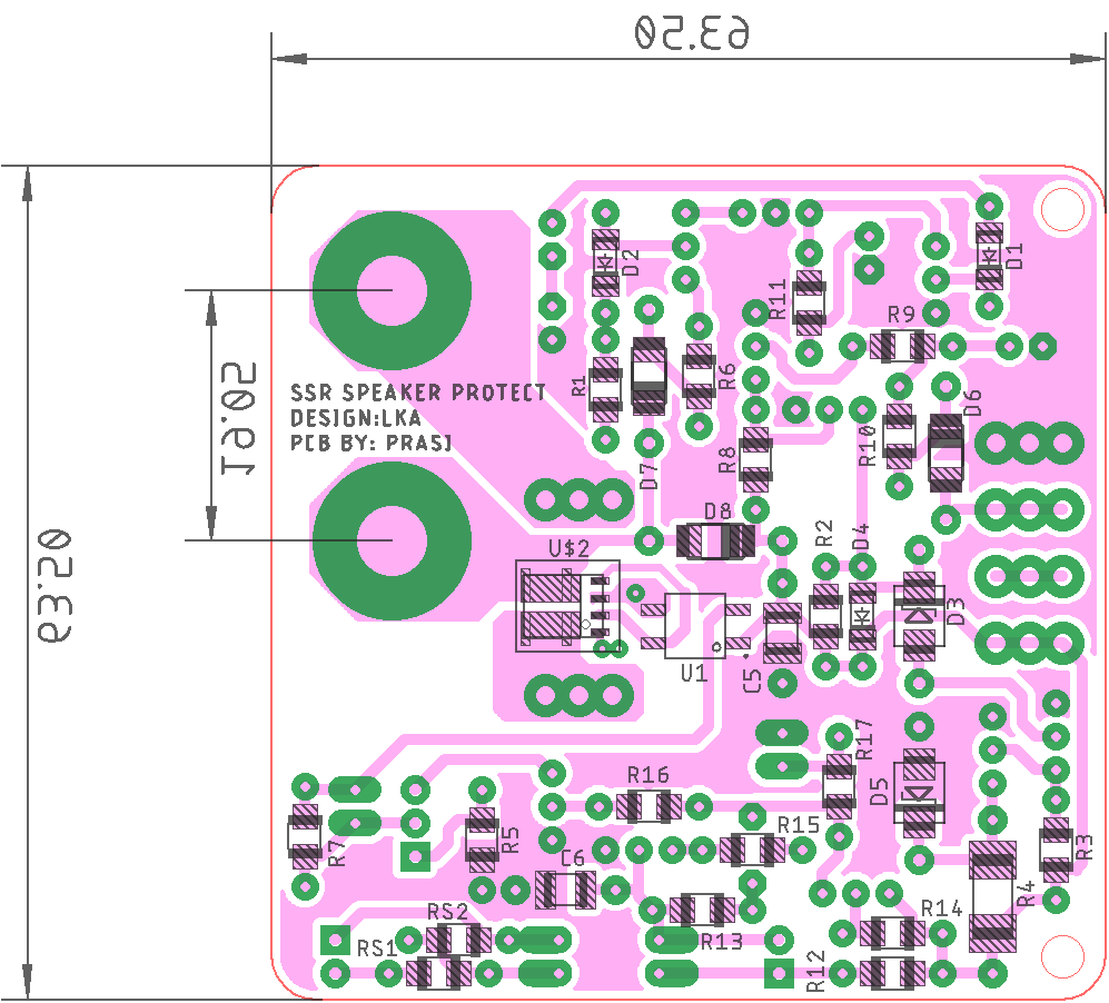

I have been working on another version with smd and tht both and here are the views.
The smd on bottom and also small THT are populated from bottom side.
All electros , transistors from top.
The mosfet is a dual channel smd mosfet SQJB00EP.

how fast are you able to detect ac or dc
There's a couple issues you will have with a design like this. First, it's way too slow. The cone of the speaker would already be against the stop by the time that thing saw DC. Your detection needs to be happening in the microseconds realm, not milliseconds. Second, you have digital and analog circuits connected together, it's going to be noisy. If you are going to monitor two channels you'll have ground loop issues as well.
I've found the best approach is to use a good old fashion analog DC detection circuit connected to the input of a high speed optoisolator. Use the output from the optoisolator to change the state of an interrupt pin on your microcontroller. I use a dual input optoisolator and have one output connected to the microcontroller and the second directly disconnecting the SS relay allowing for a redundant shutdown of the SS relay with the microcontroller latching it off, meanwhile the microcontroller shuts down the amp at the same time minimizing further damage to the failed output stage.
regards
Prasi

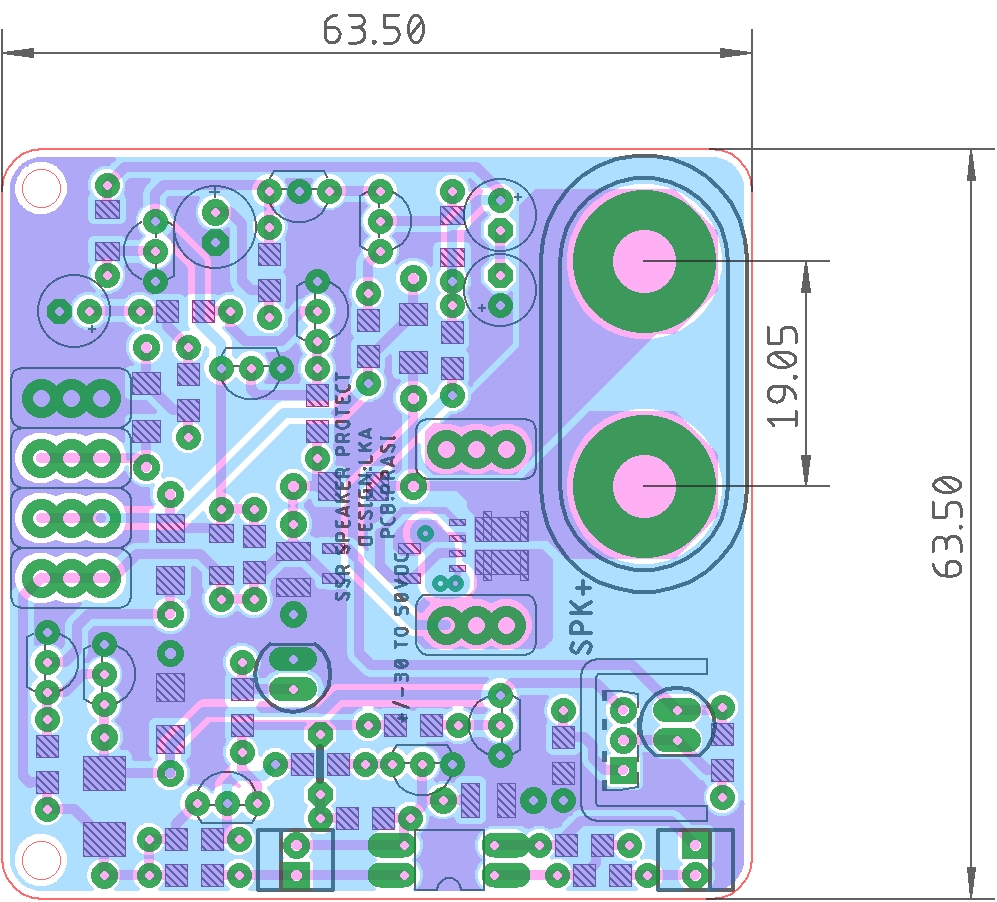

gerbers as per above design. Not tested.
regards
Prasi
