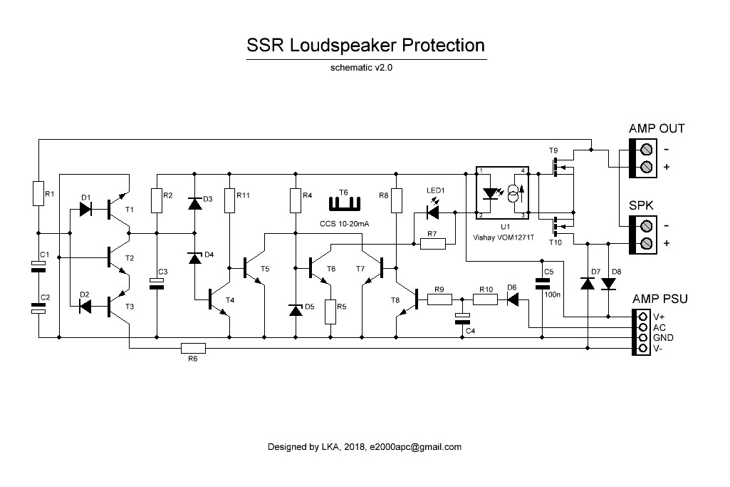

One can use protection like this. On the left - DC detector, on the right - AC detector. Photovoltaic coupler is powered by CCS. R2,C3 - ON delay. T6 requires a heatsink.
Can anyone help me with understanding what T1, T2, T3, D1 and D2 are doing?
So if I understand correctly, T2s collector is held around the positive rail voltage (less one ~0.7V diode drop). If the amp output were to sit at rail voltage for enough time, C1 and C2 charge via R1. This will switch on T1 with base current supplied through D1. T1 collector is now pulled low which discharges C3, turning off the optocoupler.

If no DC at amp output, T1-T3 are all OFF. C3 is charged via R2, if voltage reaches zenerV+0.6V, T4 turns ON and T5 OFF. CCS (R4,R5,D5,T6) is released, now optocoupler can work.
When DC present at output, for example positive, T1 turns ON, this pulls down T4 base, T5 turns ON and CCS will be switched OFF.
D1 and D2 increase DC level thresholds.

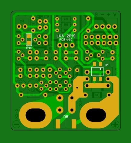

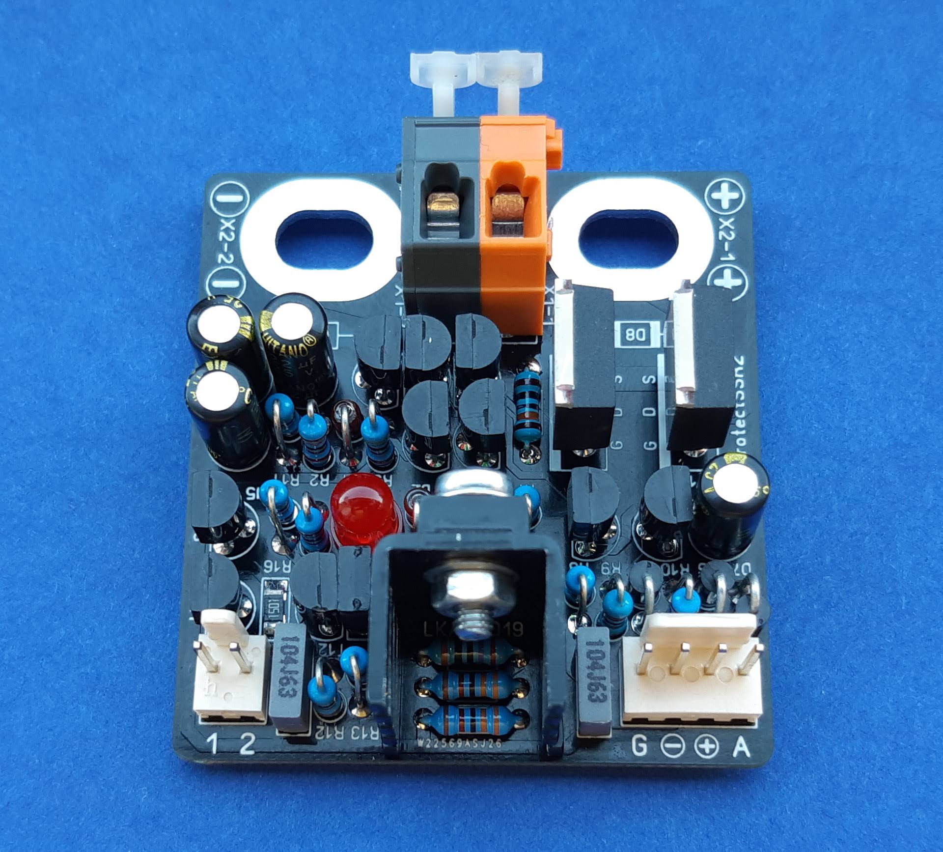

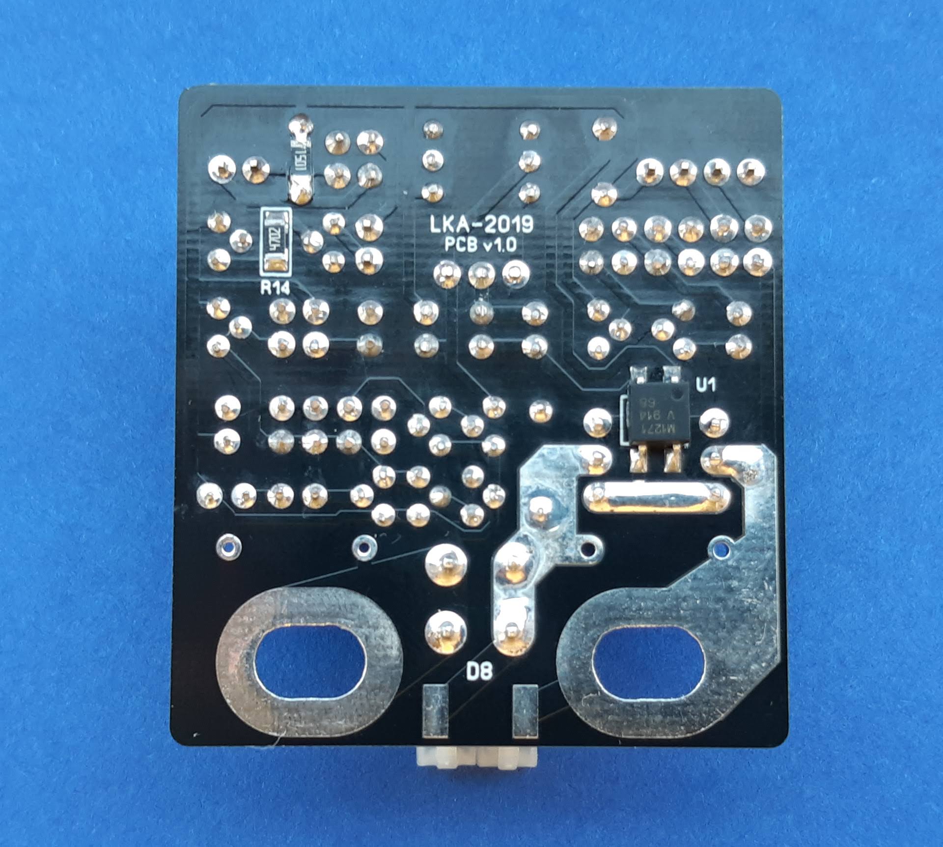

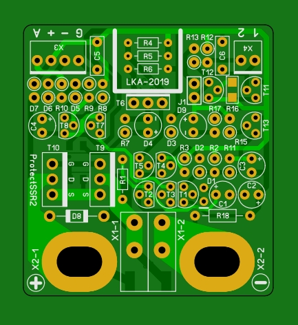

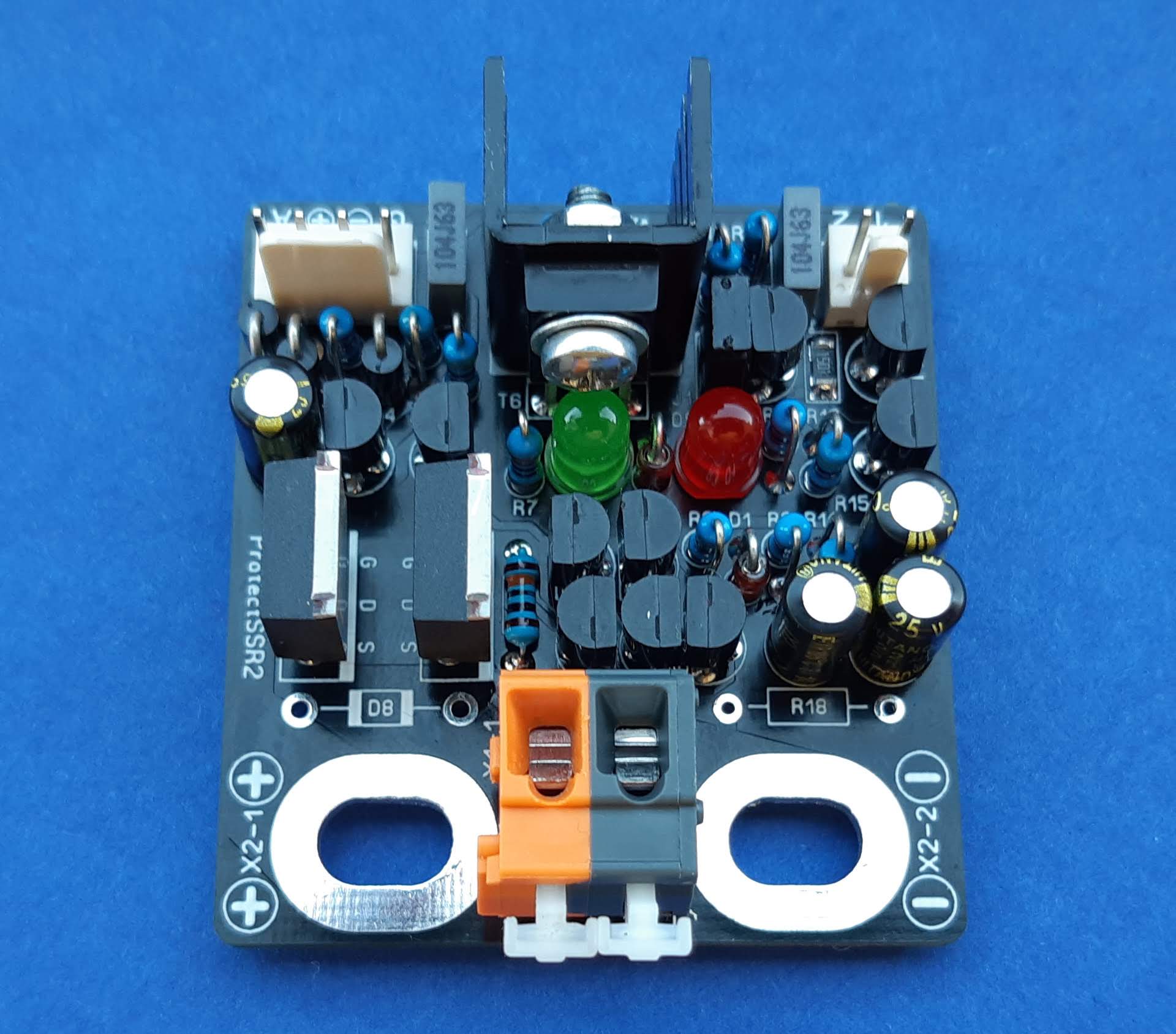

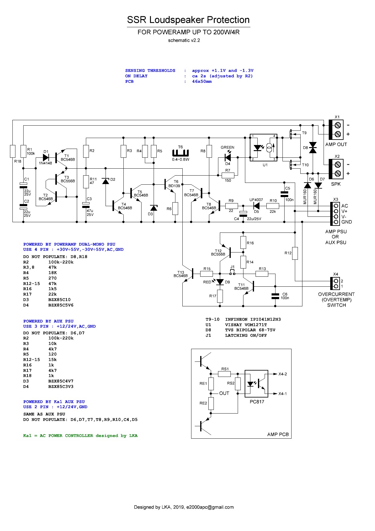

My PCB design, holes 3-5mm, terminal distance 22.5-28mm, board dimension 46x50mm. Almost all components are TH.

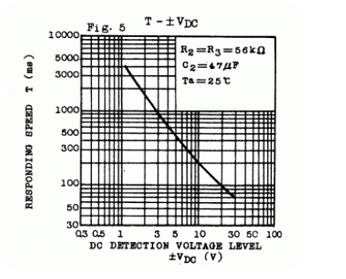

Have you properly simulated or tested the circuit? 250mS doesn't sound right.
Response time
Many DC detections are working on the same principle.
The TA7317 chip is the one I'm using combined with a SSR relay.
The response time of the TA7317 is depending on the RC input filter AND the value of the DC input voltage.
See graph below.
